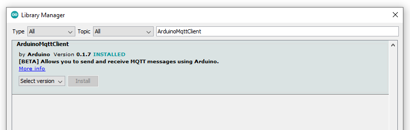

    The library must be installed via Libraries:
    Screenshot of the Arduino Library Manager with the ArduinoMqttClient library installed.
    Then we can run the sample code that we'll write together in a moment.

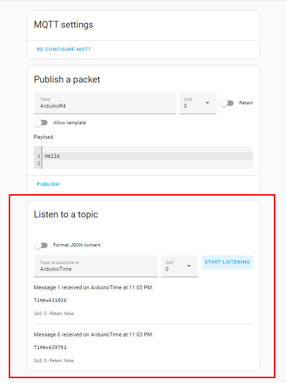

    That's all. We save and upload to Arduino. Home Assistant assumes it's already on. We enter the MQTT tool, Home Assistant sees the information published by Arduino:
    Screenshot of MQTT settings in Home Assistant with publishing and listening messages.
    Arduino also sees what HA will post:
    Screenshot showing Arduino R4 WiFi communication with an MQTT broker in Home Assistant.
    Communication works fine both ways.
