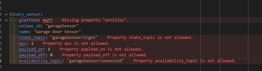

    Yes I have familiarised myself with this, and have only managed to achieve sensor status and relay control in homeassistant.
    But the stumbling blocks started when you have to create code for the binary sensor to read the sensor status, for me in homeassistant it gives an error when trying to set up the binary_sensor with the mqtt platform. Screenshot of YAML code for homeassistant showing configuration errors for binary_sensor. .

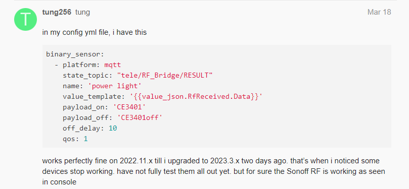

    The syntax has changed recently. Try correcting according to this topic:
    https://community.home-assistant.io/t/binary-sensor-of-mqtt-broke-with-core-2023-3-x/549165
    Before:
    Screenshot of a forum post showing a YAML configuration snippet for a binary_sensor using the MQTT platform in Home Assistant.

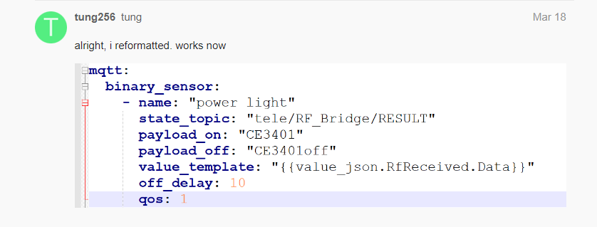

    After:
    Screenshot showing a YAML configuration snippet for Home Assistant, defining an MQTT binary_sensor named power light. .
