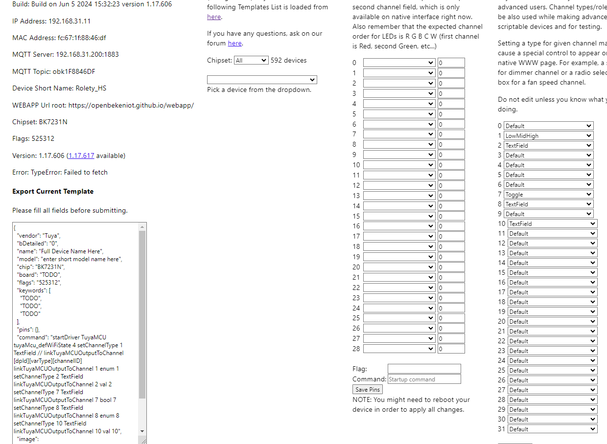

    I have a MOES roller shutter switch standard with BK7231N(CB2S) on board. I have uploaded OpenBEKEN version 1.17.606 to it along with autoexec.bat (TuyaMCU).
    MOES roller shutter switch with three buttons: up, middle, down. .

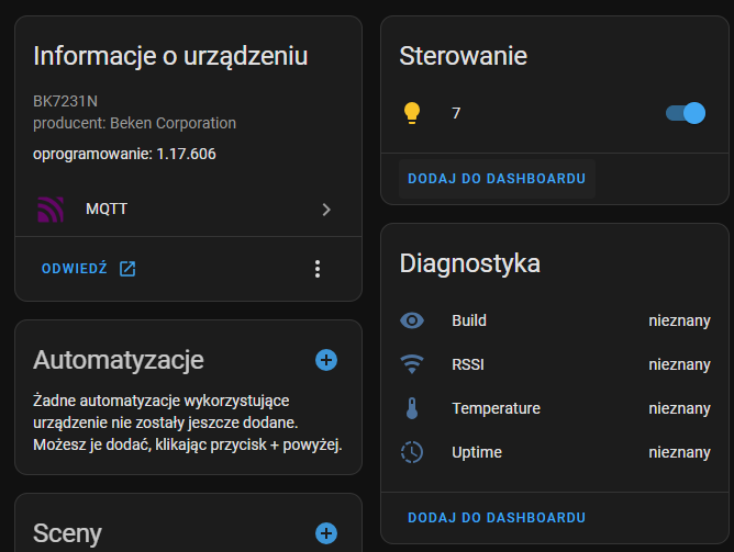

    I have MQTT in the docker (working), the switch reports to HA, but I don't see anything in the entities to control the blinds.

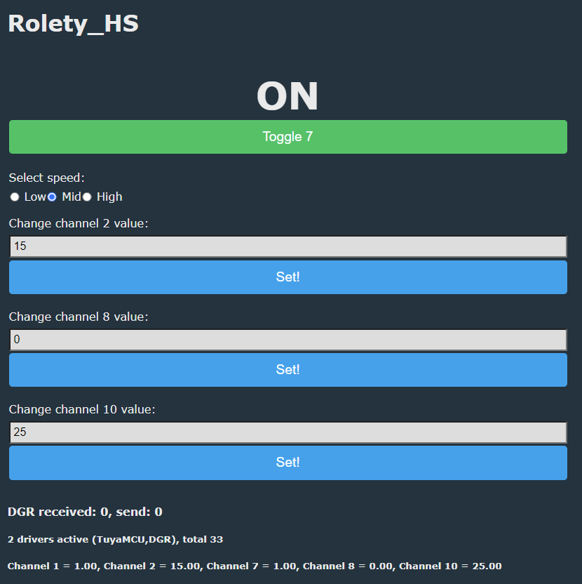

    Screenshot of the blinds control interface with MOES switch and OpenBEKEN .
    OpenBK7231N settings panel for roller switch.
    Device control panel BK7231N in Home Assistant .
    It seems to me that the problem is that the control of the blinds (opening/closing/pausing) is done via channel 1 (LowMIDHigh), which can take the value 0,1,2 (enum), and I don't know how to "map" the value of channel 1:0-close, 1-pause, 2-open.
    When I assigned to channel 7 (bool) in Channel Types: toggle, an entity appeared in HA to control the switch, here a backlight. The question is how to configure channel 1 (TuyaMCU) so that this channel can be controlled in HA. Is it possible to "make" one channel into 2 virtual switches which could take the values 0-1, 1-2?

    If a channel type is missing then you can simply write the YAML for Home Assistant yourself. There are two ways to do this
    1. you can simply add the device manually in configuration.yaml
    2. you can write the yaml for HA discovery manually and publish it via publishFile, see here: https://www.elektroda.pl/rtvforum/topic4052749.html#21075733
    Alternatively, since you say that the channel "close, 1-pause, 2-open." is used in TuyaMCU then I can add it to the predefined types.
    With the switches it would probably work too, but I'd have to think about it.
