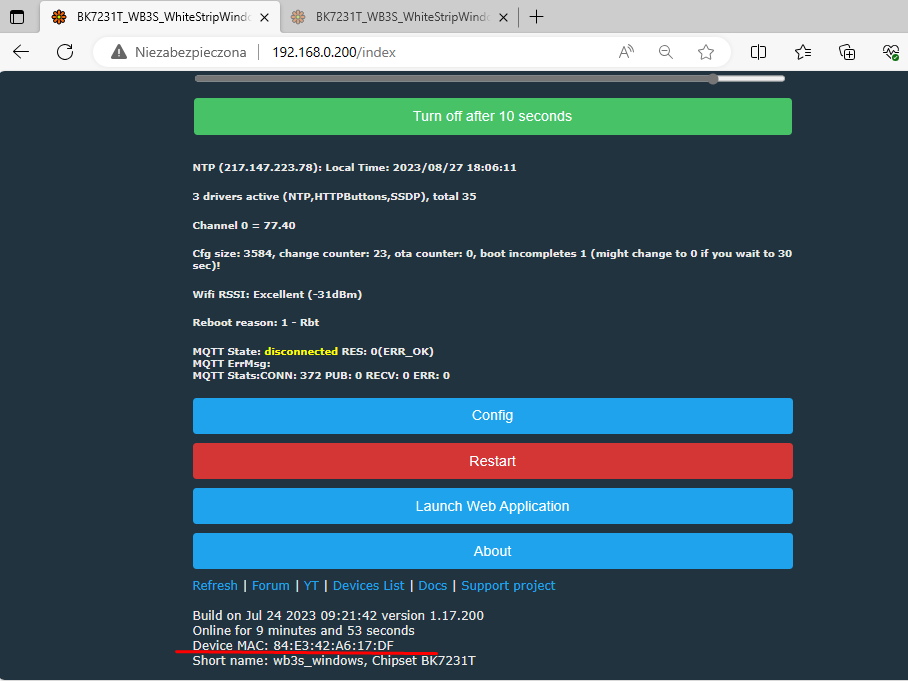

    Maybe let's check one thing first. Can you post screenshots from each panel of the device, where the MAC address is?
    Screenshot of a network device user interface showing configuration and status information.
    I wonder if maybe you didn't remove the RF partition with calibration and at the same time also removed the MAC addresses...
    Or show a screenshot from the DHCP tab, what MACs do the Beeches have at your place?

    Hmm ok, but check those MACs anyway, if your MAC addresses end in zeros, that means you've cleared the RF partition for yourself.

    None of the devices have 00 at the end. Is that a good thing yes?

    This is rather good. It is also worth noting whether the MAC addresses are repeated
