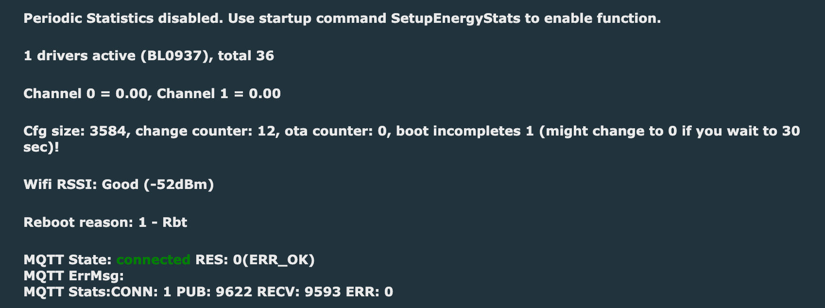

    I recently flashed two devices (Smart Plug & Wifi Bulb) to Openbeken via Tuya cloud cutter.
    Everything went perfectly fine, and I am able to access both the devices via web server.
    I have configured MQTT correctly and both devices say it's "Connected to MQTT".
    I have started "Home Assistant discovery" also but the devices are not being discovered by Home Assistant.
    Screenshot showing device connection information to MQTT network.
    What could be the issue? I have tried restarting Home Assistant and also restarted MQTT services but nothing seems to be working.
    Please help

    Please post full specs of your devices, preferably including the OBK JSON template from the Web App.

    The following device should be correctly discovered by HA.
    Please redo the Discovery and paste Home Assistant log here, maybe something goes wrong.
    Or wait, maybe you have whitespace in device name?

    this is the HA log
    Logger: homeassistant.components.mqtt.discovery
    Source: components/mqtt/discovery.py:114
    Integration: MQTT (documentation, issues)
    First occurred: 12:05:12 PM (24 occurrences)
    Last logged: 1:09:56 PM
    Received message on illegal discovery topic 'homeassistant/sensor/Zunpulse Smart Plug _sensor_7/config'. The topic contains not allowed characters. For more information see https://www.home-assistant.io/integrations/mqtt/#discovery-topic
    Received message on illegal discovery topic 'homeassistant/sensor/Zunpulse Smart Plug _sensor_8/config'. The topic contains not allowed characters. For more information see https://www.home-assistant.io/integrations/mqtt/#discovery-topic
    Received message on illegal discovery topic 'homeassistant/switch/Zunpulse Smart Plug _relay_1/config'. The topic contains not allowed characters. For more information see https://www.home-assistant.io/integrations/mqtt/#discovery-topic
    Received message on illegal discovery topic 'homeassistant/light/Syska Bulb_light/config'. The topic contains not allowed characters. For more information see https://www.home-assistant.io/integrations/mqtt/#discovery-topic
    Received message on illegal discovery topic 'homeassistant/switch/ZunpulseSmartPlug _relay_1/config'. The topic contains not allowed characters. For more information see https://www.home-assistant.io/integrations/mqtt/#discovery-topic

    You have spaces in the device name. I wll try to fix that issue soon.

    Oh God, just noticed I had a space at the end of the device name, that stopped HA discovery.
    Issue is fixed now :) I have corrected the names...
    Thanks for your support and yes please fix that in the next update.

    Test is complete, short names will be forced to have underscores in place of spaces and long names can have spaces (those are not sent to HA) - starting with build 1.17.238
