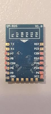

    I got this chip from a ceiling light similar to this one below:
    34W Tuya WiFi LED Ceiling Light Double Layer Type Dimmable CCT Ultrathin Surface Mounting Lamp RGB Colorful Back Light

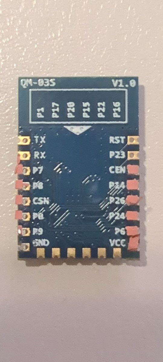

    Can anyone identify what this chip is? It has no sticker on it and from the PCB markings I cannot be sure.
    Electronic chip from a ceiling light, without visible markings.
    Chip module labeled QN-803S V1.0 with various pins.
    Thanks

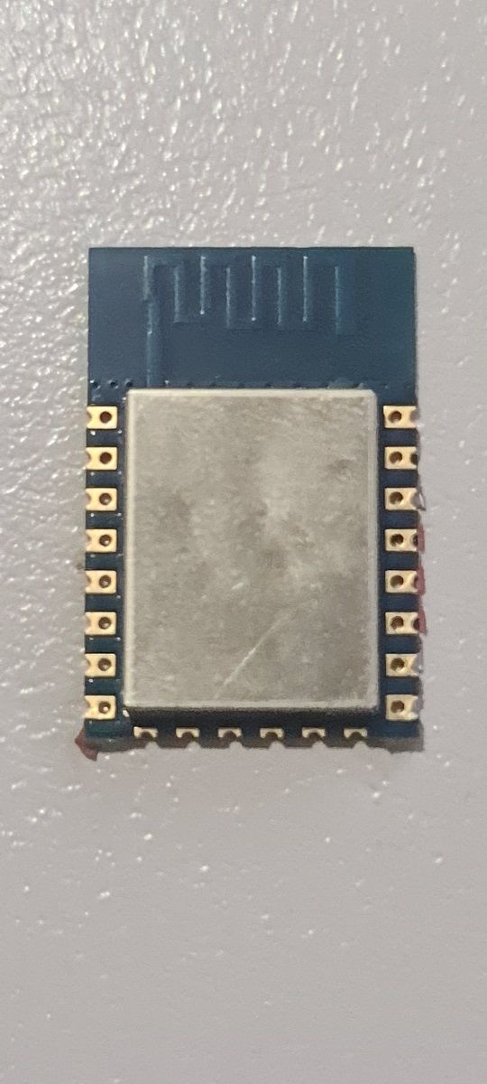

    Can you remove the metal shield? Could be N chip
    Those look like ripped pads on the pins
  • #3 20722859
    MnM1
    Posts: 175
    Rate: 13
    Yes, they are ripped pads... don't ask :)
    I can try to remove the shield.

    It's a CB3S
    I hope you can repair those ripped pads on the pcb, takes some patience and steady hands for that
