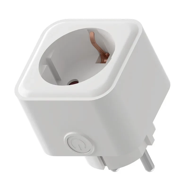

    Hi, I found this plug in a thrift store and am using it to learn. After opening it and extracting the WB2S module I was able to program it with OpenBaken easily using UART.
    Translating GPIO Configuration of Calex Smart Plug 429198 from Tasmota to OpenBKApp
    Now I need help with the pin configuration. Tasmota already has support for this same model https://templates.blakadder.com/calex-429198.html but I don't know how to translate that GPIO configuration to the OpenBKApp one.
    I would appreciate if you help me to understand how to do it.
    Thanks!

    #2 20734335
    gmarcos87
    I was able to get it set up and running with Home Assistant.
    PWM0 - Button
    PWM1 - Led
    PWM2 - Led
    PWM4 - Relay
  • #3 20736816
    Posts: 14771
    Rate: 12914
    Good job on translating it. Keep in mind that even CB3S footprint is slightly different from WB3S footprint so you have to double check when porting a template between platforms. The most important GPIOs like power, ground, UART and ADC are matching but some of the other digital IOs may be swapped.
