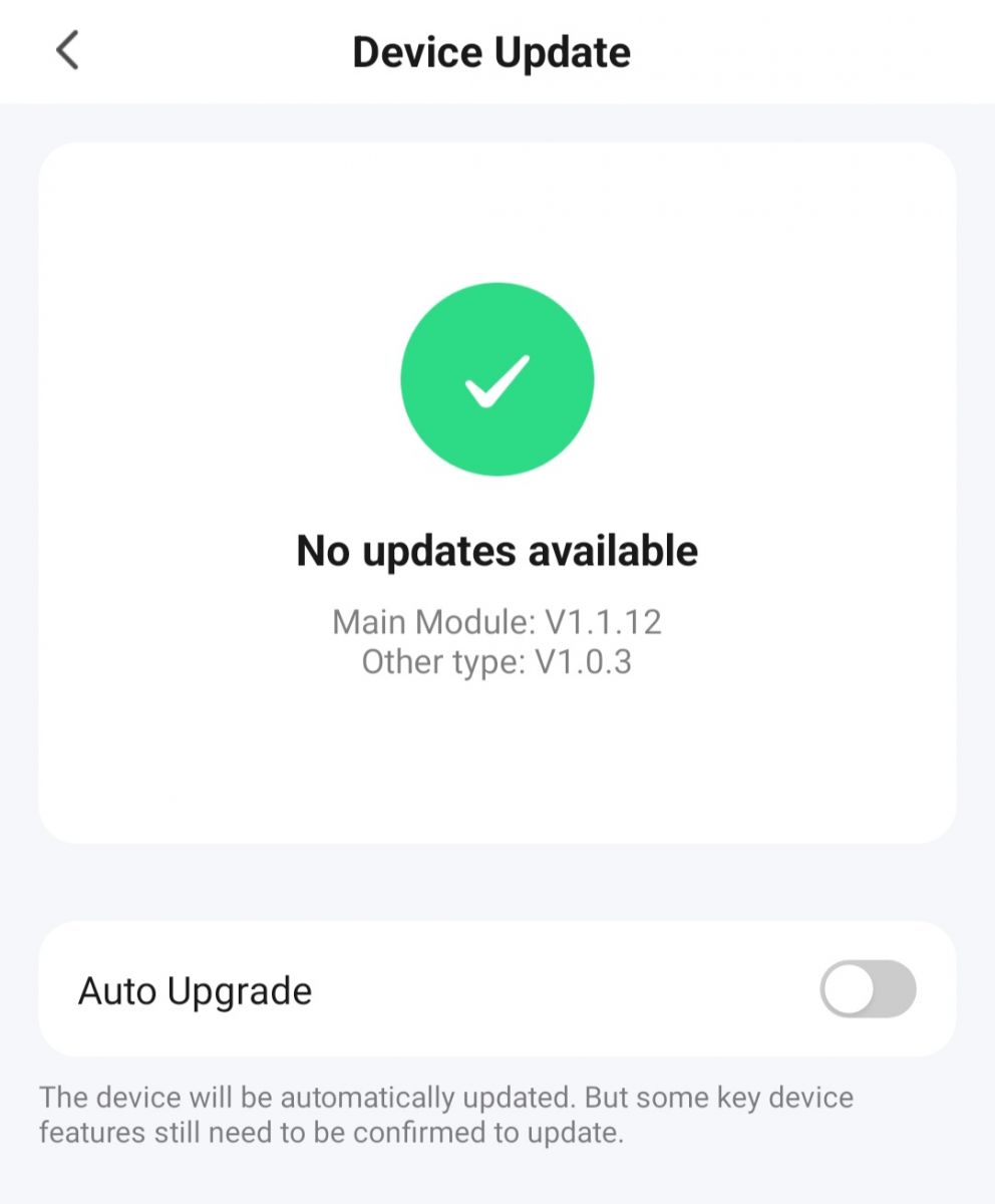

  • #11 20646933
    baukje
    Posts: 27
    So half of the plugs I got were patched (1.1.12) and have to be opened, and the rest are slightly older and unpatched (1.1.8) but work (with difficulty in tuya-cloudcutter).
    openbeken flashed, but how do I use the power monitoring? All the pins were discovered from backup, but I don't see power output in the webUI or in MQTT... How do I enable?

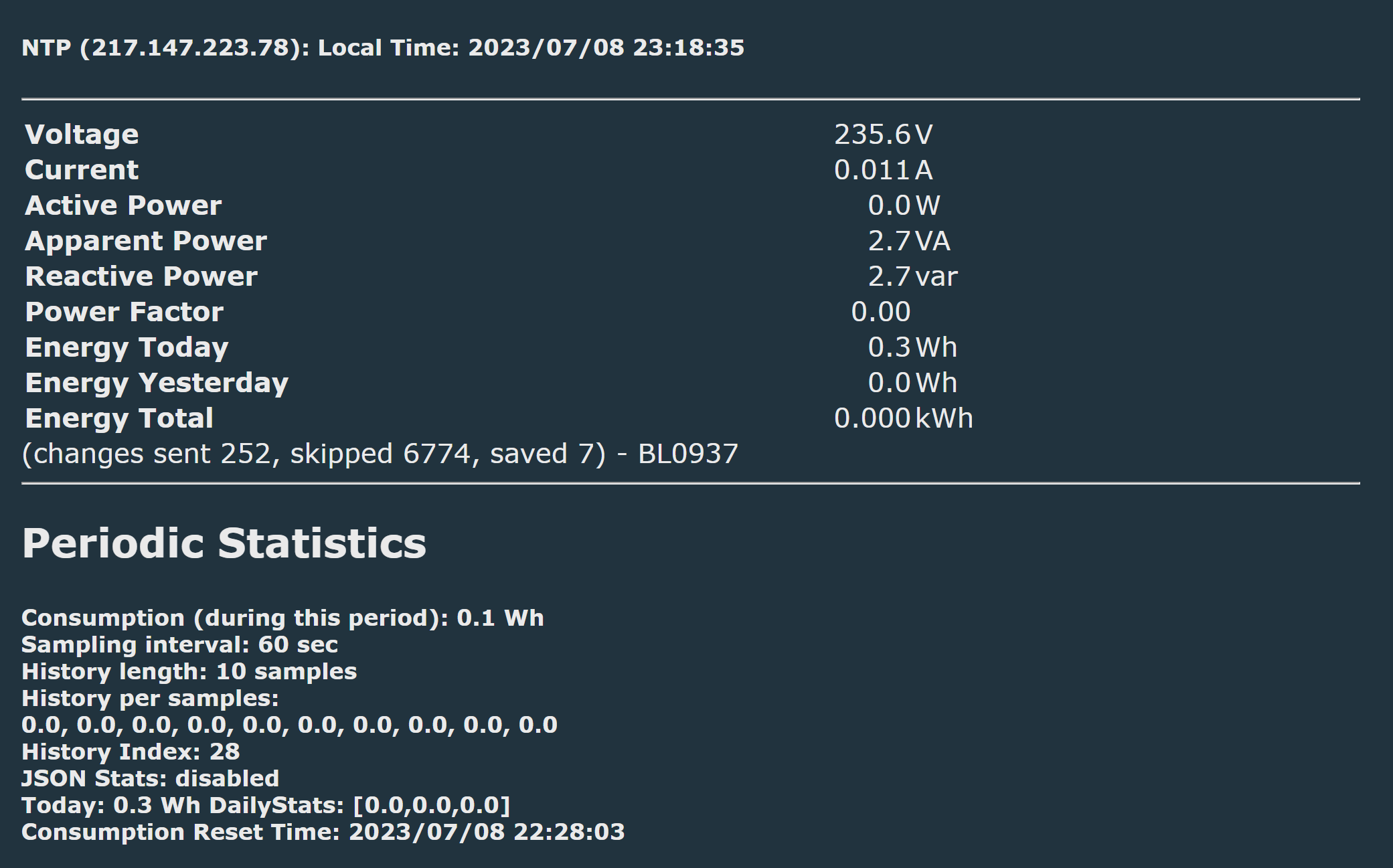

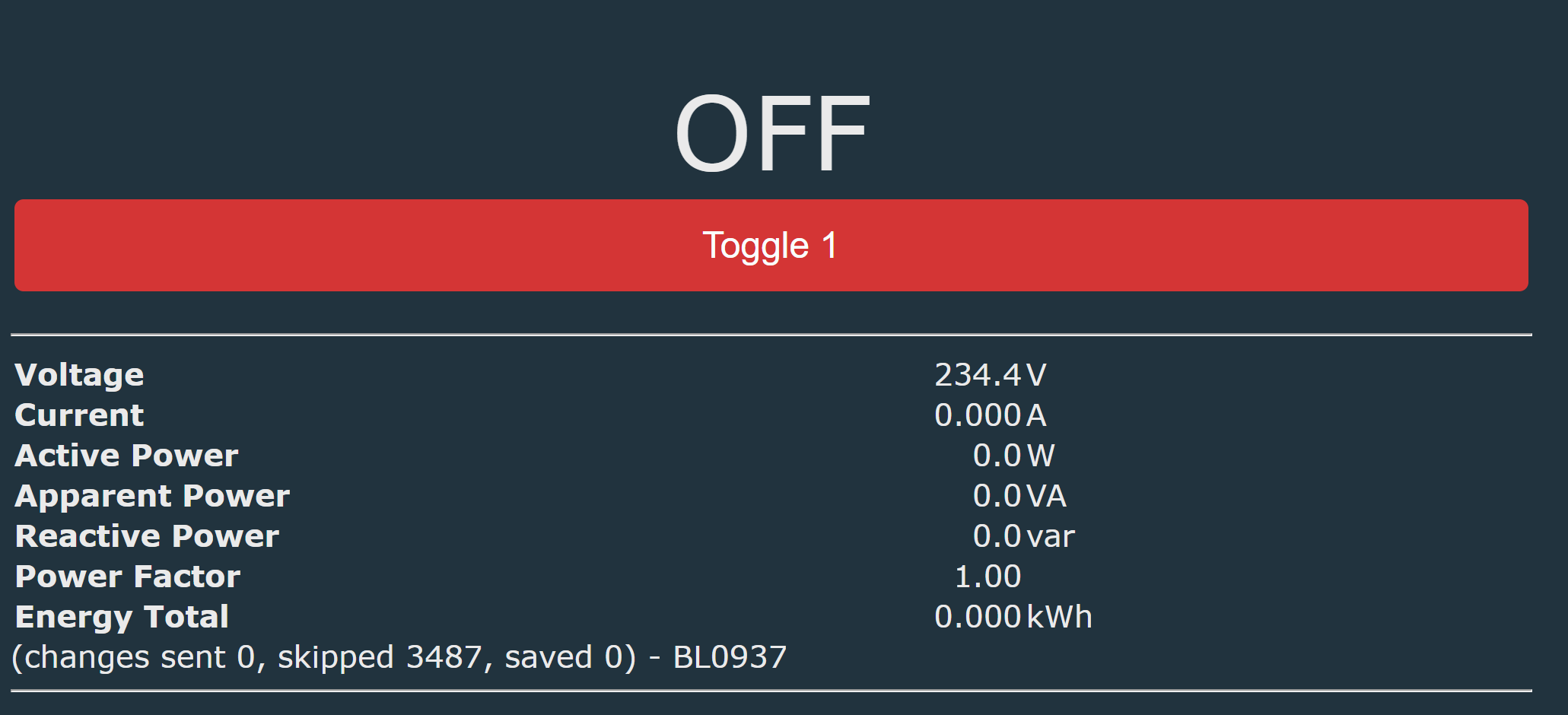

  • BL0937 pin mapping and calibration confirmed
    #13 20646971
    baukje
    Posts: 27
    The main WWW only showed toggle relay..... at first :) I just checked again and it shows the power stats as expected.
    Other than calibration, does it need any other configuration?
    - BL0937 SEL on P8
    - Button (channel 1) on P26
    - BL0937 VI on P6
    - WiFi LED on P11
    - BL0937 ELE on P7
    - Relay (channel 1) on P24
    Device seems to be using CB2S module, which is using BK7231N.

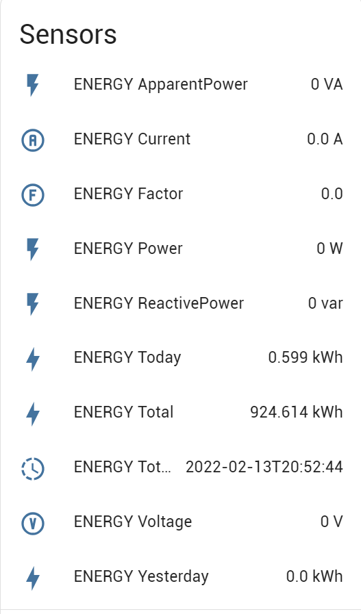

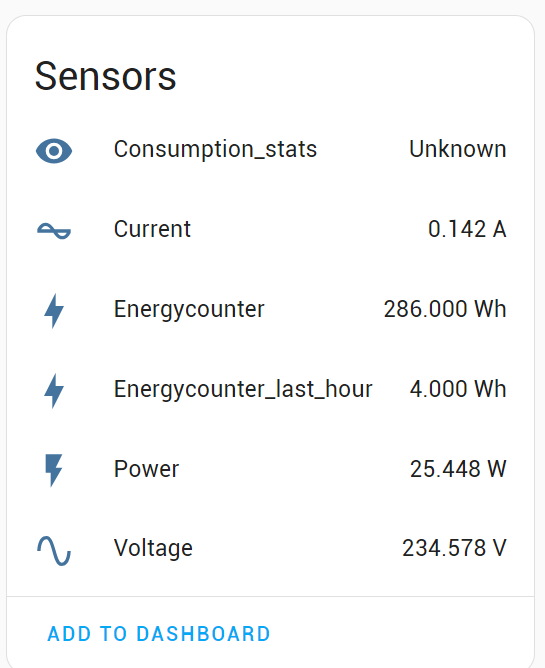

  • #15 20647141
    baukje
    Posts: 27
    Are there any example setups for HA? I can't get it to show kWh, only in totals
    Configuring GPIO and Power Monitoring Pins for Antela UK 13A Smart Plug with OpenBK7231N Flash
    Added after 9 [hours] 41 [minutes]:
    ok, found the flag to show totals in kWh in mqtt.

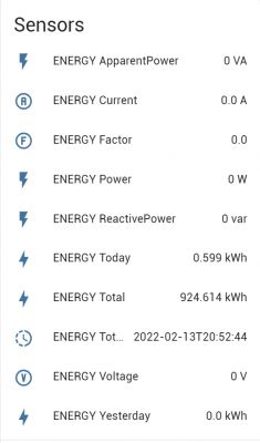

  • #16 20648023
    Posts: 14827
    Rate: 13010
    So, is everything working as expected?
    You can pair the device with HA manually (by writing YAML) or use our Home Assistant Discovery
  • #17 20648112
    baukje
    Posts: 27
    The units seem to sometimes show in Wh and sometimes kWh
    On a similar Tasmota device, I got this as default:
