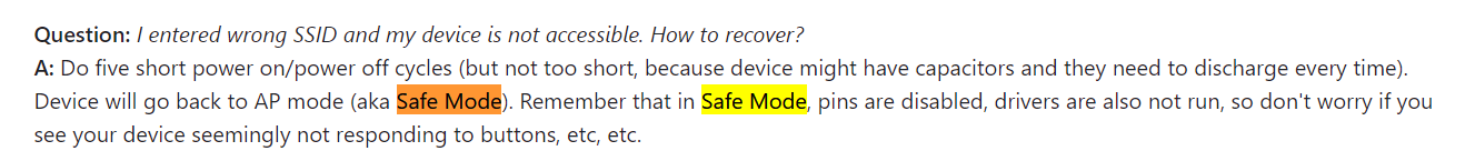

    Hello, is there any way to reset OpenBeken device?
    I had a very well working device until I changed the name settings from the config and rebooted it. Now it does not appear connected to the network and the only button on it does not respond in any way.
    It has an LED lit under the button. So I suppose it is not totally dead.
    But what can I do to reset it?
  • #2 20780162
    Posts: 14743
    Rate: 12839
    Hello @Tilator, have you tried to use Safe mode, just like we've shown on our FAQ?
    https://github.com/openshwprojects/OpenBK7231T_App/blob/main/docs/faq.md
    Screenshot of instructions for recovering a device after entering the wrong SSID.

    I am glad to hear that the issue is resolved.
