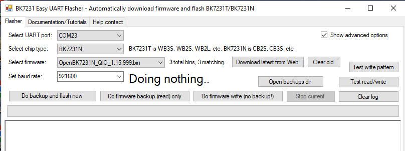

    1. Flash the device using BK7231Flasher.exe with FullFW.bin (Attached).
    FullFW.bin is a full 2MB flash with empty MAC and RF data. This clears the incompatible RF data from Tuya.
    2. Copy FullFW.bin to OpenBK7231N_QIO_1.15.999.bin and put the file into the firmwares folder. The BK7231Flasher will not "see" the FullFW.bin file in the "Select firmware" dropdown otherwise.
    [Tutorial] Fix for OpenBeken not connecting to WiFi (KS-602S switch, BK7231N chip)
    3. Click on "Do backup and flash now".
    4. While the flasher is displaying "Getting bus failed" in yellow, touch the CEL pin to ground for 0.1 to 0.25 seconds to put the device into the flash mode.

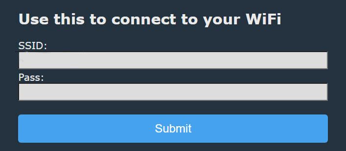

    9. From here, click on "Configure WiFi", then enter your WiFi credentials.
    10. When you click on "Submit", the device will reboot and try to connect to your network. (If everything goes well. Otherwise see below)).

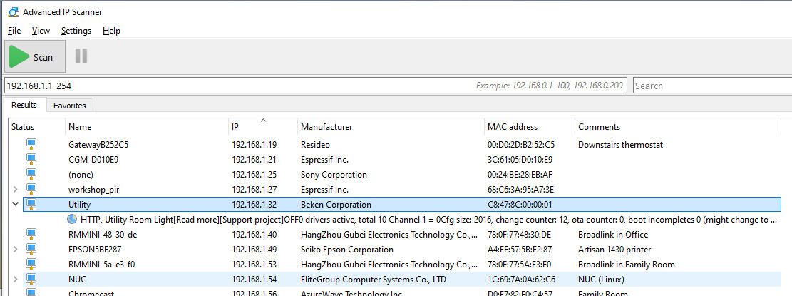

    11. Do an IP scan to find the IP address of the device. (I use Advanced IP scanner).
    12. Enter the device IP address on your browser. (A feature of the Advanced IP scanner is that the dropdown exposes the HTTP link).

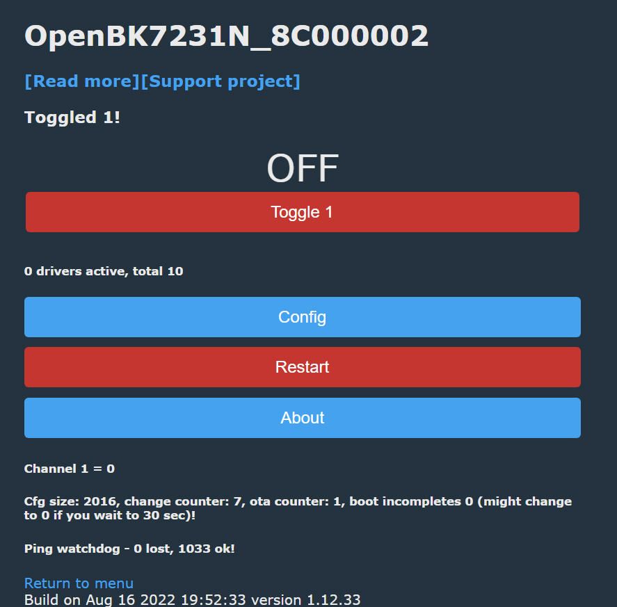

    Opening the IP address for the device will bring you back to the menu. Again, open "Config".
    13. Now go to "Change Mac". The binary I used, FullFW.bin, erases the MAC address and if you ever flash a second device you will have a MAC address conflict unless you change them. Now would be a good time to change the MAC address. (In my case I just changed the last digit from 0 to 1. On the second unit I changed the last zero to 2).

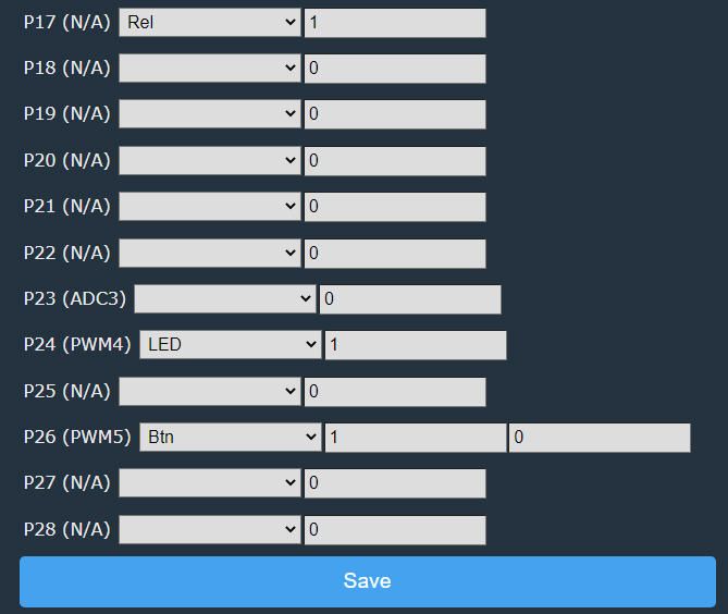

    Here are the Module Configuration for my KS602S switches:
    P17 - Relay - channel 1
    P24 - LED - channel 1
    P26 - Button - channel 1

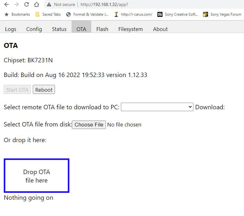

    Do not use the config menu item: OTA (update software by WiFi). This won't work with an .rbl file.<br>
    1. Go to https://github.com/openshwprojects/OpenBK7231T_App/releases and download the *.rbl file for your device.
    In my case the KS602S switches have the BK7231N chip, so I downloaded OpenBK7231N_1.15.394.rbl
    2. Open the Web App by entering your device IP plus /app?. For example: http://192.168.1.32/app? (Alternately, there is a link to WebApp on the config menu).
    3. Click on the "OTA" tab.
    4. Drag the .rbl file you just downloaded to the box labeled: "Drop OTA file here".
    5. Click on "Start OTA.

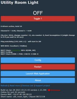

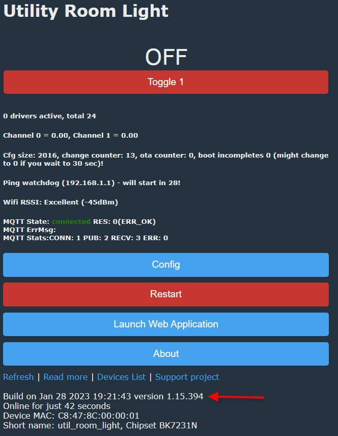

    6. When OTA is finished, the device will reboot. Wait a few seconds and open the device IP.
    At the bottom of the menu from the device you can see the latest version number.
    Your device is now up to date.

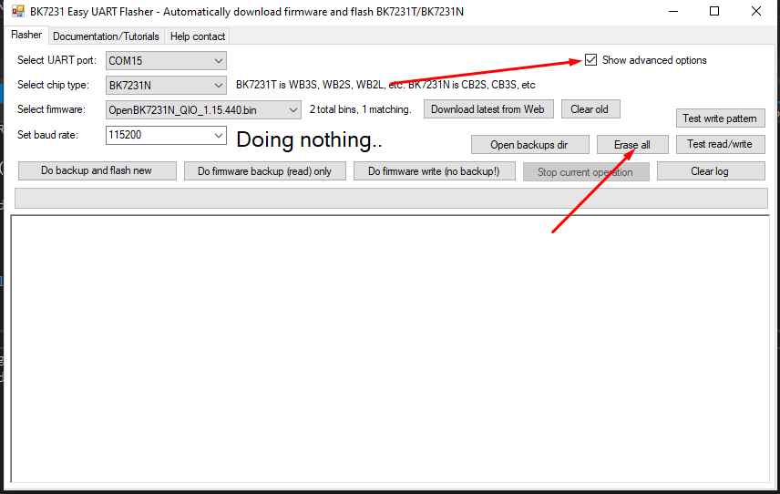

    IMPORTANT:
    Now you can just use our BK flasher:
    first do erase All:
    this will remove RF partition, config, etc. Your MAC will become zeros.
    Then flash OBK latest release (as usual).
    Then in OBK, you need to go to Web App, Flash Tab, click Restore RF Partition, and then change MAC.
    The description above does basically the same what FullFW.bin did, FullFW.bin was a full flash binary with erased RF data. But this work around now is simpler.
