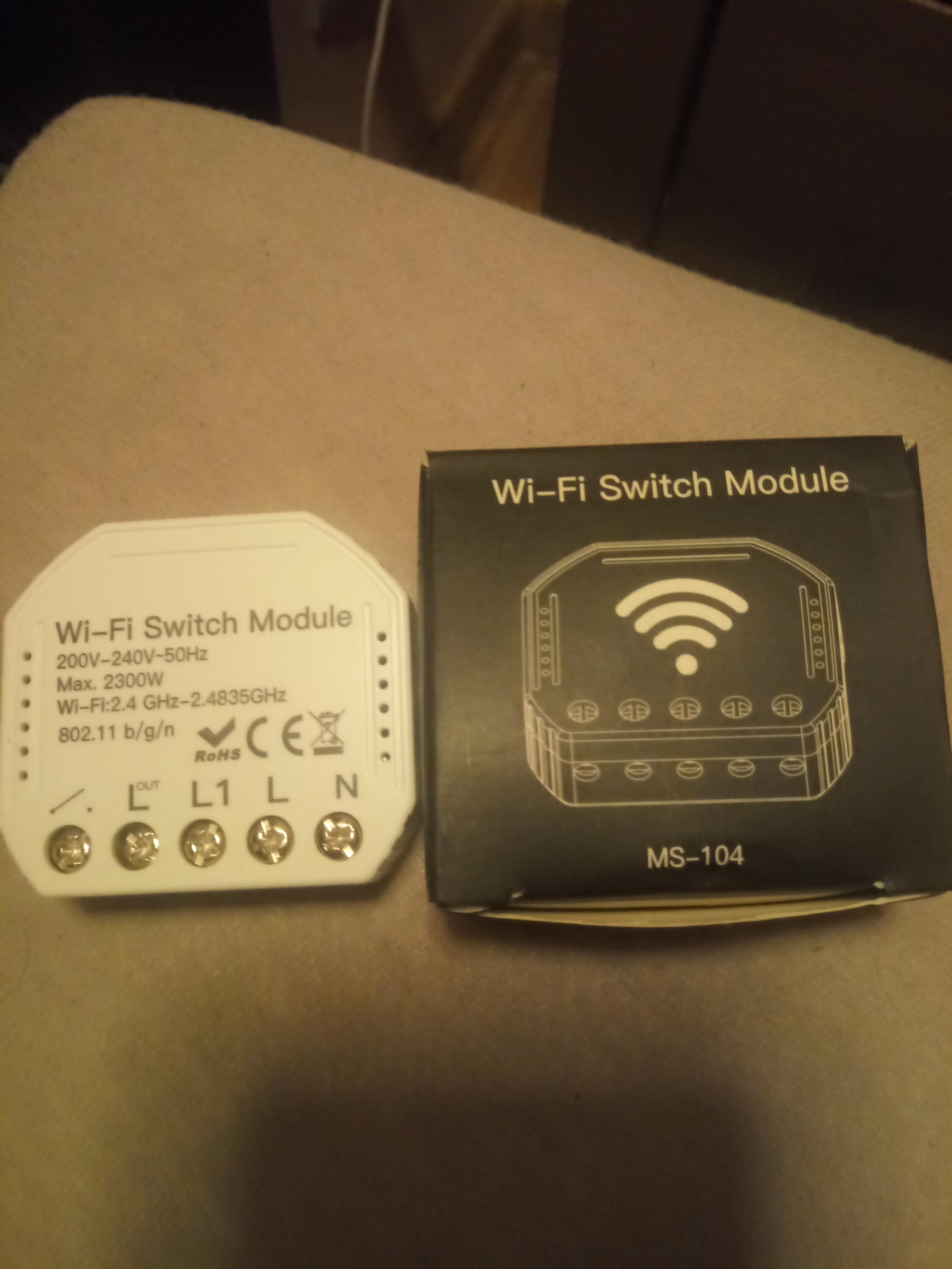

    Hello, I am making a request to experts in the subject. I own 2 pieces of Chinese Tuya WIFI switches. They are paired in such a way that when one switch is switched on, this one automatically switches on the other switch via the scene. The analogous principle is for switching off: the device connected to switch 1 switched off = the device connected to switch 2 automatically switched off. Everything works as it should until there is a power outage (interruption of the power supply to the house). When the power goes out, even for a moment, the appliances do not return to their preset operating state. When the power comes back on, they are out of the network and have to be found again in the system and the scenes have to be programmed.
    Is there any advice and a way for this to happen so that after a power outage and when the power comes back on, the devices themselves find the network and work as programmed in Tuya?

    Specify manufacturer and model, insert photo.

    >>20781380
    Something like this.

    If it forgets the setting after a power outage then in my opinion this is some kind of fault. I have this in one outdoor lamp and as a solution I used to replace it with another one. I use switches in such a housing for the Tuya system and they do not forget the settings.

    Use the search on Elektroda with the keyword "MS-104". Colleagues seem to have done something with this switch, I haven't.
