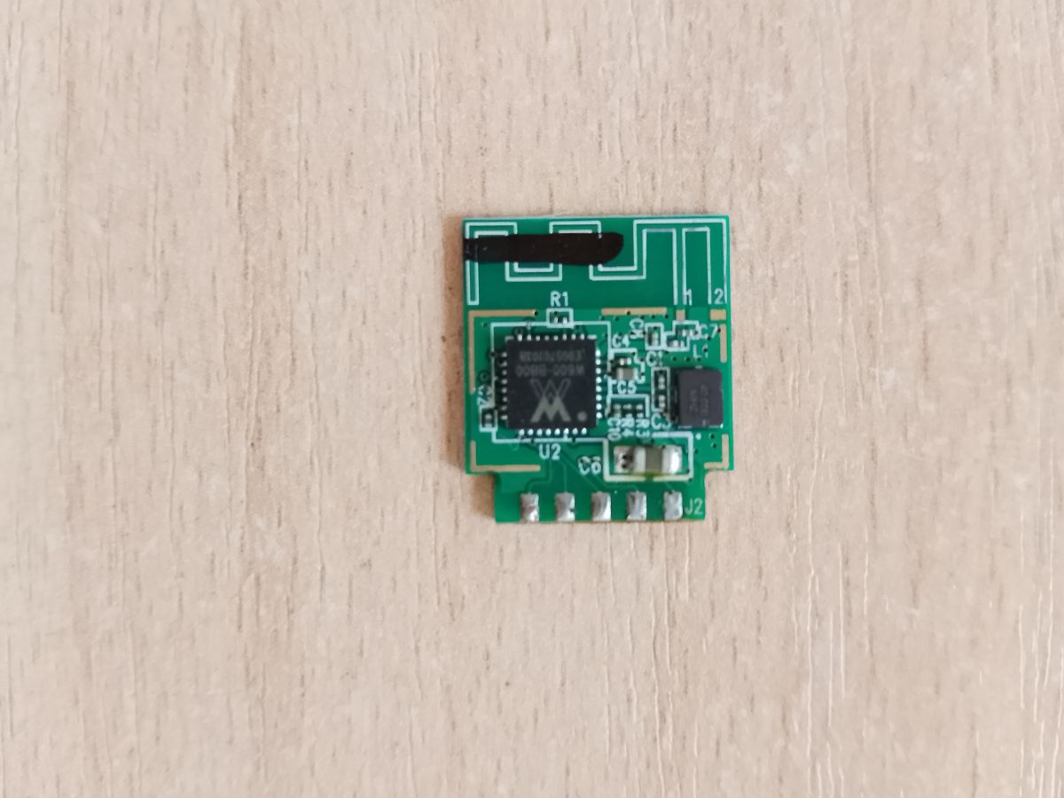

    Hello. Please tell me how to flash the board W600. The seller deceived me, promised esp8285, but inside is W600.

    No problem, so, what kind of W600 board you have? How does it look like?

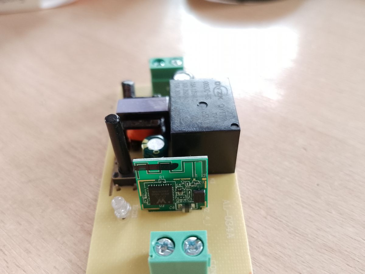

  • #3 20787623
    skyvladik
    Level 4  
    Posts: 10
    The inscription on the board is T102 W600-V2.0. The inscription on the chip is w600-8800.
    Added after 3 [minutes]:
    Electronic module with visible chip and relay on a circuit board.

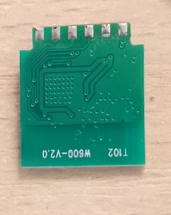

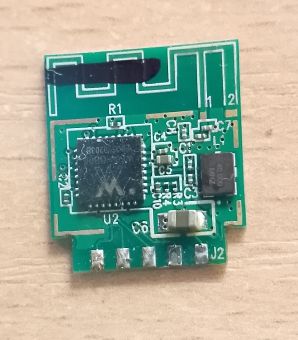

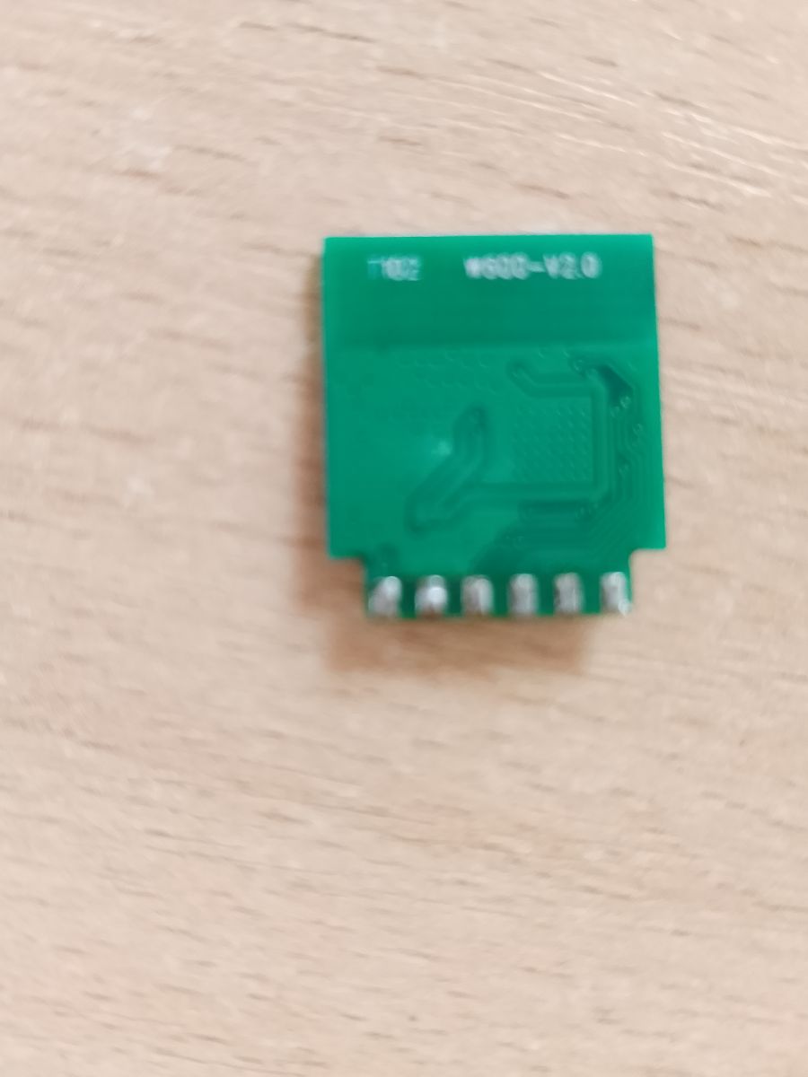

  • #4 20787742
    Posts: 14797
    Rate: 12954
    Are there any pads on the back of this WiFi module?
  • #6 20790449
    Posts: 14797
    Rate: 12954
    They didn't print a markings on pads... not good.
    Okay, now show us the other side of the board.
    Futhermore, can you create a high-quality photo of the board so we can see where the traces go?

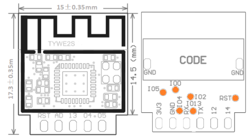

  • #8 20790625
    Posts: 14797
    Rate: 12954
    Diagram of the TYWE2S module with marked pins.
    I 'd guess, connect RX, TX and 3.3V and GND... but I am not sure about boot signal.

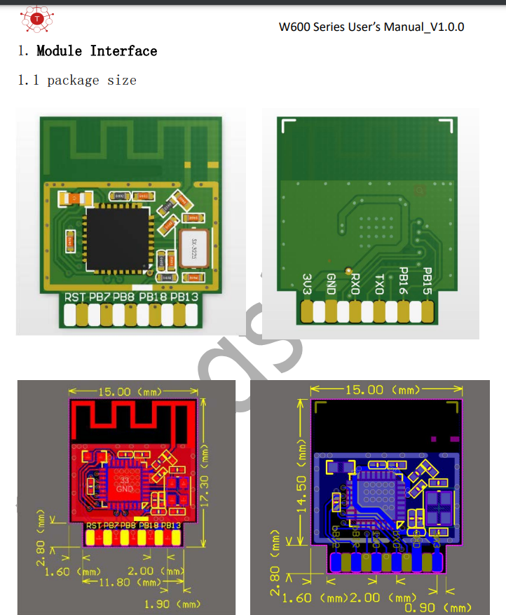

    Added after 32 [seconds]:
    Isnt it that module?
    https://fccid.io/2ASQV-TW-03/User-Manual/User-manual-4210975.pdf
    Diagram of W600 interface module with pin labels and dimensions.
  • #9 20795197
    skyvladik
    Level 4  
    Posts: 10
    Yes, it looks like this module. Tell me how to flash this module. I don’t understand what program is needed and where to get the firmware for the w600.
  • #10 20795201
    Posts: 14797
    Rate: 12954
    Hello, here is a short W600 flashing guide, which shows which program you should use (wm_tool.exe) and which console command you should type in the terminal:
