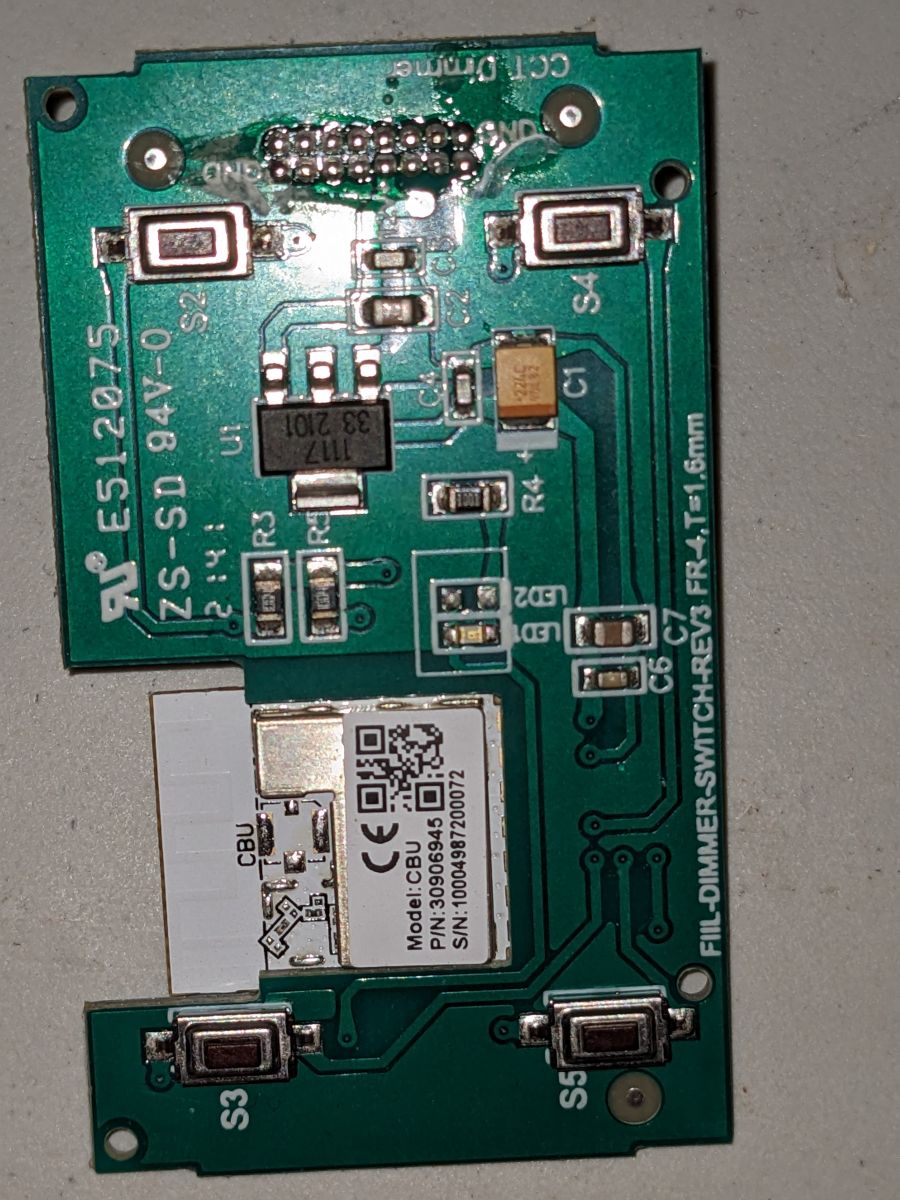

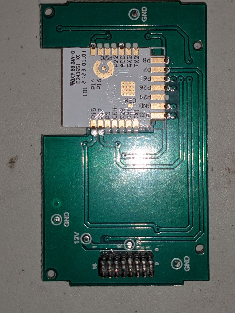

    I would like to control the lights in a more advanced way, i.e. on/off with a single press on the top left or bottom left buttons, different things (like specific color/brightnesses or random rainbow chase or something) for the top right and bottom right, and double taps for example, dim up/down for some buttons held down).
    Unfortunately extraction failed...
    Sorry, no meaningful pins data found. This device may be TuyaMCU or a custom one with no Tuya config data.
    The device seems to be using the wb3s module, which is using BK7231T.
    And the Tuya section starts at an UNCOMMON POSITION 0.
    It does not have a tuyaMCU, and it runs on a CBU module, so I think it is just a weird device with highly customized firmware that doesn't have data in normal places...
    the buttons are directly wired to pins on the board.
    View of an electronic module mounted on a green circuit board with pin markings. Circuit board with a CBU module and buttons.
    i now have the GPIOs working from the 4 buttons and the LED:
       "6": "Btn_ScriptOnly;0",
        "7": "Btn_ScriptOnly;0",
        "8": "Btn_ScriptOnly;0",
        "14": "LED;6",
        "15": "AlwaysLow;0",
        "17": "AlwaysLow;0",
        "26": "Btn_ScriptOnly;0"
    now i guess i need to understand the SmartLED Button functionality?
