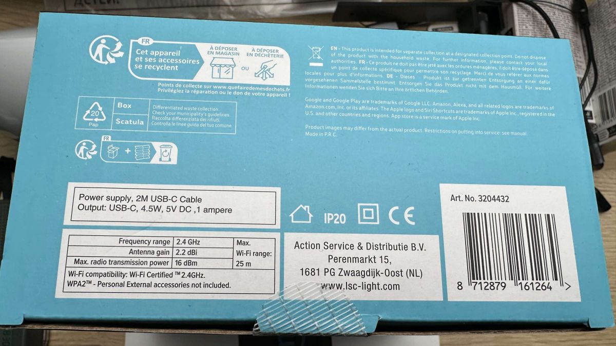

    Box of LSC Smart Mood Light with visible feature information.
    Back side of LSC smart lamp packaging with product information.

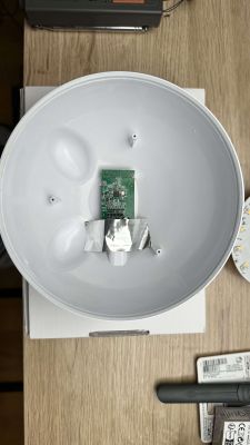

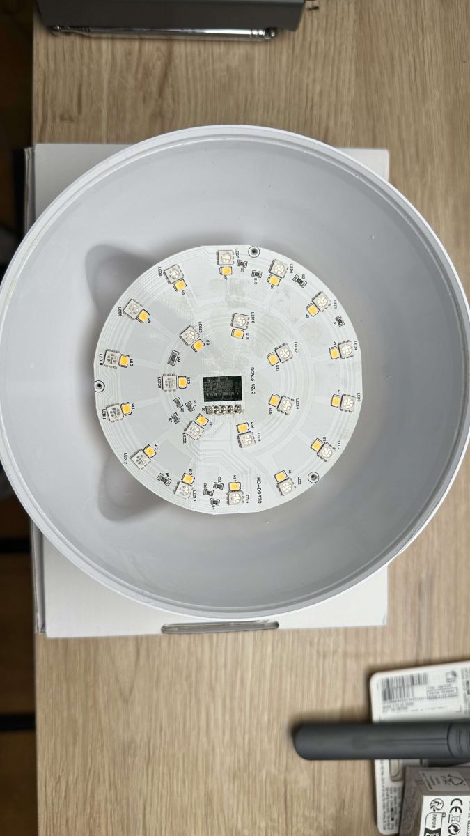

    opening is quite easy by gently cutting the glue around the edge of the refractor and then it comes :
    Interior of a smart lamp with a visible circuit board and wires.

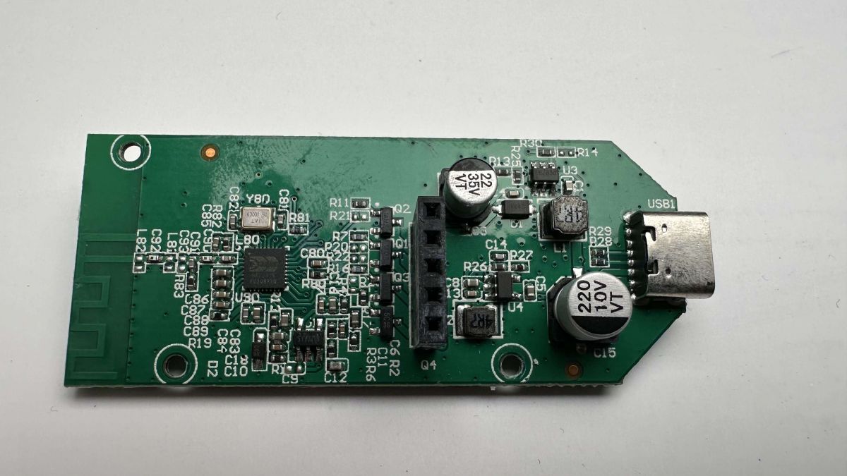

    Interior of a smart light with a visible circular circuit board featuring LED diodes.

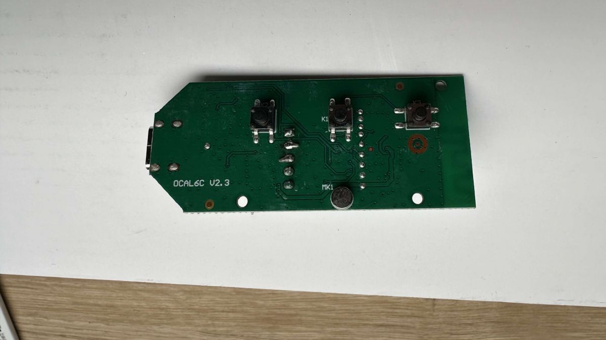

    This time, the BK7231N is soldered directly :
    The image shows a printed circuit board with electronic components and a USB connector on the right.
    Circuit board with three visible buttons and the marking OCAL6C V2.3.
    The light is recognized in tuya app with fw 2.0.0.
    I've dumped the FW and submitted a profile for TCC so now this lamp can be flashed directly.
    Working profile (except mic/music functions):

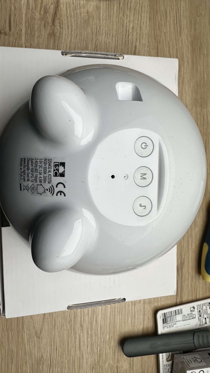

    White, smart lamp with a rounded shape on a desk surrounded by boxes and cables.
    Back of the smart mood lamp with three buttons and a sticker with CE markings.

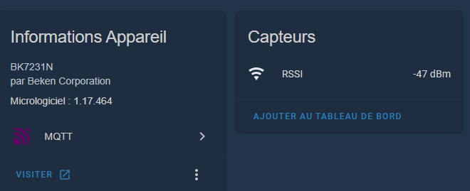

    Hi there,
    I've just flashed my device with tuyacloudcutter, working like a charm on its web interface, however I'm struggling to make it work with Home Assistant, I'm only getting RSSI info on MQTT, nothing else. Screenshot of the BK7231N device web interface showing device information and RSSI.
    Do you have an idea of what could be the issue? Thanks!

    Hello @alexandrethenard , sorry for the late reply.
    The following may indicate that you haven't configured PWMs, or, to be more precise, that you did HASS Discovery before configuring the PWMs.
    You need to first configure PWMs (the GPIO, the template as shown in the first post), and then do again Home Assistant Discovery.
    Please refer to the video below for HASS Discovery procedure:
    If you have a different device and don't know which GPIOs are used, don't have a template, you can try doing Tuya config extraction:
    Let me know if the issue persists after repeating Home Assistant Discovery and I will try to help you futher in such case.

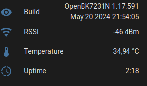

    I have a similar problem. I just see the values for: Screenshot showing system data of OpenBK7231N.
    But no Lights. I selected as template the model: 3204432
  • #12 21091240
    Posts: 14793
    Rate: 12941
    What is your config? From what I can see, the 4-PWM discovery is missing?

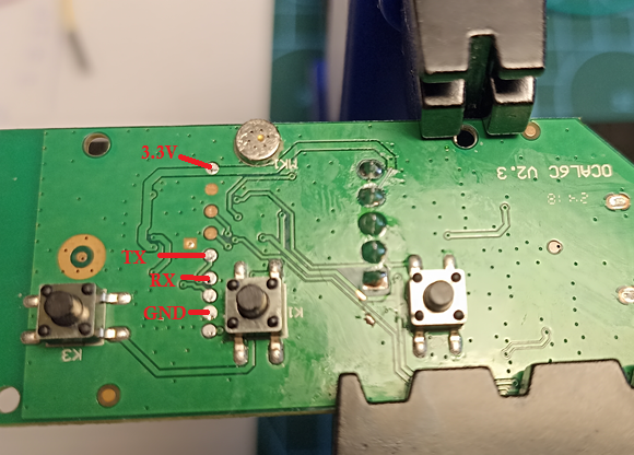

    thordals
    >>20959172 I'm old school, I like the smell of tin ;)
    I flashed today by soldering 0.2mm wire to access the UART pins
    UART pins :
    Close-up of a circuit board with wires connected to UART pins labeled 3.3V, TX, RX, and GND. Circuit board with wires soldered to UART pins.

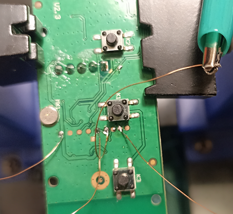

  • Reset pin needed on CEN pad for flashing
    #24 21629231
    mtb1007
    Rate: 10
    >>21318230
    Thanks for figuring out the UART wiring, I've flashed it that way too. In addition to these pins, I also needed the reset pin to initiate the transfers: the CEN pin is routed to the pad just above Tx (in your first image), so the 3rd pad from the mic.
    With the pin settings from post #17 above, and flags 0, 1, 10, 23 and 24 set, the device functions quite well. Although even at full power, the brightness of the RGB LEDs is rather poor (especially R), but the warm-white LEDs are a bit better. You get what you pay for, I guess..

The CEN reset point is routed to the pad just above TX, described as the third pad from the microphone in the first UART photo. A later flasher said that pad was needed to initiate transfers, in addition to the UART pins. If flashing does not start over TTL, missing the CEN connection is a concrete failure point. [#21629231]
