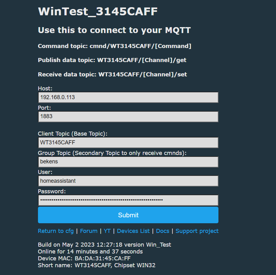

    Here is a screenshot from Windows Simulator with CW strip in OBK:
    C01W/C02W/C03W/C04W WiFi&BT LED Controller with TuyaMCU UART protocol
    C01W/C02W/C03W/C04W WiFi&BT LED Controller with TuyaMCU UART protocol C01W/C02W/C03W/C04W WiFi&BT LED Controller with TuyaMCU UART protocol

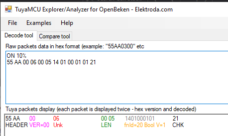

    I got another device and recorded the UART as requested.
    9600 baud 8N1 on pin 5
    Unfortunately the device isn't recognized as Cool/Warm, it appears as just a single channel "Smart Wi-Fi Dimmer" in both "Tuya Smart" and "Smart Life" apps, so I just get brightness and on/off. Both cool and warm are operated equally. I hope you can guess which is which - I would guess the protocol is consistent with RGBCW ordering since that's the pin layout on the main board.
    Let me know what else I can provide!
    ON 10%
    55 AA 00 06 00 05 14 01 00 01 01 21

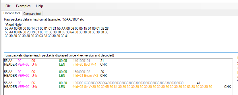

    55 AA 00 06 00 05 14 01 00 01 01 21 55 AA 00 06 00 05 15 04 00 01 02 26
    55 AA 00 06 00 20 19 03 00 1C 30 30 30 65 30 64 30 30 30 30 30 30 30 30
    30 30 30 30 30 30 30 30 63 38 30 30 30 30 41

    Here is the tool used:
    https://www.elektroda.com/rtvforum/topic3970199.html#20528459
    Here is interpretation:
    The packet above is only turn on, no brightness change.

    "Good night":
    What may be this?
    fnId=25 Str V=30 30 30 65 30 64 30 30 30 30 30 30 30 30 30 30 30 30 30 30 30 30 63 38 30 30 30 30
    A string? What if we decode as ASCII...
    00 0e 0d 00 00 00 00 00 00 00 00 c8 00 00

    32 55 AA 03 07 00 05 15 04 00 01 02 2A 55 AA 03 07 00 08 16 02 00 04 00
    00 03 C0 F0 55 AA 03 03 00 00 05 55 AA 03 03 00 00 05 55 AA 03 00 00 01
    01 04 55 AA 03 07 00 10 21 00 00 0C 00 01 00 00 03 E8 03 E8 03 E8 03 E8
    F3 55 AA 03 07 00 08 1A 02 00 04 00 00 00 00 31
    Decoded:
    55 AA	03	00		00 01	00	03
    HEADER	VER=03	Heartbeat		LEN	00	CHK
    55 AA	03	01		00 32	7B2270223A226E77617236776F766171796378787A7A222C2276223A22312E302E30222C226D223A322C226D74223A31307D	C1
    HEADER	VER=03	Product		LEN	{"p":"nwar6wovaqycxxzz","v":"1.0.0","m":2,"mt":10}	CHK
    55 AA	03	02		00 00		04
    HEADER	VER=03	McuConf		LEN		CHK
    55 AA	03	07		00 05	14 01 00 01 01 		25
    HEADER	VER=03	State		LEN	fnId=20 Bool V=1	CHK
    55 AA	03	07		00 05	22 01 00 01 00 		32
    HEADER	VER=03	State		LEN	fnId=34 Bool V=0	CHK
    HEADER	VER=03	State		LEN	fnId=21 Enum V=2	CHK
    55 AA	03	07		00 08	16 02 00 04 000003C0 		F0
    HEADER	VER=03	State		LEN	fnId=22 Val V=960	CHK
    HEADER	VER=03	WifiState		LEN		CHK
    55 AA	03	00		00 01	01	04
    HEADER	VER=03	Heartbeat		LEN	01	CHK
    55 AA	03	07		00 10	21 00 00 0C 0001000003E803E803E803E8 		F3
    HEADER	VER=03	State		LEN	fnId=33 Raw V=00 01 00 00 03 E8 03 E8 03 E8 03 E8	CHK
    55 AA	03	07		00 08	1A 02 00 04 00000000 		31
    HEADER	VER=03	State		LEN	fnId=26 Val V=0	CHK
    Through a lot of slow effort I simplified some cases for the strings:
    0000000000000000000000100000 1%
    0000000000000000000000300000 2%
    0000000000000000000000500000 3%
    0000000000000000000001000000 11%
    0000000000000000000002000000 32%
    0000000000000000000003000000 62%
    0000000000000000000010000000 99.9%
    0000000000000000000020000000 32% (weird)
    0000000000000000000030000000 99.9%
    0000000000000000000040000000 99.9%
    0000000000000000000050000000 0%
    0000000000000000001000000000 1%
    0000000000000000003000000000 2%
    0000000000000000005000000000 3%
    0000000000000000010000000000 11% (same pattern)
    0000000000000000100000000000 99.9% (same weird pattern)
    A 1 in any other position (0x31 character) results in OFF/0%
    In all cases, R=G=B=0 and C=W=%

    Info:MQTT:MQTT_RegisterCallback called for bT obkLEDstripWindow/ subT obkLEDstripWindow/+/set
    Info:MQTT:MQTT_RegisterCallback called for bT bekens/ subT bekens/+/set
    Info:MQTT:MQTT_RegisterCallback called for bT cmnd/obkLEDstripWindow/ subT cmnd/obkLEDstripWindow/+
    Info:MQTT:MQTT_RegisterCallback called for bT cmnd/bekens/ subT cmnd/bekens/+
    Info:MQTT:MQTT_RegisterCallback called for bT obkLEDstripWindow/ subT obkLEDstripWindow/+/get
    Info:NTP:NTP driver initialized with server=217.147.223.78, offset=0
    Info:MAIN:Started NTP.
    Info:MAIN:Time 1, idle 240138/s, free 84304, MQTT 0(0), bWifi 0, secondsWithNoPing -1, socks 2/38
    Info:MAIN:Time 2, idle 215726/s, free 84304, MQTT 0(0), bWifi 0, secondsWithNoPing -1, socks 2/38
    Info:MAIN:Time 3, idle 74493/s, free 84368, MQTT 0(0), bWifi 0, secondsWithNoPing -1, socks 2/38
    Info:MAIN:Time 4, idle 0/s, free 84368, MQTT 0(0), bWifi 0, secondsWithNoPing -1, socks 2/38
    Info:MAIN:Time 5, idle 10399/s, free 82808, MQTT 0(0), bWifi 0, secondsWithNoPing -1, socks 2/38
    Info:MQTT:mqtt_userName homeassistant
    mqtt_pass qqqqqqqqqq
    mqtt_clientID obkLEDstripWindow
    mqtt_host 192.168.0.113:1883
    Info:MAIN:Time 6, idle 244856/s, free 84264, MQTT 0(1), bWifi 1, secondsWithNoPing -1, socks 3/38
    Info:NTP:Seconds since Jan 1 1900 = 3891990453
    Info:NTP:Unix time  : 1683001653
    Info:NTP:Local Time : 2023/05/02 04:27:33
    Info:MAIN:Time 7, idle 214557/s, free 84496, MQTT 0(1), bWifi 1, secondsWithNoPing -1, socks 2/38
    Info:CMD:"NTP is ready"

    williamgibsonwg
    Posts: 6
    I've finally got working C02W (d'oh)
    I have determined the string coordinates setting all values simultaneously.
    For non-scene control:
    dpID 21 = 0 (non-scene)
    dpID 22 = dimmer (0-1000)
    dpID 23 = Colour (0 = warm, 1000 = cool)
    dpID 28 = string ("10000000000000", 2 bytes dpID 22, 2 bytes dpID 23)
    -e.g. 100000000000003e803e8 for 100% Cool, 100000000000003e80000 for 100% Warm
    Assuming 1 0000 0000 0000 03e8 0000 is "1 R G B DIM COOL" for anyone with C03W/C04W/C05W, but I can't guess what dpIDs these correspond to sorry.
    When using the Tuya apps, it always uses dpID 28 while scrolling values, and then sets 23/22 after the smooth motion stops. I assume setting 23/22 independently will be OK.
    For scene control:
    dpID 21 = 2 (scene)
    dpID 25 = string :
    1 byte scene number (probably unimportant)
    repeating set of:
    2 bytes timing (100=4.5s, 72=3.2s, 52 = 2.3sm 40=0.5s, something like byte[decimal] = 33.8*exp(0.23*seconds))
    1 byte type (0=constant 1=flash 2=breathe)
    6 bytes zero (almost certainly reserved for RGB)
    for every item you want in the sequence.
    Smart Life only has 1 or 2 items in sequence, but format looks like maybe you could add more.
    Details:
    Spoiler:
    Set scene #4 to flash 100%C/100%W, slow (4.5s):
    dpID25 = "04 64640100000000000003e803e8 64640100000000000003e80000"
    Set scene #4 to flash 100%C/100%W, fast:
    dpID25 = "04 28280100000000000003e803e8 28280100000000000003e80000"
    Set scene #4 to breathe 100%C/100%W, fast (0.5s):
    dpID25 = "04 28280200000000000003e803e8 28280200000000000003e80000"
    C02W startup sequence:
    Product {"p":"3szijijz5uwozmjm","v":"1.0.0","m":2,"mt":10}
    dpID 20=1 (power)
    dpID 21=2 (scene)
    dpID 22=1000 (dimmer)
    dpID 23=1000 (colour)
    dpID 26 = 0 (??)
    dpID 33 = RAW: 00 01 00 00 03 E8 03 E8 03 E8 03 E8 (looks like scene info?)
    dpID 34=0 (??)
    Question: Is there a list of TypeString that setChannelType accepts somewhere? I couldn't find it, looked here.
    I'm not sure how to configure dpID 23.
    Does OpenBeken support constructing these strings? I don't think I care for my application but it was fun reverse engineering it a bit.
