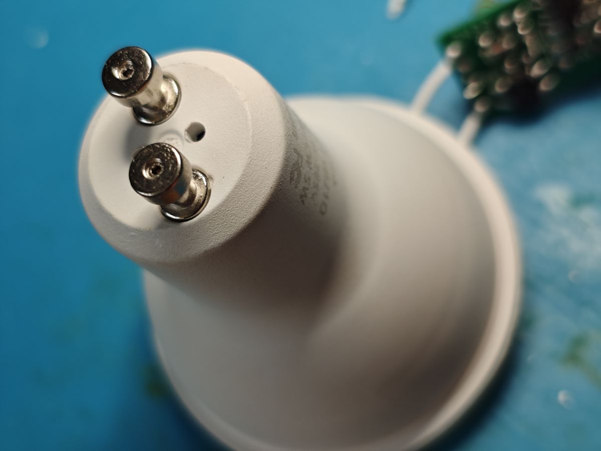

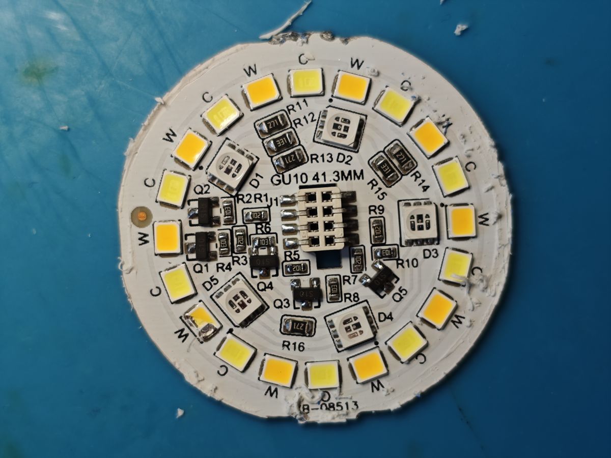

    Lamp ordered from AliExpress:
    https://www.aliexpress.com/item/1005006049460076.html
    Quite easy to pop off the front glass with a small screwdriver.

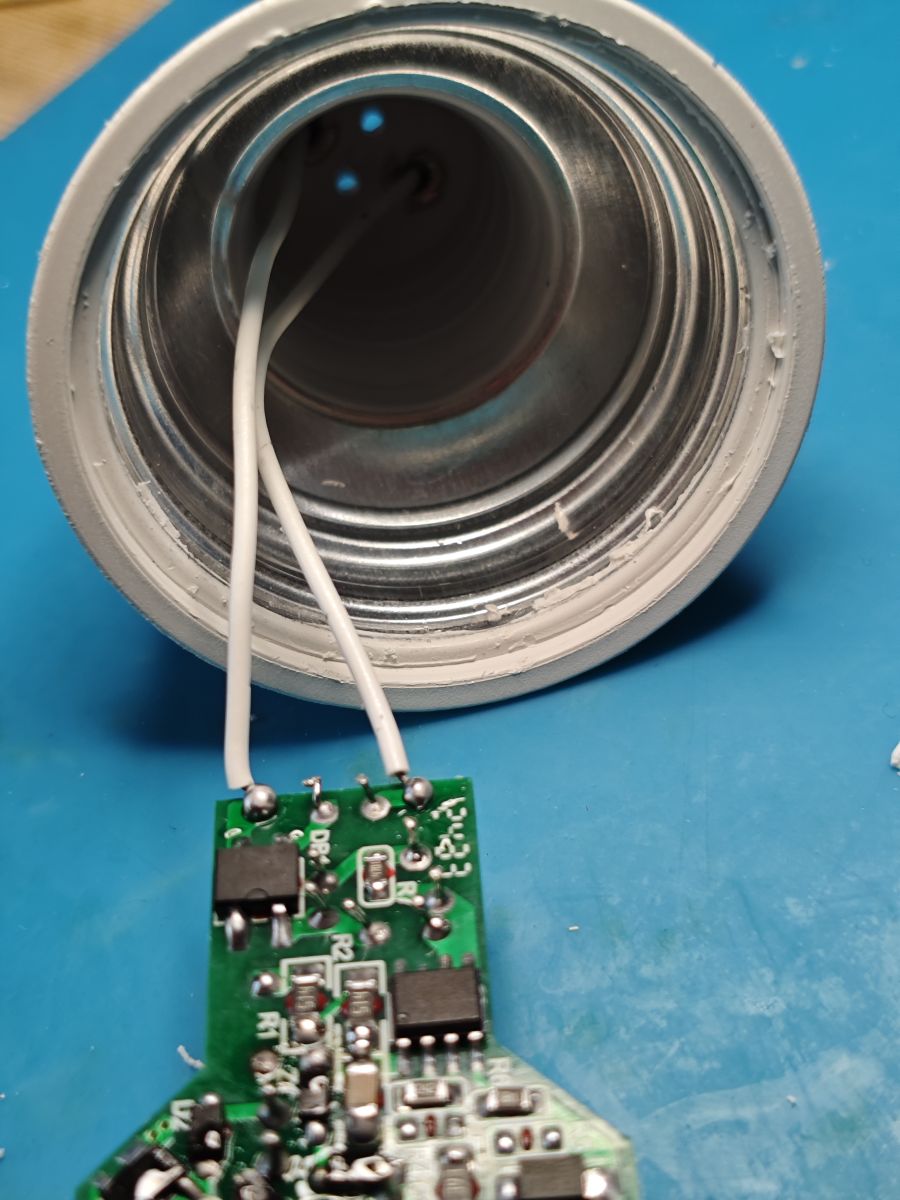

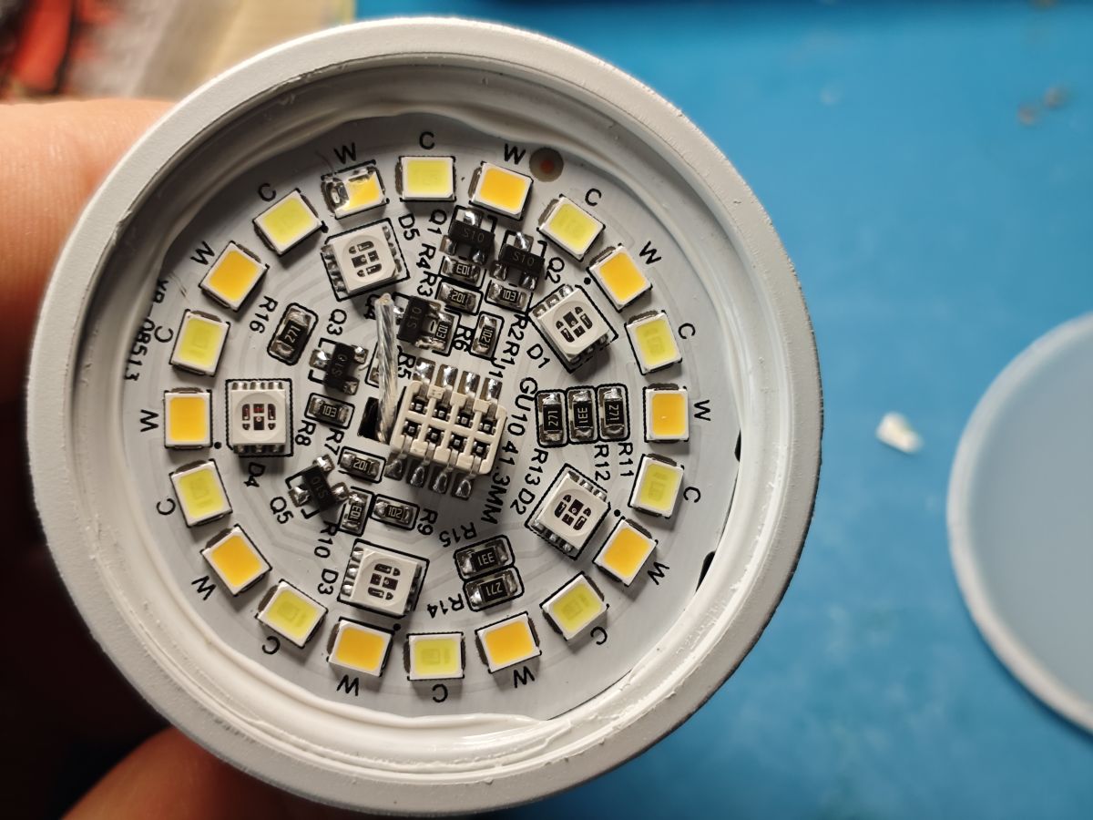

    Also easy to remove the silicone around the LED circuit board and then to pry it out (using a small screwdriver).

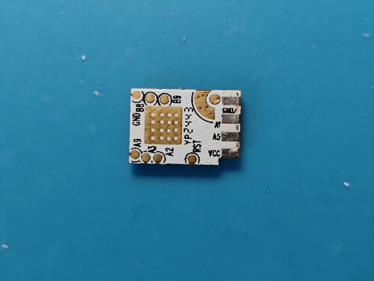

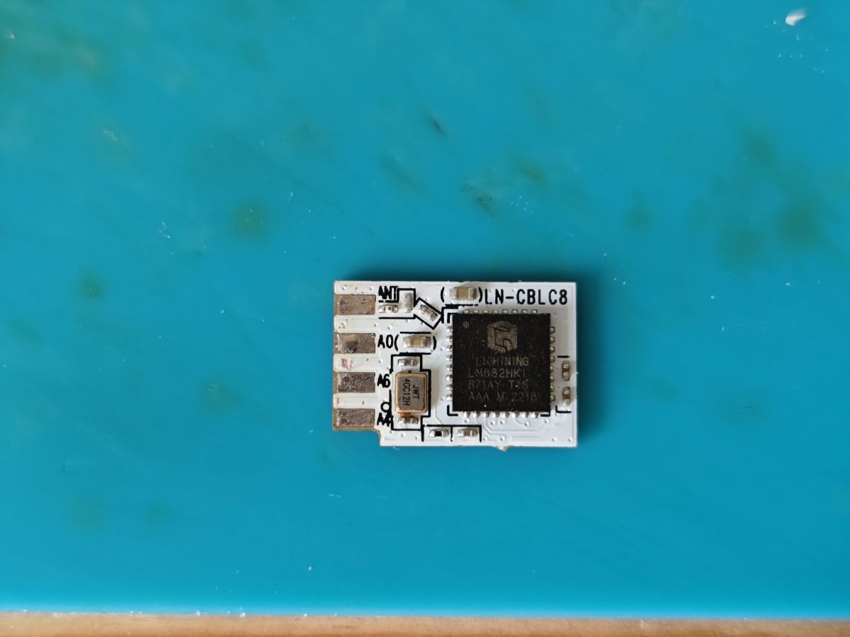

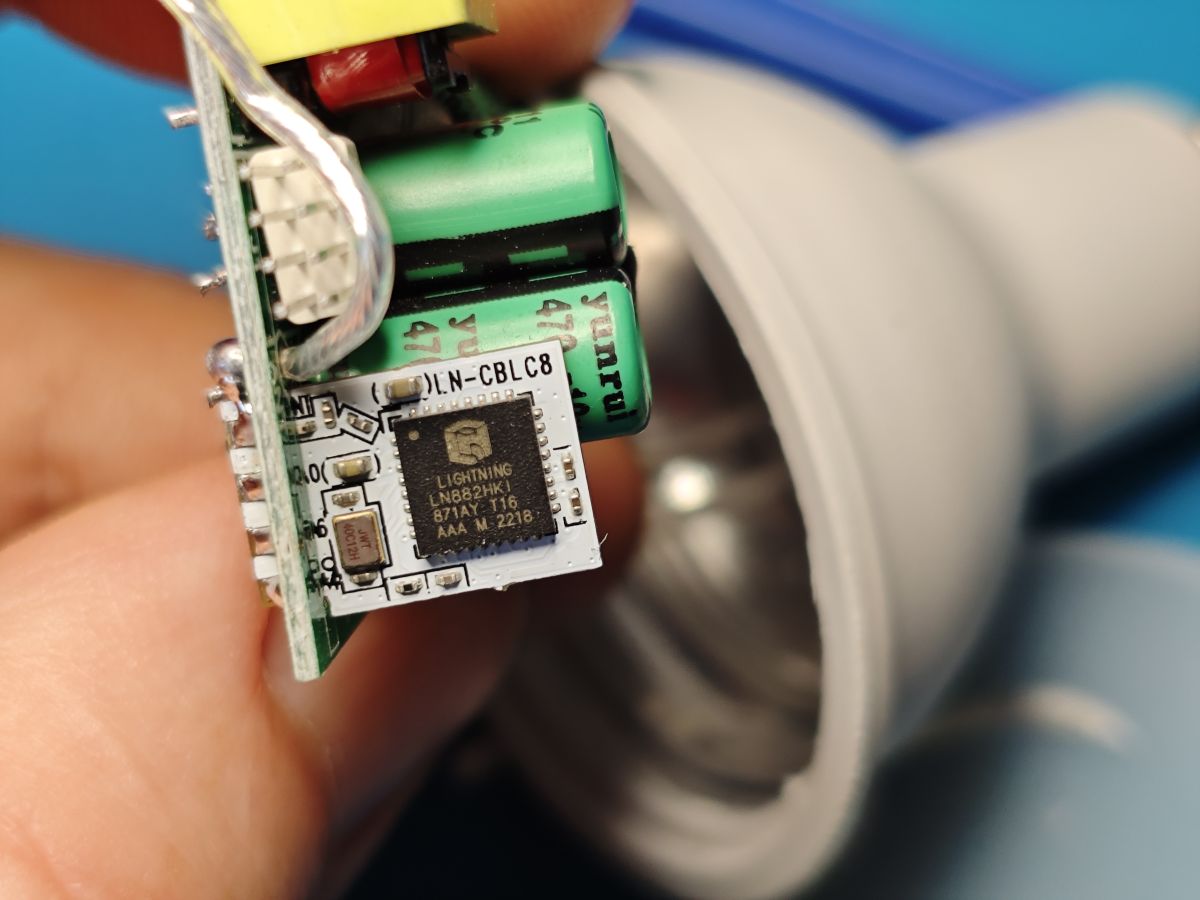

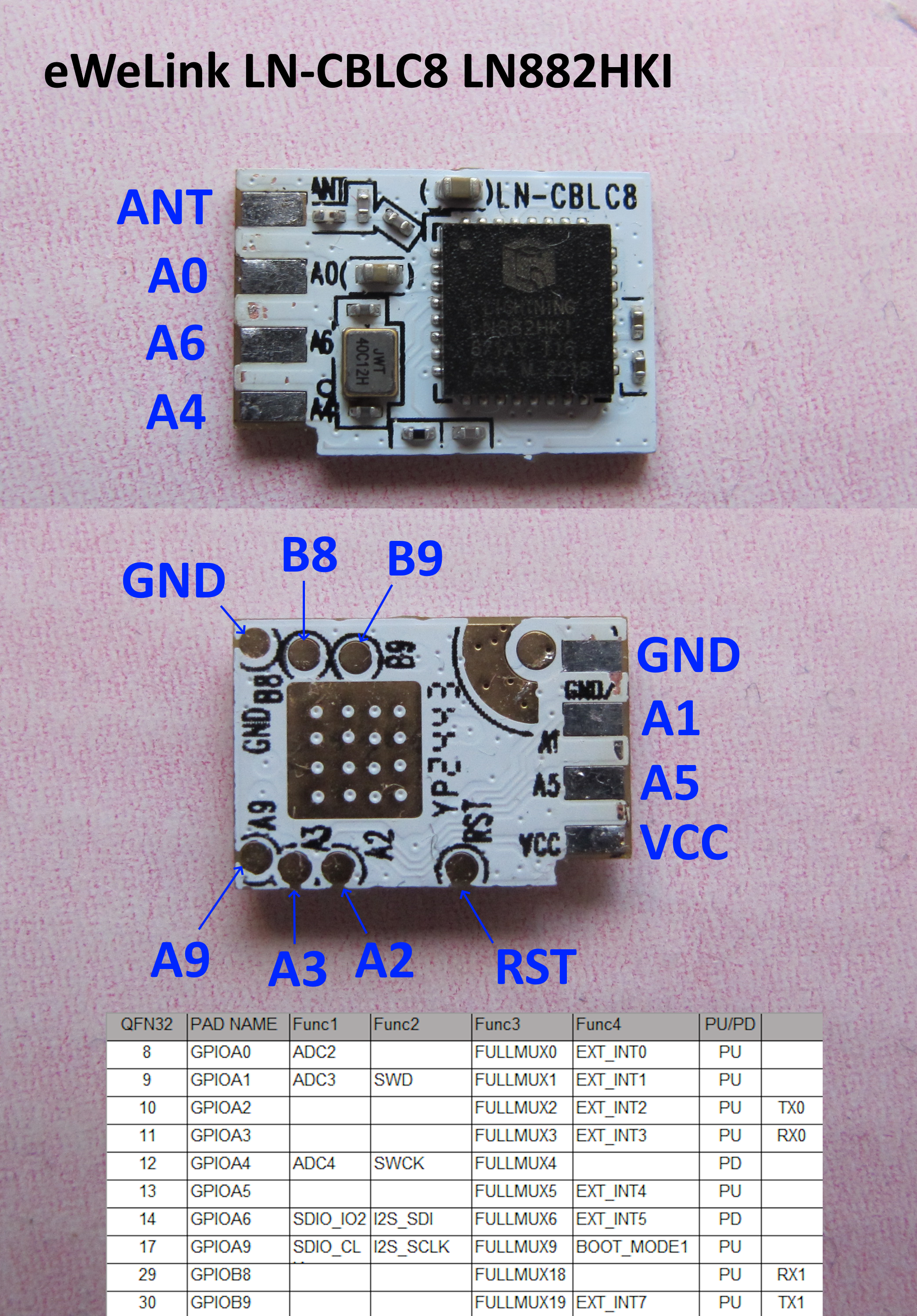

    This device uses a new (?) 8-pin LN882 board, LN-CBLC8, with an external antenna wire.
    Flashed using A9 to GND and RX/TX on A3/A2 (easily flashed from an RPI using /dev/ttyAMA0 and loader.py).
    Seems to work rather well, although with a couple of random hang/reboot issues so far.
    GU10 smart light bulb and packaging labeled Smart Lights on a wooden surface
    PCB with LN-CBLC8 module and LN882H chip removed from GU10 lamp housing

    Do you have any more pics of the module? This might be the first time we can put a module name to these little CBLC5-like LN modules.

  • #4 21760397
    insmod
    Posts: 1397
    Help: 164
    Rate: 436
    >>21760156
    Ewelink, not Tuya.
    It's not CBLC5-compatible
    8 pins, instead of 6 on CBLC5.
  • #5 21760450
    lhakanl
    Posts: 9
    Yes, CBLC8, 8 pins (or rather pads).
    GND, VCC, Antenna and 5 A-pins (used as PWMs in this case).
    Sorry, no other pictures.

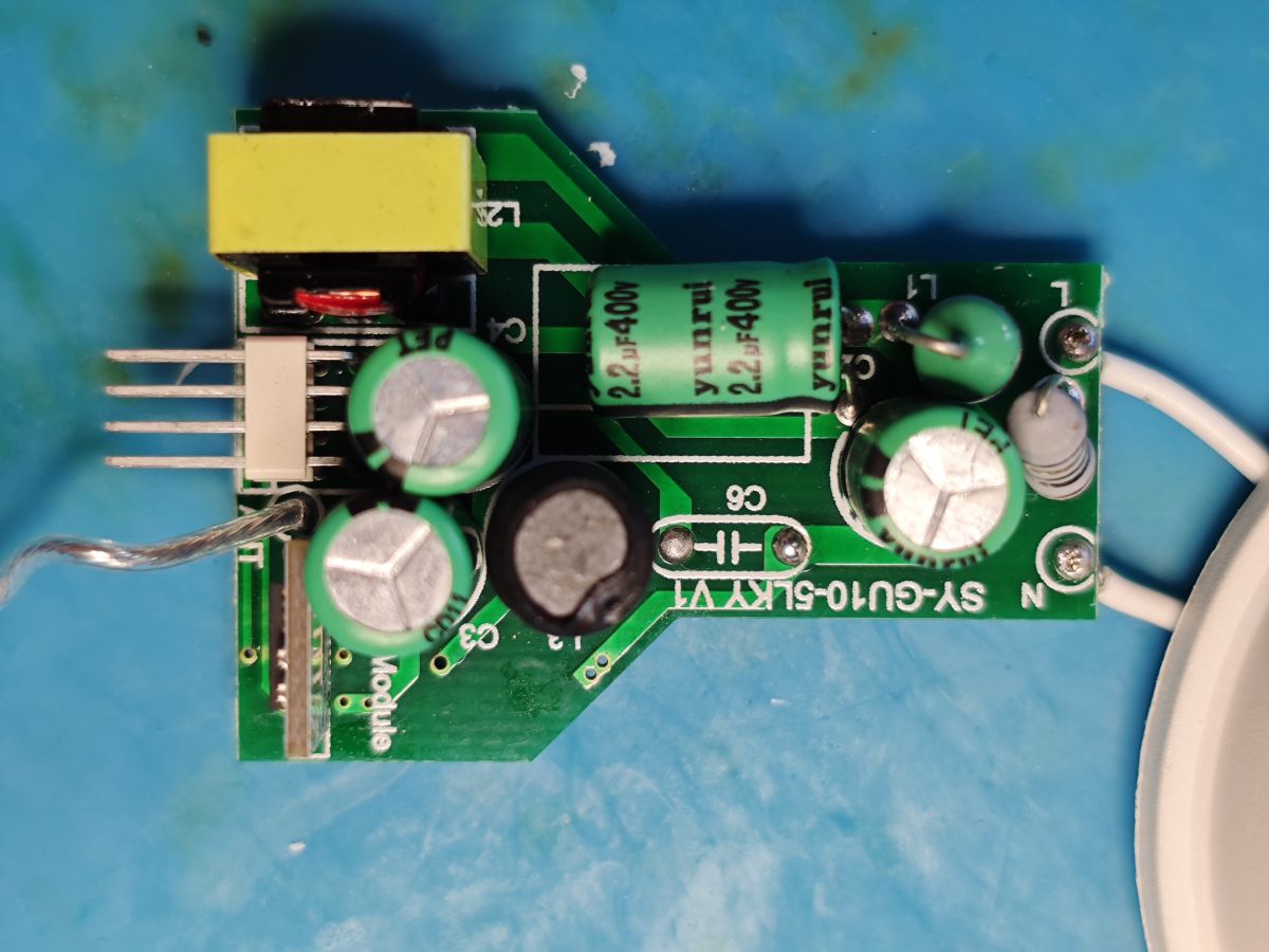

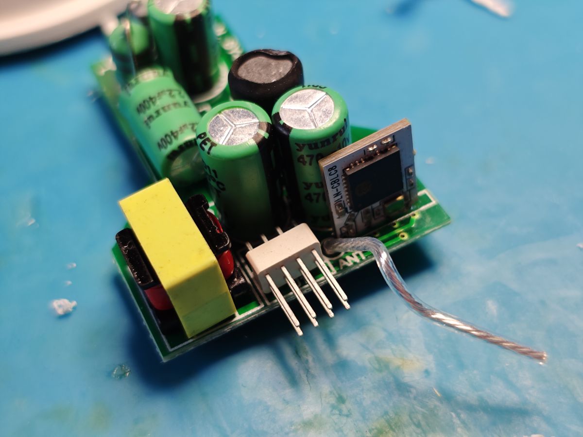

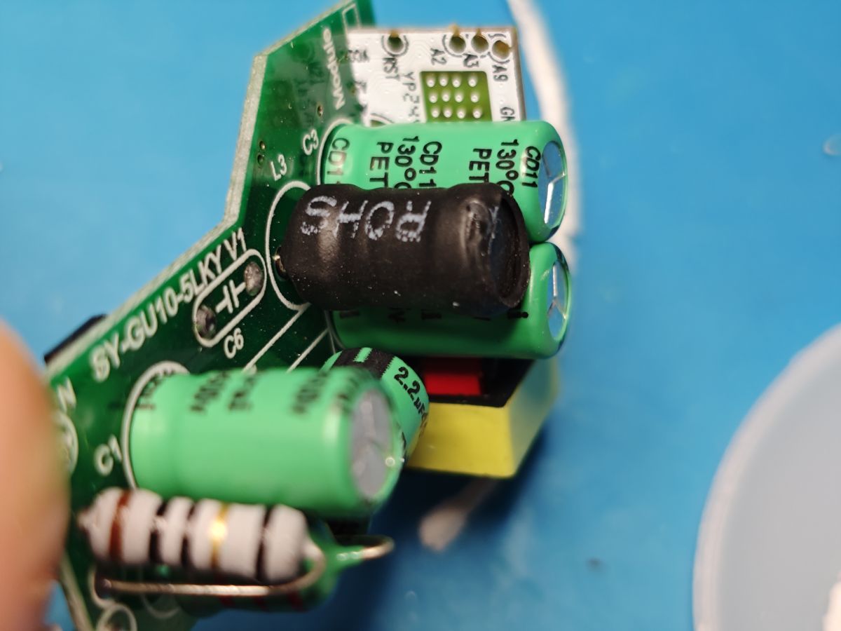

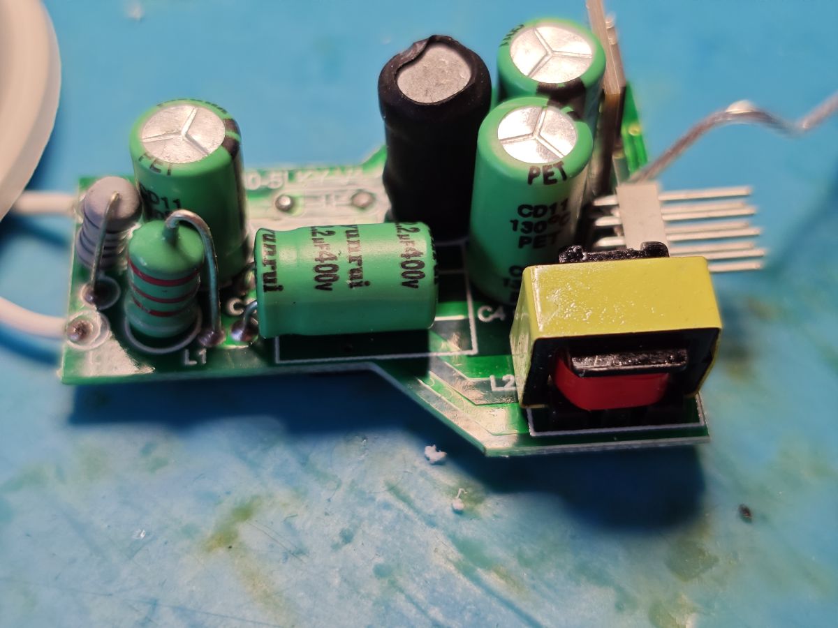

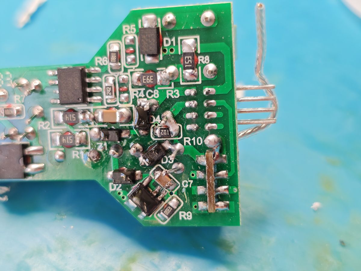

    I bought one

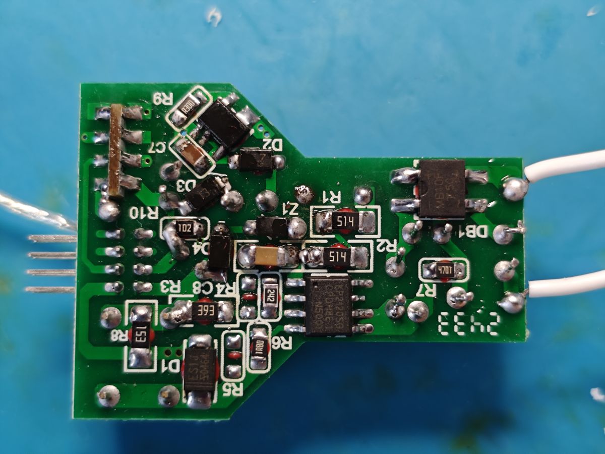

    Label on GU10 smart bulb box with manufacturer details and certifications Label with barcode on EW-GU10-E light bulb box showing WiFi and voltage info. Close-up view of the RGB+C/W smart GU10 bulb PCB with LEDs and SMD components Close-up of a green PCB populated with various electronic components PCB of SY-GU10-5LKY1 bulb with capacitors and a transformer GU10 LED board with C, W, R, G, B channels and visible electronic components Close-up of a PCB with green capacitors, a resistor, and a yellow transformer. Circuit board with capacitors, transformer, and LN-882-GL Wi-Fi module Close-up of LN882H chip on a PCB inside a smart GU10 light bulb PCB board with electronic components, soldering residues, and visible wire connections Close-up of SY-GU10-5LKY V1 PCB with capacitors and resistor LN-CBLC8 module with LN882H chip on a blue background PCB module with pin labels M, A5, VCC, GND on a blue backgroundClose-up of Ewelink SMART GU10 bulb with printed technical specifications. Close-up of a GU10 LED bulb base with metal pins and a small vent hole Inside view of LED bulb with PCB and two white wires soldered to it
    eWeLink LN-CBLC8 module with pin labels and GPIO function mapping
    921600 B9 TX1:
    linking it to here it seems: https://gitee.com/lightningsemi/ln882h/tree/colink_pwm/project/combo_mcu_colink_example

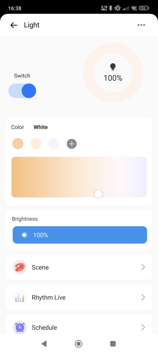

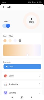

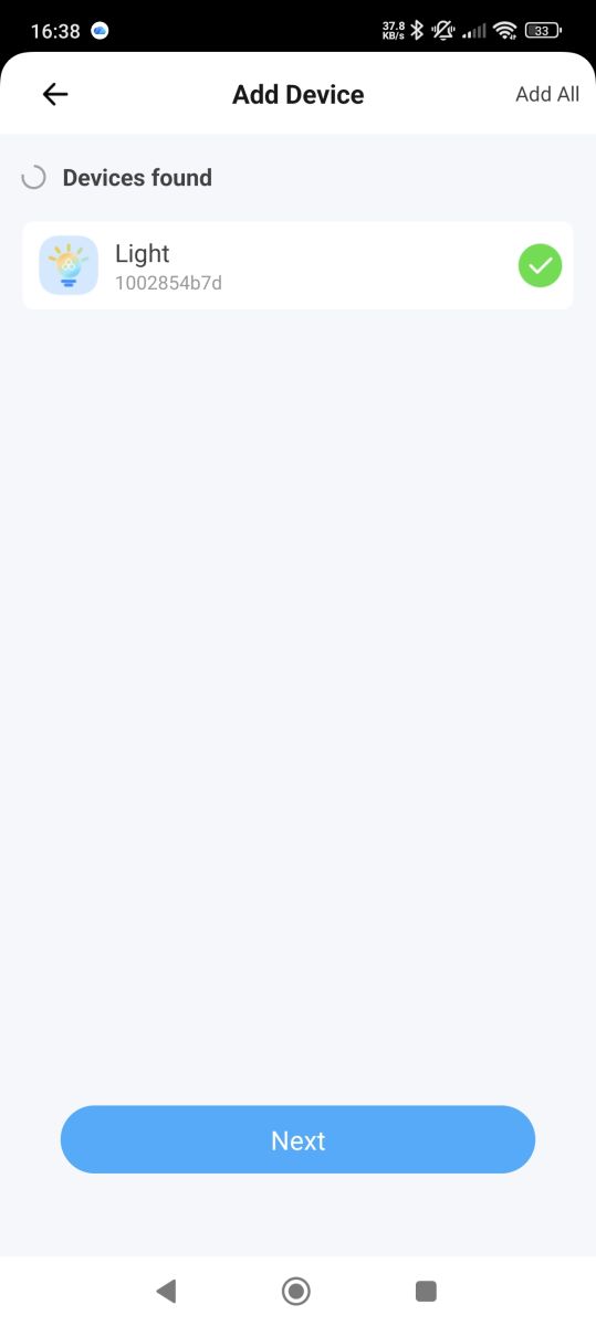

    eWeLink app:
    Add Device screen showing one found bulb named Light with ID 1002854b7d eWeLink app screen with smart bulb turned on and brightness set to 100%
    Keywords:
    XB-08513
    LN-882-GL
    SY-GU10-5LKY V1
    EW-GU10-E
    Ewelink Wifi GU10 5V AC85-265V
    Product name: Smart Bulb Model: 570471
    Manufacturer: Shenzhen New Green Energy Technologies Co Ltd Address:A3-303, Xuexiang Park, Bantian Street, Longgang District, Shenzhen, 518129, China
    Emall:coolo@outlook.com Tel: +8613760160006
    https://github.com/divadiow/FlashDumps/blob/m...ink_GU10_RGBCW_(LN-882-GL)_LN-CBLC8_1.2.9.bin

    A quick observation. At least on my lamp, only 6–7 mm of the antenna cable was visible outside the LED circuit board.
    Pulling it fully out (to about 16–17 mm) has made the Wi-Fi reception much better.
