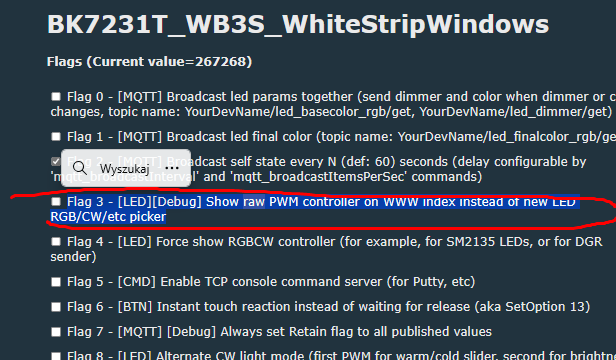

    Please show screenshots from Configure->Configure Module tab, which GPIOs are PWM?
    If you enable this flag (temporary):
    Screenshot of the configuration panel with flag 3 related to PWM highlighted.
    do you get 2 sliders on main panel? Are they working? Which are working and which don't?
    Maybe this device is using alternate CW mode:
    Screenshot showing flag options in module configuration with flag 8 selected for alternate CW mode.
    and you just need to tick flag 8? You can also try it

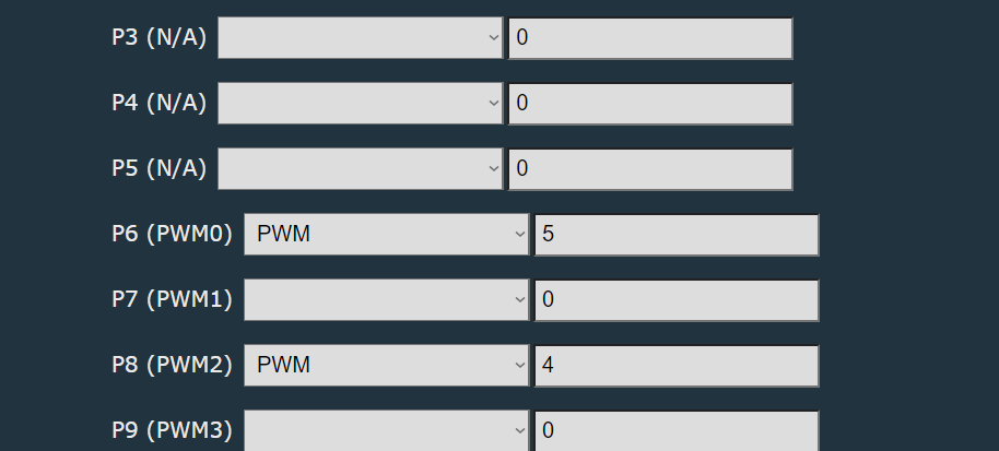

    The module config only has 2 entries:
    Module configuration screen with a list of PWM settings.

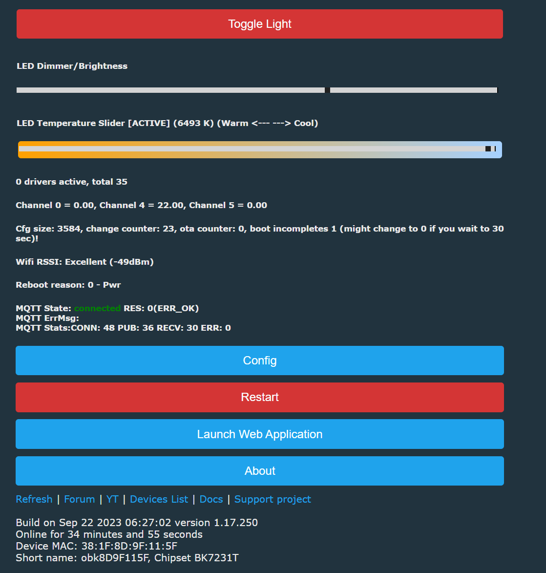

    The 8th flag does nothing. The only option that allows me to control color and brightness is Flag #3. The top slider controls channel 4 - it acts like brightness, and channel 5 acts like color temp. This is already more than the original firmware because I was unable to add this lamp to the Tuya or manufacturers app. I tried bazillion times.
    But the problem is there is no option to turn on and off, so I won't have to change both sliders to the 0 position to turn it off. I would like the device to remember the position/settings the lamp was in. I would like it to always turn on when it gets electricity or, even better, remember the last state.

    This device will work well with OBK. This is what we needed to know:
    tommixoft wrote:
    Flag #3. Top slider controls channel 4 - it acts like brightness, and channel 5 like color temp.
    It means that is using alternate CW mode. Now, you need to:
    - set the alternate CW mode flag, so one PWM controls brightness and second temperature
    - disable "show raw PWMs" flag to get on/off button back
    - check if it's working, if not, try to swap channel with 5, alternatively try to set one slider to channel 0 and second to 1 (or swap them)
    - if you have inverted brightness slider or inverted cool and warm, change the respective PWM role to PWM_n

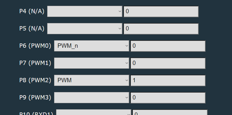

    tommixoft
    It WORKS!! Thanks A LOT!!!
    To people who will come here via Google search, here are the module settings:
    Module settings window with PWM configuration for channels highlighted.
    Also, set Flag #8 to on and #3 to off.
    The problem was auto config from JSON really. It was controlling channel 4 and 5, and needed to be 0 and 1.
