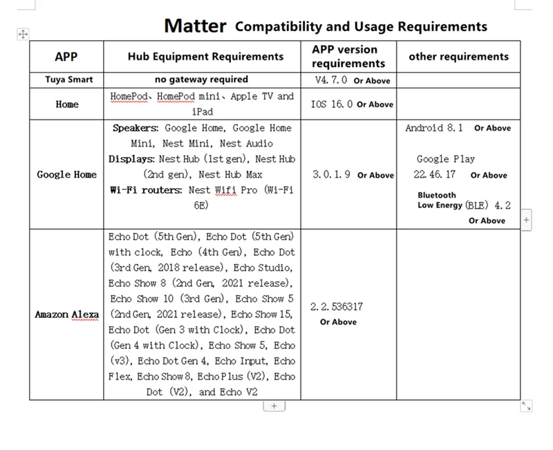

    Hi, so blakadder dumped a firmware from a tuya matter relay device which is using a bk7231n. I thought they might be using the newer tuya chips for matter support, but apparently not.
    Device link -> https://www.aliexpress.com/item/1005005727004823.html
    The image shows a Matter relay switch by Tuya, used for turning lights on and off, compatible with various smart voice assistants.
    Table of compatibility and requirements for Matter.
    Firmware dump:
    nas-sw01w-...tter-w.bin (2 MB)You must be logged in to download this attachment.
    Which brings me to my question if there's any plan to include matter support for future updates with openbk?

    Alexa or Google speakers hub would be a decent choice
    From my test with matter on tasmota:
    RCBCW Light bulb:
    - You can only enable warm/cold light or rgb light, not both. At least for now
    Alexa:
    - Doesn't support multi relay yet (for more than 1 gang switches), if added to alexa, you can only control the 1st relay. Seems to be alexa's limitation of matter
    Google:
    - Has a specific requirement to add device to matter
    https://tasmota.github.io/docs/Matter-with-Google/
