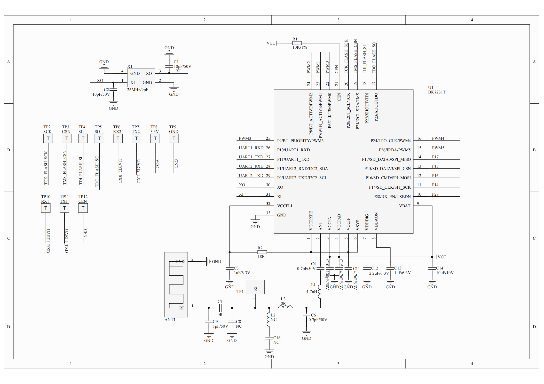

    BK7231 QFN32 Pinout
    Here's the pinout of BK7231 microcontroller:
    Pin configuration diagram of BK7231T chip
    BK7231 pin table:

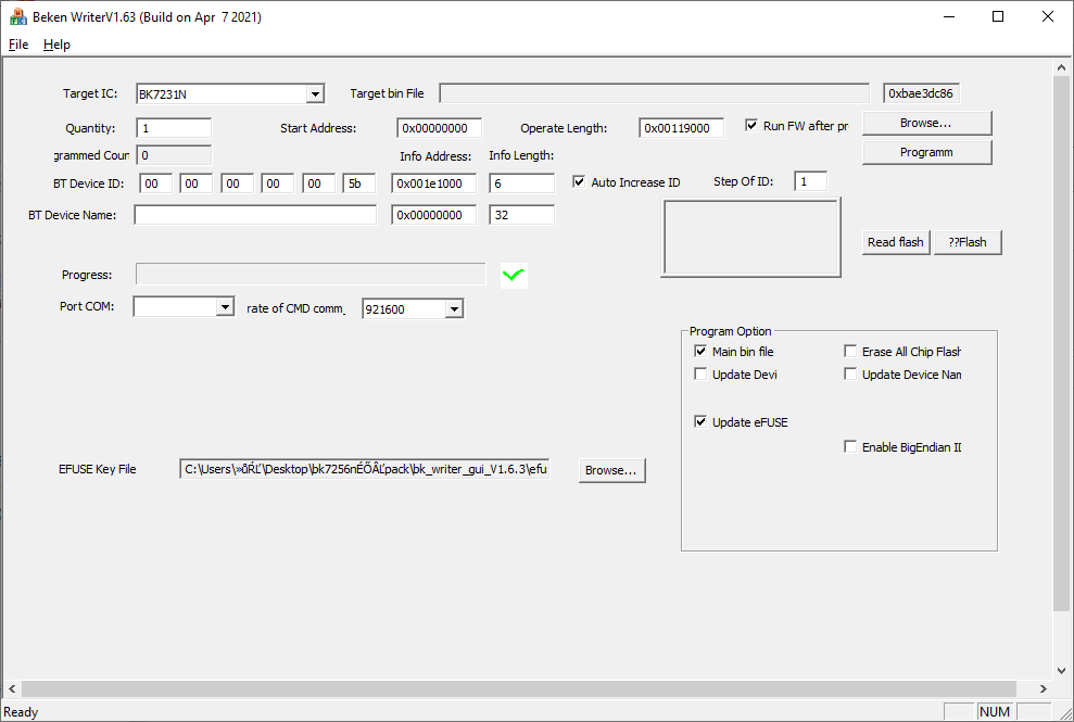

    The preferred simple GUI tool for flashing BK7231T and BK7231N is BK7231 GUI Simple Flasher:
    Scroll down to see full BK7231 GUI Flasher Guide!

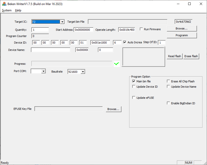

    The old tool for Windows from Beken Corp is bkWriter 1.60:
    https://github.com/openshwprojects/OpenBK7231T/blob/master/bk_writer1.60.zip
    bkWriter 1.60 works well for BK7231T, but it may overwrite your bootloader if you try to write flash memory to address over 0x200000 because of address wrap. Still, it's safe to use it to write OpenBK7231T_UA_* file, as it's smaller than 2MB
    BK7231 datasheet, pinout, programming, specification, wiki (BK7231T, BK7231N)
    The current bkWriter 1.60 usage is following: flash UA (User Area) firmware to offset 0x11000 with operation length no longer than 0x001EF000 (0x00200000-0x00011000).

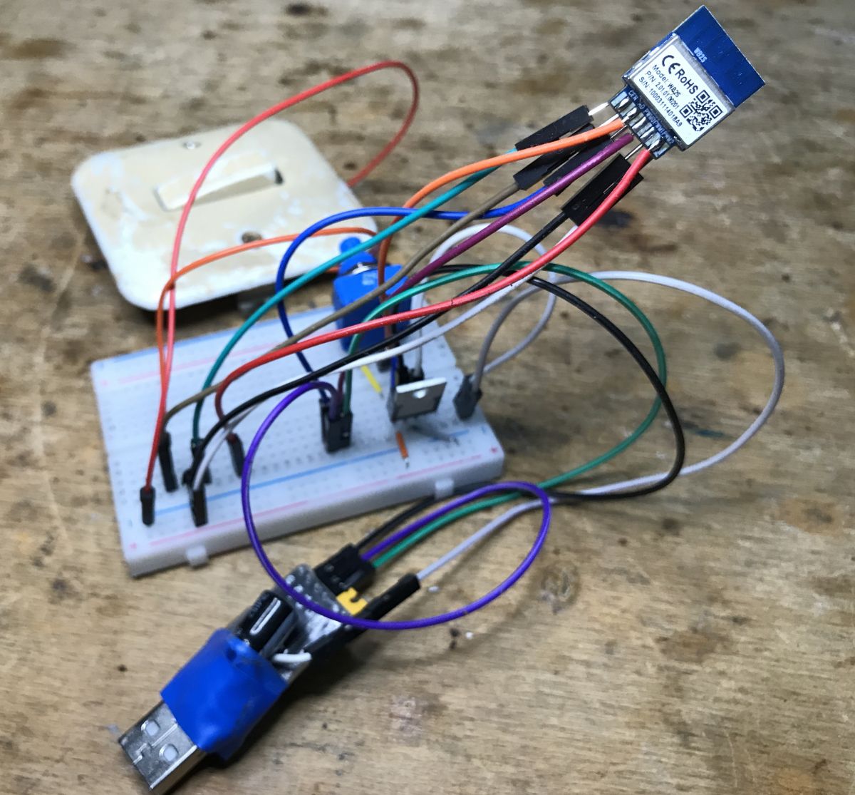

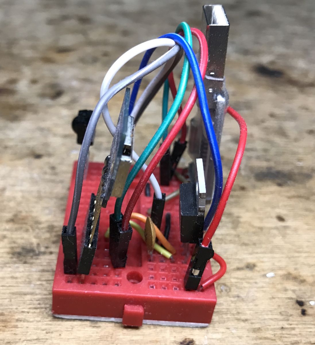

    Example flashing circuit (flashing outside the PCB)
    CB2S/WB2S version:
    WB2L/WB2L_M1 (BK7231N) version:
    WB3S example:
    Entire circuit is powered by 3.3V and 5V would damage it.
    Shorting those two pins select 3.3V voltage levels:
    WARNING: You can't use USB to UART converter 5V/3.3V pins to power circuit. They are used to select voltage levels and don't have enough current capability. That's why we're using external LDO (TC1264 3.3V or AMS1117 3.3V)
    WARNING: If you don't have external USB cable, you can get 5V directly from USB to UART converter USB socket pin, more about that later.

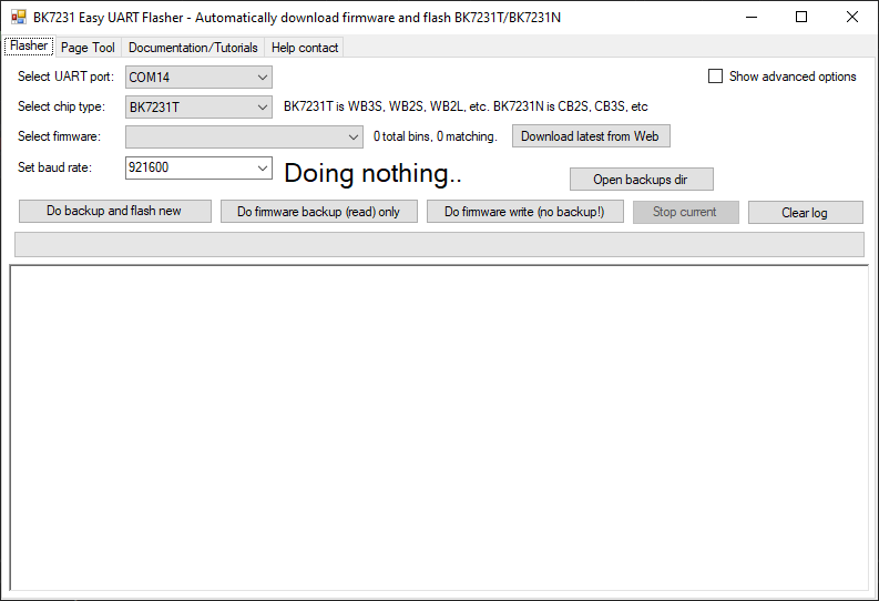

    BK7231 GUI Simple Flasher Usage
    BK7231 GUI Flasher is very simple to use, it can even download latest OBK build automatically. Here's a detailed step by step guide:
    1. Download and unpack executable from Releases tab
    2. Prepare programming circuit for BK7231 (both T and N)
    - get a USB to UART bridge with 3.3V voltage signals
    - connect the Bridge RX to Module TXD1, and Bridge TX to Module RXD1
    - if you want to use CEN RESET method, solder wire to CEN
    - power the device from either the bridge or an external power source. All Beken based modules require 3.3v.
    ⚠️ NEVER try hacking devices while connected to mains power!
    3. Open our flasher:
    4. Select proper platform - BK7231T or BK7231N
    5. Select your COM port of USB to UART converter
    6. Click "Download latest from Web" to get proper binary file
    7. Wait for download to finish
    8. Close download window
    9. Click "Backup and flash new"
    10. When the log window is waiting for "Getting bus", do a device reboot. You can do this in two ways, choose one:
    - Option A: short CEN to GND for 0.25s (it is tricky to get this right, requires precise timing)
    - Option B: power off and on device (of course, it should not be connected to mains, use your own safe 3.3V power supply that can supply enough current)
    11. It will begin reading (it does first backup, then write)
    12. After reading, it will start the new firmware erase
    13. And then, automatically, write:
    14. Done:
    15. Firmware access point show appear now. Connect to it and enter 192.168.4.1 configuration page.
    16. Remember that saved firmware backup is in the "backups" dir
    NOTE: If you're getting CRC mismatch, then it means you've selected from platform (T instead or N, or vice versa):

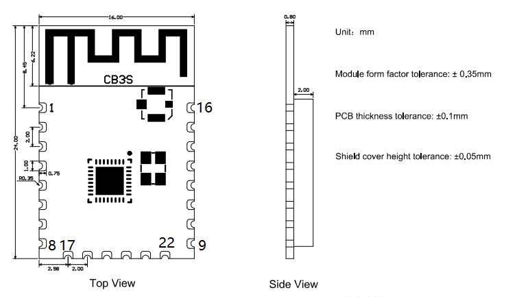

WB3S/CB3S match TYWE3S/ESP-12; WB2S/CB2S match TYWE2S. Swap is possible but OpenBeken already removes cloud lock-in, so replacement is rarely needed [Elektroda, 20396908]
