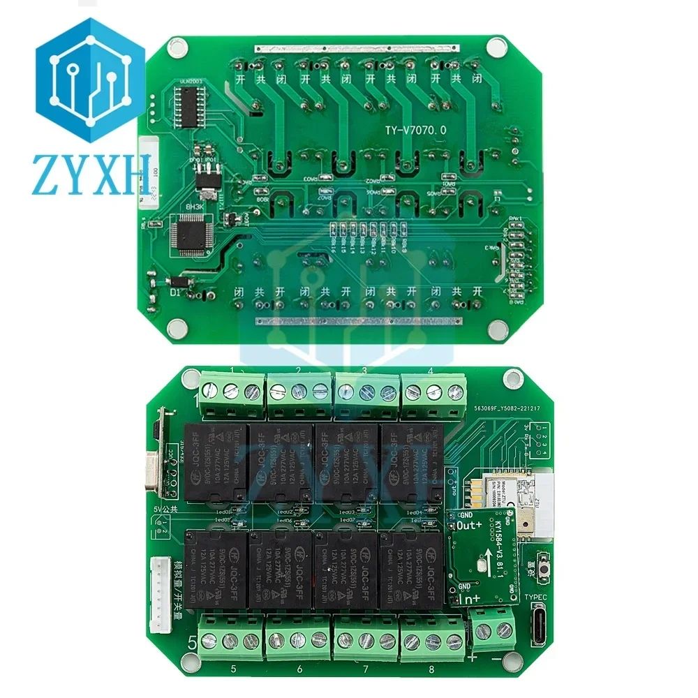

    Next project is this device, a 8 channel smart Tuya switch (Picture is from their website, board looks a bit different now - see below):
    Printed circuit board of an 8-channel smart Tuya switch, front and back view.
    sold as "LLXLJY". Can hopefully be used with OBK. If anyone already has experience with it, pls. let me know. Device should arrive here in a week or so. Can be found here: Link

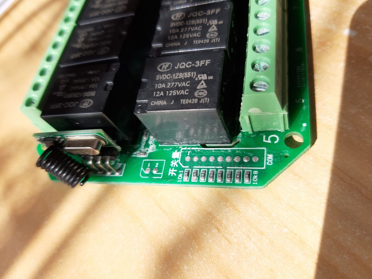

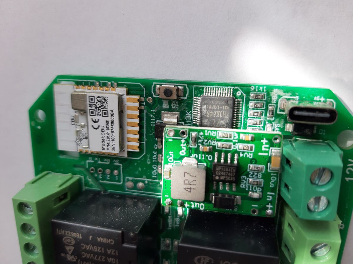

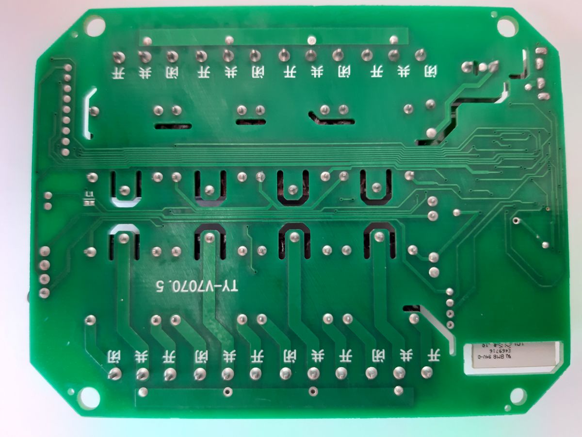

    Arrived. Here are some more detailed pictures. The board layout has changed, now there are no chips on the boards backside:
    Close-up of an 8-channel Tuya smart switch with visible relays and connectors. Close-up of a green circuit board with various electronic components. Tuya switch manual with circuit board in bubble wrap
    View of the backside of the PCB for an 8-channel Tuya switch.

    There is a fair chance that's a TuyaMCU device. If that's the case, the conversion should be relatively easy:
    https://www.elektroda.com/rtvforum/topic4038151.html

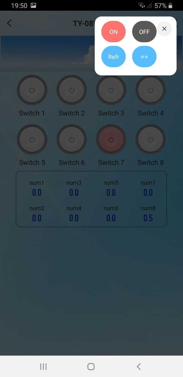

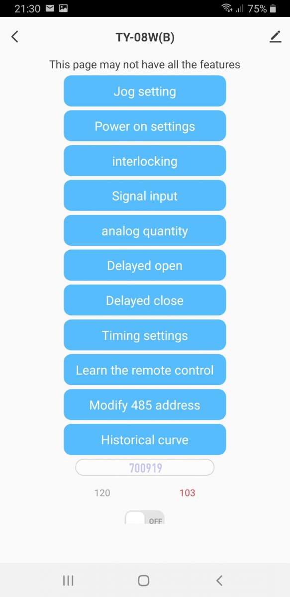

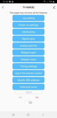

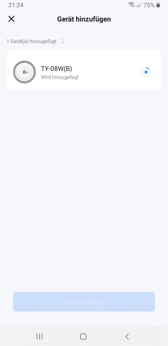

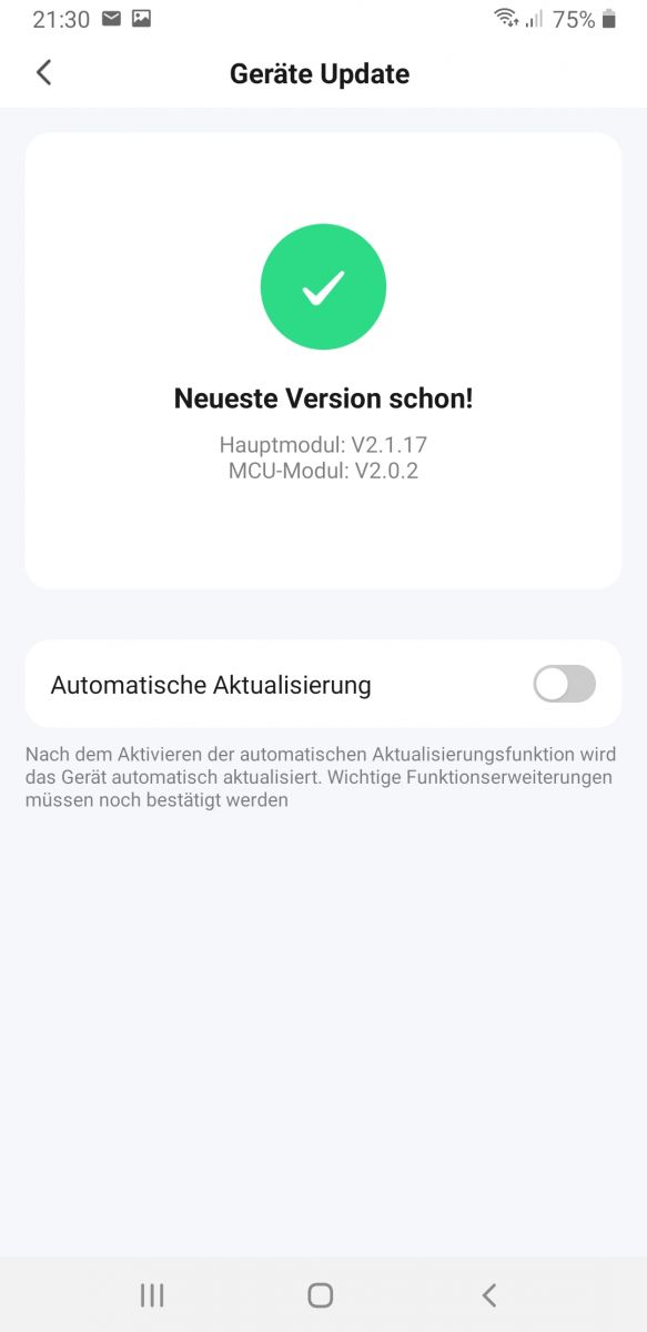

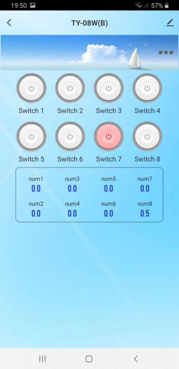

    First some pictures of the functions available in SmartLife-App:
    App screen showing the addition of the device TY-08W(B). Screenshot from the SmartLife-App displaying various functions for the TY-08W(B) device. Screenshot from an app showing a device update with a message indicating the latest version.
    SmartLife app screen with eight switch buttons. SmartLife app screen with eight switches and numerical values.
    To tell from the last picture it's definitly MCU
    To be honest I'm not too sure, if the board does these functions like Jog setting, Interlocking or delayed open/close, or if this is rather controlled via the App. Maybe the board in fact only has relay switching function by WiFi or RF. Would be enough for me, I only want to switch my floor heating valves open or closed.

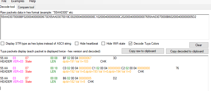

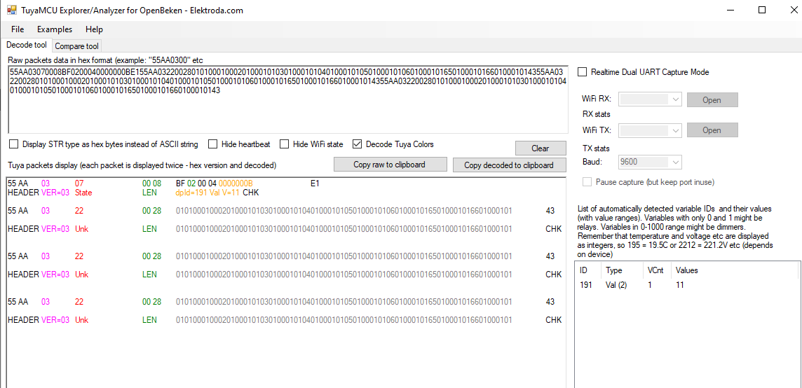

  • Captured TuyaMCU packets after fixing RX/TX mix-up
    #15 21219611
    io2345
    Posts: 273
    Rate: 7
    Can't do the TuyaMCU packets capture. As I wrote in #9 there is power on the RX line of the UART adapter. If I connect it to either CBU's RX or TX, it stops responding to the the App.
    Don't know how to solve that problem.
    EDIT: Solved it (or to be more precise: It wasn't a problem. I only mixed up RX and TX line).
    Now I have two capture files - but not really an idea, what they are going to tell us.
    I did: switch on and off every single relay, did open the settings menu and open there every single entry (without changing values) They are named:
    - jog setting
    - power on settings
    - interlocking
    - signal input
    - analog quantity
    - delayed open
    - delayed close
    - timing settings
    - learn the remote control
    - modify 485 address
    - historical curve
    I think in capture_tx-file one can see the relays being switched on and off in the beginning, right?

    #17 21220533
    Posts: 14756
    Rate: 12883
    Wait a moment... but those files are a single binary blob, so... do you know which dpID corresponds to which Tuya option now?
    We can try to use that and in worst case we will do some guessing, but I usually do separate capture for each function.
    I do this that way:
    1. enable capture
    2. change single relay in tuya
    3. save capture as hex called "toggle_relay1.txt"
    4. repeat points 1, 2, and 3 for each function like relay2, temperature, etc etc

    Some of functionalities like interlock group looks very advanced:
    Screenshot of TuyaMCU Explorer/Analyzer for OpenBeken.
    But toggling relay is very simple:
    55 AA	00	06		00 05	0101000101	0E
    HEADER	VER=00	SetDP		LEN	dpId=1 Bool V=1		CHK
    55 AA	00	23		00 01	01	24
    HEADER	VER=00	Unk		LEN	01	CHK
    55 AA	00	06		00 05	0101000100	0D
    HEADER	VER=00	SetDP		LEN	dpId=1 Bool V=0		CHK
    We could get relays working very fast.
    Not all things are super clear, for example power on setting has multiple dpIDs:
    Screenshot of a Tuya packet decoding tool with data in hexadecimal format.
    Maybe it would be easier to use Tuya API to get dpID meanings:
    https://www.elektroda.com/rtvforum/topic4021129.html

    >>21221908
    After checking all of the captures that I did (maybe half of all options) it might be like this:
    "VM144":40{
       "1":"Switch 1",   Relay 1 (boolean, V=1 or 0)
       "2":"Switch 2",   Relay 2 (boolean, V=1 or 0)
       "3":"Switch 3",   Relay 3 (boolean, V=1 or 0)
       "4":"Switch 4",   Relay 4 (boolean, V=1 or 0)
       "5":"Switch 5",   Relay 5 (boolean, V=1 or 0)
       "6":"Switch 6",   Relay 6 (boolean, V=1 or 0)
       "26":"Fault",
       "101":"Switch 7",   Relay 7 (boolean, V=1 or 0)
       "102":"Switch 8",   Relay 8 (boolean, V=1 or 0)
       "170":"page",
       "171":"Ctrl 1",   set timer (example: V=09-09-24 18:10:33 ON7)
       "172":"Ctrl 2",
       "173":"Ctrl 3",
       "174":"Ctrl 4",
       "175":"Ctrl 5",
       "181":"value",
       "182":"num8",|
       "183":"num7",|
       "184":"num6",|
       "185":"num5",|---> Numerical values under relay buttons (num1 ... num8). value 1 equals 0,1
       "186":"num4",|
       "187":"num3",|
       "188":"num2",|
       "189":"num1",|
       "190":"mode",
       "191":"operate", ->  selecting options:
             Menu2 (Val V=10)
             Interlock, Group on (V=11)
             Interlock, Group off (V=12)
             Refr (V=16)
             Learn the remote control (V=20)
             Jog setting (V=101)
             Power on setting (V=103)
             Historical curve (V=104)
             Signal Input (V=105)
             Interlocking setting (V=108)
             Analog quantity (V=110)
             Delayed open (V=112)
             Delayed close (V=115)
             Timing setting (V=135)
             Modify 485 address (V=137)
       "192":"val1",   -> value(s) on page following selecting item in dpID 191 e.g for "set Interlock" (Val V = number "of channels")
       "193":"val2",   -> value(s) on page following selecting item in dpID 191 e.g. for "set delay open/close" (Val V = time in ms)
       "194":"val3",   -> value(s) on page following selecting item in dpID 191
       "195":"val4",   -> value(s) on page following selecting item in dpID 191
       "197":"Alarm",
       "198":"state",
       "199":"."
    }"undefined"
    I also added two photos in thread #11 to clear up a bit. The last photo shows "menu1", pressing "==" there opens "menu2" (that's photo 2)
    No idea, what the values "num1...8" under the relay buttons mean.

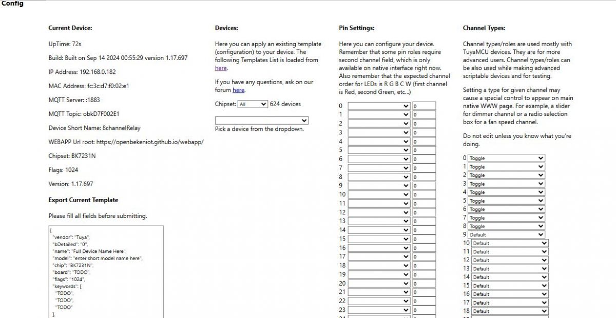

    Now, how can I get the eight relays working? How can I toggle them with MQTT?
  • Baud rate 9600 enables relay turn-on but not off
    #26 21228256
    io2345
    Posts: 273
    Rate: 7
    Did put that in autoexec.bat
    startDriver TuyaMCU
    tuyaMcu_setBaudRate 115200
    tuyaMcu_defWiFiState 4
    setChannelType 1 Toggle
    SetChannelLabel 1 "Room 1"
    setChannelType 2 Toggle
    SetChannelLabel 2 "Room 2"
    setChannelType 3 Toggle
    SetChannelLabel 3 "Room 3"
    setChannelType 4 Toggle
    SetChannelLabel 4 "Room 4"
    setChannelType 5 Toggle
    SetChannelLabel 5 "Room 5"
    setChannelType 6 Toggle
    SetChannelLabel 6 "Room 6"
    setChannelType 7 Toggle
    SetChannelLabel 7 "Room 7"
    setChannelType 8 Toggle
    SetChannelLabel 8 "Room 8"
    linkTuyaMCUOutputToChannel 2 bool 2
    linkTuyaMCUOutputToChannel 3 bool 3
    linkTuyaMCUOutputToChannel 4 bool 4
    linkTuyaMCUOutputToChannel 5 bool 5
    linkTuyaMCUOutputToChannel 6 bool 6
    linkTuyaMCUOutputToChannel 101 bool 7
    linkTuyaMCUOutputToChannel 102 bool 8
    waitFor MQTTState 1
    Now I have controls in the GUI. They change from red to green, as expected.
    Only thing is, that the relays don't turn on. What did I do wrong?

    >>21228330
    Thank you for caring. This is what I get in two minutes time maybe:
    Info:TuyaMCU:ProcessIncoming[v=3]: cmd 34 (Unknown) len 47
    Info:TuyaMCU:ProcessIncoming: unhandled type 34
    Info:TuyaMCU:Received: 55 AA 03 22 00 28 01 01 00 01 00 02 01 00 01 00 03 01 00 01 00 04 01 00 01 00 05 01 00 01 00 06 01 00 01 00 65 01 00 01 00 66 01 00 01 00 3C
    Info:MAIN:Time 206, idle

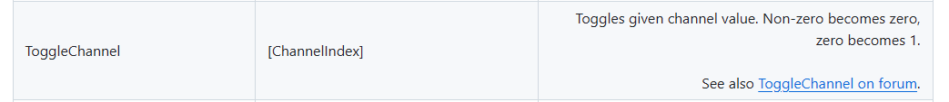

    Ok, so we have communication between the WiFi module and MCU, is that with baud rate 9600 or 115200?
    Next would be to to toggle your channel and observe the log and if possible paste it here. You can do that with ToggleChannel <channel index number> command
    Screenshot of a table with the ToggleChannel command and the ChannelIndex parameter with a description of its function.

    When I use the toggle-command, the color of the control on the webpage alternates red/green. I can also see the commands in the log ("Info:MQTT:Channel has changed! Publishing 0 to channel 2
    Info:CMD:[WebApp Cmd 'ToggleChannel 2' Result] OK
    "), but relay does not switch off nor the LED indicator.
    Here is a screenshot of the configpage:
    Screenshot of IoT device configuration page with device information, pin settings, and channel types.
