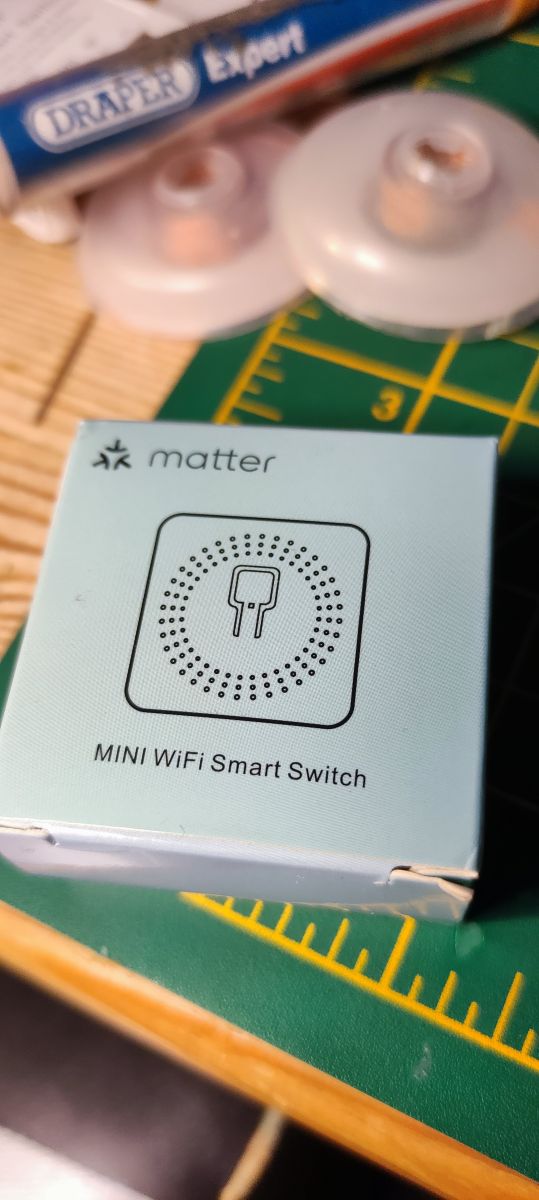

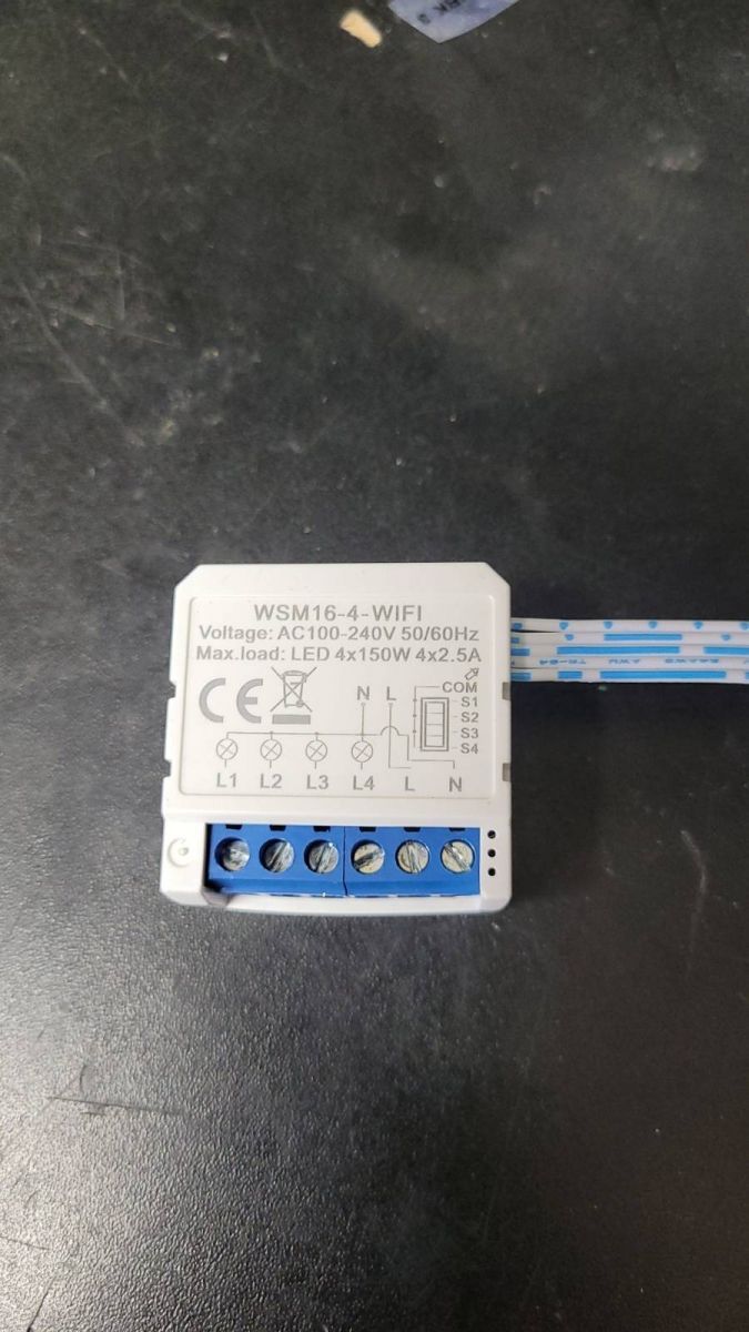

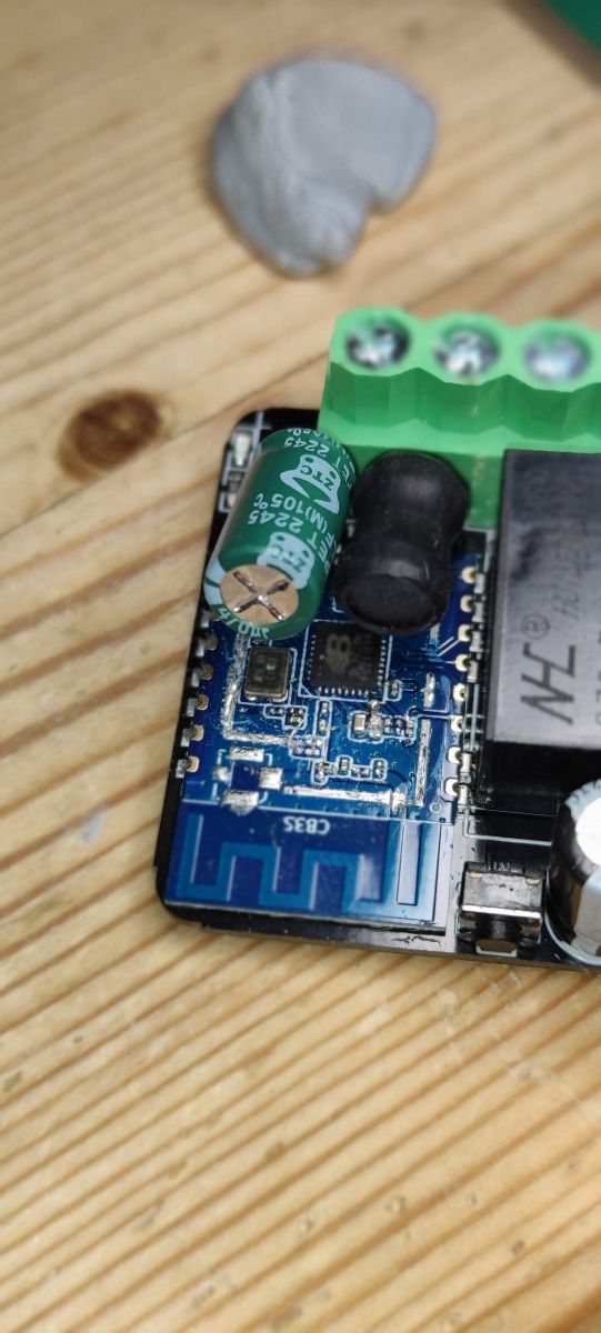

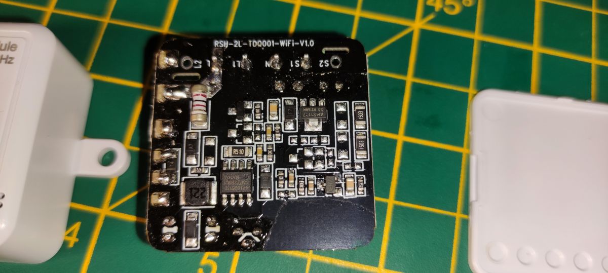

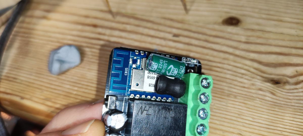

  • I grabbed this from Ali to have a play. https://www.aliexpress.com/item/1005006155824101.html
    Image of an AliExpress product page showing the Matter1CH switch module.
    It comes with a CB3S module which is BK7231N.

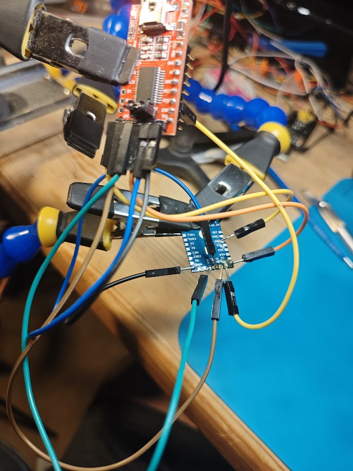

    The VCC was just about accessible with a pin, so no soldering.

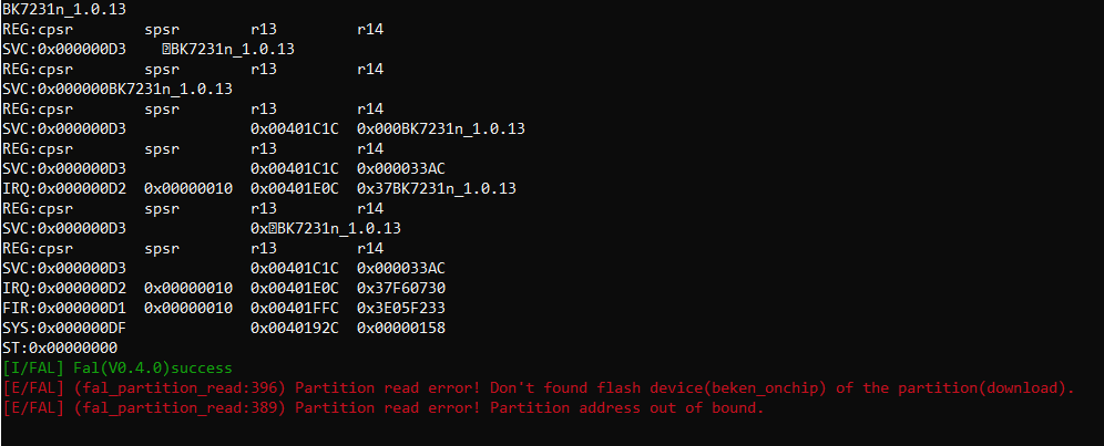

    Short boot log:
    BK7231n_1.0.13
    REG:cpsr        spsr        r13         r14
    SVC:0x000000D3              0x00401C1C  0x000033AC
    IRQ:0x000000D2  0x00000010  0x00401E0C  0x37A60330
    FIR:0x000000D1  0x00000010  0x00401FFC  0x7A05E227
    SYS:0x000000DF              0x0040192C  0x00000158
    ST:0x00000000
    [I/FAL] Fal(V0.4.0)success
    go os_addr(0x10000)..........

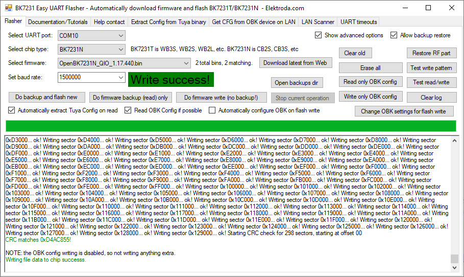

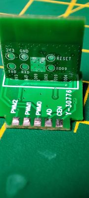

    Assuming the CB3S module was standard hardware I used BKflasher to dump the factory firmware, attached. I also took a small risk and flashed OBK to the module to see if it would boot up with an AP, as expected with any non-Matter BK device, but sadly not. I was able to flash it back to factory though and it worked again.
    Will OBK not working be because of some other partition differences? The RF partition? Should I try "Restore RF part" in the easy flasher?
    Will OBK support Matter one day? Does it need to? I know there's a lot of other development, so maybe low priority.

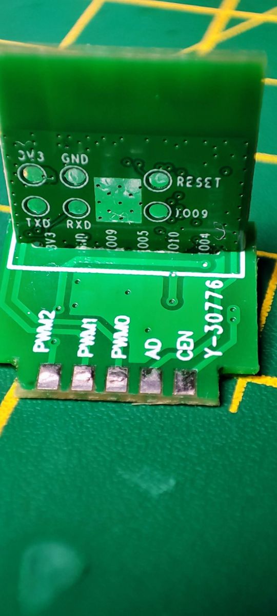

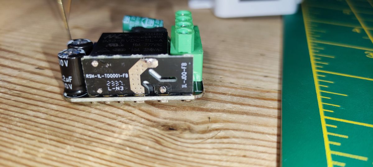

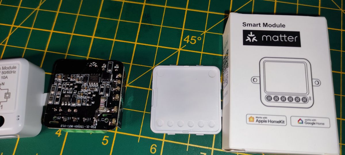

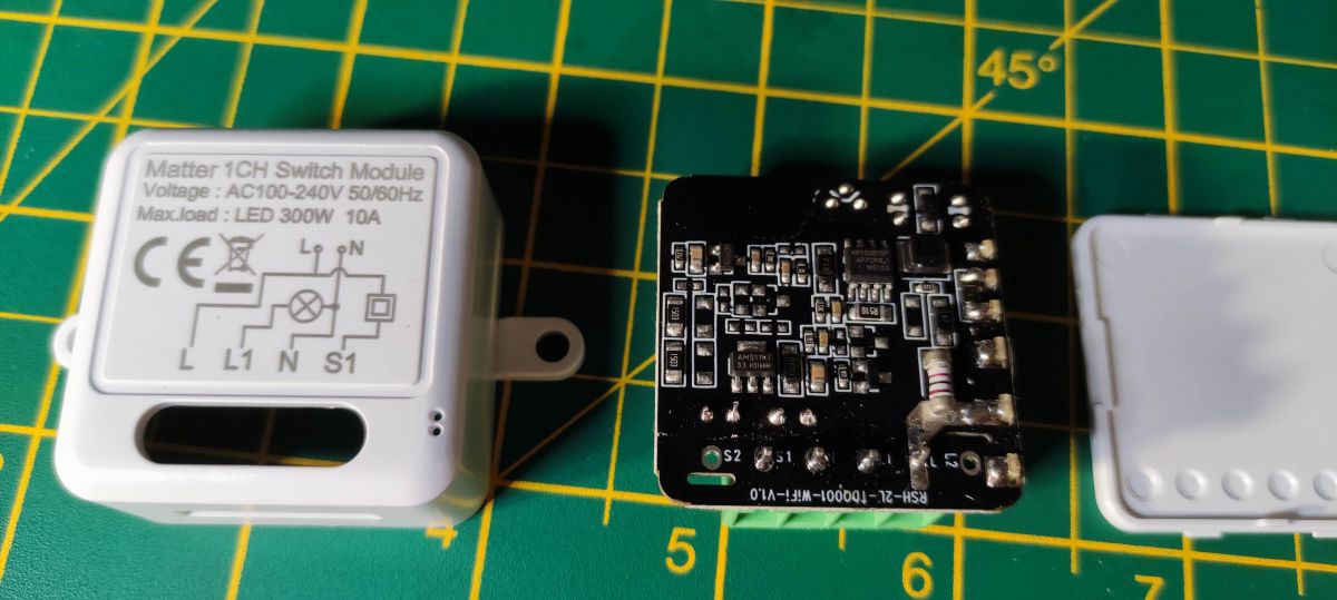

    Anyway, here are some more pics

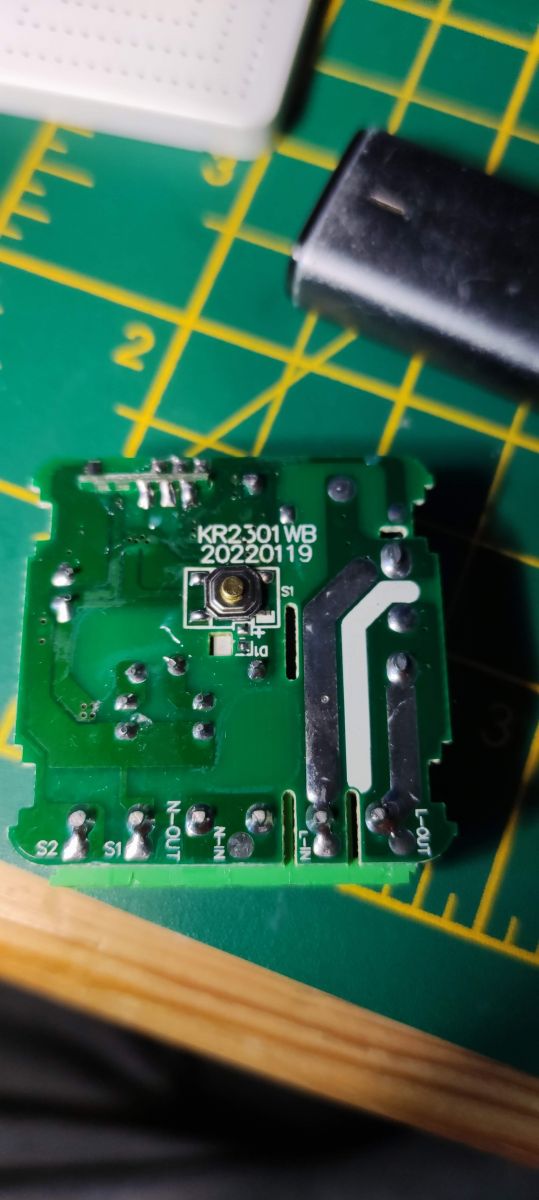

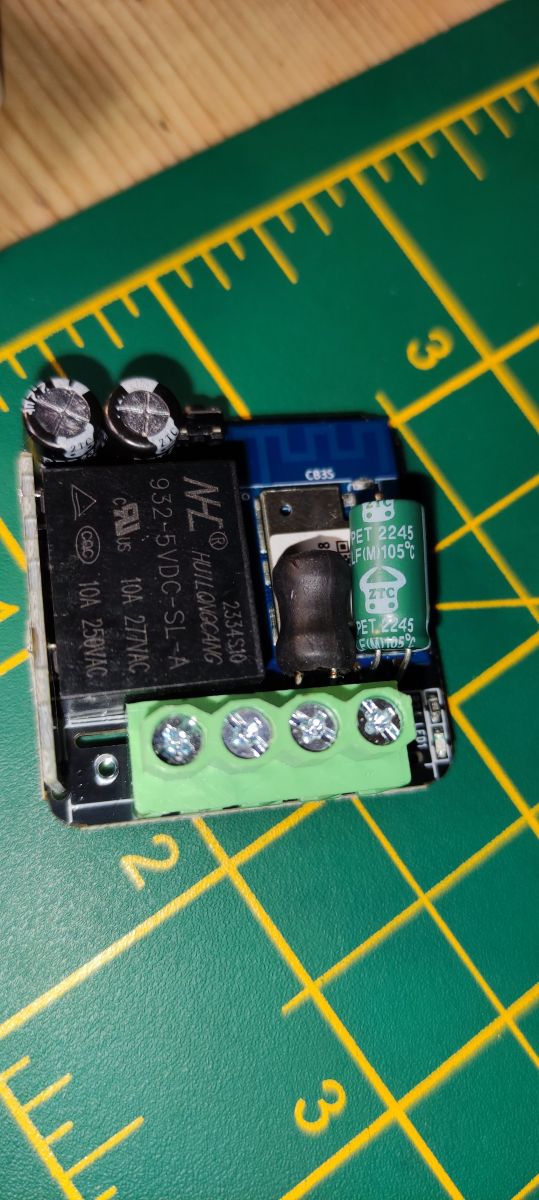

    Matter 1CH switch module next to an open casing with a visible electronic board on a green measurement mat. Electronic module with visible components labeled RSH-2L-TDQ001-WiFi-V1.0 Close-up of a PCB with various electronic components, including a KP16051SF chip. Smart module with casing and box. CB3S module with electronic components on a green mat. Electronic module with a green terminal block and a black relay. Relay module on a wooden surface. CB3S electronic module mounted on a board with other components. Confirmation of Uascent smart plug connection with Alexa account.

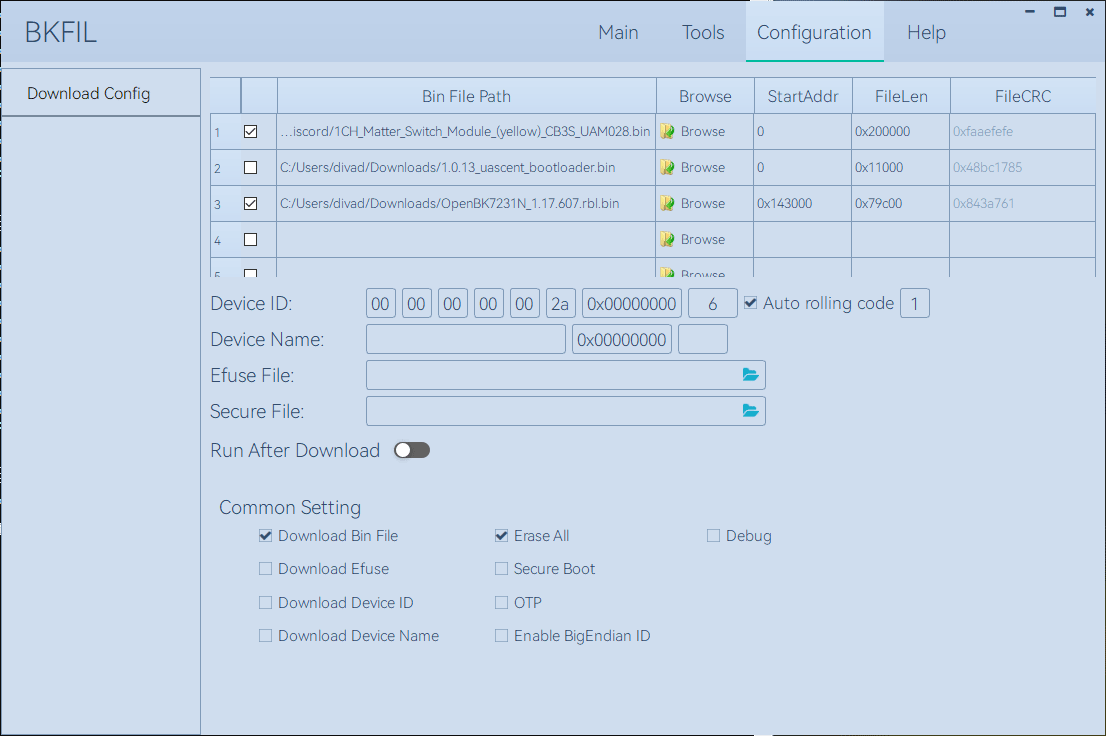

    Screen of BK7231 Easy UART Flasher app showing successful write process.

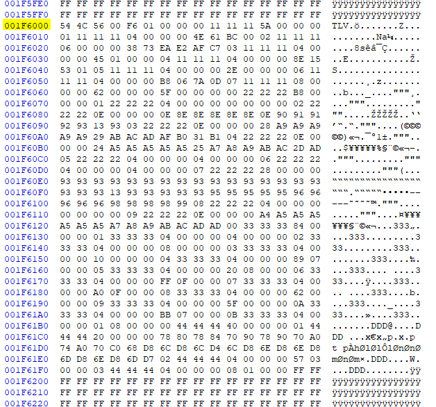

    • CB3S_uHome_Matter_1CH_White_UAM028_SPI.bin (2 MB) You must be logged in to download this attachment.
    • readResult_BK7231N_QIO_2024-02-2-07-08-02.bin (2 MB) You must be logged in to download this attachment.

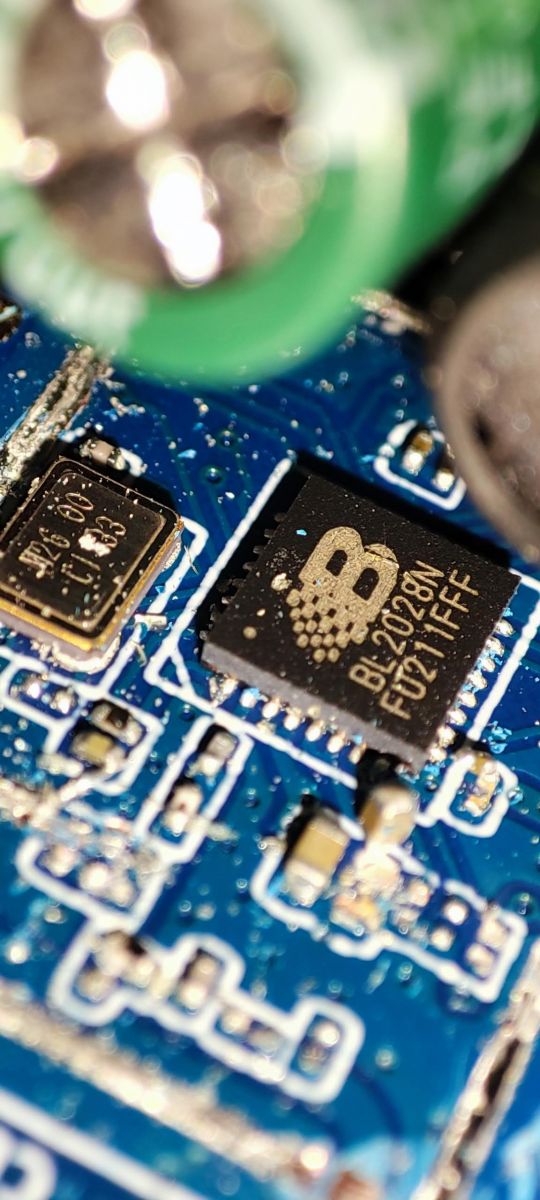

  • Shield removal revealed a BL2028N chip
    #3 20940846
    Posts: 5208
    Help: 446
    Rate: 914
    interesting. I had not heard of BK7231M. After spending ages flashing various CB3S and other BK7231N firmware, and even the BK7231M firmware from https://www.elektroda.com/rtvforum/topic4017870.html#20837165
    I did not get any output from TX uart log with any combination, not even OBK :( At most I got was 2 squares with a question mark in them. This didnt change with baud rates or retries.
    Finally, I tried to heat up the shield over the chip to see if I could get the whole thing to a temperature where the solder holding it in place melted. I do not have a hot air gun. I gave up and used a blade to slice into the solder. I got it off. It's a BL2028N!
    Close-up of a BL2028N integrated circuit on a blue printed circuit board. Electronic circuit board with components on a wooden surface.
    So I'm no further forward getting a non-factory firmware working but I'll keep playing. Flashing from another BK7231N factory firmware to OBK does not seem to make a difference. No sign of the device in the Tuya/Cozylife/Smart Life apps with any Tuya firmwares.

    That's very strange, BL2028N is known to work with OpenBeken. Have you tried flashing whole 2MB of dump from a working OBK device or a flashable Tuya device?
    I would say that it has to work, because otherwise, it would mean that there is some kind of extra strange difference between your BL2028N and the old BL2028N's which worked with OBK, and that would be very.... strange.

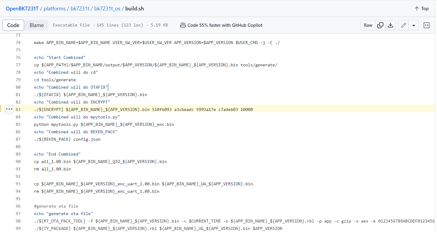

    I have some BK7231M devices sent by a user. Currently I've checked the dumps and they seem to have changed encryption keys, so the solution would be to build OBK with a correct keys:
    Snippet of the build.sh script for the OpenBK7231T platform with encryption-related lines.

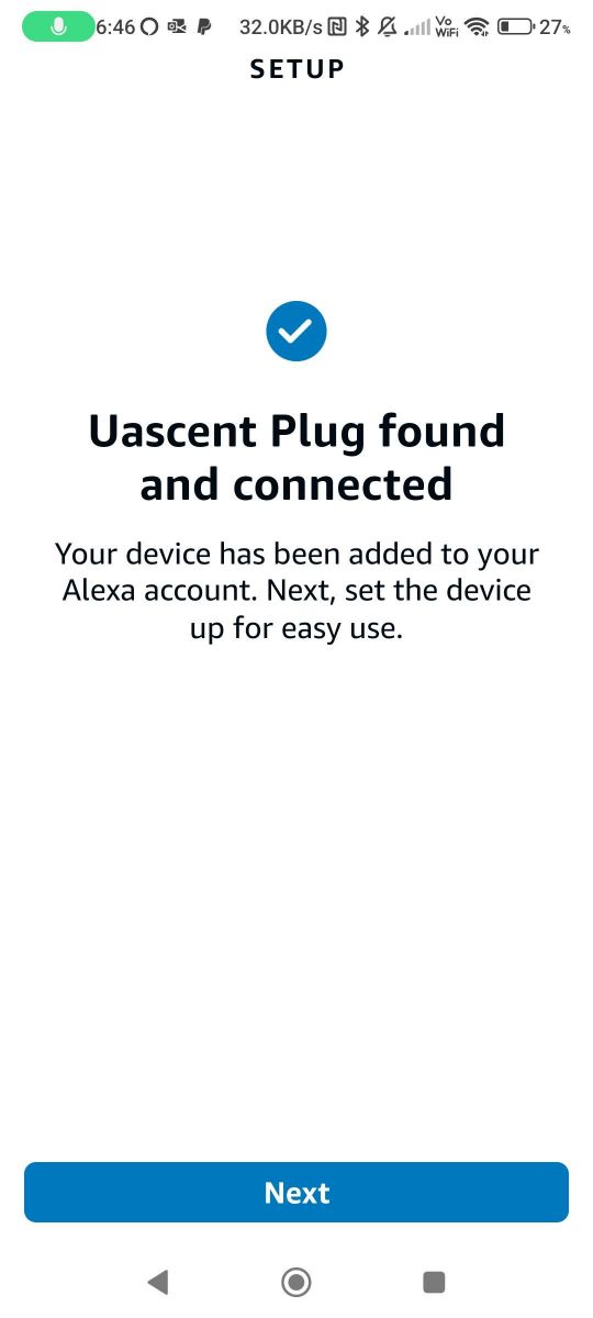

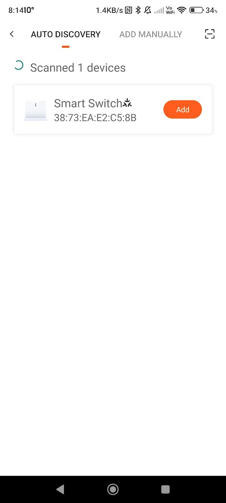

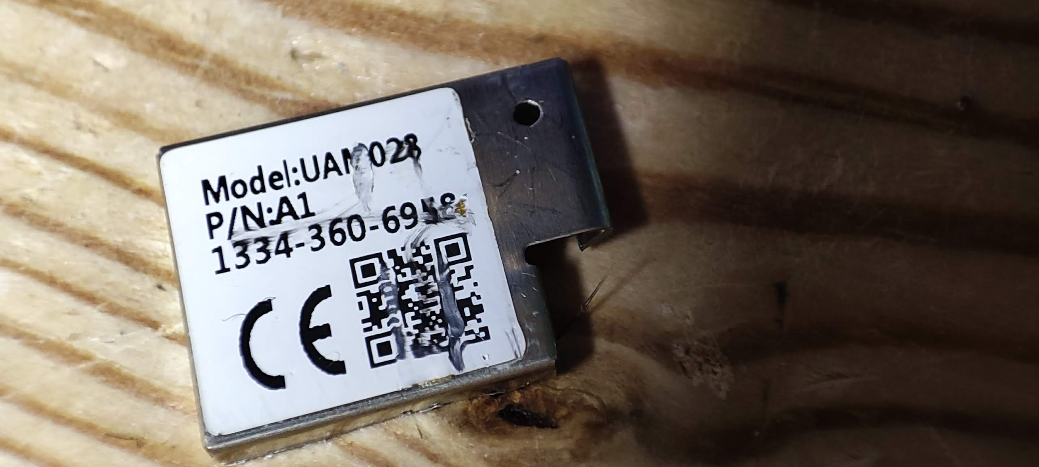

    to add the public discourse the shield over the Belon has these markings - UAM028
    Metal label with model UAM028 marking, P/N: A1 code, and number 1334-360-6918. A QR code and CE symbol are also visible.
    which suggests these are not Tuya, but uHome.

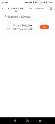

    In fact Uascent in the device name says as much - https://play.google.com/store/apps/details?id=cn.com.uascent.iHome&hl=en&gl=US
    uHome+ app
    uHome+ app interface showing a scanned Smart Switch device.

    What is the MAC address of this device?
    Added after 24 [seconds]:
    EDIT: Wait it seems you posted the reply on the screenshot while I was posting my question
  • #11 20942216
    Posts: 5208
    Help: 446
    Rate: 914
    ha. thought you'd gone mad
    38:73:EA:E2:C5:8B yes

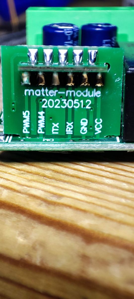

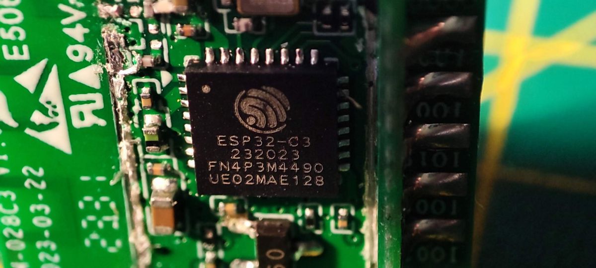

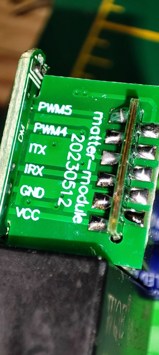

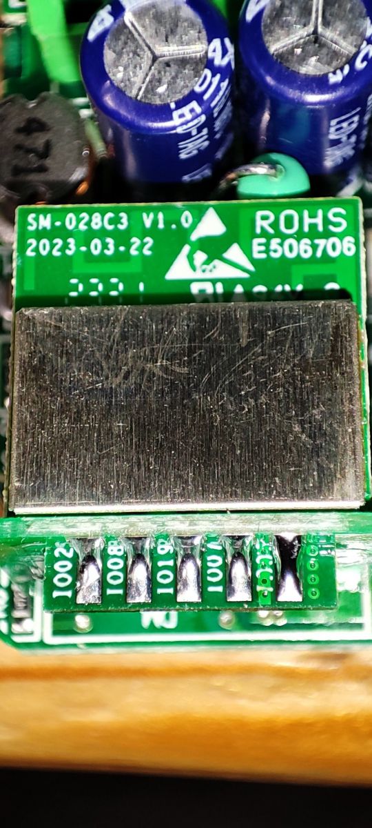

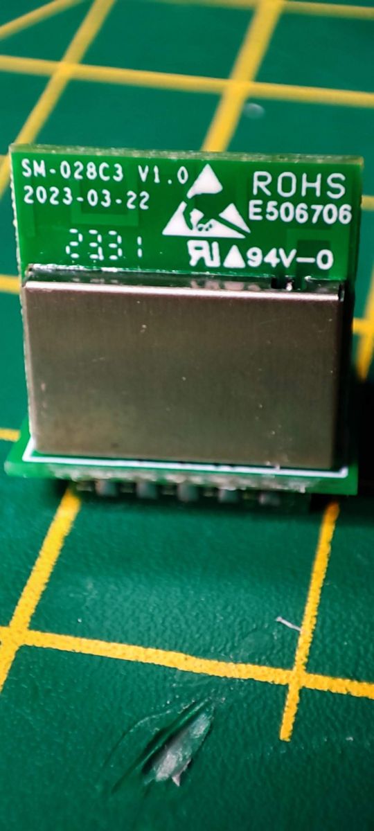

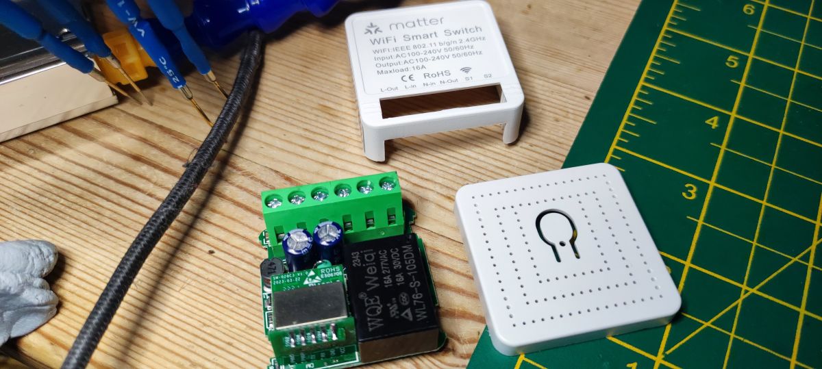

    I picked up another Matter device. The familiar 16A mini switch. To my surprise this one comes with an ESP32-C3 chip on module SM-028C3 on a little riser. I can only find this in relation to that module model:
    Presentation board with SM-028C3 modules on display.
    some internals:
    Close-up of a green circuit board with labels: PWM5, PWM4, ITX, IRX, GND, VCC, and the text matter_module 20230512. SM-028C3 electronic module with ESP32-C3 chip on a carrier board with visible connectors. Opened Matter WiFi Smart Switch device with visible ESP32-C3 board. Close-up of a small electronic module labeled matter-module 2023051.2 with terminals marked PWM5, PWM4, TX, RX, GND, VCC. Close-up of a circuit board of a mini switch with markings and connectors. SM-028C3 module with ESP32-C3 chip on a green PCB with markings. Close-up of an ESP32-C3 chip on an SM-028C3 module. Image of a green printed circuit board with various connectors and labels. Box labeled Matter MINI WiFi Smart Switch on a green mat background.
    Sadly, I suspect it's like this device, with Secure Boot enabled so no flashing even Tasmota :(

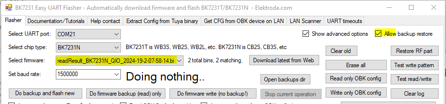

    oh. I think I used the Easy flasher. You have to check the "allow backup restore" box
    Screenshot of BK7231 Easy UART Flasher with the Allow backup restore option checked.
    and I think the filename has to start "readResult_BK7231N_QIO.." for it to appear in the list, if you're trying to restore from a backup taken by another app.

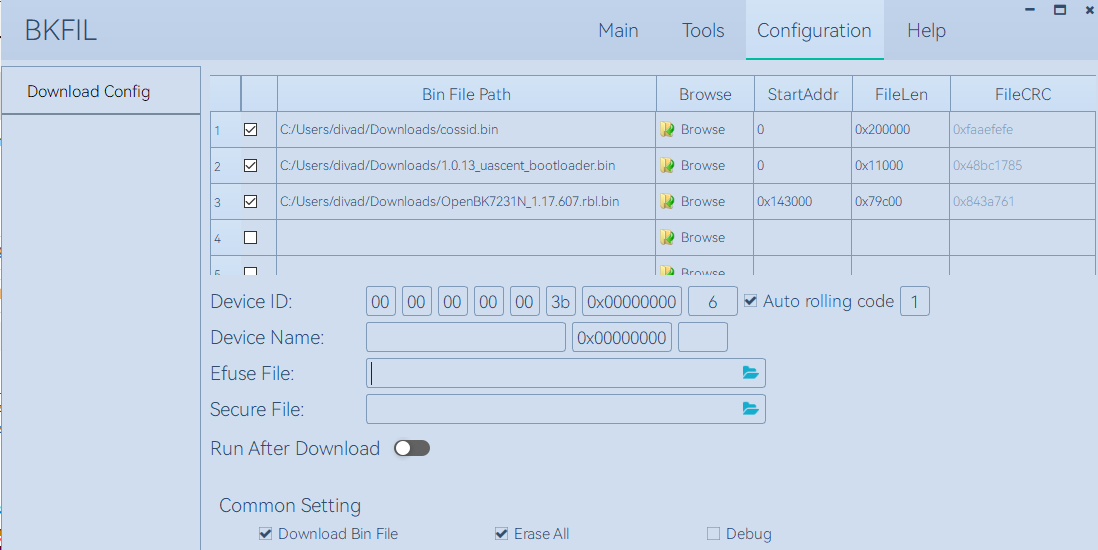

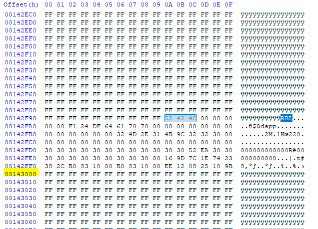

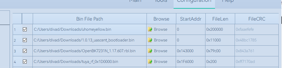

  • OpenBK7231N flashed to 0x143000 hits partition read errors
    #21 21106354
    Posts: 5208
    Help: 446
    Rate: 914
    >>20940846
    OK. so I have my own thread to log some scribbles rather than muddying this one https://www.elektroda.com/rtvforum/topic4056377.html
    playing with my own RT-Threads bootloader device - the matter switch in the first post of this thread. CB3S.
    flashing Uascent factory and then flashing unencrypted BK-N RBL OpenBK7231N_App_1.0.0.rbl file to 0x143000 gives:
    Screenshot of console errors during work on RT-Threads device.
    this is where I believe to OTA partition begins on this
    Screenshot of a hex editor with highlighted offsets.

    @divadiow what does the new flasher reads on your device?
    https://www.elektroda.com/rtvforum/topic4058227.html
    Can it flash it in BK7231M mode? Just make sure to restore backup first. Flashes is not writing the bootloader now.
  • BKFIL flashing steps for CB3S Matter device
    #23 21115403
    Posts: 5208
    Help: 446
    Rate: 914
    I have progressed much further. I'll post with news shortly.
    I am juggling BK Writer 1.7.5, BKFIL and Easy Flasher for various bits
    Added after 1 [hours] 18 [minutes]:
    so after many hours of using various flashers, factory fw backups from my own UAM028 Uascent uHome Matter device and a couple of others around the internet, including a UAM027 bulb, I've managed to have some success getting OBK to boot using BKFIL and a series of steps.
    a few points of note/reminders:
    -This is a non-Tuya Matter device using CB3S/BL2028N module
    -only 1.0.13 bootloaders from other uHome devices are booting on this device
    -the coeff key is 4862379A 8612784B 85C5E258 75754528 but reads as 00000000 00000000 00000000 00000000 (presumably because efuse read-out is disallowed- something of note for others reporting 0s in Easy Flasher)
    -OTA partition is 0x143000 on these
    -I often have to wipe using Easy Flasher and/or BKFIL (from 0x0) then flash factory, bootloader again and then finally OBK rbl to OTA partition:
    BKFIL software configuration view with binary file parameters.
    -when the Bootloader detects data in 0x143000 it will begin flash update
    -after flashing the 3 files it will often take 1, 2, 3 reboots to initiate flash. eg:
    flash happens when this is seen ###############BBBBBBBBBBB##################
    after OTA is complete the red text is appended to the output
    Screenshot of console showing logs related to firmware flashing process.
    and usually OBK begins to boot. it sometimes gets stuck at "bk_misc_init_start_type 0 0"
    Here's a full log from OTA flash through to OBK boot
    BUT there is no mac address and so no AP broadcast despite the full factory firmware being flashed in bin 1 in BKFIL

    Added after 2 [hours] 11 [minutes]:

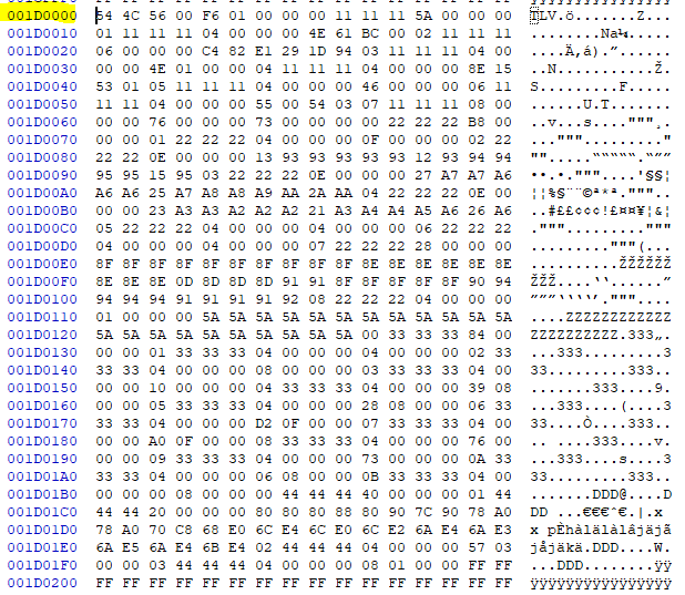

    look like RF is at 0x1F6000 on these.
    Screenshot displaying hex data from a binary file.
    vs standard Tuya at 0x1D0000
    Screenshot showing binary data in a hex editor.
    reflashing uhome factory and tuya extracts to 0x1F6000 makes no difference to the no-AP situation

    added SPI dump of a second 1CH white UAM028 BK7231N/BL2028N Matter CB3S to first post for the collection - CB3S_uHome_Matter_1CH_White_UAM028_SPI.bin
    Circuit board connected to a programmer with wires on a desk.

    I'm no further forward but to make my experience more real here are some gifs.
    first are the files I have queued and then flash with BKFIL
    BKFIL software screenshot with BIN file download configuration.
    then the reboot, a couple of CENs before it'll start OTA, then a couple more CENs to get it to boot fully into OBK.
    GIF showing a terminal console with a flashing and OTA, OBK booting process.
    Added after 9 [minutes]:
    I've flashed uHome and Tuya RF to 0x1F6000 and 0x1D0000 to no effect

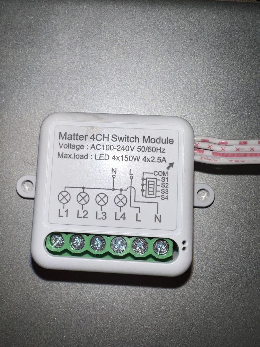

    Hi, have you tried the 4 gang version?
    The 3 gang and below has COM port and the
    3 wires to connect to the switch.
    But the 4 gang version doesn’t have COM port and there’s only 4 wires to the switch.

    Hello. I only have 2 1CH uHome Matter mini switches with which I have been trying to get Openbeken to work on.
    I'm not sure I understand the relevance to the physical differences you have pointed out in the 4CH device though. Presumably the challenges/issues will be the same regarding coeff, bootloader, partition layout, RF not working?
    Have you tried to get Openbeken onto one of these? If yes, does your experience match all the above in my previous posts?

  • 4gang version uses relay 2 on p28
    #30 21137429
    ferbulous
    Posts: 419
    Help: 8
    Rate: 56
    >>21137409
    Just thought you might’ve figured how to connect the 4gang version to the switch (if you bought one) because I can’t get it to work yet.
    It’s actually the same as this one by avatto with the same pinout except relay 2 is assigned to p28 instead of rx1.
    And it does have 5 cables including COM while mine only has 4
    WSM16-4 WiFi switch module on a black table background.
    I swapped the matter cbu with spare cbu that i have and i got it flashed. I had to add some more solder to each sides because it just wasn’t budging with hot air & flux
