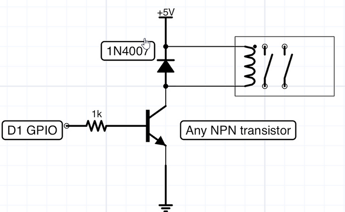

    With this arrangement (only the relay will be on 12V and not 5V):
    Detection of 12V relay status via GPIO - I am looking for a method without using the D1 mechanism .
    I am looking for the best way to detect if the relay is switched on. I don't want to do this through the D1 relay switching mechanism because the relay can also be switched on by another circuit (not ESP). How on another GPIO can I detect if the relay is switched on ?
    Its contacts are from signalling this state.
    I don't understand the question.
    In contactors there are auxiliary contacts for this, and here every contact not used for switching the circuit in question.

    Hm... well, there is 230V on the contacts. And isn't there some way to e.g. detect the 12V flow of the relay coil ?

    faber wrote:
    Hm.... well there is 230V on the contacts
    After all, not on all of them.
    A relay is an electromechanical apparatus.
    It is also a mechanism. The only certain information about its switching is the state of the contacts. It means that the jumper has been tightened to the core.
    Added after 4 [minutes]: .
    Well that's right. And if it is switched on there will be zero on the switched contact. Do you have the information?

    khoam wrote:
    faber wrote:
    As there is no way to e.g. detect the 12V flow of the relay coil ?
    This will 100% not mean that the contacts have switched on or off.
    And would it be possible to do so after all ? :) i.e. this monitoring of the state of the relay is not sensitive, just by the way of changes I wanted to know, but it is not a function on which something will depend, just monitoring, I would not like to simply interfere with the 230V circuit

    faber wrote:
    As it would be possible after all ?
    Collector voltage. If it is close to zero, i.e. the full voltage of 12 V is on the coil of the relay.
    With a circuit with e.g. a zener diode and a resistor you can lower it to e.g. 5 V.
    It will be a negative signal.

    jozgo
    Level 42  
    Posts: 7370
    Help: 1023
    Rate: 1344
    For separation, you can insert an optocoupler.

    faber wrote:
    no at the contacts is 230V
    It is possible to detect this voltage (230V), for example with a brazenly copied mains zero detection circuit.

    krzbor
    Posts: 1783
    Help: 42
    Rate: 1072
    If no separation is needed (i.e. we have a common ground) then it is best to connect the cathode of the diode to the collector, a 10k resistor to the anode and the other end of the resistor to supply the ESP (3.3V). To the anode we connect the free I/O. The signal will be in negation.
