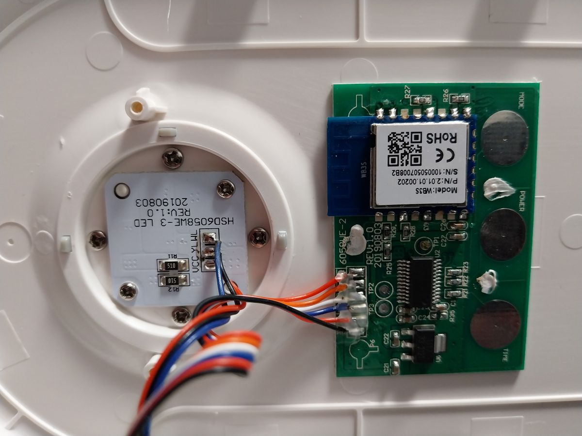

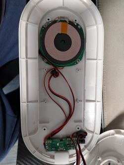

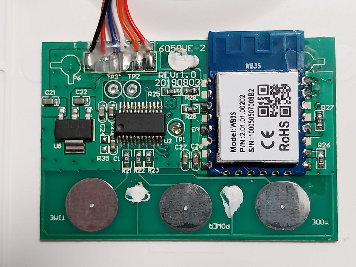

  • Device Name: Mirabella Genio Wi-Fi LED USB Desk Lamp With Wireless Charger - I003867
    Device Type: Desk Lamp with Qi Charger
    Device Chip: WB3S - BK7231T with TuyaMCU
    Device Purchased Bunnings Warehouse - $29.95AUD - Appears they not stocking this anymore and selling last of stock
    Inside of a wireless charger with visible induction coil and electronics. Interior of a desk lamp with Qi charger and WB3S electronic module. Circuit board with WB3S module. Mirabella Genio LED desk lamp with wireless charger.
