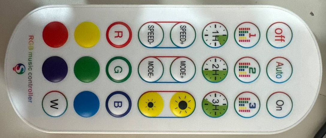

    New leading radio communication RGBW WX400P with leading: Built-in microphone communication, Using WiFi connection, Synchronization of LEDs with music, IR remote control, with leading microphone communication, Using WiFi connection, Synchronization of LEDs with music, IR remote control, with leading radio communication.

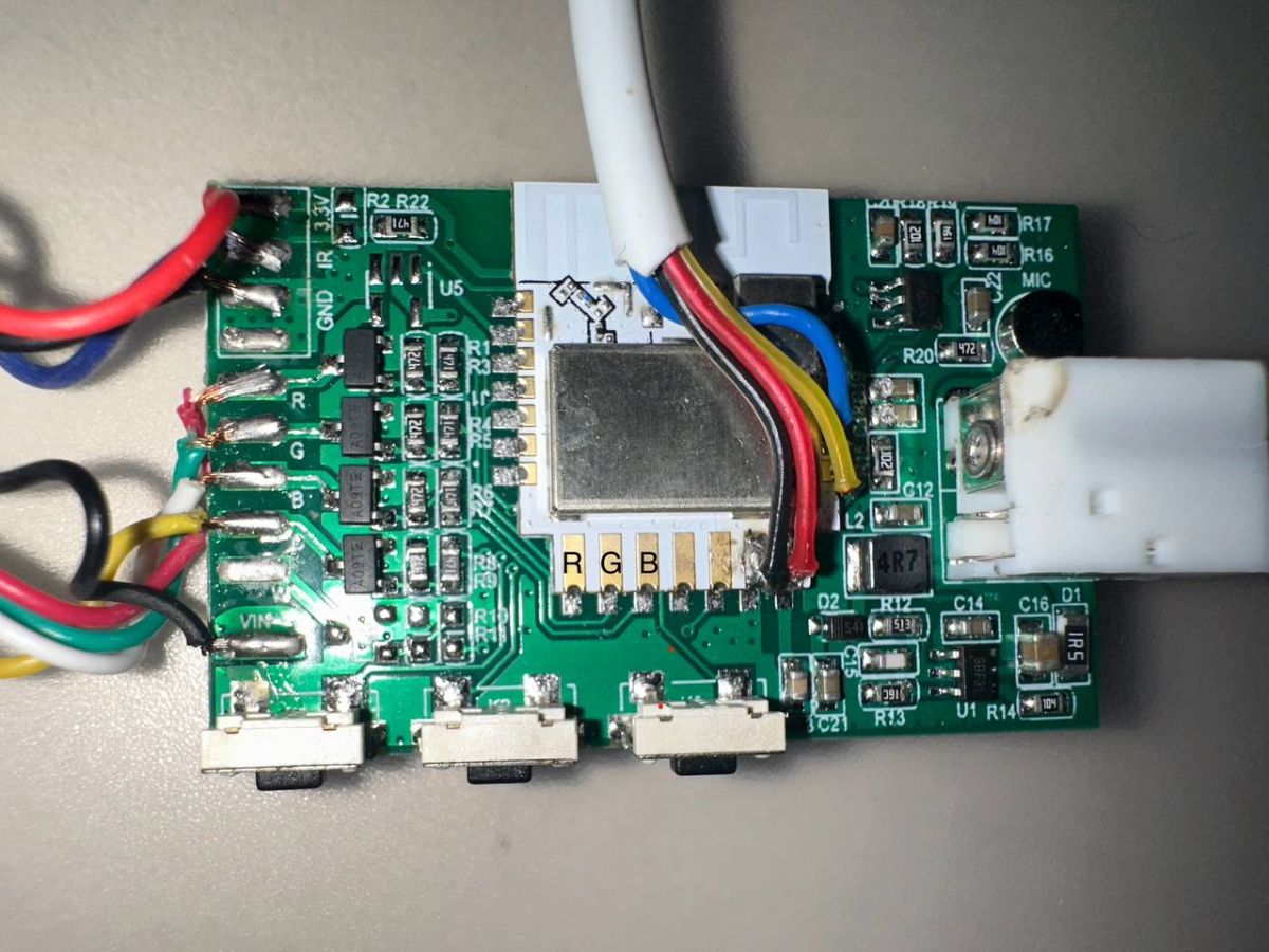

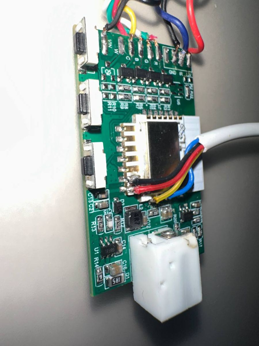

    Tuya WX400P RGBW LED strip controller with CBU module soldered to PCB.

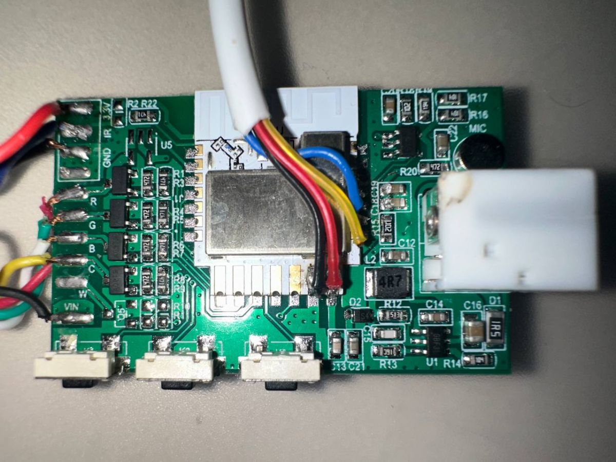

    [BK7231N] [CBU] Tuya WX400P RGBW Music Ir LED Strip с кнопками
    The printed circuit board has the inscription "SHY690-v1.4".
    Spoiler:
    На печатной плате имеется надпись "SHY690-v1.4".

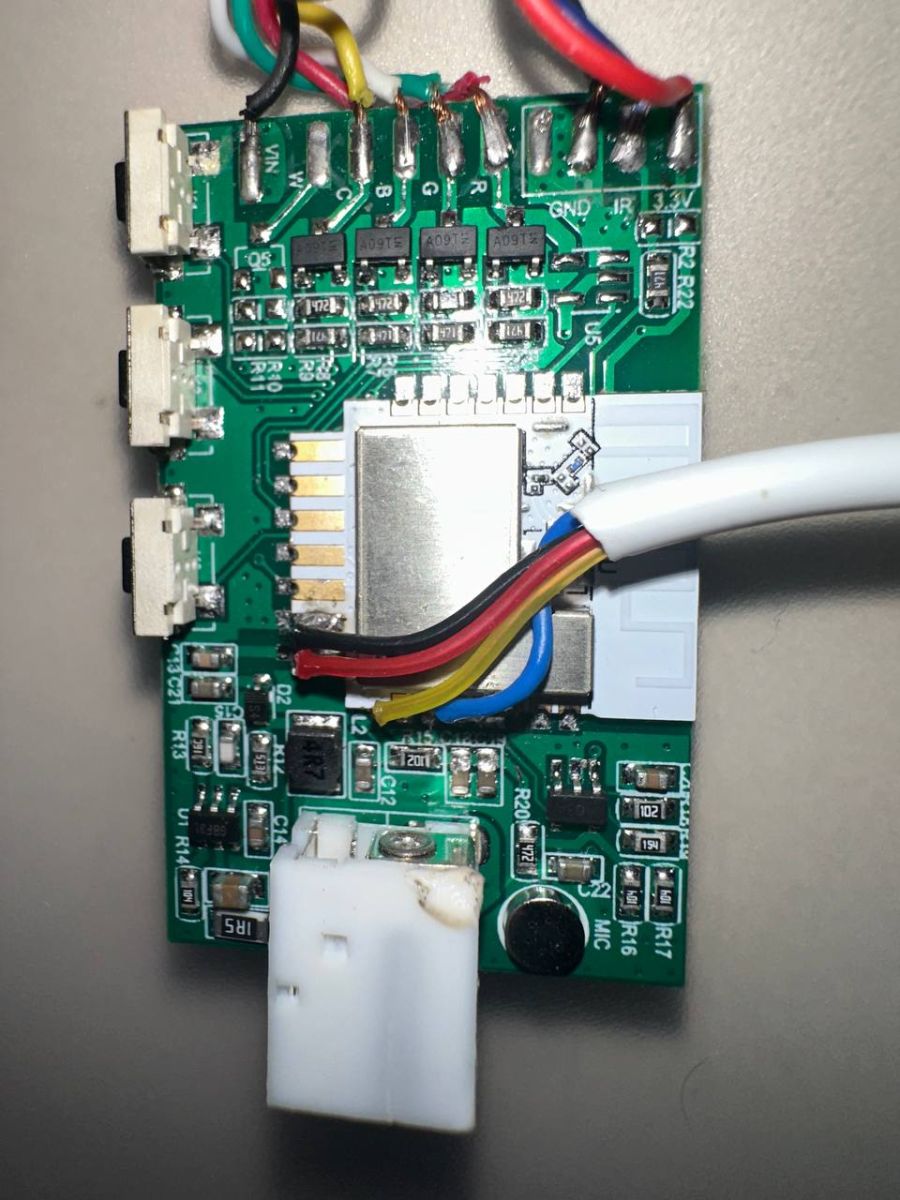

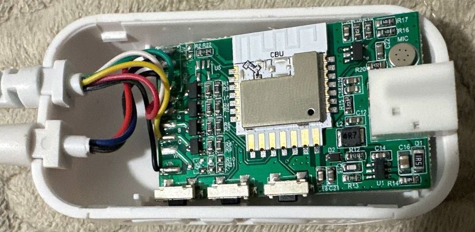

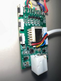

    More photos of the board
    Spoiler:
    Еще фото платы

    Here is all the information that we managed to get:

    Managed to start like this:
    OBK Template
    Spoiler:
    Удалось завести вот так:
    Шаблон OBK

    Help me figure it out to the end! I wanted the white color to work in some combination with RGB.
    Also, how can I make the microphone work with RGB?
    This is my first time dealing with OpenOBK and it is not entirely clear how well I did everything correctly.
    Help me finish everything correctly
    Spoiler:
    Помогите разобраться до конца! Хотелось что бы белый цвет как то комбинировано работал с RGB.
    Так же как заставить работать микрофон с RGB?
    В первый раз дело имею с OpenOBK и не совсем понятно на сколько я все правильно сделал.
    Помогите довести все грамотно до конца
    AI: Can you please specify which pins on the PCB are connected to the microphone and to the white LED channel? If possible, describe or show how the microphone and white channel are wired.
    B - "6": "PWM;2",
    G - "7": "PWM;1",
    R - "8": "PWM;0",
    W - "9": "PWM;3",
    Button - "20": "dInput_NoPullUp;43",
    Button - "22": "dInput_NoPullUp;41",
    MIC - "26": "IRRecv;0",
    Button - "28": "dInput_NoPullUp;35"
    I'm afraid there is no microphone support in OBK for audio-reactive effects.

    How would you like mic to work, do you have any specific algorithm in mind?
    What kind of RGBW control do you want - either RGB or W, or do you want to be able to set RGB and W at the same time?

    cloudcutter exploitable. profile added https://github.com/tuya-cloudcutter/tuya-clou...2732c245f2cd78dd707a4d0249ff1801742c2078a264b
