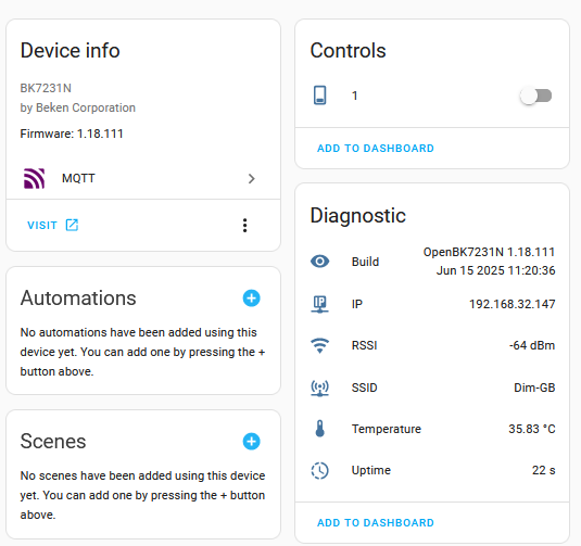

    Since it can't work with HASS Api (Am I wrong?) I setup MQTT and I recive following informations in HASS:
    How to Rename openBK Switch Entity and Separate External Switch in HASS with BK7231N?
    Here my questions:
    1. Is there a way to change from openBK the "1" name for the switch with a more friendly one? Inside cfg_name i only see device name (Short, full).
    2. Is there a way to see the external switch as a separate identity keeping the switch function on the relay?

    What is HASS API? we have HASS Discovery in OBK.
    1. Sure, use SetChannelLabel
    2. You can set separate channel index for your button or whatever you want, you can also set channel type toggle for that in the web app and it should work good, along with HASS Discovery

    1. Perfect, I wrote in app -> Log -> Console "SetChannelLabel 1 switch". It would be useful to have the link you provided directly on the web UI near the console (I tried help w/o results)
    2. I set as shown above, but in hass I only see the switch
    setting dInput I see the value in HASS but even if it's ok when I connect a bistable button, it's not good for a push button pressed very fast. It would be better to have a variable that toggles between on and off with the push so I'm sure to detect the push even with network latency.
    Many thanks
