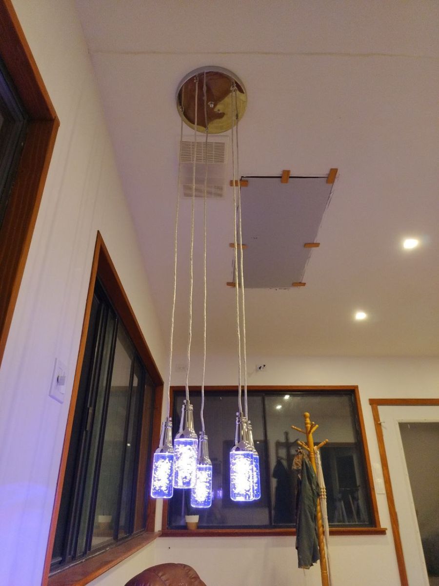

    Today, we are going to decloud a nice pendant light in the shape of beer bottles Link
    Carro Beer Bottle Pendant Light Teardown: OpenBK7231N OTA Flash, Pin Mapping.

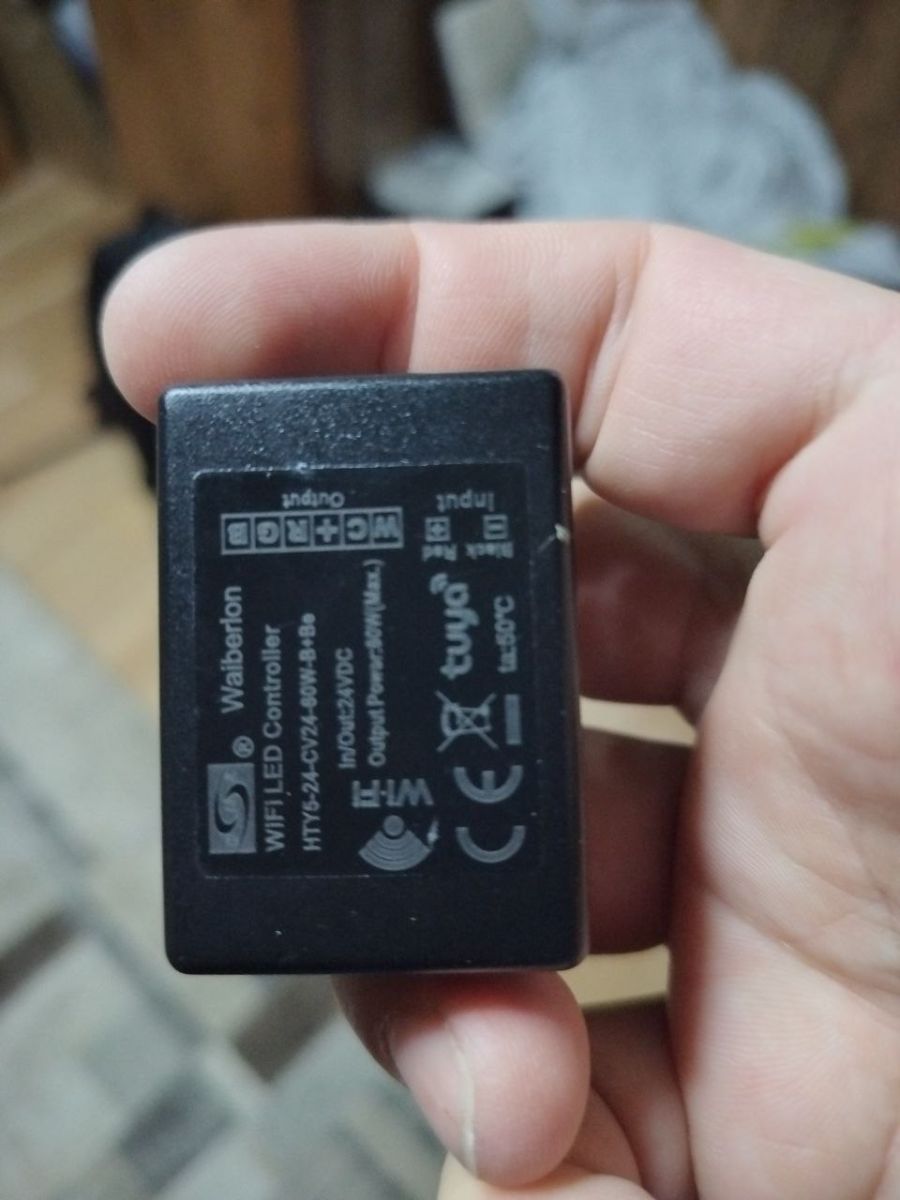

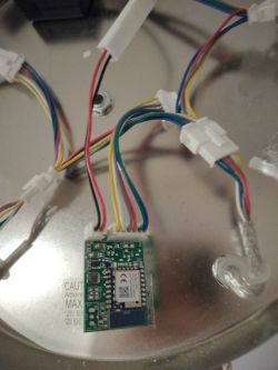

    According to the manual, it is made by Carro. Obviously, I didn't want to install their stinky app, so here we go. Inside the lamp, we see a 24V PS and an LED controller. The LED driver is powered by a CB3S IC, therefore, you'd need the BK7231N FW (I know it says it is for WB3S, but nonetheless) . Since we will be doing the upgrade OTA, you need the UG FW, I used OpenBK7231N_UG_1.15.597.bin
    Carro Beer Bottle Pendant Light Teardown: OpenBK7231N OTA Flash, Pin Mapping Carro Beer Bottle Pendant Light Teardown: OpenBK7231N OTA Flash, Pin Mapping
    As before, I used the Tuya Cloud Cutter (CC henceforth). However, unlike the previous LED lamp, CC knew neither the lamp nor the controller (HTY5-24-CV24-60W) manufacturers.

    Now comes the fun part, matching the pins. After some experiments, it turned out that PWM0 is cold white, PWM1 is not connected, PWM2 is warm white, PWM3 is green, PWM4 is red, and PWM5 is blue. You need to set your channels to PWM0 - 3, PWM2 - 4, PWM3 - 1, PWM4 - 0, PWM5 - 2, and check Flags 4, 10, and 12. Once this is all set, you can provision it with Home Assistant, and it will correctly set the colors. This was relatively easy and required minimal teardown, even though no documentation seems to be available for the LED controller.

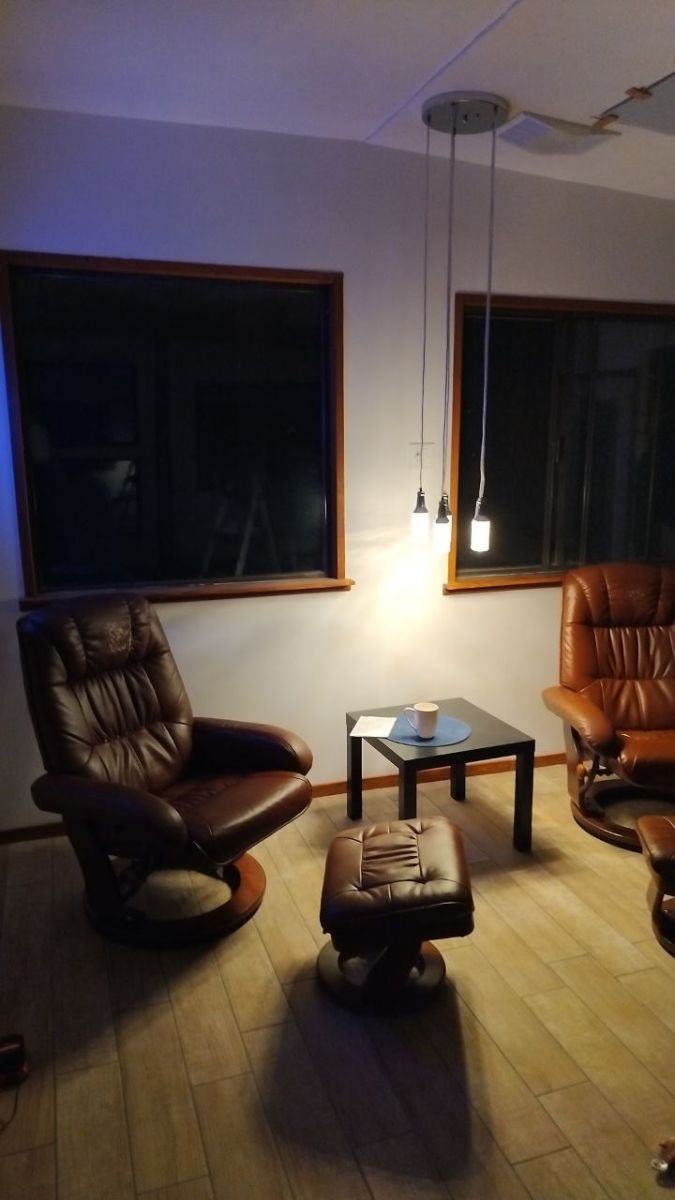

    Very nice lamp, thanks for sharing! How it looks during the night with other lamps turned off?

    @p.kaczmarek2 Thank you :) This is how it looks at night
