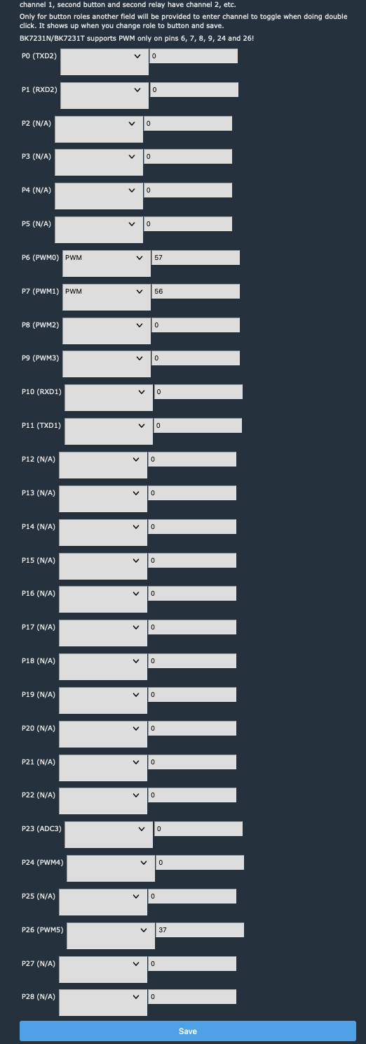

    I have multiple Tuya LVL ceiling lights. I flashed one with Cloudcutter, then installed the OpenBK7231T firmware and got the web interface.
    With the testing of the pins, I found pin 6 and 7 (channel 56/57) to respond to the relays testing. Changed them to PWM and can control brightness and color temp, perfect.

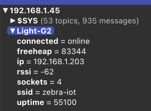

    Yes, I watched all videos but I have to explain again:
    When the device channels are set to relays, MQTT works and HA also picks them up.
    But when I put the pins/channels to PWM so I see the sliders in the web interface (and everything just works), I cannot get the right info to MQTT, nor does HA pick this up.
    I have MQTT Explorer open to check, but the dim values are not coming in.

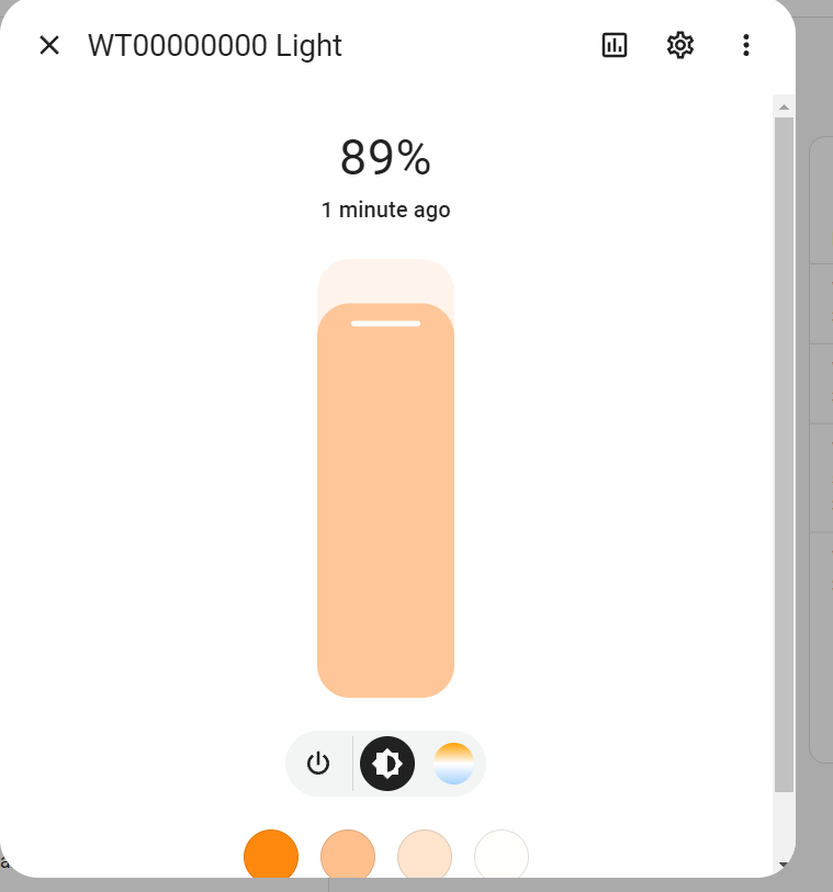

    Are you sure? It worked for me many times, and it worked when I tested it right now, albeit in simulator:
    LED lighting circuit simulation with buttons for brightness and temperature adjustment.
    Screenshot of the WinTest_00000000 software interface showing buttons and sliders for light management.
    In HA:
    Screenshot of a light control interface with brightness set to 64%.
    App interface showing WT00000000 light set to 89%
    Discovery happens:
    Screenshot of system logs showing messages related to MQTT communication and device configuration.
    What HA got:

    For security, I set up a new MQTT broker. This keeps it simple to monitor.
    I have only set two pins because they reacted on the real testing. I see you use button options, and when I test those, the light does not work, but I see dimmer commands in the broker.
    Sharing my settings:

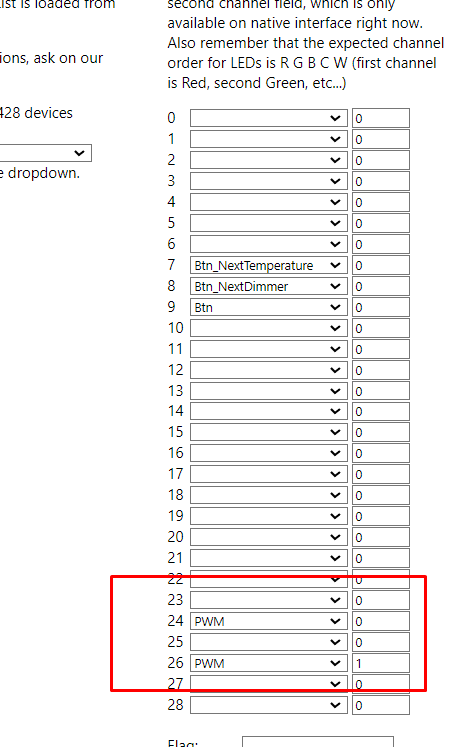

    Can you please try to set the channels of PWMs to 0 and 1, like on my side?
    PS: I am using a button GPIO role because I have a physical buttons on the device. Or at least, simulated physical buttons... your lamp doesn't seem to have physical buttons, so no problem with that.

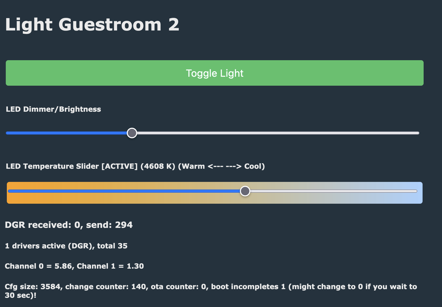

    Getting closer :-)
    Setting 0 and 1 did not affect the controls in the webpage but in MQTT I now see the led_dimmer and led_temperature but the values don't seem to come through, they don't match changes from the web interface.
    However, I am able to send SET commands. Those work for the dimmer but sending a value to the led_temperature changes the brightness (on channel 0)

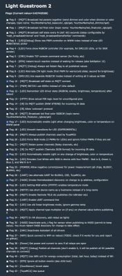

    Those controls on the web page... by any chance, do you have set "Show raw PWM controls" in flags? It's not set by default, so that would be strange, but still, it's worth to check this out.
  • #9 20837191
    zebrahosting
    Posts: 12
    Yes, I had it set and removed it. Now the sliders give a different image, but the temperature slider now controls the dimmer. For security, my flag settings:

  • Flag 3 breaks color temperature control
    #11 20838036
    zebrahosting
    Posts: 12

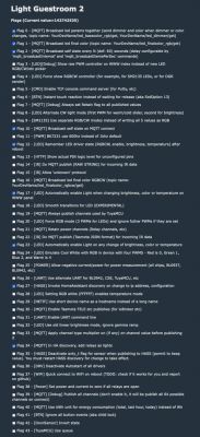

    When things did not work, I have been playing with the flags (my bad). It would be nice to have a 'back to default' button.
    The state now, after changing the flag you mentioned:
    The web interface shows both sliders, with the bottom one having color temperature attributes. Unfortunately, it no longer works as a color temperature setting, but it seems to affect brightness too.
    In MQTT, I see the details coming through, which is great. Brightness ranges from 1-100 and color temperature ranges from 500-154 (but affecting brightness as mentioned above).
    I have switched some flags off, but there must be a mistake somewhere.
    In the HA window, it now displays the HA config again. So, in short, we're nearly there, I would say. Just the color temperature slider is not controlling the right way, everything else seems on track.
    With Flag 3 enabled, the controls work as expected, but everything else does not. It's best to keep it disabled, but then the color temperature slide does not work.

    I think I know what may be wrong... it's the thing we've spoke about on our video:
    I suspect your device is using alternative CW control, which means one PWM is literally the brightness and second is literally the color temperature, as opposed to situation where one slider is cool color and second is warm.
    You need to enable the "alternate CW mode" in the device flags.
    Futhermore, you may need later to change one of the PWMs to PWM_n (inverted), depending on your device.

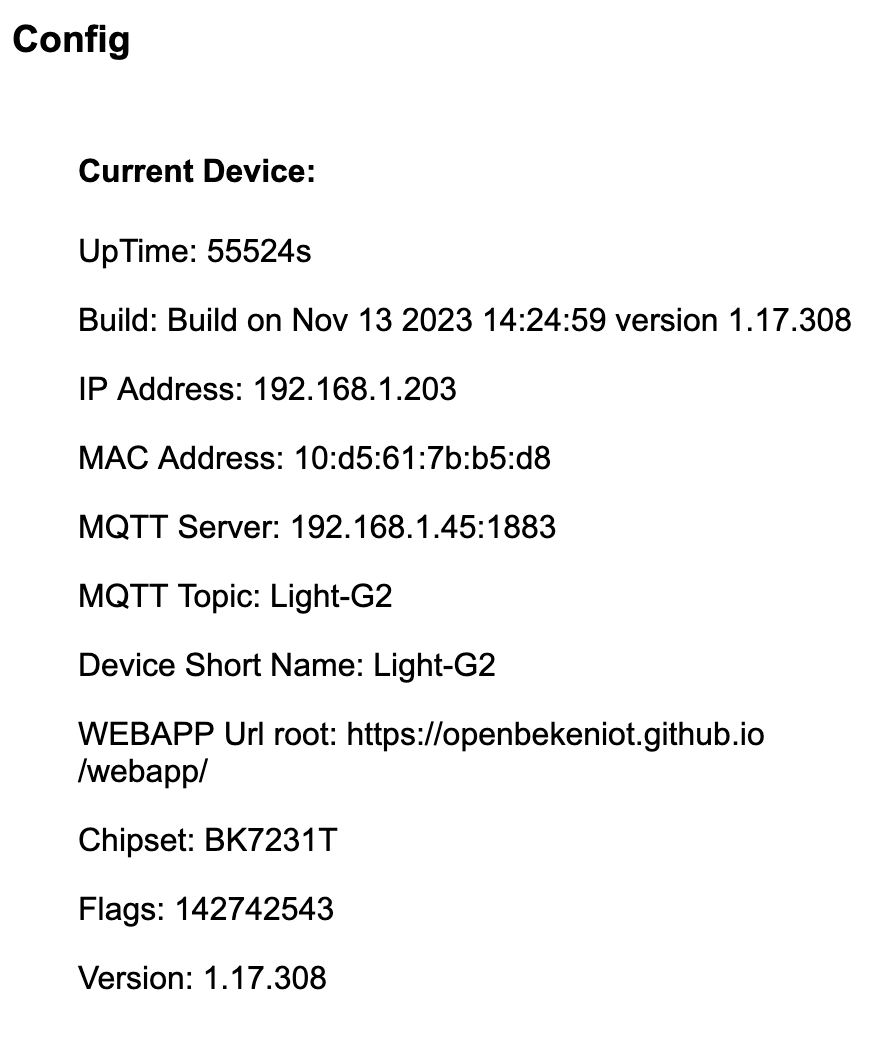

    Can you also attach here Tuya config as shown on this video:
    https://www.youtube.com/watch?v=WunlqIMAdgw&ab_channel=Elektrodacom
  • Tuya info may still be stored in a partition

    It seems that we need to start with the basics. Enable back "show raw pwm controls" so you get two PWM sliders and check - what does affect each of the sliders?
    a) is one slider then a brightness, and second is temperature?
    b) or is one slider cool white and second is warm white?
    If that's option a), then maybe you need to swap channel indexes?
    Look, for flag 8:
    Screenshot of control panel with LED debugging flags.
    You need two PWMs, but their order matters. Maybe you have them swapped? Maybe you need to swap channels? Replace 0 with 1 and 1 with 0?

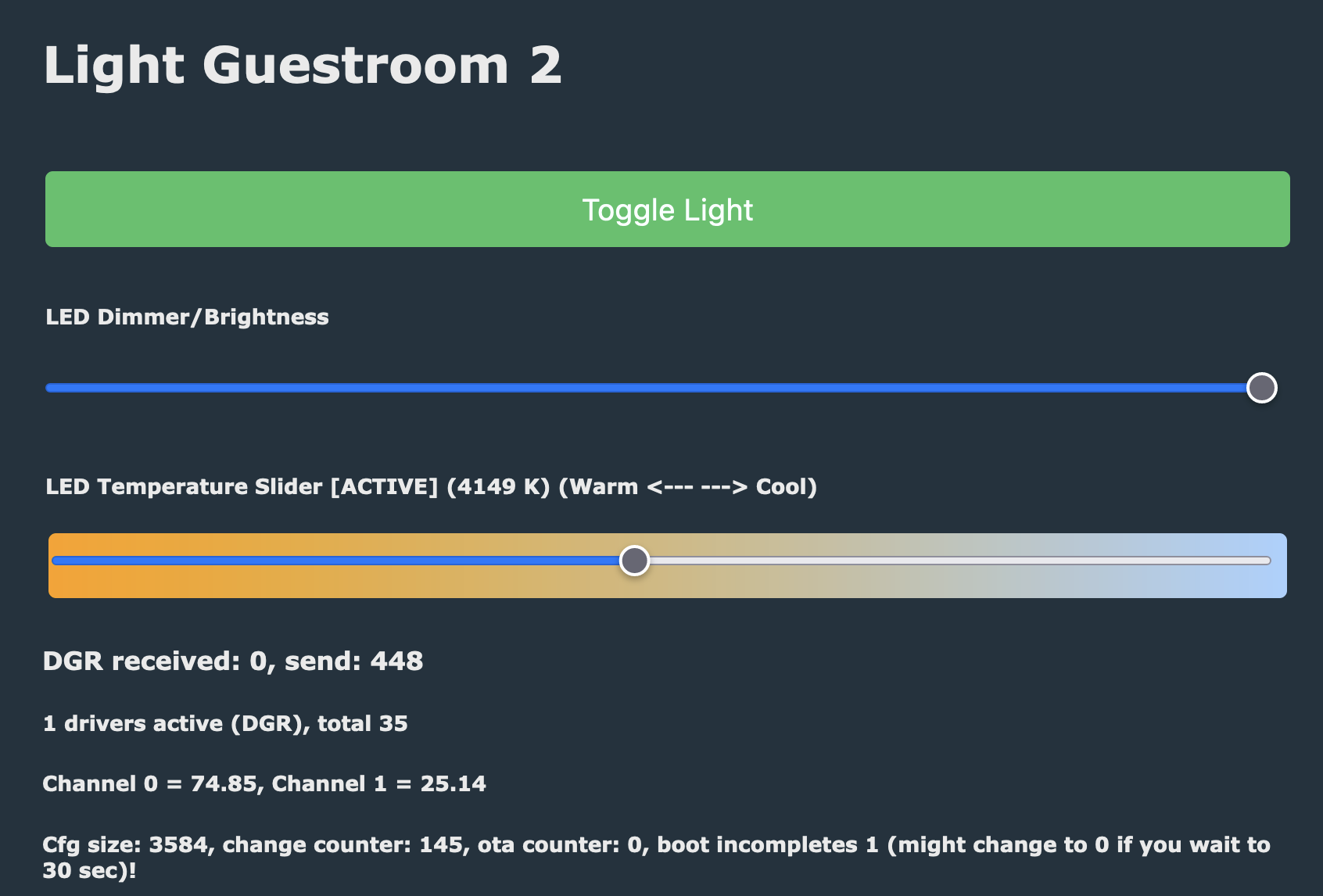

    Thought I have been pretty clear but let me try again:
    Web interface:
    With Flag 3 enabled, I get two sliders. The top one is brightness, the lower one is colortemp. Both work as expected. If I switch Flag 3 off, I get more fancy sliders but the colortemp slider does not change the color but affects the brightness.
    MQTT:
    If I set Flag 3 on, I don't get any MQTT values sent through. Not for led_dimmer, not for led_color. If I switch it off, it works again. Flag 3 is killing my MQTT and also has an effect on the HA setup (not showing anymore)
  • Swap PWM channels for alternate CW mode

    zebrahosting wrote:
    MQTT:
    If I set Flag 3 on, I dont get any mqtt values send through. Not for led_dimmer not for led_color. If I switch it off, it works again. Flag 3 is killing my MQTT and also has an effect on the HA setup (not showing anymore)
    Flag 3 is "show raw PWM controllers", it's supposed to disable LED mode. It is for development test only, not for production.
    zebrahosting wrote:
    With Flag 3 enabled I get two sliders. Top one is brightness, lower one is colortemp. Both work as expected.
    This is raw PWMs mode, only used for testing.
    zebrahosting wrote:
    If i switch Flag 3 off, I get more fancy sliders but the colortemp slider does not change the color but affects the brightness.
    This is now as expected, because, as I said earlier:
    Look, for flag 8:
    Your device is using alternate CW mode. In alternate CW mode, first PWM is warm/cool, second is brightness.
    You are saying that you have first slider which is brightness, and second is warm/cool.
    That means you need to:
    1. first swap channels, so warm/cool is first, and brightness is second
    2. then disable debug flag 3 called "show raw PWMs"
    3. then enable alternate CW mode (flag 8)
    4. Then, if something is inverted, like warm is inverted with warm, you may need to change one of PWM roles to PWM_n ...
  • #17 20838600
    zebrahosting
    Posts: 12
    OK checked and working now. I never saw anywhere that flag 3 was for dev but thanks for hanging on and helping out. Next I will download the firmware when I have time and make a description. Nice to see it working and respect for all the work done.
  • #18 20838602
    zebrahosting
    Posts: 12
    With great support and patience, the right module setting / flags made it work. Just 15 more to flash

It includes fields like avty_t "~/connected", bri_scl 100, min_mirs 154, max_mirs 500, and topics for led_dimmer and led_temperature with matching cmd/stat pairs. Unique ID and device info (ids, name, sw, mf, mdl) are present as well. [Elektroda, p.kaczmarek2, post #20835673]
Should I invert any PWM (PWM_n), and when?
If warm/cool or brightness behave inverted after enabling Alternate CW, change one PWM role to PWM_n. This flips the output polarity without rewiring. Test both channels to confirm correct white balance and dimmer behavior in HA. [Elektroda, p.kaczmarek2, post #20838044]
What availability topic and QoS does OpenBK use by default for lights?
The HA discovery payload advertises an availability topic of ~/connected and a QoS of 1. Use this to monitor device online state in HA. You can also see state via led_enableAll get/stat topics. [Elektroda, p.kaczmarek2, post #20835673]
How can I verify that OBK is publishing the expected MQTT messages?
Use an MQTT client to watch led_dimmer/get and led_temperature/get while moving sliders in the OBK UI. Confirm command topics cmnd//led_dimmer and cmnd//led_temperature accept values. Check the discovery payload to validate ranges (bri_scl 100; 154–500 mireds). [Elektroda, p.kaczmarek2, post #20835673]
Is there a one-click way to restore OpenBK defaults if I changed many flags?
There isn’t a single “back to default” button noted in this thread. The practical fix was to disable Flag 3, set proper PWM order, and use Alternate CW mode. That restored correct CT and MQTT/HA behavior. [Elektroda, zebrahosting, post #20838036]
Quick 3-step: how do I make HA discovery publish again for my light?
  1. Turn off Flag 3 (raw PWM) to re-enable LED mode.
  2. Enable Alternate CW (Flag 8) and ensure CT is first, brightness second.
  3. If whites invert, set one channel role to PWM_n, then restart discovery. This restores HA entities and correct sliders. [Elektroda, p.kaczmarek2, post #20838559]
