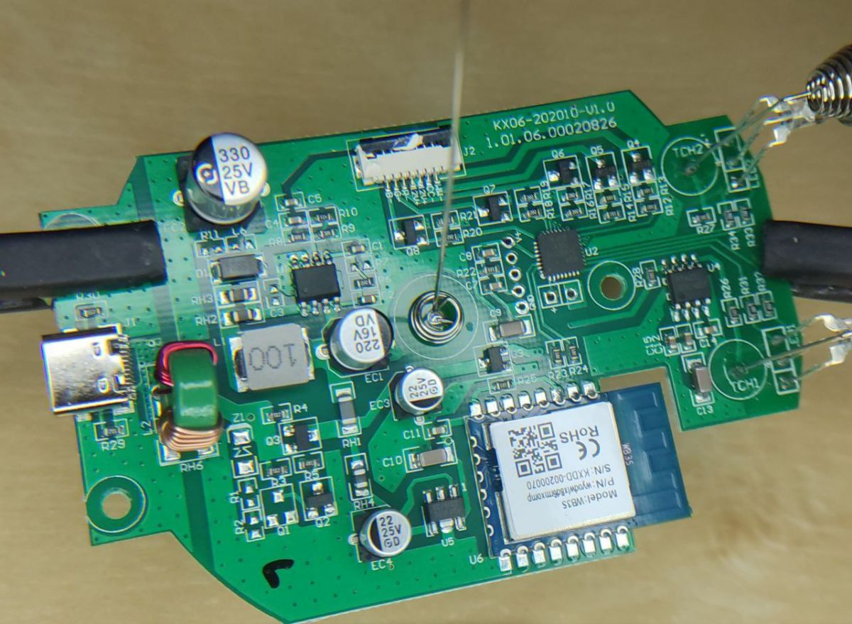

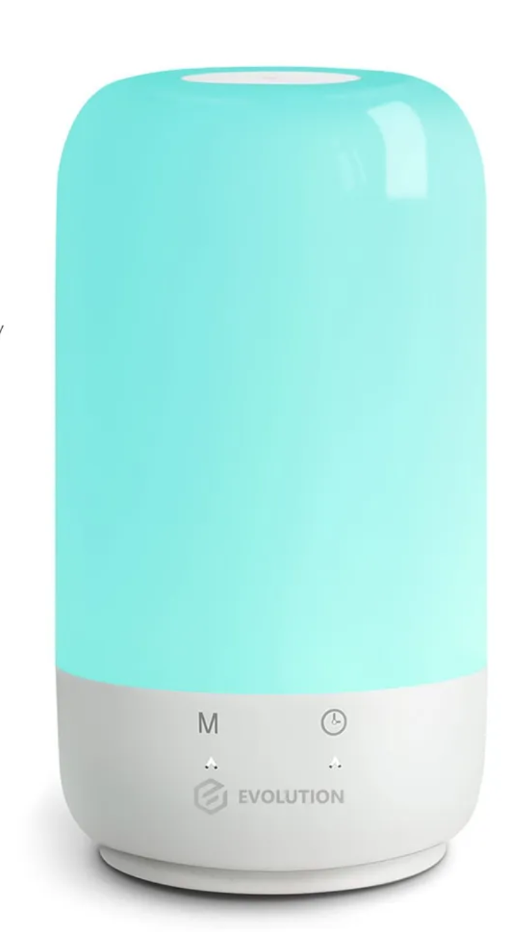

  • Close-up of a circuit board with a WB3S module.
    Lamp with a white base and a glowing turquoise shade.
    Removing WB3S with soldering iron wasn't easy, cause copper is very thin and easy to torn apart.
    Otherwise usual flashing.

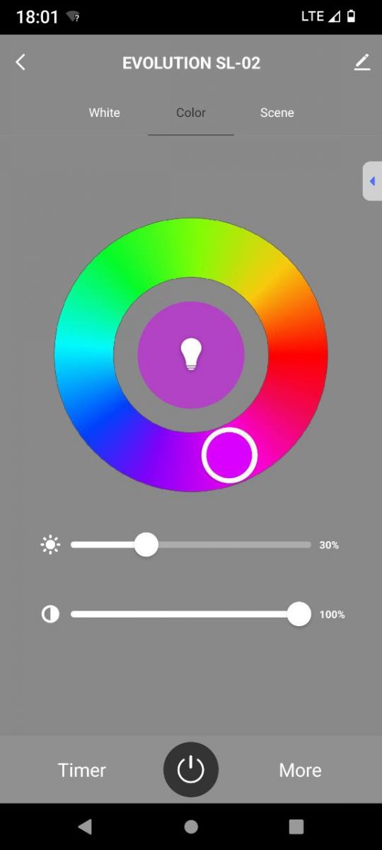

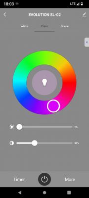

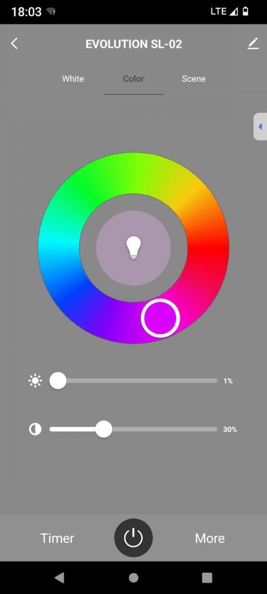

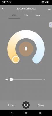

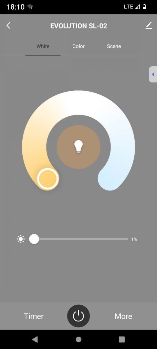

    some app screens:
    App interface for controlling RGB lamp with color, brightness, and contrast settings. Tuya app with Scene tab open, showing colorful patterns and lighting modes. App screen with scene settings named Colorful featuring color selection and flash modes. LED lighting control app screen with color options and modes. TuyaMCU mobile app with a color wheel for adjusting light hue. App interface for controlling EVOLUTION SL-02 lamp with color and brightness options. App screen for light control showing Soft mode with color options. Smartphone app screen with color and brightness settings for the Gorgeous scene mode. App screen with lighting settings
    with TuyaMCUAnalyzer I've found out:
    ## white tab
    dpId=21 Enum V=0
    color temp
    min dpId=23 Val V=0
    max dpId=23 Val V=1000
    brightness
    1%     dpId=22 Val V=10
    30%   dpId=22 Val V=299
    80%   dpId=22 Val V=797
    100% dpId=22 Val V=1000

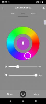

    ## color tab
    dpId=21 Enum V=1
    same purple color and contrast 100
    brightness 1   dpId=24 Str V=012303e8000a
    brightness 4   dpId=24 Str V=012303e80026
    brightness 30  dpId=24 Str V=012303e8012c
    brightness 100 dpId=24 Str V=012303e803e8
    same purple color and brightness 1
    contrast 1   dpId=24 Str V=01230000000a
    contrast 4   dpId=24 Str V=01230025000a
    contrast 30  dpId=24 Str V=01230130000a
    contrast 100 dpId=24 Str V=012303e8000a
    changing color, brightness and contrast 1
    red        dpId=24 Str V=015d0000000a
    yellow   dpId=24 Str V=00320000000a
    green    dpId=24 Str V=00650000000a
    blue      dpId=24 Str V=00e10000000a
    purple   dpId=24 Str V=01230000000a

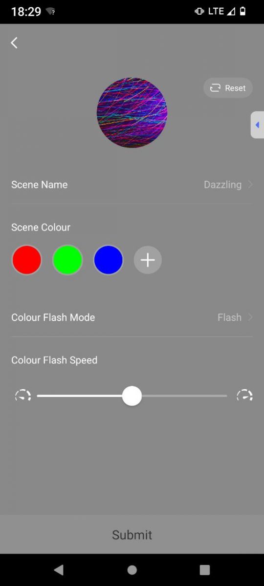

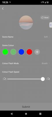

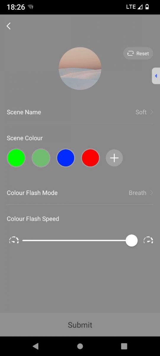

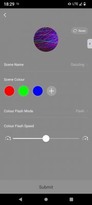

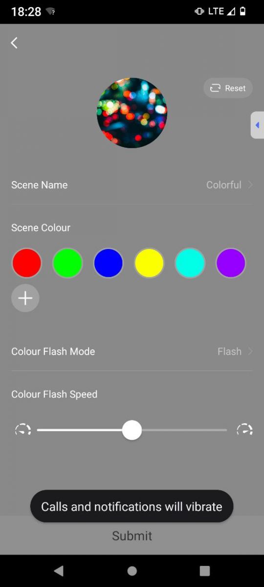

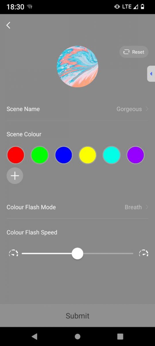

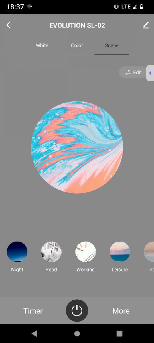

    ## scene tab
    dpId=21 Enum V=2
    modes
    night   dpId=25 Str V=000e0d0000000000000000c80000
    read    dpId=25 Str V=010e0d0000000000000003e801f4
    working dpId=25 Str V=020e0d0000000000000003e803e8
    leisure dpId=25 Str V=030e0d0000000000000001f401f4
    soft    dpId=25 Str V=04464602007803e803e800000000464602007803e8000a00000000
    breath soft    dpId=25 Str V=04646402007803e803e800000000646402007803e8000a0000000064640200e603e803e800000000646402016803e803e800000000
    colorful dpId=25 Str V=05464601000003e803e800000000464601007803e803e80000000046460100f003e803e800000000464601003d03e803e80000000046460100ae03e803e800000000464601011303e803e800000000
    dazzling dpId=25 Str V=06464601000003e803e800000000464601007803e803e80000000046460100f003e803e800000000
    gorgeous dpId=25 Str V=07464602000003e803e800000000464602007803e803e80000000046460200f003e803e800000000464602003d03e803e80000000046460200ae03e803e800000000464602011303e803e800000000
