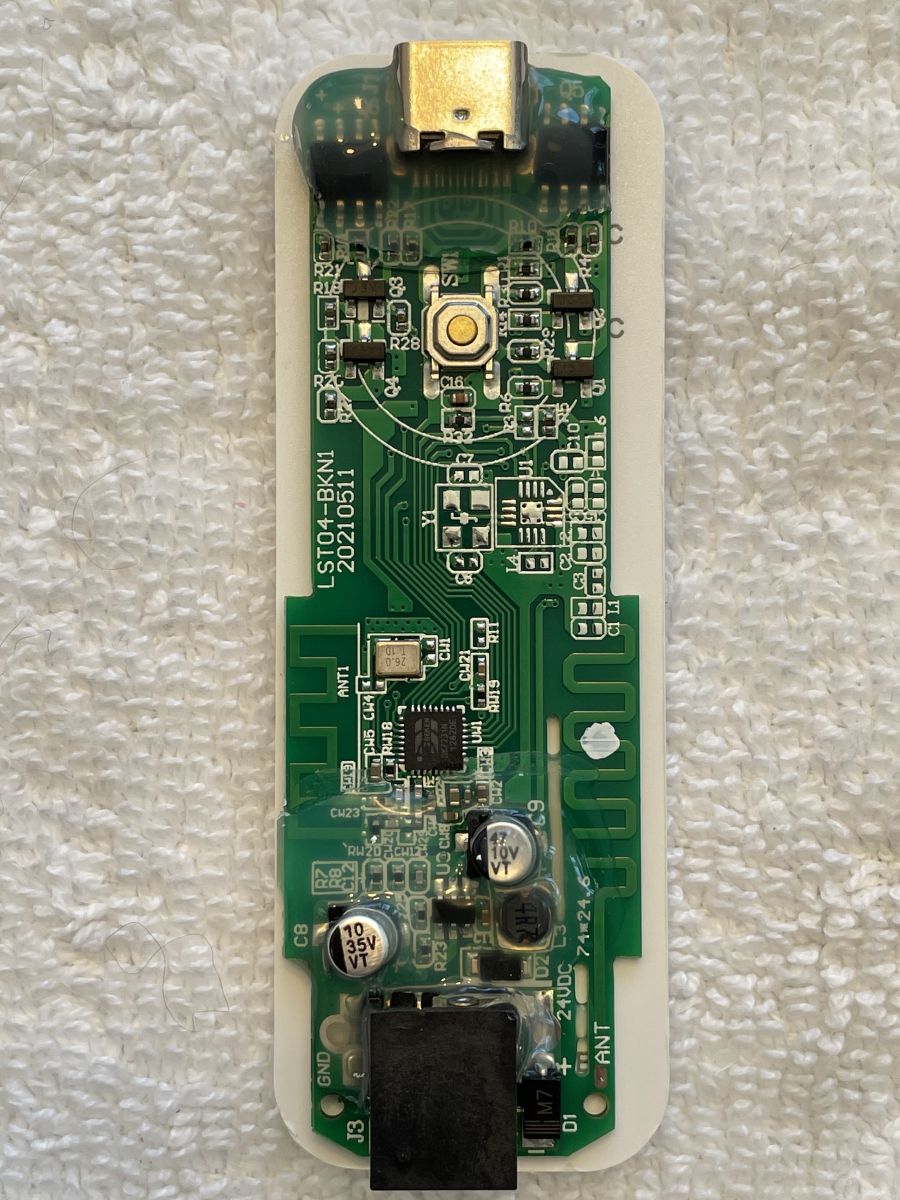

  • FEIT Smart WiFi Light Strip FETAPE/RGBW/CNTRSC on BK7231N was torn down and mapped for OpenBK/CloudCutter.
  • RGBW mode needs flag 24 in the native interface; the web app misreports status, and the BLE wireless remote still does not work.
  • The working pin map is 6=PWM;4, 7=PWM;2, 8=PWM;1, 9=PWM;0, plus 26=Btn_SmartLED;0, with no signal on pin 24.
  • Flashing through RX1, TX1, GND, and CEN worked without desoldering, and the 1.0.9 OpenBK update notably improved Wi‑Fi performance across five devices.
  • This teardown is complete.
    I got everything working now (except of course the BLE wireless remote):
    It looks like we have to use the native interface instead of the web app for this device since it is RGBW (warm white.)
    It appears that it needs flag 24 in order to work correctly.
    (Note that the Web App will not show the correct information on the Status screen - but the native interface will.)
    There is nothing on pin 24 - but if we don't set it to PWM3, then the HomeAssistant/MQTT definition breaks into 4 separate lights rather than a single RGBW light. (Might be a bug - Flag 24 should probably automatically fix this so we don't have to find an unused pin.) (This is fixed in latest FW update.)
    The "smart" button is on pin 26.

    I was able to flash it using only the RX1, TX1, GND and CEN test pads on the back of the board without having to desolder or cut any traces.
    I was able to power the board with its included 24VDC power supply to talk to the 7231N.
    I successfully completed a UART dump using a Raspberry Pi and the uartprogram from https://github.com/OpenBekenIOT/hid_download_py
    The dump is zipped and attached to this post with a test SSID and Password on an otherwise freshly reset Tuya Firmware 1.0.9.
    I have tested the CloudCutter profile and can confirm it works on an un-modified device.

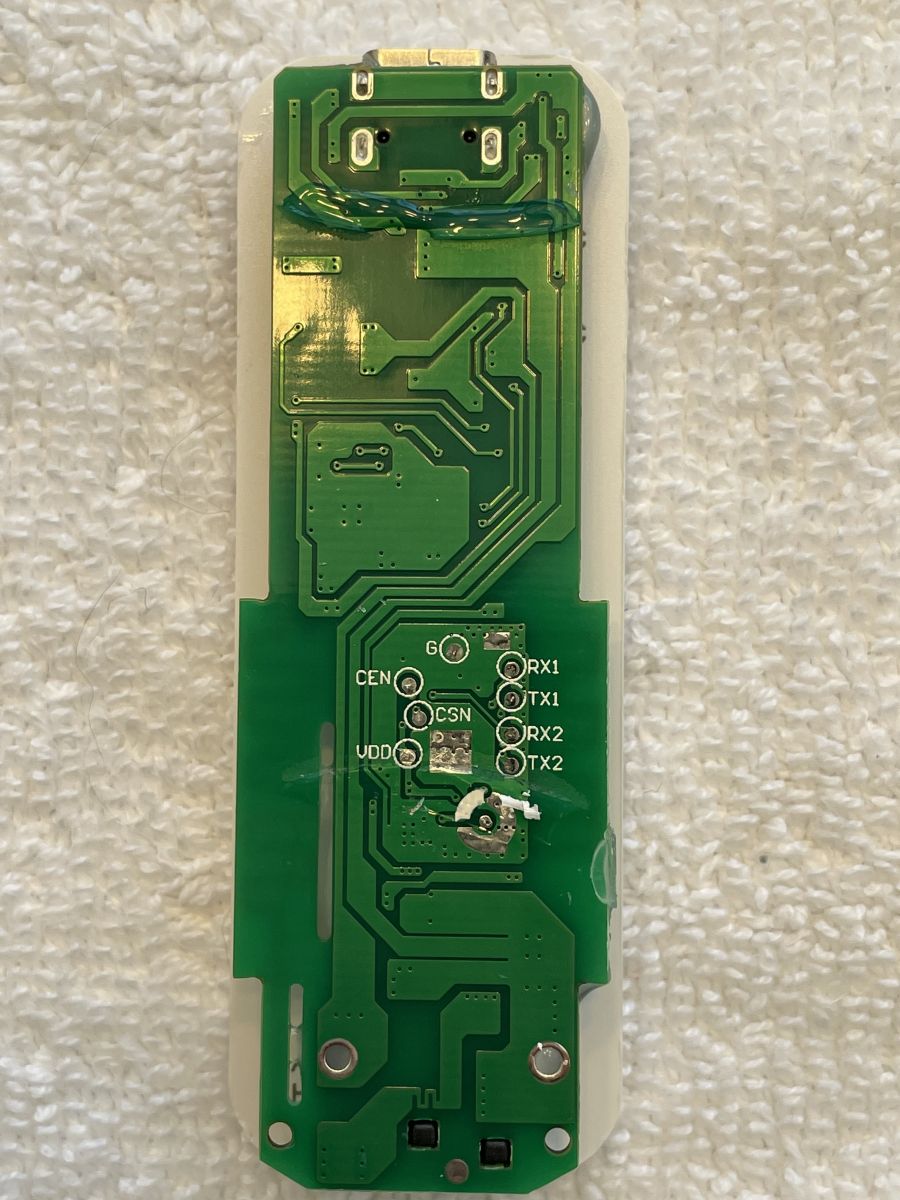

    Unfortunately I managed to damage the RX1 diagnostic pad. I will need to clamp a probe onto the chip for RX1 - are the pinouts the same for 7231N and 7231T? I found some pinout diagrams on the site labeled 7231T.
    Mine is a QFN 4x4 32-pin chip.

    Unfortunately it doesn't want to talk to me in-circuit:
    FEIT Smart WiFi Light Strip - Model: FETAPE/RGBW/CNTRSC - FCC ID: SYW-TAPRGBWCNTRSC - 7231N
    Rather than try to modify anything abut this board, I think it will be easier to just remove the chip.
    They don't use a daughterboard for this device, and it is a wicked small chip - QFN 4x4 32 - so I ordered some of these from Amazon:
    https://www.amazon.com/dp/B0B75V1DFP?ref_=cm_sw_r_apin_dp_DVBYW4H7SQENGG29KR9V
    I guess I will get a chance to try out my hot air system on some actual SMD work rather than just heat shrink. :)
    Wish me luck.

    I think you can solder to that two points:
    Is RX1/TX1 used for anything else in this system? If not, then flashing should work.
    Removing chip most likely won't work because it might need some basic external circuitry to work, like a crystal oscillator.

    I did use that through hole for the RX1 pad I pulled up. The TX1 one is fine. Maybe I will try a couple other things first:
    1: I used the 3.3v power pin from the Pi. I can try an external supply.
    2: I believe I set up the Pi properly to use the HW UART, but I have never tested that it works on anything else. I can try a different device than the Pi, maybe Windows and USB UART.

    Are you using the CSN/CEN reset method or just a power off/on cycle RESET method?
  • #9 20474346
    Wonko
    Level 4  
    Posts: 29
    I have a momentary button that shorts CEN to GND.
    Is there any reason not to power the board from its own 24VDC power supply and forget trying to power via VDD pad? It is not a mains connected device.

    If your 24V DC power supply provides galvanic isolation from mains then it can be used. Actually we have used this approach while flashing BL602 LED strip, we used 12V DC power supply:
  • #11 20474438
    Wonko
    Level 4  
    Posts: 29
    I got it!
    Turns out I was using the wrong serial port address on the Pi. Duh.
    The CRC doesn't match, but I think that's expected when dumping the whole image, right?
    ReadSector Success 1ff000 len 1000
    2097152
    CRC should be ae58a67a
    CRC is 89cc3081
    CRC check failed
    Wrote 200000 bytes to FEIT-LED-Strip-7231N-1_0_9-2.bin
    Still no joy.
    The circuit is getting a nice 3.3v from the onboard power.
    TX1 is connected to RXD0 on the Pi.
    RX1 is connected to TXD0 on the Pi.
    GND is Connected to GND.
    CEN is open until I press a button to bring it low.
    VDD is not connected- but I read 3.19v on it.
    I have disabled the Pi console I/O to the serial pins.
    I have the Pi running dtoverlay=pi3-miniuart-bt which should give the hardware UART to the TXD0 and RXD0 pins and give the software UART to Bluetooth.
    Here is what I am sending uartprogram:
    pi@Pi3b31:~/hid_download_py $ uartprogram FEIT-LED-Strip-7231N-1_0_9.bin -d /dev/serial1 -r -s 0x0 -l 0x200000
    I have tried -b 115200 and even -b 9600...
    Any other suggestions?

    FEIT Smart WiFi Light Strip - Model: FETAPE/RGBW/CNTRSC - FCC ID: SYW-TAPRGBWCNTRSC - 7231N FEIT Smart WiFi Light Strip - Model: FETAPE/RGBW/CNTRSC - FCC ID: SYW-TAPRGBWCNTRSC - 7231N
    The first image is one of these devices running the Tuya firmware, and the second is running OpenBK. They are right next to each other. The one of the right was upgrade to OpenBK about 14 hours ago. Notice the green bar? Yes - your firmware is behaving much better on my network than the Tuya FW. In fact, my APs say the `AP/Client Signal Balance` from all of the 5 OpenBK strips is 'Good' and the same value for the remaining 4 running Tuya FW all report as 'Poor.' This of course means the AP is transmitting a much stronger signal than it is hearing from the devices. This same set of images is consistent across all 9 of my devices - all the OpenBK devices no longer have the yellow WiFi performance areas, and all of the Tuya ones have that same messy pattern and poor signal balance. I have a speculation about this. I believe Tuya FW is transmitting at a lower power level - and I believe it may be to avoid blinding the BLE radio from listening for the remote. I could be wrong about the reason - but nevertheless it is very clear that the OpenBK firmware significantly improves the WiFi performance of these light strips. Fantastic.
