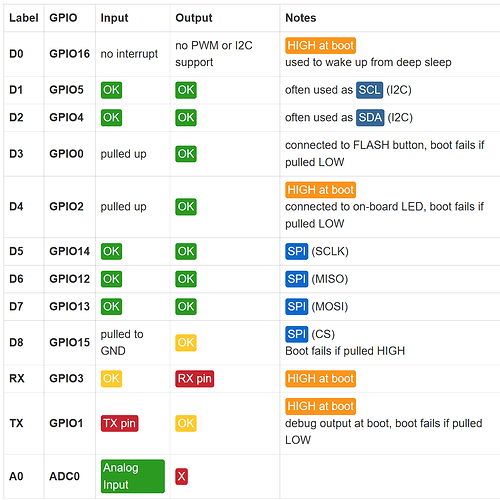

    I have an ESP8266 (WeMos D1 mini) to which I want to connect BME280 and DHT22 sensors. My question is if I connect the BME280 via I2C (GPIO4 and GPIO5) and the DHT22 via 1-wire (GPIO14) will it work? Will there be any problems? Will it be able to be programmed without problems?
    Thanks in advance for your help, regards.

    Connecting the BME280 and DHT22 sensors to the WeMos D1 mini, as you described, is perfectly feasible and should not cause any major problems. The ESP8266 has enough GPIOs to support both sensors, and the use of different communication protocols (I2C for the BME280 and 1-Wire for the DHT22) allows both devices to coexist on the same board without conflict.

    1. Check the exact I2C address for your BME280 sensor (could be 0x76 or 0x77) and set it accordingly in the `bme.begin()` function.
    2. The GPIOs used in this example (D1, D2, D5) are the GPIOs on the WeMos D1 mini board, which correspond to the following pin numbers on the ESP8266: D1 is GPIO5, D2 is GPIO4, D5 is GPIO14. Make sure you use the correct pin designations according to the pin table of your WeMos D1 mini module.

    Hello, the selected pins should not interfere with the programming and booting up of the ESP.
    • Connecting sensors to the ESP8266 via I2C and 1-wire simultaneously pinout.png (105.76 KB) You must be logged in to download this attachment.
