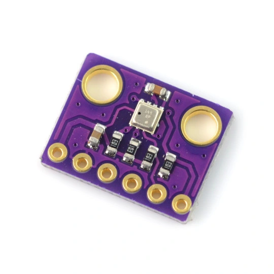

  • BME280 as an easy DHT11 upgrade
    #3 21041002
    Posts: 14765
    Rate: 12899
    Basically I can only agree. There are also slightly better sensors, for example BME280:
    BME280 sensor module on a purple circuit board with visible solder points and components.
    A beginner can treat this as an exercise and convert the code to a different sensor, basically it will only come down to changing the library, connecting the element, and adding one variable to the measurements (if we want to take pressure into account)

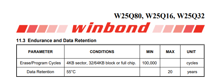

  • Suggesting EEPROM or flash instead of RAM for measurements
    #8 21041976
    Posts: 14765
    Rate: 12899
    @mariomario, you have information on the Internet how much RAM is on ESP8266, but the question is, are you sure you want to use RAM? So that it disappears after a power loss? Maybe it`s better to use some external chip, for example EEPROM or Flash, you can even desolder these from electronic waste... or, as a last resort, write to flash from ESP8266, but in a clever way, saving erase cycles, see my OpenBeken project for the flash vars code which optimizes flash usage:
    https://github.com/openshwprojects/OpenBK7231...ob/main/src/hal/bk7231/hal_flashVars_bk7231.c
    Additionally, if we were to optimize for memory, we would need to improve the data structure. I write the tutorial simply and without complications, but if we were to reduce the amount of memory:
    Code: C / C++
    you could lose a lot of weight. Now this is 12 bytes (16 if time_t is 64 bit). What resolution and temperature range do we really want?
    What humidity resolution?
    I think that instead of two floats (8 bytes), I would pack it in 3 bytes... probably not in 2, but 9 bits for humidity and the rest for temperature...
    time_t (you would need to check whether it is 32-bit or 64-bit) could also be reduced, for example by counting seconds or tens of seconds from January 1, 2024. Or even minutes, because is accuracy down to the second necessary?
    If you want, I can work on something similar in the next part, or we can think about it together.

    Are you sure you need to save flash so much?
    For example, W25Q80 withstands a minimum of 100,000 deletion cycles (4KB sector):
    Fragment of Winbond memory specification regarding endurance and data retention.
    Assuming that there is a reading every 15 minutes a day, i.e. 96 readings, and that you exhaust one entire sector, you will exceed the limit after 100000/96 = 1041 days
    However, if you use the solution I linked earlier , which saves erase cycles, then assuming that the measurement structure is 16 bytes, you improve the situation by 4096/16 = 256 times.
    So after 266496 days you will reach the minimum number of erase cycles... after 729 years. This assumes that you tire out one sector, but you can separate them, e.g. 16... then 729 increases even 16 times.
