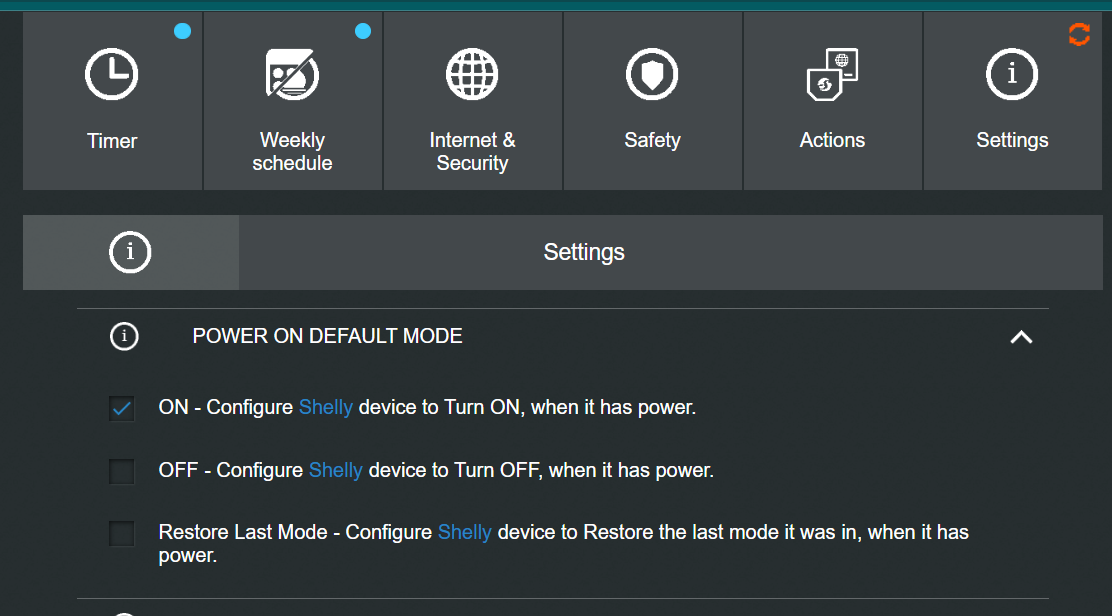

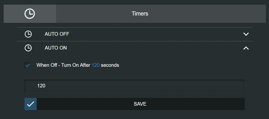

    #9 20863882
    b_bingo
    Posts: 12
    I was already about to write you that you are probably some of this but I will refrain and help you instead.
    Find the IP address of the socket and log into the control panel (password and user are probably in the box with the manual or on the socket). In the timers option, tick AUTO ON / this is your self-activation function after switching off the contraption via the app and when you no longer have internet. The device will simply measure the time you specify after switching it off and will switch it on again by itself - how clever.
    If, during the countdown to switching it on again, the bad engineers from the power industry turned off your electricity, imagine that the engineers who designed the device also thought about this - in the SETTINGS / POWER ON DEFAULT MODE option mark ON. And don't be so irritated...
