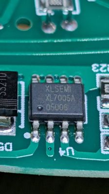

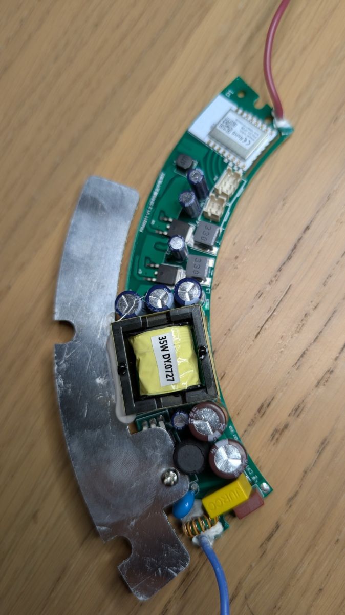

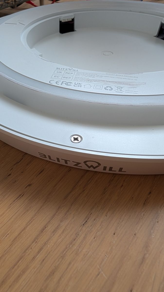

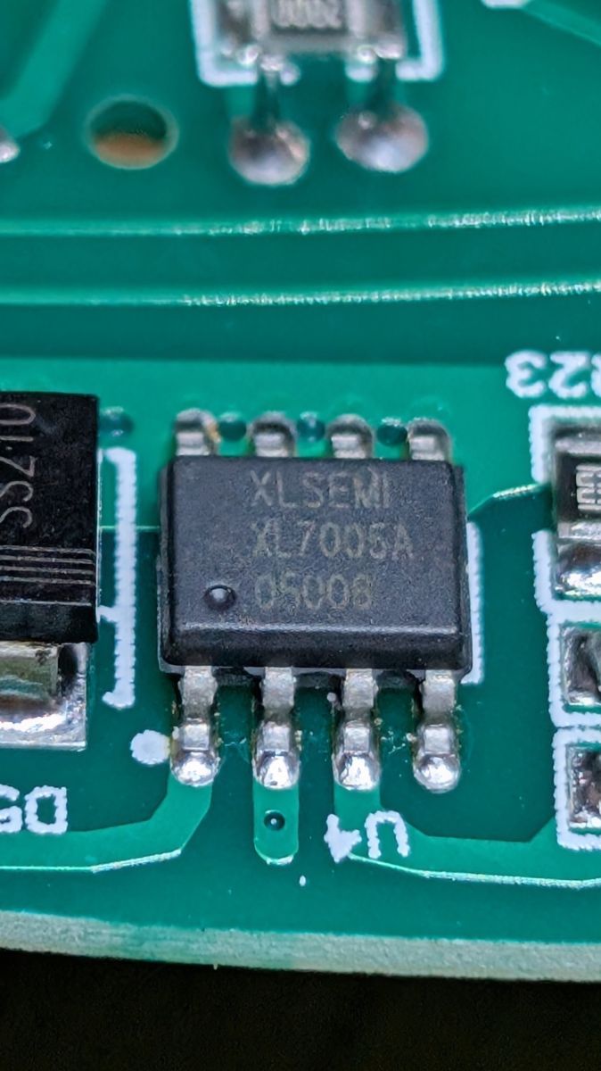

    Purchased a BlitzWill® BW-CLT1 LED light and after opening it up, it has a Tuya WB3L module inside.
    Brand: Blitzwill
    Model: BW-CLT1
    Chip: BK7213T (WB3L)
    for backup and flashing, used 230400 baud as the default 115200 not worked for writing.
      "vendor": "Tuya",
      "bDetailed": "0",
      "name": "Blitzwill CLT1 LED smart ceiling light RGB atmosphere",
      "model": "BW-CLT1 30",
      "chip": "BK7231T",
      "board": "WB3L",

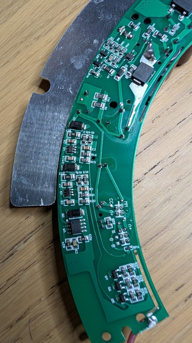

    WB3L module on green PCB with capacitors and multicolored wires Curved PCB from LED lamp with electronic components and attached metal part Tuya WB3L module on a curved LED lamp PCB with power components and heat sink. Close-up of XL7005A chip on green PCB with visible solder joints and traces [BK7231T / WB3L] Teardown of BlitzWill BW-CLT1 led smart ceiling light 30cm with RGB atmosphere [BK7231T / WB3L] Teardown of BlitzWill BW-CLT1 led smart ceiling light 30cm with RGB atmosphere

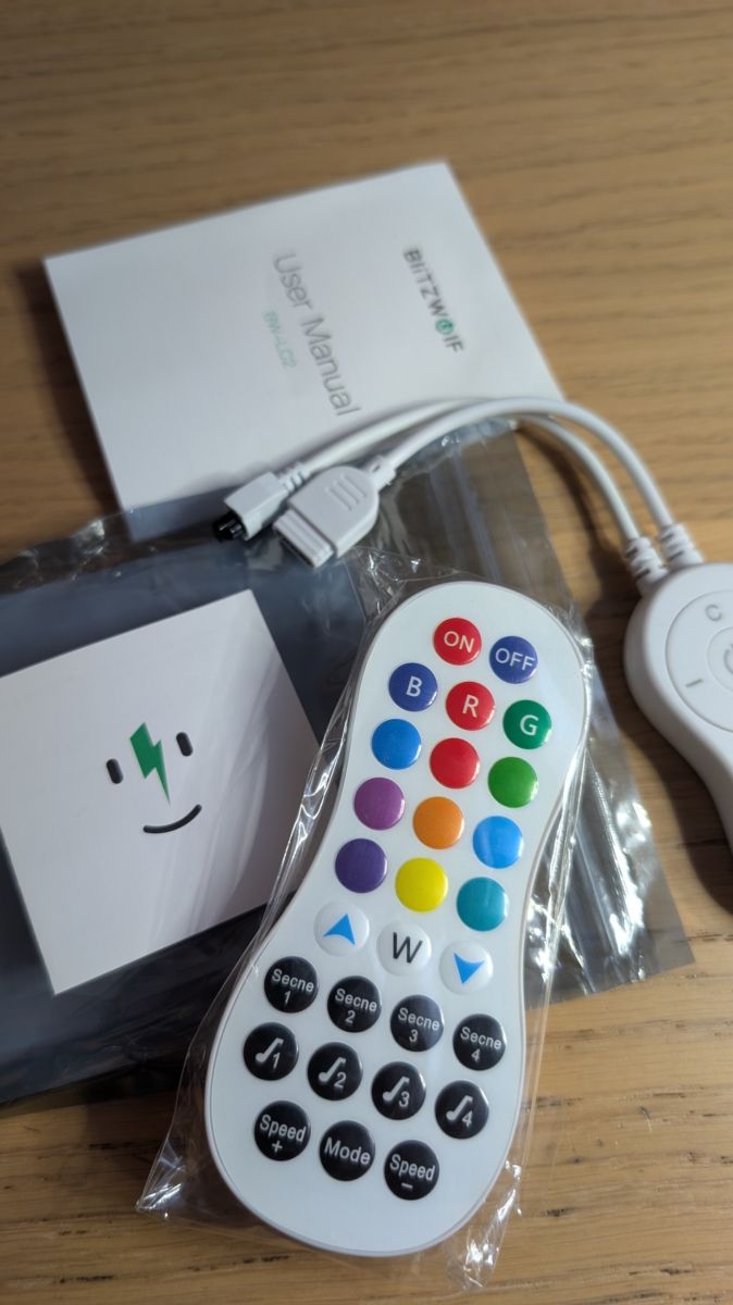

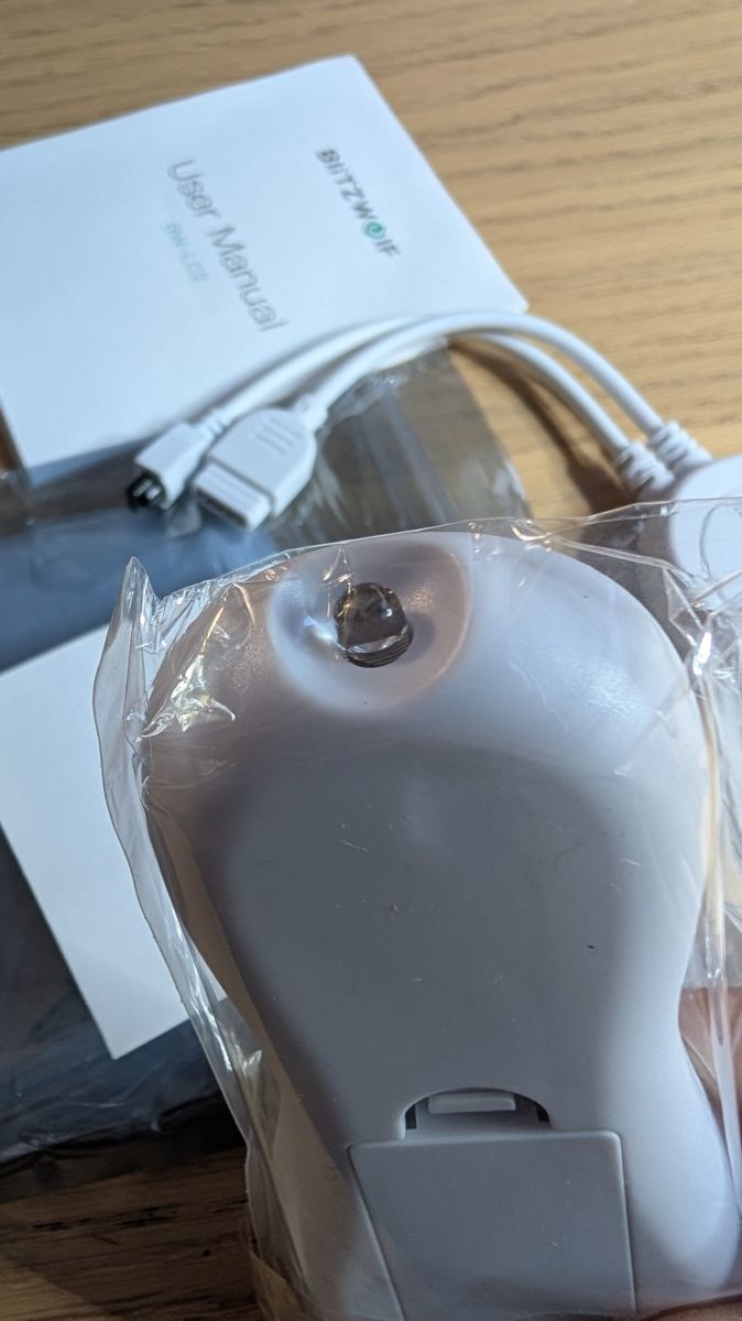

    photos about the remote:
    BlitzWolf BW-CLT2 remote in plastic wrap with accessories and user manual LED remote, BlitzWolf BW-CLT2 manual, and connectors on wooden table
  • Questions whether the remote is IR and LEDs use raw PWM

    It doesn't look like WS2812 device, just pure color, so probably not that hard to support. Should work out of the box. Is it using raw PWMs or is there integrated LED controller?
    The only thing that worries me is the remote. Is it IR-based? We have IR support, but we don't have Bluetooth.

    I had a second look at my order and this device is BW-CLT1. Sorry for the confusion!
    Also posted pictures of the remote; it looks IR-based, but personally I never used it. :)

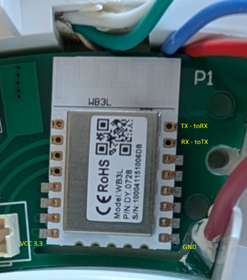

    I'm planning to perform the firmware backup, then flash the device.
    My understanding about the process is the following:
    - connect my CH340 UART to the WB3L (GND, TX1, RX1)
    - add 3.3 V to the PCB using a bench power supply (I have to find the right power supply points)
    - download OpenBK7231T / BK7231GUIFlashTool to perform backup
    - flash latest firmware for BK7231T
    - since there is no published device template, try/error to find the right pins to determine the working setup.
    Do you have suggestions or feedback if my approach is the right one?
    Many thanks for your help!

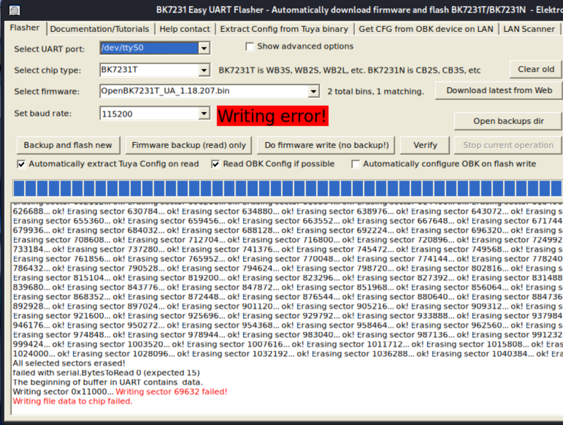

    >>21745941 I was able to create a firmware backup (using option: "Firmware backup (read) only"), then tried to flash OpenBeken firmware ("Do firmware write (no backup!)"), which is failing. Shortened the wires between my CH340 and the PCB to ~10 cm, increased the external power to 3.4 V; still getting the following error. Any idea what's wrong?
    update: https://www.elektroda.com/rtvforum/topic4150483.html#21732182
    setting higher baud rate solved the problem, write successful.

Discussion of a BlitzWill BW-CLT1 30 cm RGB smart ceiling light teardown and firmware flashing on a Tuya WB3L module with BK7231T/BK7213T chip. The device appears to use raw PWM outputs for the LEDs, and the remote is likely IR-based. A firmware backup was made successfully with OpenBK7231T/BK7231GUIFlashTool, but initial flashing failed at the default 115200 baud rate. After shortening UART wiring, raising the external supply to about 3.4 V, and increasing the serial baud rate to 230400, the OpenBeken firmware write succeeded. The user then planned to identify the correct pin mapping and configure the light in the first post.
