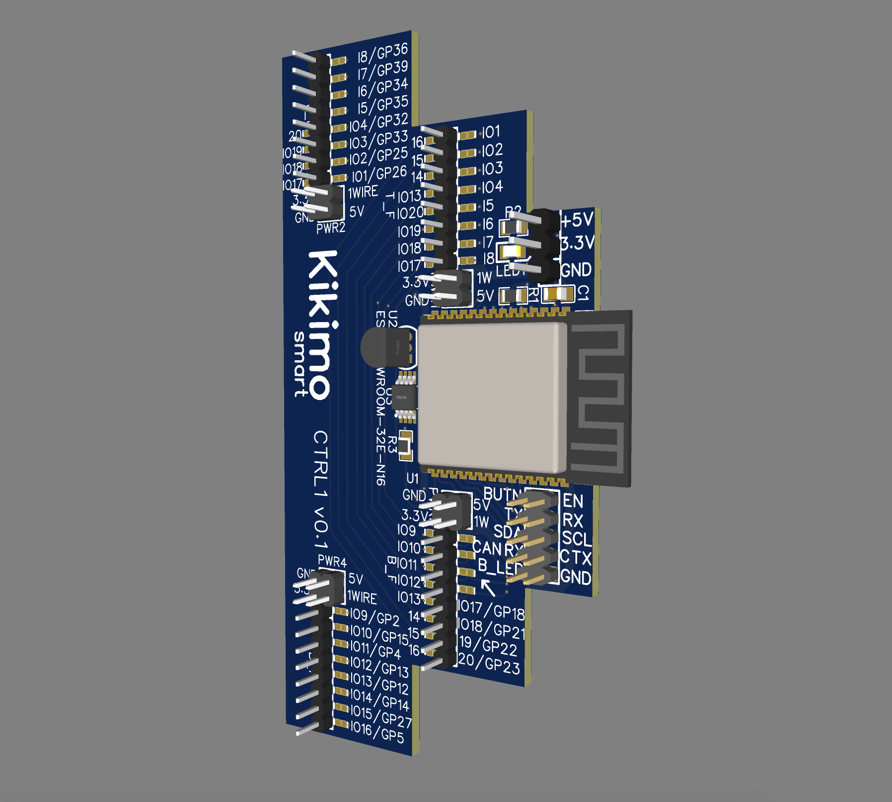

    Hi,
    The moment is approaching to equip my new house with electrics, lighting and an alarm system and I have started to prepare for a Smart Home. Ready-made solutions don't satisfy me, and on top of that they are horrendously expensive, so I'm developing something of my own.
    At first I thought about using ready-made modules from aliexpress and making a spider web on the backplane, I see a lot of people doing this and it's quite effective, but I've seen a few people replacing it with something more integrated made to their own design.
    My objectives are as follows:
    - professional appearance - DIN TH35 enclosures,
    - full modularity - one control board for many applications, based on ESP32,
    - additional boards for specific functions,
    - communication over CAN - proven multi-master protocol supported by many devices and systems, - power supply of 5V logic,
    - free power supply of circuits (not connected to control circuits),
    - possibility to use any software such as ESP Home, ESP Easy or any SDK such as Arduino, etc.

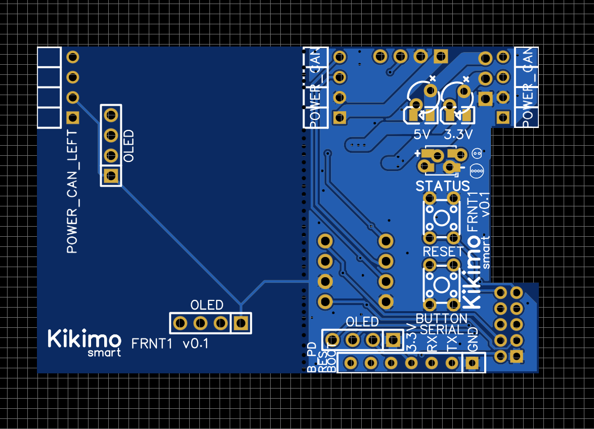

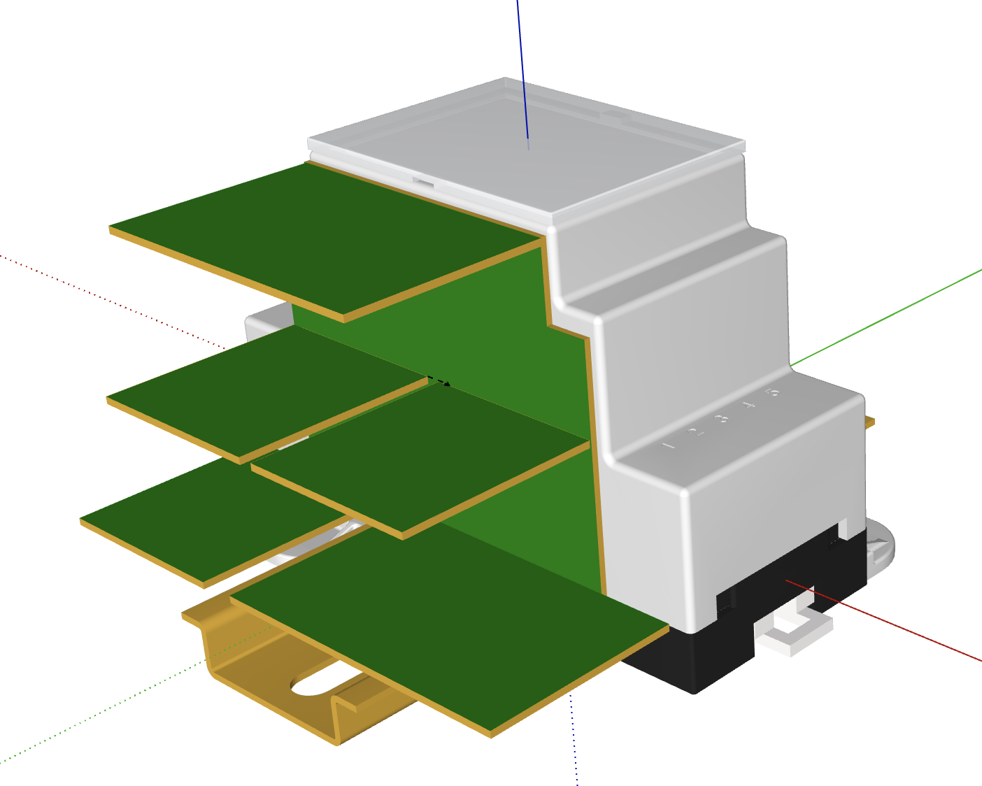

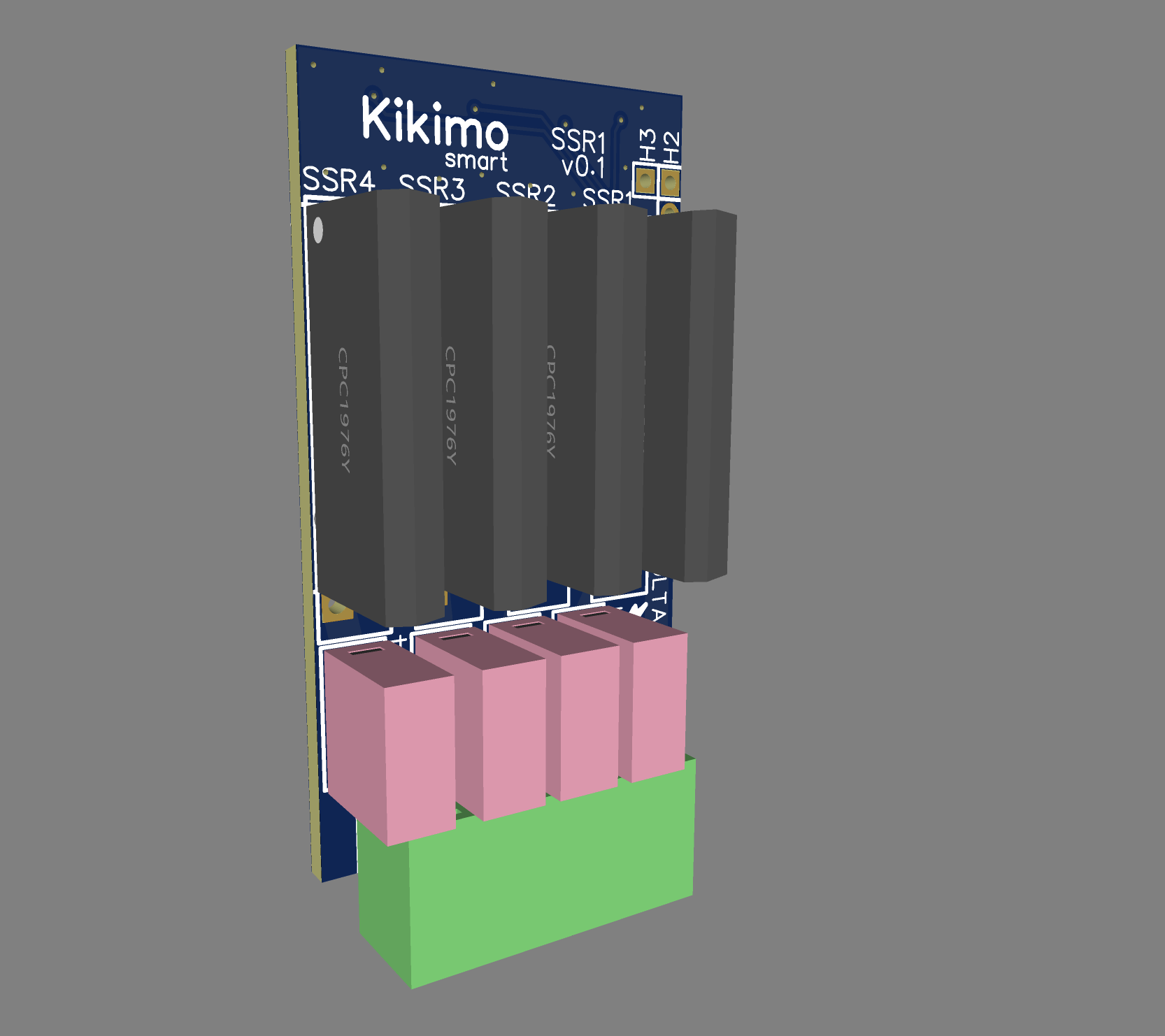

    Physical design:
    - use of some inexpensive and universal DIN housing
    - base size is two modules
    - placement of the boards as follows:
    3D model of Kikimo FRNT1 board in a DIN enclosure.
    - possibility to combine function boards in length
    - possibility to place two and more sets of boards in one enclosure in order to increase the number of IO
    - connection of modules by means of sockets in the side walls of the enclosure and goldpins, the only disadvantage is that the module will have to be moved before removal, if this is a misfire I will work out some other way of connecting, if I found some nice connectors with spring pins at 1mm it would be ideal

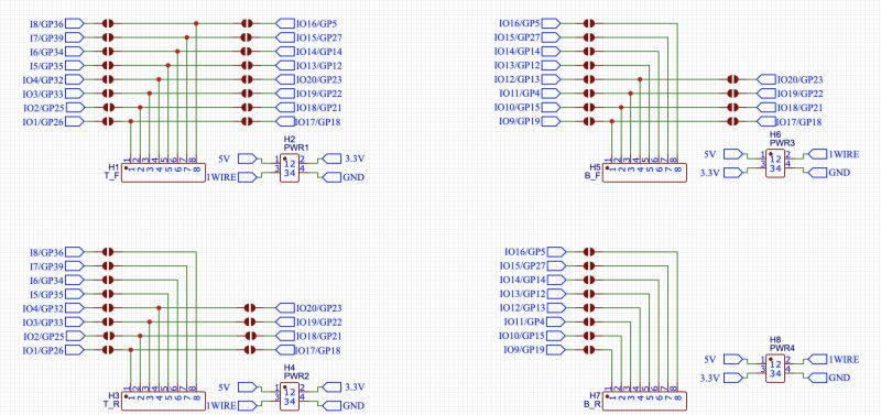

    The available number of IO will depend on the ESP32 model:
    - ESP32-WROOM-32 - 20 GPIOs will realistically be available (including 4 input-only),
    - ESP32-S3-WROOM-2 - 27 GPIOs to be used,
    - ESP32-S2-SOLO-2 - 31 GPIOs to be used.
    Why 3 different ESP32 modules? The classic ESP32 is recognised as proven in virtually every project, the WLED allows hardware control of 10 WS281x channels. ESP32-S2/S3 have more GPIOs but most projects have not found them completely proven.
    Why not port expanders e.g. MCP23017? One ESP32 costs as much as two expanders, but has incomparable capabilities and more ports.
    In addition to the specified quantities, each control board will have the following outputs:
    - CAN TX/RX,
    - serial TX/RX,
    - 1WIRE for temperature sensors,
    - RESET button, to which line as output will be connected WS2812b LED showing the status,
    - BOOT button, to be used arbitrarily when not programming the circuit,
    - power supply status LEDs 3.3V and 5V (1mA) status LEDs,
    - if OLED I2C display will be used then the number of GPIOs will be reduced by 2.

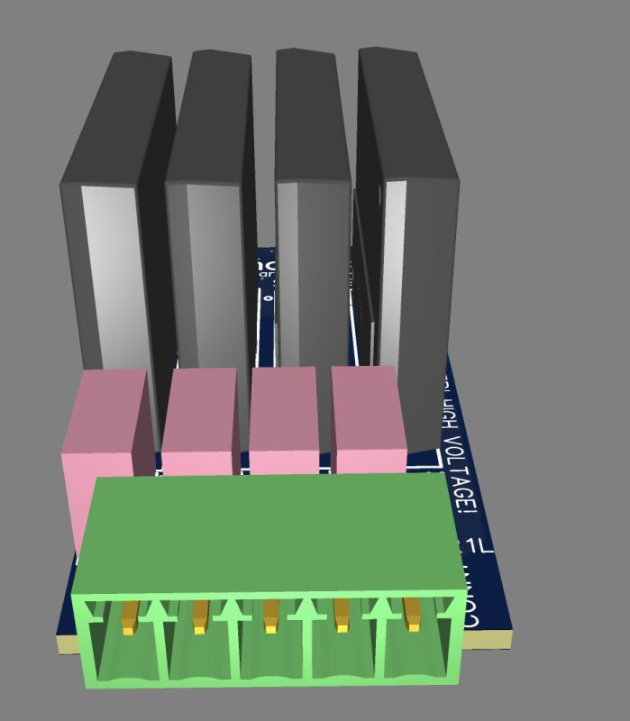

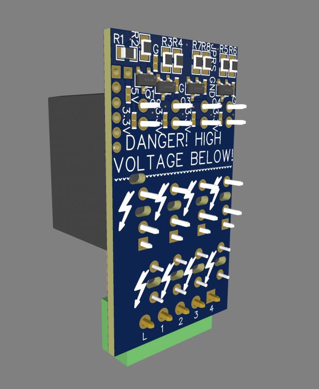

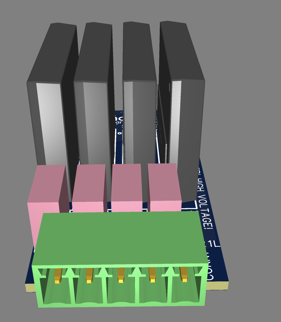

    Planned board types (width 2 DIN modules), possibility to place up to 4 boards in one housing:

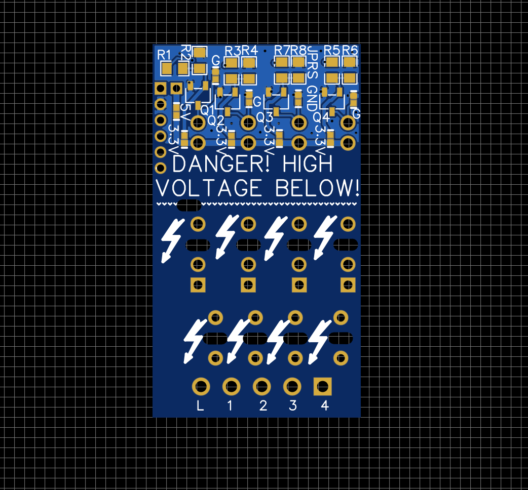

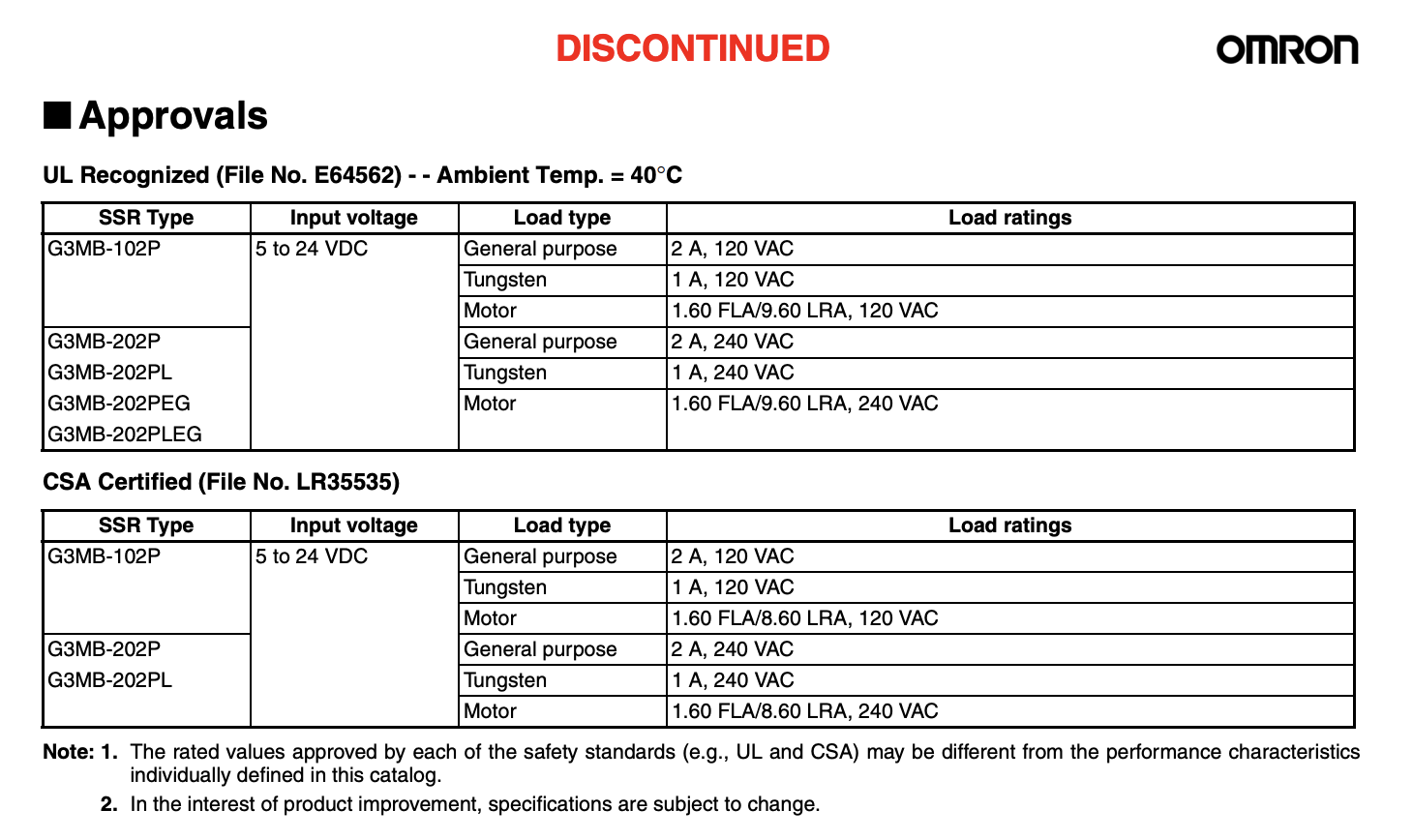

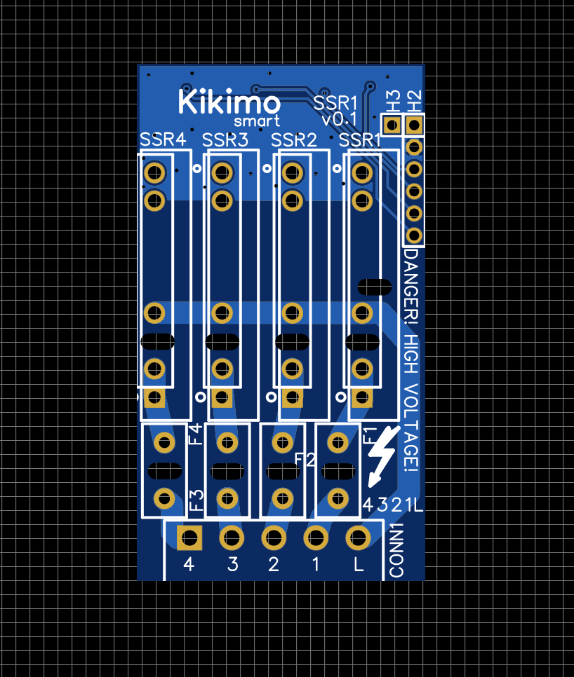

    - 4x SSR 2A board,
    - 4x relay 5A board (common input),
    - 2x relay 10/16A board (NO/NC), to be used e.g. at roller shutters,

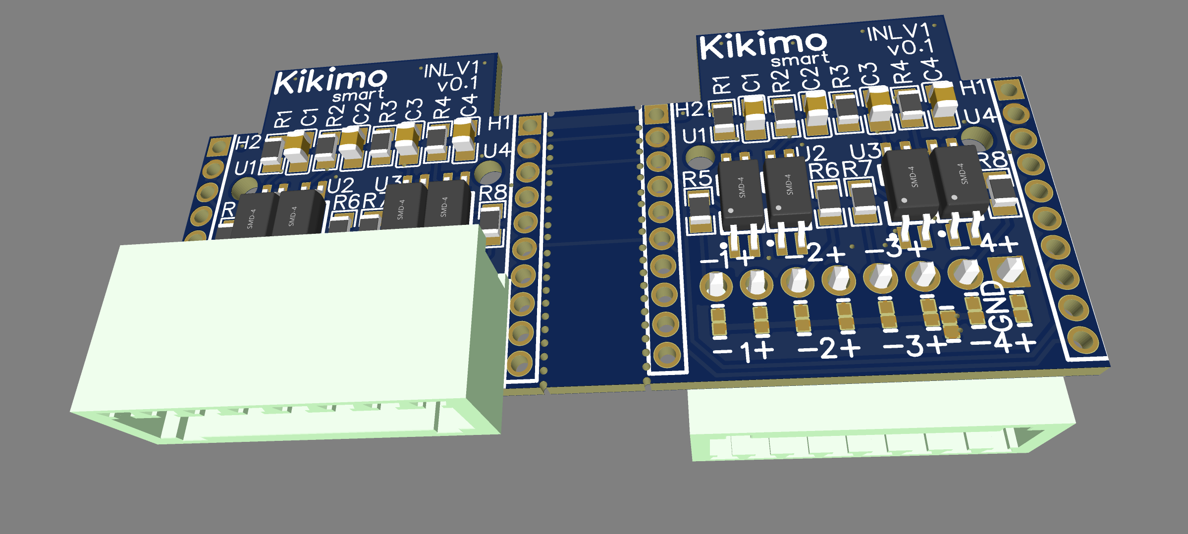

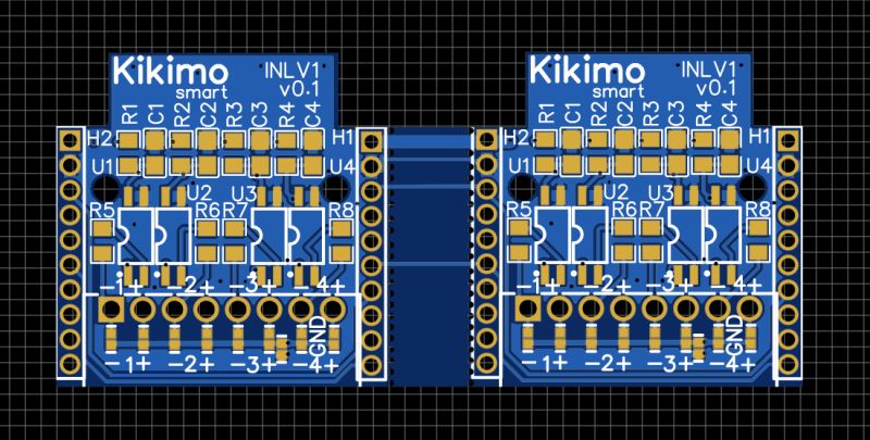

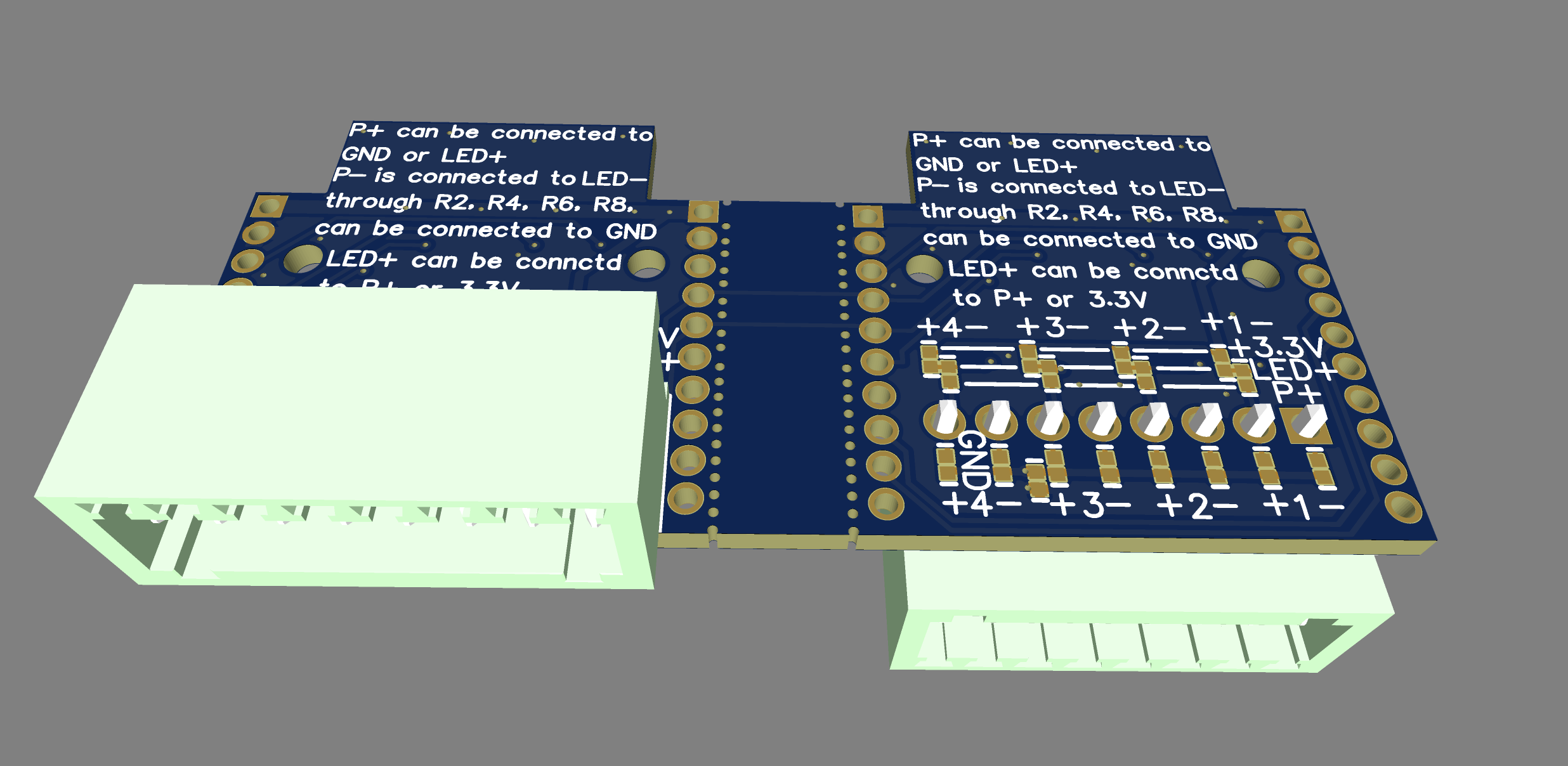

    - pixel/PWM/MOSFET board: 4x MOSFET + 4 isolated outputs to control WS281x,

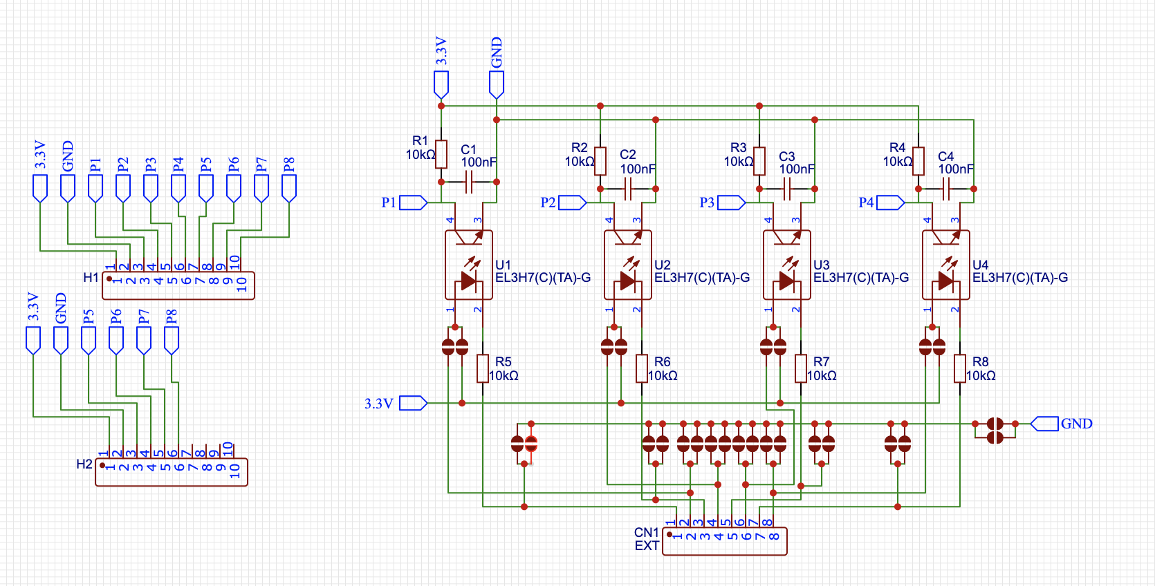

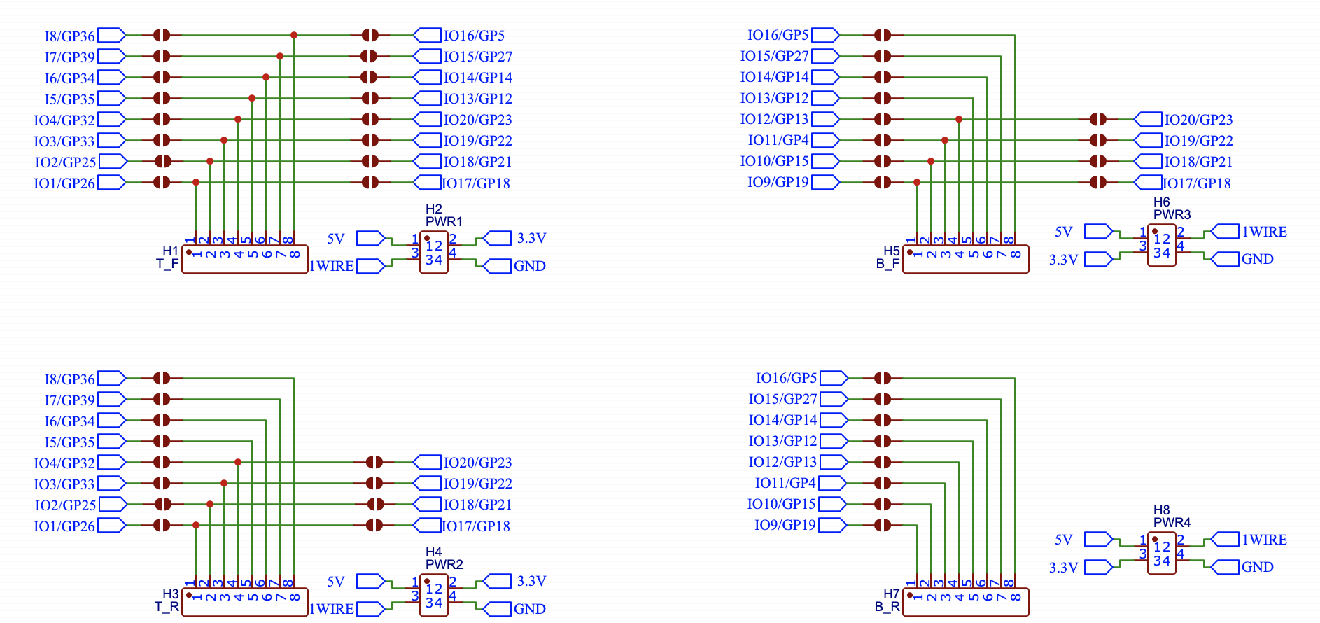

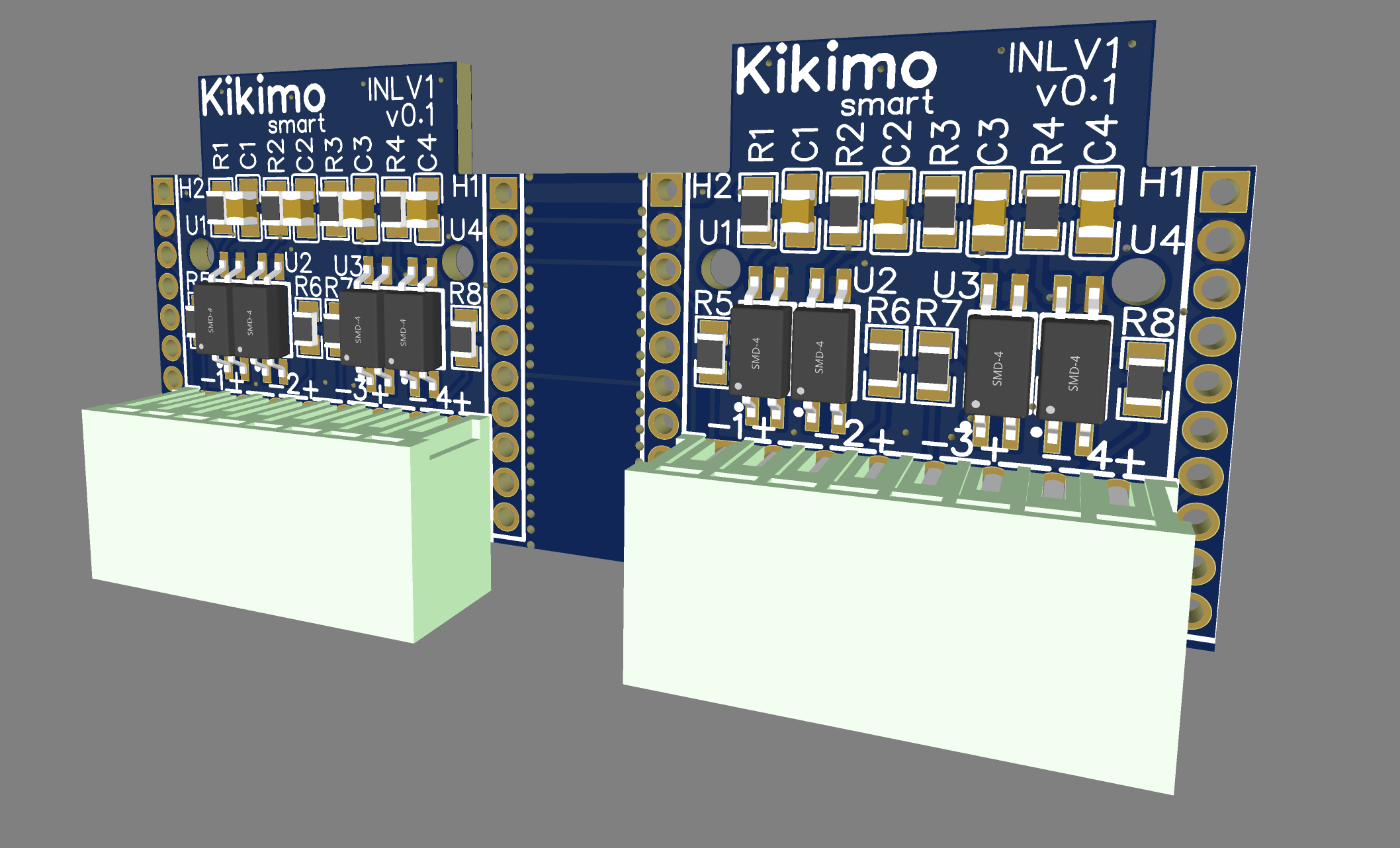

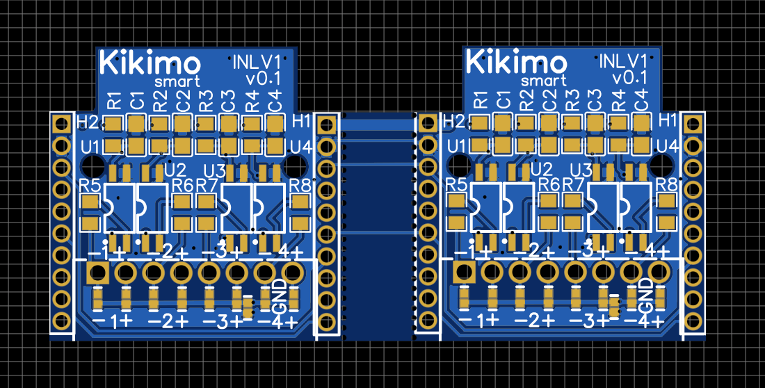

    - IO board: 2 RJ45 connectors on board, optically isolated, can be mounted in pairs. on the top and bottom of the board, i.e. a total of 8 RJ45s with the possibility of relatively free configuration of all 20-31 GPIOs via a matrix of solderable jumpers on the PCB.
    -an alternative IO board with plug connectors (screwed alb springs), 12 pins per board,
    - CAN-CAN-ETH board, connecting the internal CAN of the system to the ethernet and separated CAN e.g. for the needs of can2mqtt.
    The boards will be able to be mounted in any configuration, i.e. executive boards at the bottom, input boards at the top (or vice versa if you wish).
    The boards will have twisted or spring-loaded plug connectors, adapted to the current load.
    I plan to use the IO boards also for DIY alarm, instead of optocouplers by mounting waktrols to obtain parametric lines.

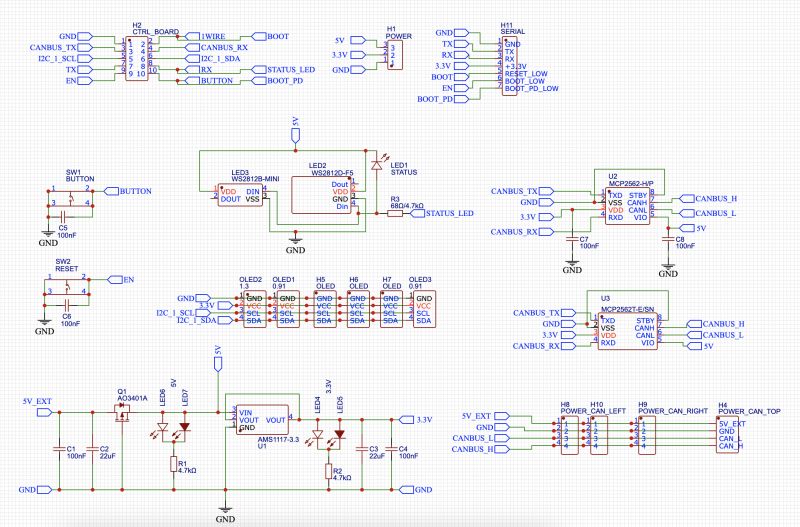

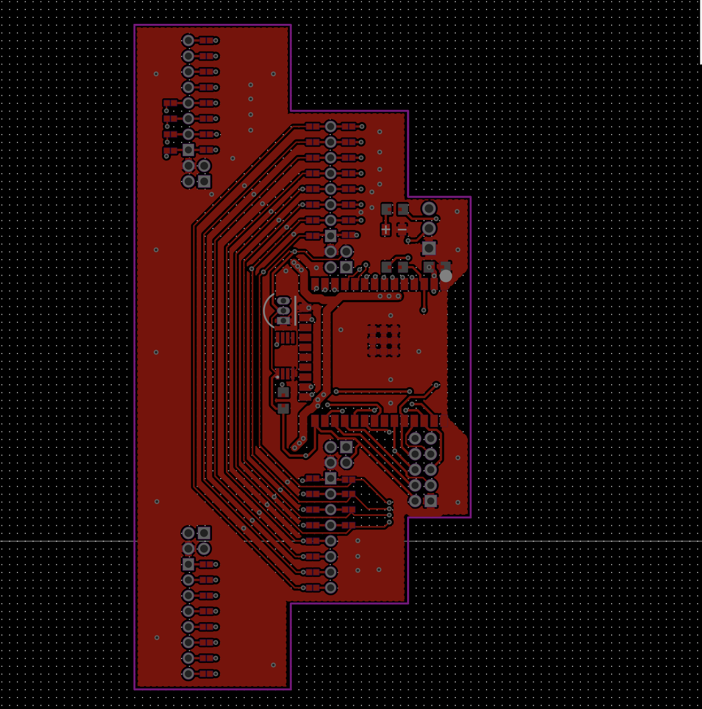

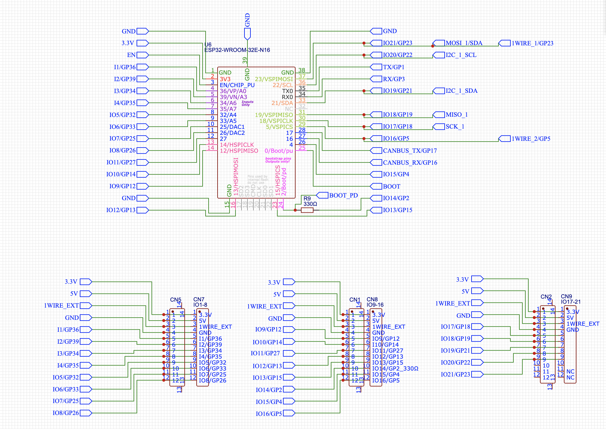

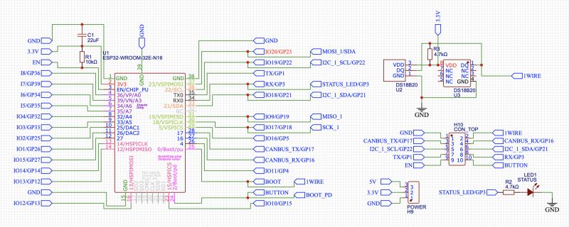

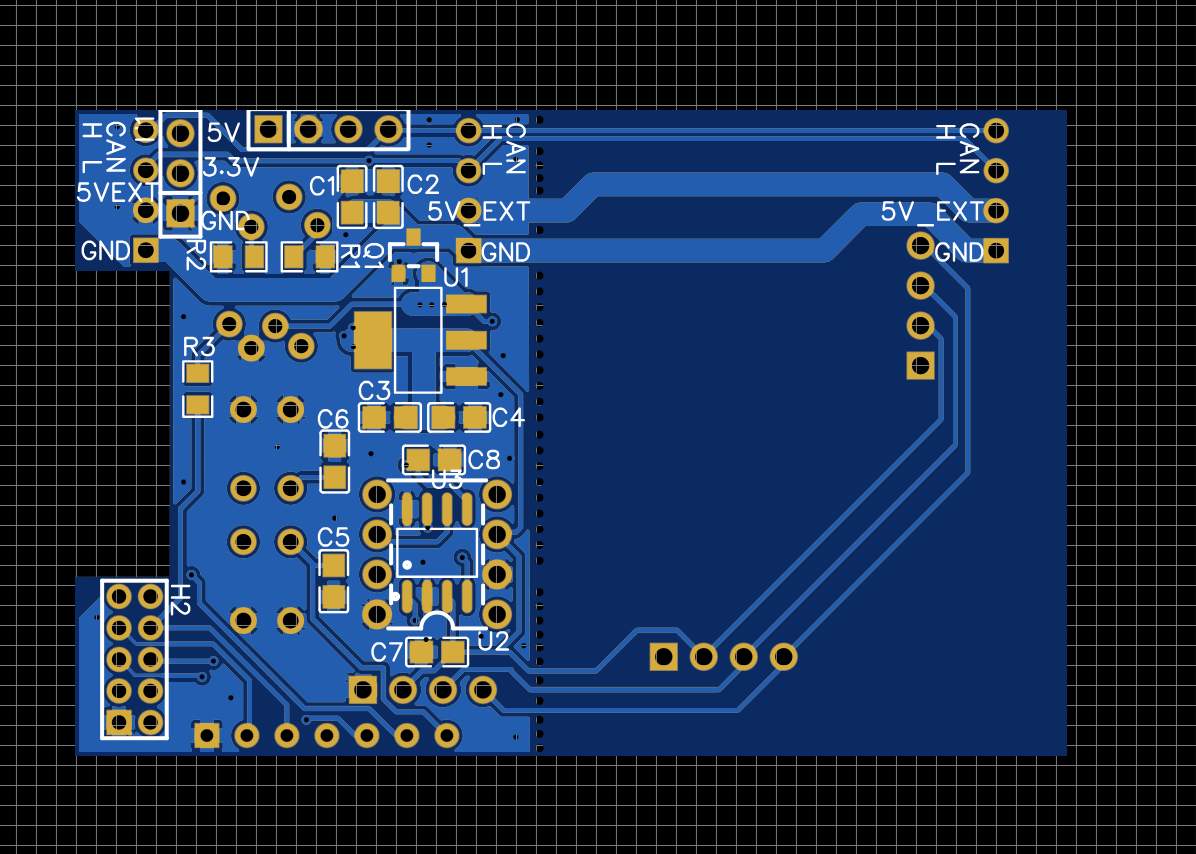

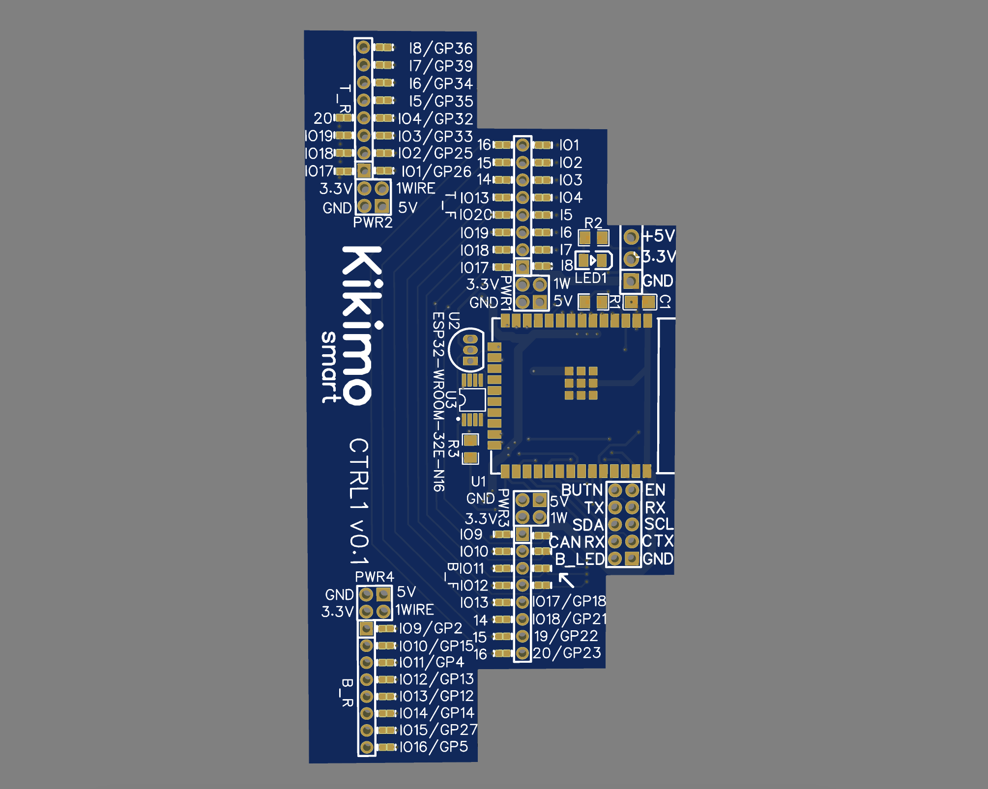

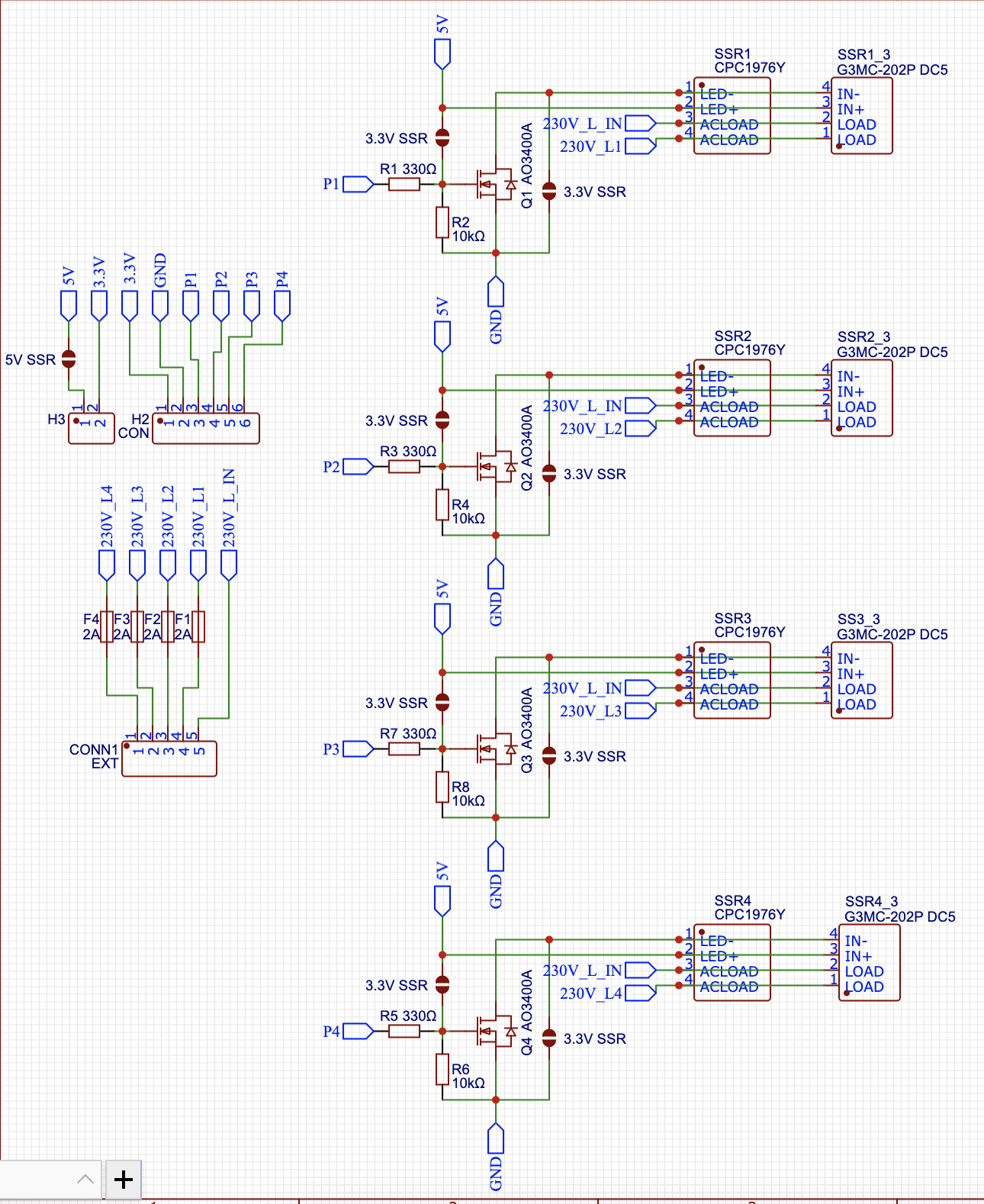

    Control board
    ESP32-.WROOM-32E
    Electrical schematic of a control board with ESP32-WROOM-32E and GPIO connectors.

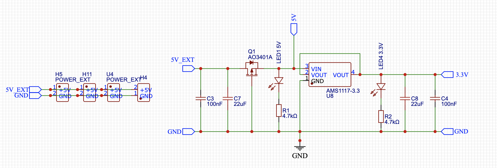

    Power section, protected against reverse polarity by a MOSFET
    Block diagram of power supply section with MOSFET protection
    CAN and serial
    Connection diagram for ESP32 controller with CAN bus and serial interface.

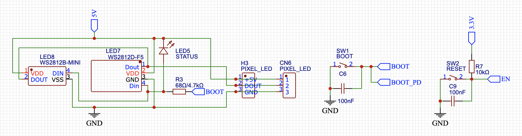

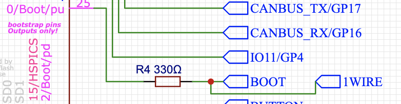

    Programmable status LED (WS2812b or regular LED depending on preference), connected to GPIO0, which is generally difficult to use, but for this.
    Circuit diagram with LED modules, BOOT and RESET buttons, and GPIO connections.

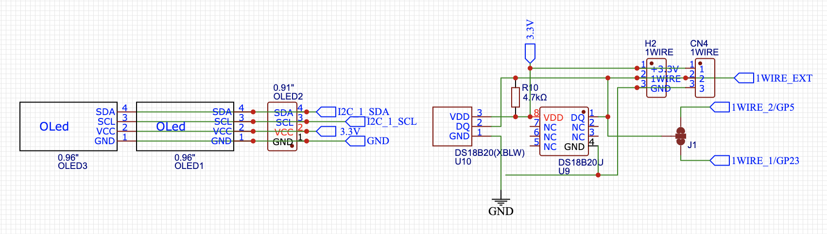

    Optional OLED display (for those interested - single colour draws about 20mA), and in my opinion the very important 1Wire for temperature measurement, especially of relays/SSRs/MOSFETs.
    Wiring diagram for OLED displays and DS18B20 temperature sensors.

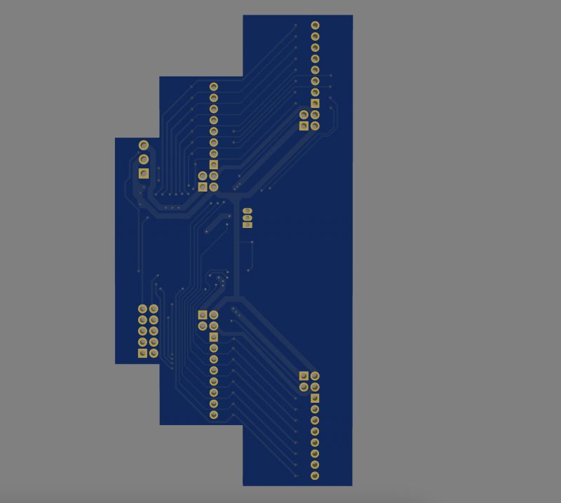

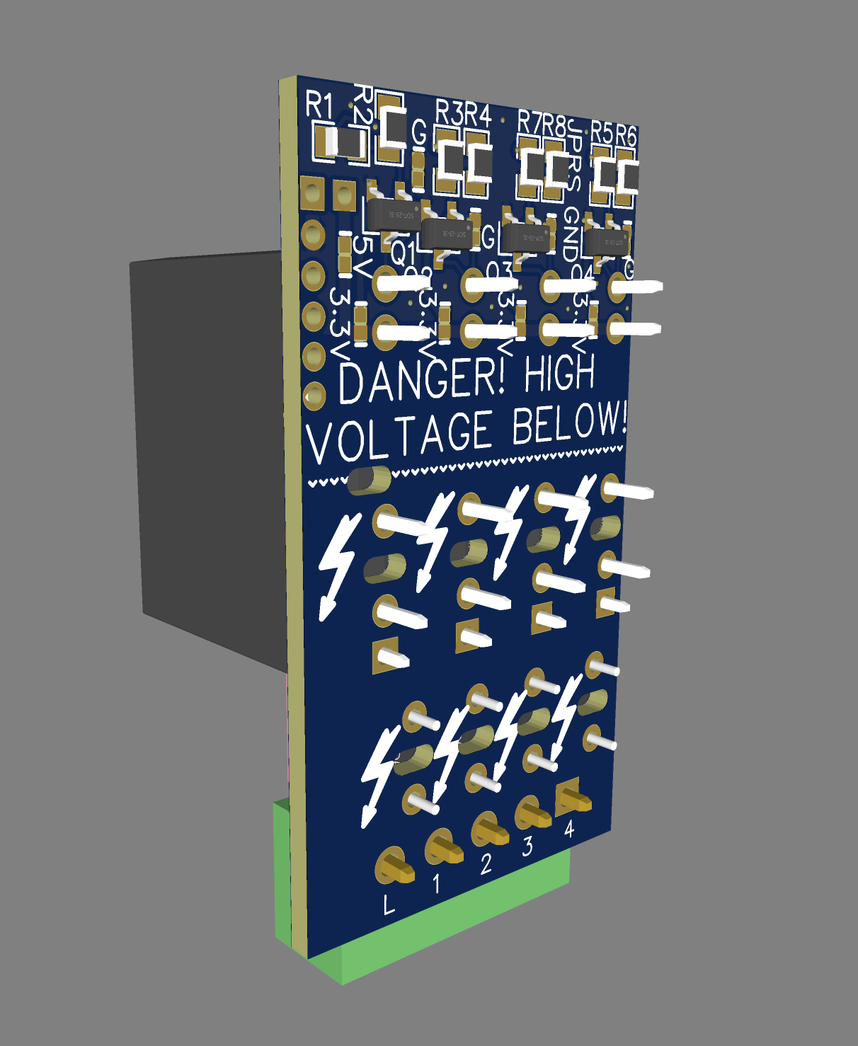

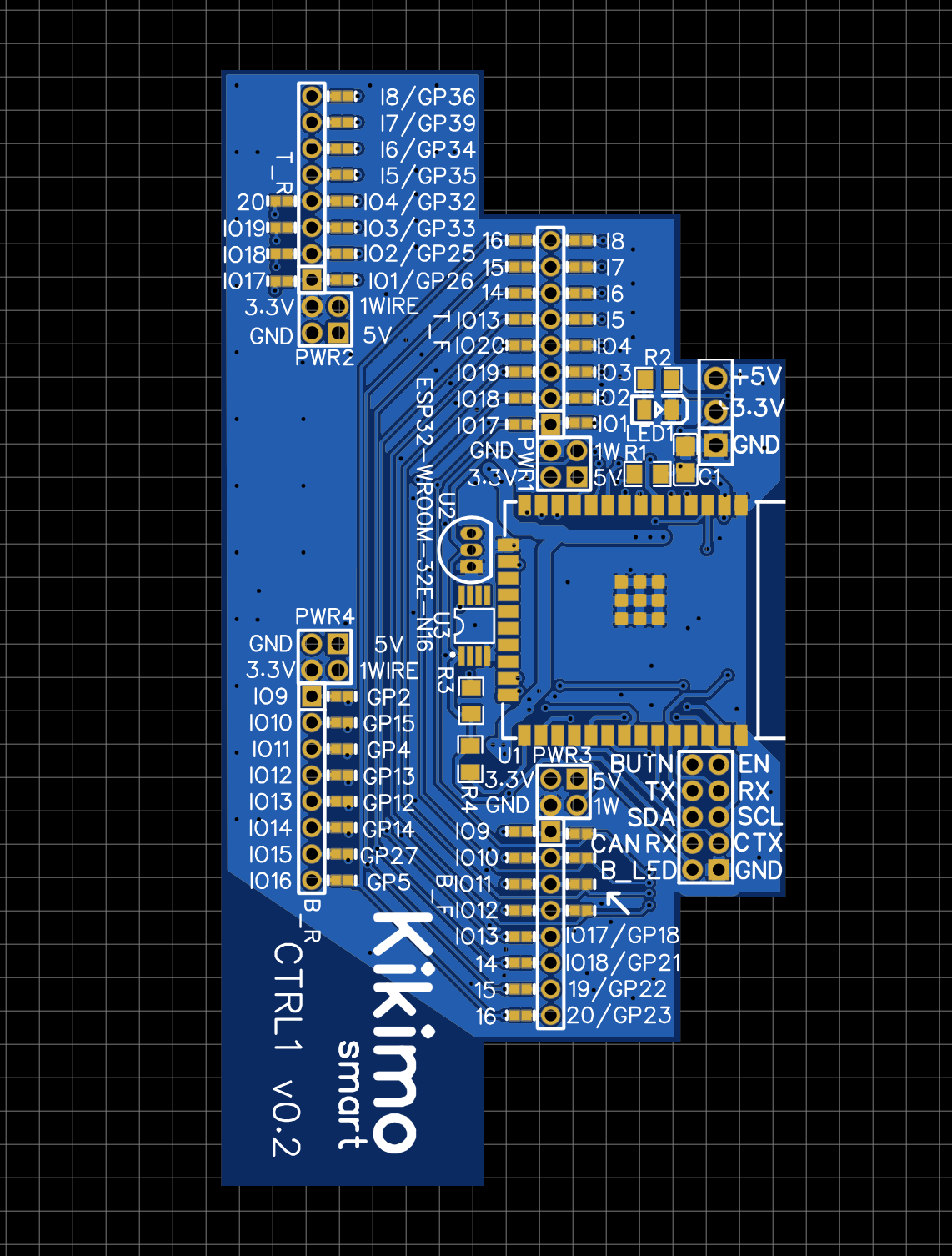

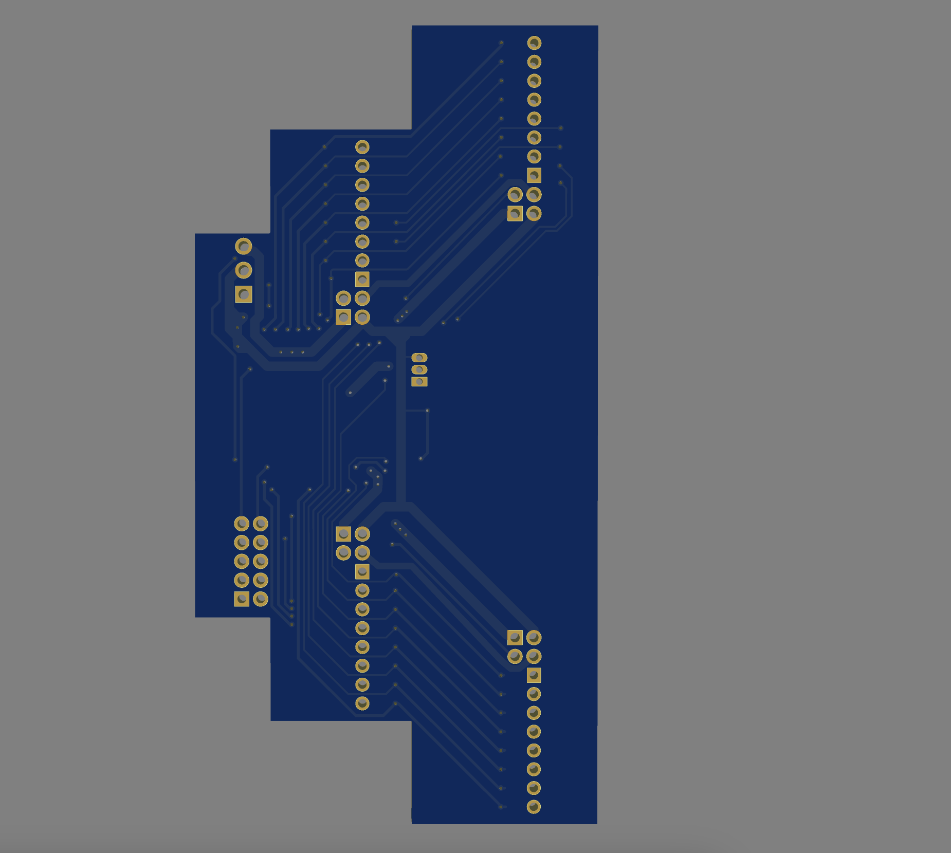

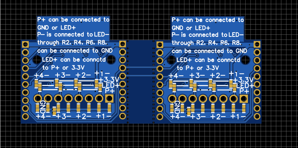

    I've also designed the board, but in the meantime I've changed the concept, originally I was thinking of a control board on the front of the chassis and connecting by tapes with connectors JST1.25, now I have to design it on the side with solder joints.

    But this is supposed to be a classic centralized smart home system. Everything in the switchboard.
    I thought the drawing showing mounting in DIN enclosures clearly shows this ;)

  • ESP32 CNTRL1 pin assignments and reworked schematics

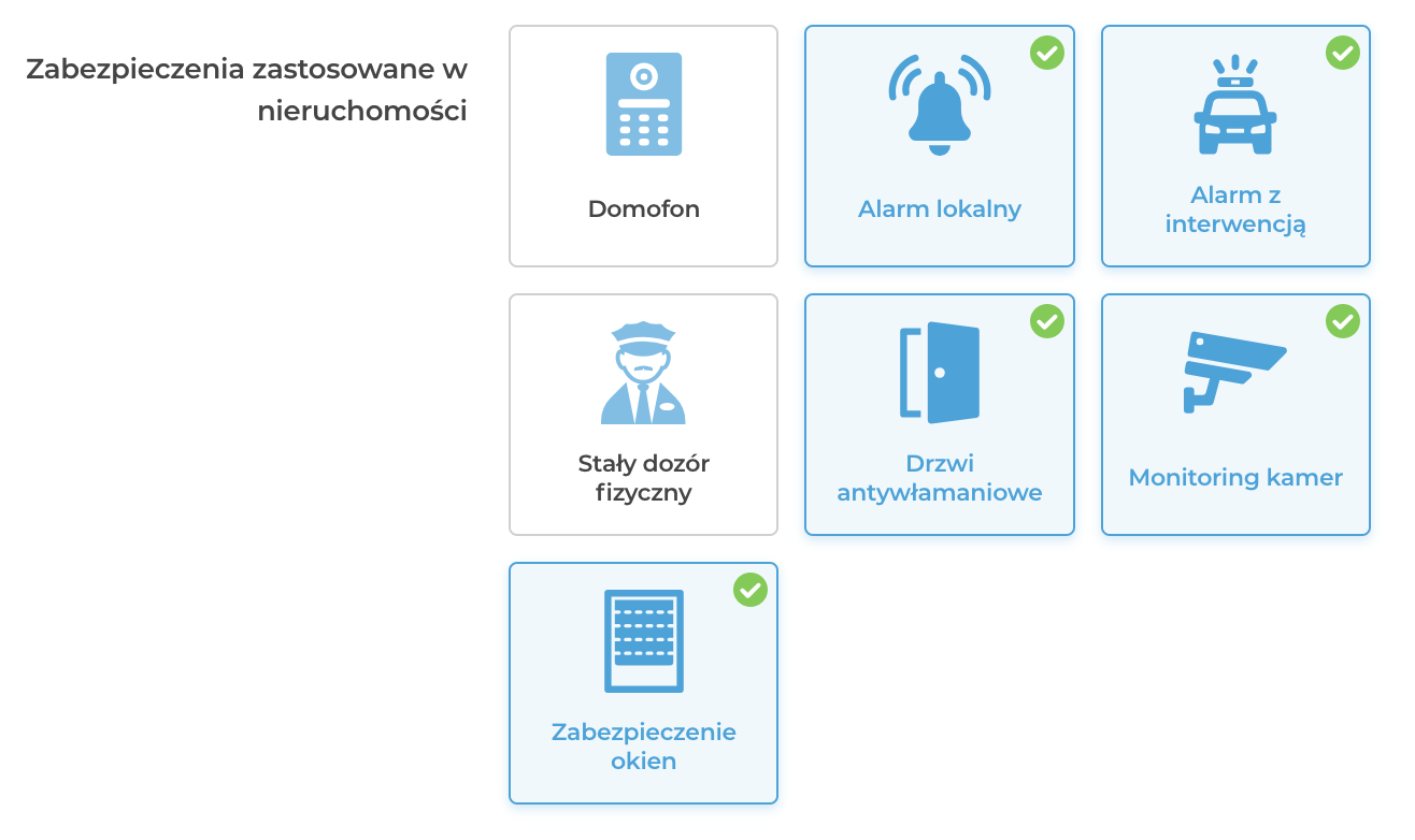

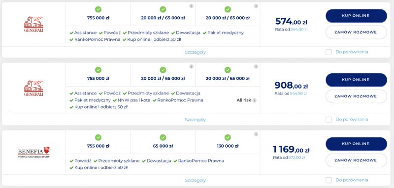

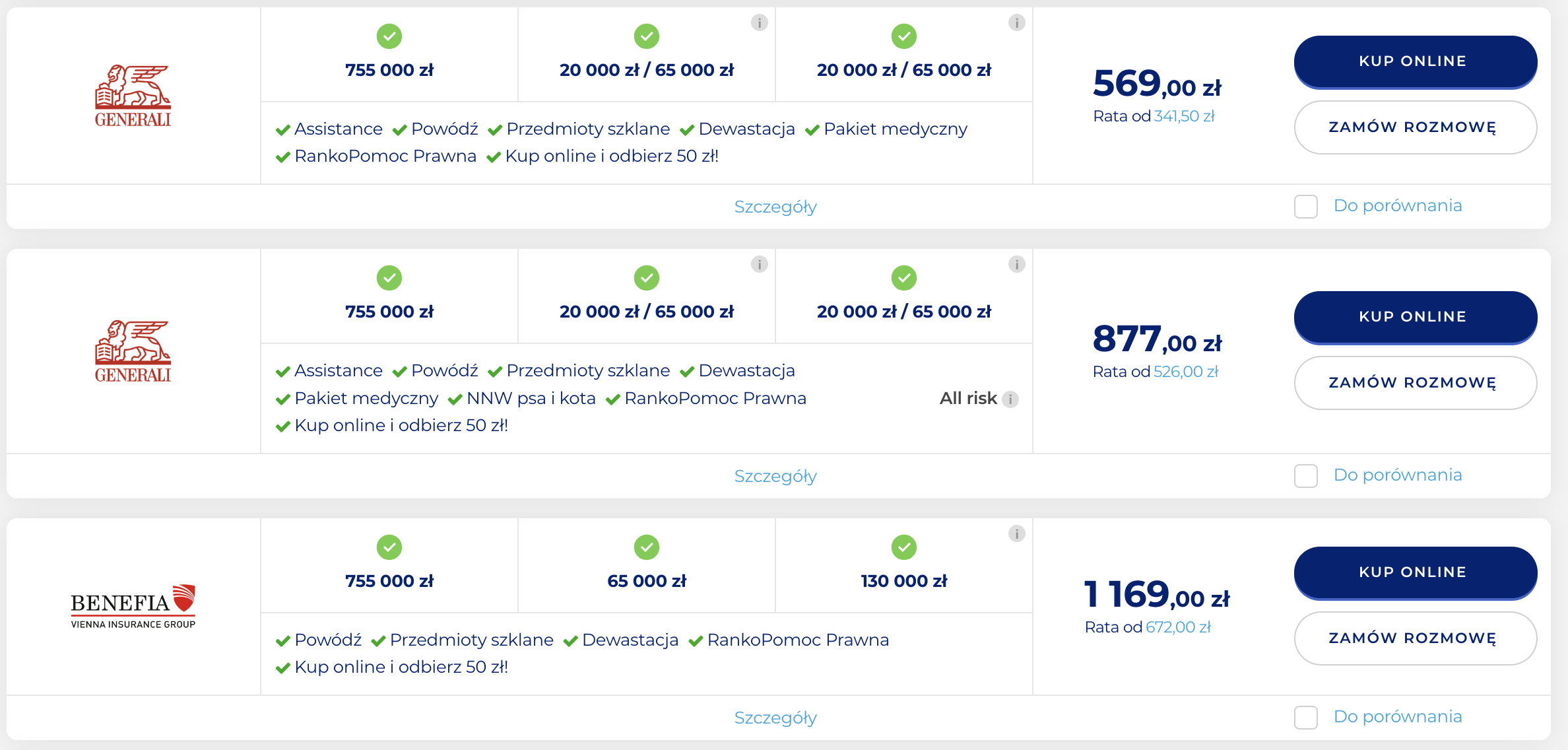

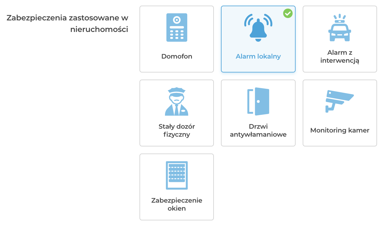

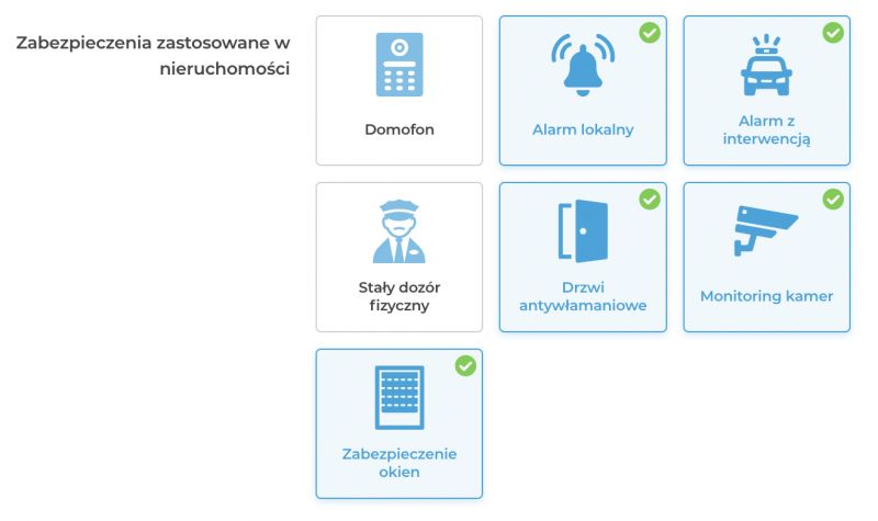

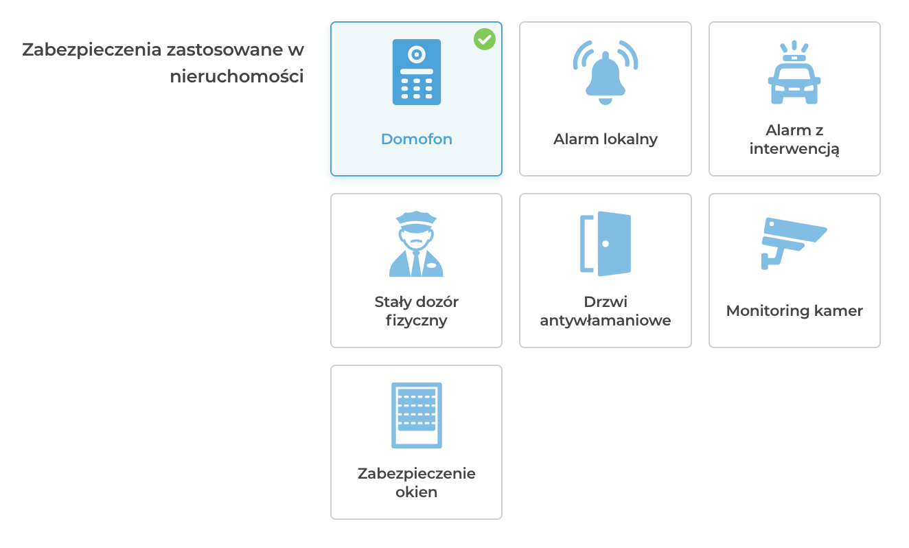

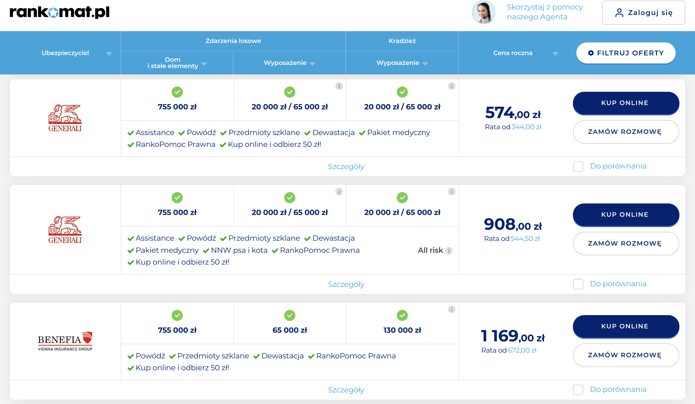

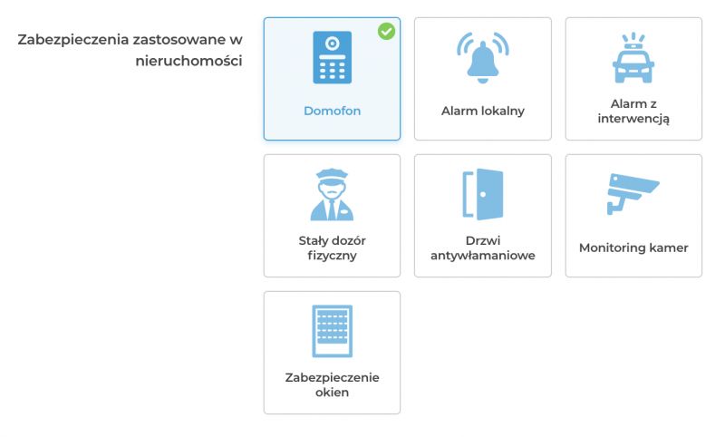

    JanuszM wrote:
    Additionally having a certified SSWiN will get you a discount on your home insurance.
    It seems so, but not really: Icons showing various property security measures, including an intercom, alarms, surveillance, and physical guard.
    Comparison of insurance offers on rankomat.pl
    It turns out that an intercom is enough :D And I still have cameras.
    The image displays various property security options, such as an intercom, local alarm, alarm with intervention, physical security guard, anti-burglary doors, camera monitoring, and window security.

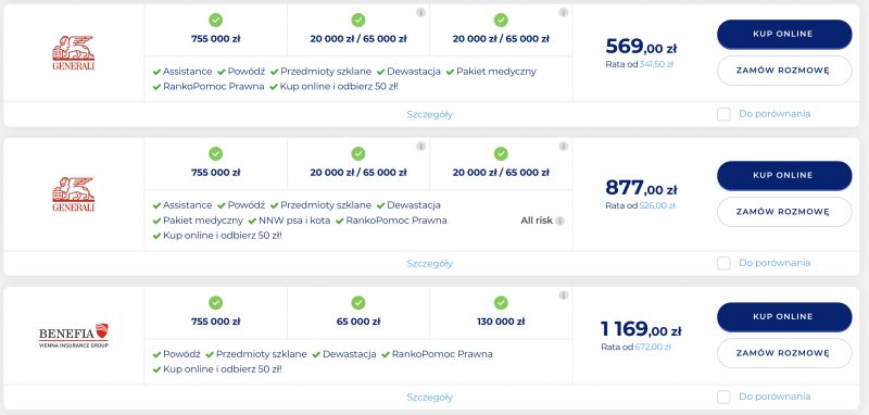

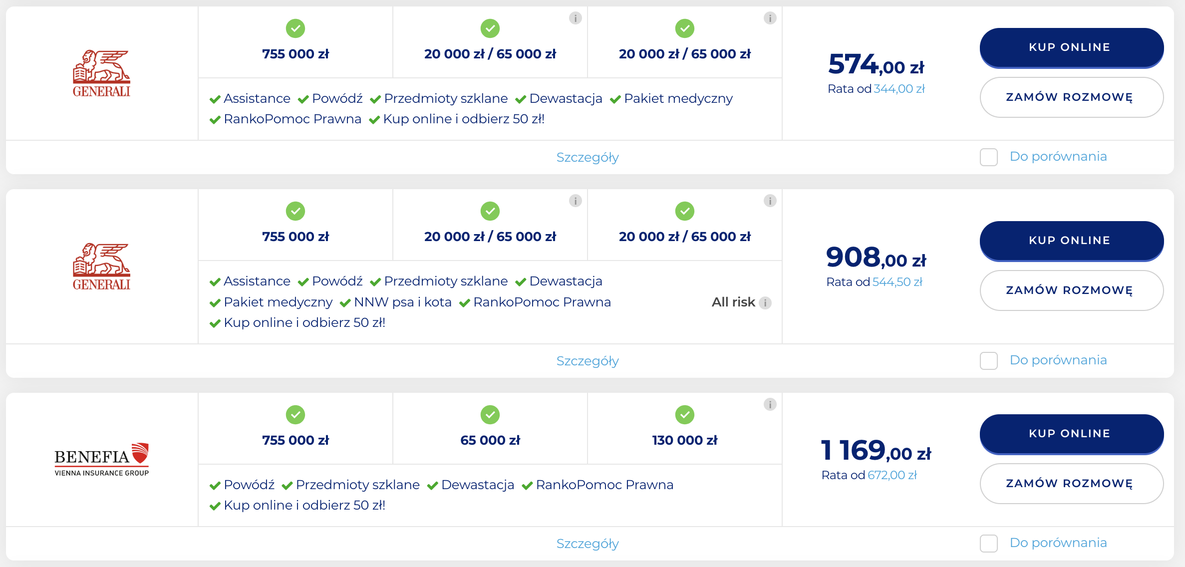

    Comparison of insurance offers from Generali and Benefia
    Just the same, full grazing doesn't help much:
    Graphic showing various types of security measures in a property.
    View of insurance offers from three companies with prices and terms listed.

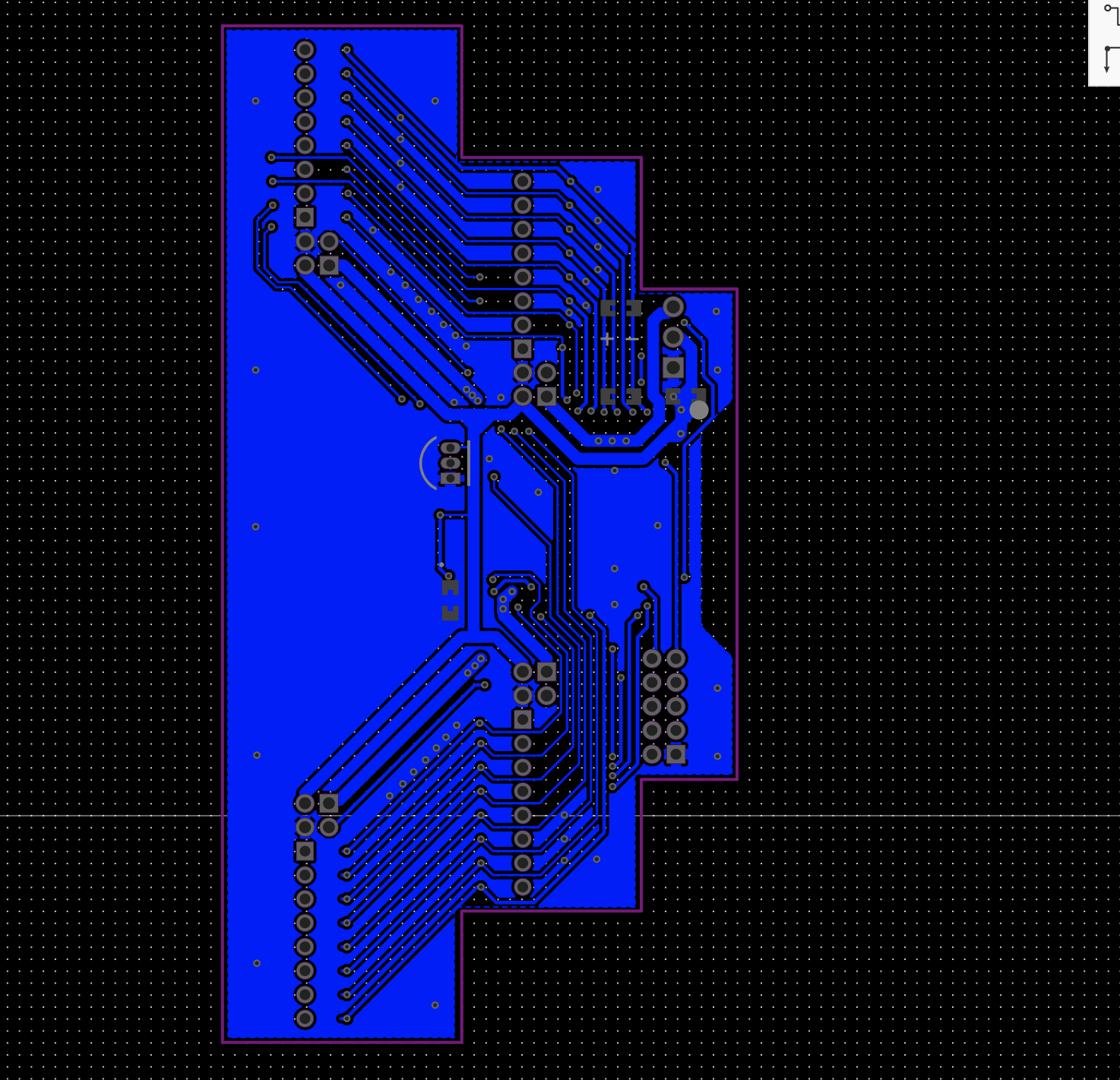

    Back to topic. After rework, corrections - previous schematics have errors ;)
    Board CNTRL1 that is the side board with ESP32 to which other boards are connected:
    Diagram of a main board with ESP32-WROOM-32E module and various GPIO connections.
    From ESP-32-WROOM-32E we managed to get 20 useful pins, as well as the following additional functional pins:
    - Serial TX/RX - serial port for programming the chip.
    - STATUS_LED - interchangeable with serial RX for use on the LED or WS281x on the front panel, interchangeable because outside of programming mode the serial port is only useful for sending logs, the TX pin alone is sufficient. There is an LED on the board with a resistor to ground, connected to this pin, when using the WS281x it will not interfere with its operation.
    - BUTTON/BOOT_PD - a secondary button (or several with a resistor ladder, as this is one of the ADC pins), interchangeable with the BOOT_PD pin which must be in a not high state to program the ESP32.
    - EN - "enable", for reset, also during programming.
    - 1WIRE/BOOT - pin for temperature reading via 1Wire, when programming BOOT pulled down to ground. There is a possibility to mount DS18B20 on the board in THT and SMD versions.
    - CAN TX/RX - for CAN transceiver on the front panel.
    Also two I2C pins, which reduce the number of usable GPIOs by 2, possible to be used by the display on the front panel.
    GPIOs are brought out on 4 connectors of 8 GPIOs + GND, 3.3V, 5V, 1WIRE:
    Connection schematic for ESP32 module boards
    Thanks to jumpers on the PCB, very flexible use of GPIO ports is possible:
    1. Connector B_R (bottom rear) enables use of IO9-16.
    2. Connector B_F (bottom front) enables use of IO9-16 and interchangeably with IO17-20 (in place of IO9-12).
    3. Connector T_R (top rear) enables use of IO1-8 (5-8 are inputs only) and interchangeably with IO17-20 (in place of IO1-4).
    4. T_F connector (top front) allows the use of IO1-8 (5-8 are inputs only) and interchangeably with IO17-20 (in place of IO1-4) and IO13-16 (in place of I5-I8).
    . CNTRL1 PCB
    Minimum components are 0805, where possible there is an alternative with through-hole assembly.
    View of CNTRL1 PCB with ESP32 and various connectors with labeled pins.
    PCB design with ESP32 and soldering pads.
    Visualization of the CNTRL1 PCB with ESP32 and connectors for module connection.
    Angled connectors will be used instead of the straight ones shown in the visualisation (IO - facing left, others facing right). As it was not possible to fit 12 pins in a 2mm raster, 1WIRE and 5V have been moved to double row pins.
    Visualisations are shown without ground filling, this is how the boards look (dots are 1mm grid):
    ESP32 CNTRL1 PCB design with visible connections.
    Printed circuit board CNTRL1 with ESP32 and visible connections.
    Added after 1 [hour] 32 [minutes]:
    Additional protection if we pressed the BOOT button shorting to ground and the 1WIRE state was high (before programming): Fragment of a PCB schematic with ESP32 showing pin descriptions and resistor R4. Additional protection if we pressed the BOOT button shorting to ground and the 1WIRE state was high (before programming): Fragment of a PCB schematic with ESP32 showing pin descriptions and resistor R4.

    Kikimo INLV1 board (inputs low voltage)
    Board 4/8 inputs protected by optocouplers, input voltage up to 48V, can be configured in several ways by jumpers on the PCB, can be mounted "upside down", leads on plug-in screw connectors with 2.54mm spacing.
    Configuration possibilities:
    1. pull-up resistors up to +3.3V if the used GPIO would not have built-in (optional).
    2. capacitors for debouncing (optional).
    3. For the light switch control I assume the following configuration: LED+ on the board to 3.3V, all P+ connected together and then to GND. Then the light switch will have GND on one pole, from the + leads, and will short the - leads to this GND, then the optocoupler diode will be on.
    4. For other purposes you can lead the LED+ to + and the LED- to - through a resistor (with the possibility of a short circuit).
    5. You can also connect all the + or - leads together on the board.
    Diagram of Kikimo INLV1 board with optocouplers and resistors.
    Kikimo INLV1 board with optocouplers and configuration options
    Diagram of the Kikimo INLV1 board with two sections and connection descriptions.
    Two Kikimo INLV1 boards with visible electronic components and connectors.
    Sockets can be mounted on both sides, so can the INLV1 boards to the CTRL1 main board, top and bottom, on two levels at the back and front. One piece of PCB contains two INLV1 boards, internally connected for mounting in 4 MOD enclosures (DIN modules), with the possibility of breaking out/cutting off and mounting in 2 MOD enclosures.
    The CTRL1 board in combination with 5 pcs. INLV1 will enable the use of 20 inputs in a 4 MOD enclosure or 16 inputs in a 2 MOD enclosure. Or any combination of INLV1 boards with other control boards (e.g. MOSFET or SSR).
    Kikimo INLV1 board with electronic components and connectors.
    Kikimo INLV1 board with visible plug connectors and PCB markings.

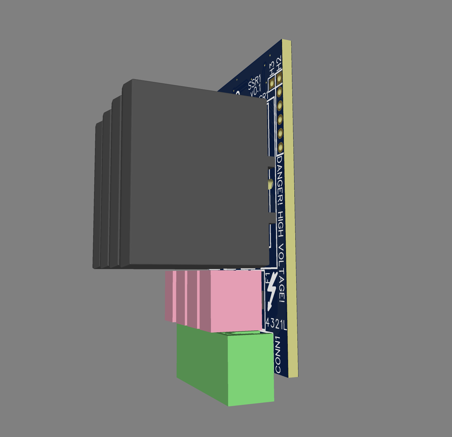

    SSR1 (solid state relay)

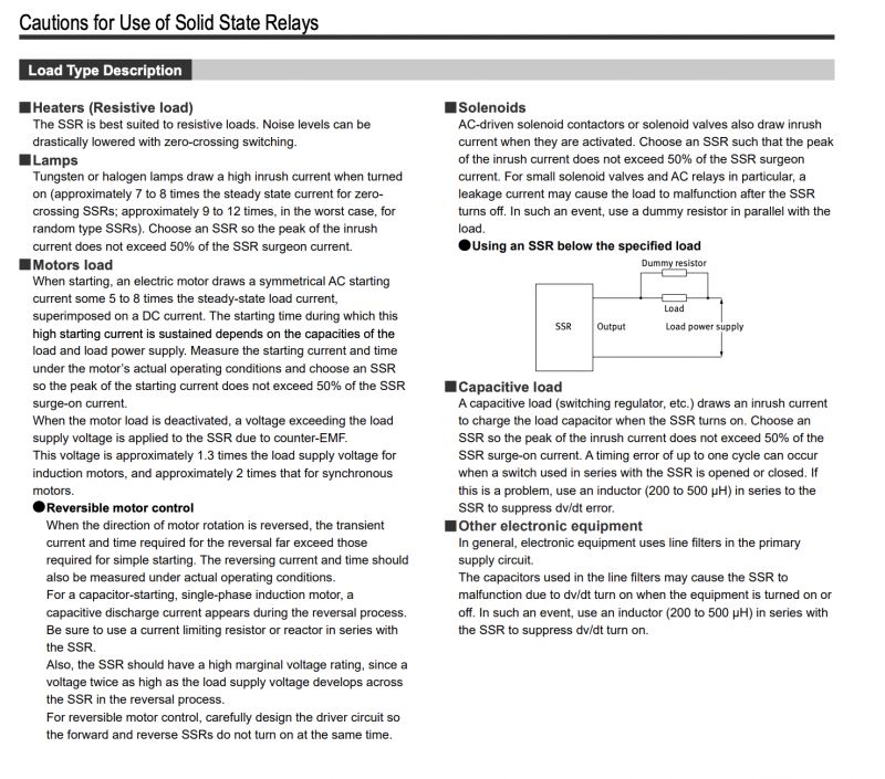

    The board is used to control 230V circuits up to 3A (see last image or SSR datasheet for details), in particular lighting.
    The following SSRs can be used:
    - Chinese clones of Omron G3MB, with currents up to 2A, costing 5PLN each (the original has been withdrawn since 2011, the successor is priced above 100PLN).
    - Panasonic AQG22212 (2A) dimensionally identical to the above Omron, widely available in Europe at around 20PLN.
    - Ixys/Littlefuse CPC1976Y (2A) or CPC1966Y (3A) available in Europe at 20/30PLN.
    Panasonic and Omron clones are controlled from 5A with MOSFET AO3401. The Ixys/Littelfuse can be controlled directly from the ESP32 pins (3.3V high state), only a 330ohm resistor is needed, limiting the SSRs diode current to 7mA, there are G (GND) and 3.3V and 5V mode changing jumpers on the board. When using 3.3V, do not connect 5V and solder the 3.3V and G/GND jumpers and leave only the 330ohm resistors, the rest of the components are redundant.
    Schematic of the SSR relay board circuit
    Kikimo SSR1 board with marked slots for four solid-state relays.
    Printed circuit board with high voltage warning signs and lightning symbols.
    3D view of a circuit board with four black relays on top, four pink components, and a green connector at the front.
    Render of a printed circuit board with high voltage markings.
    SSR1 board with solid state relays and plug-in connectors.
    SSRs Ixys/Littlefuse are much smaller than Omron/Panasonic:
    Kikimo SSR1 board with solid state relays.
    For the 230V board I had to modify the CTRL1 board, moving the lower rear connector upwards:
    PCB with ESP32 named CNTRL1.
    If other boards need to be fitted in the B_R connector, an extension board will be made.
    The board for 8 SSRs will have a separate design, otherwise IO5-8 would be too close to 230V.

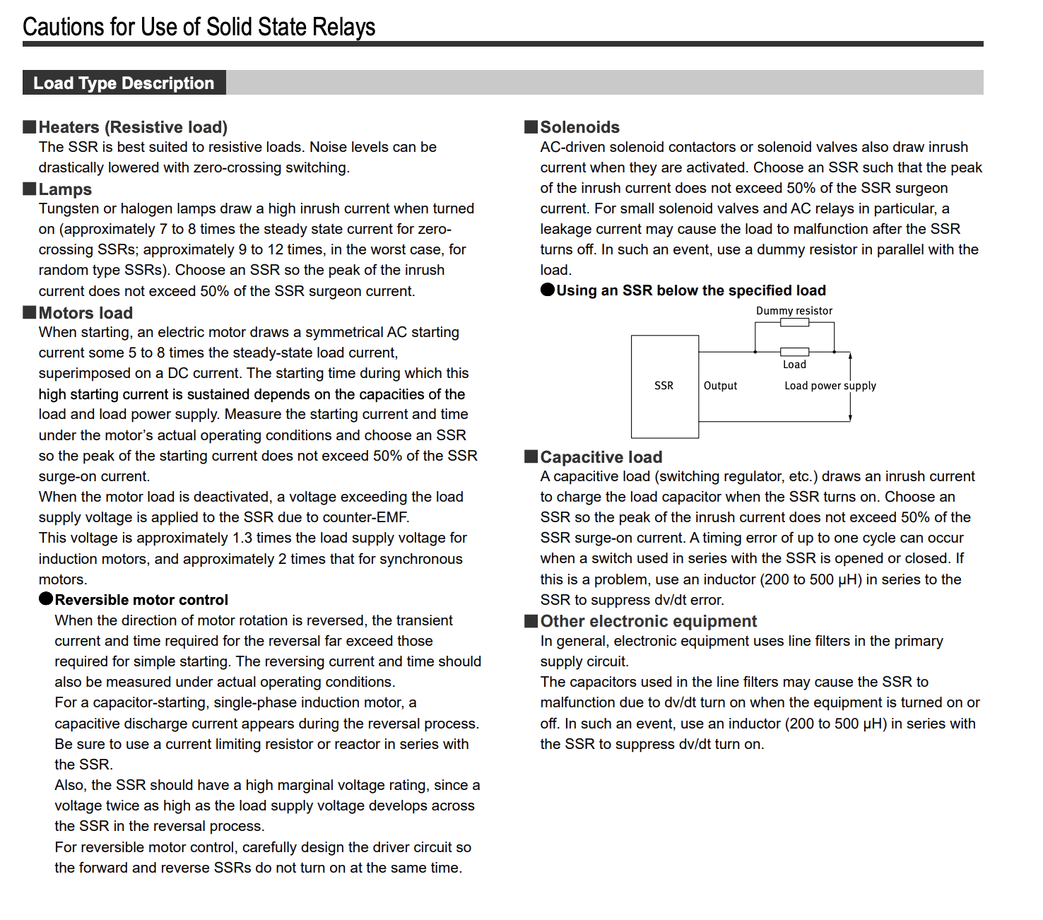

    Current limits:
    https://datasheet.lcsc.com/lcsc/2011191008_PANASONIC-AQG22212_C719647.pdf
    Table with cautions for using solid state relays (SSR).
    https://datasheet.lcsc.com/lcsc/1810270918_Omron-Electronics-G3MB-202PL_C48654.pdf
    Specification table showing Omron G3MB relays with SSR types and technical data.

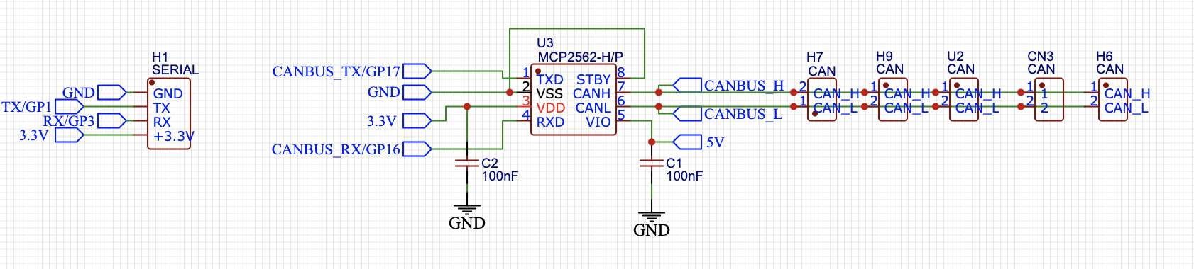

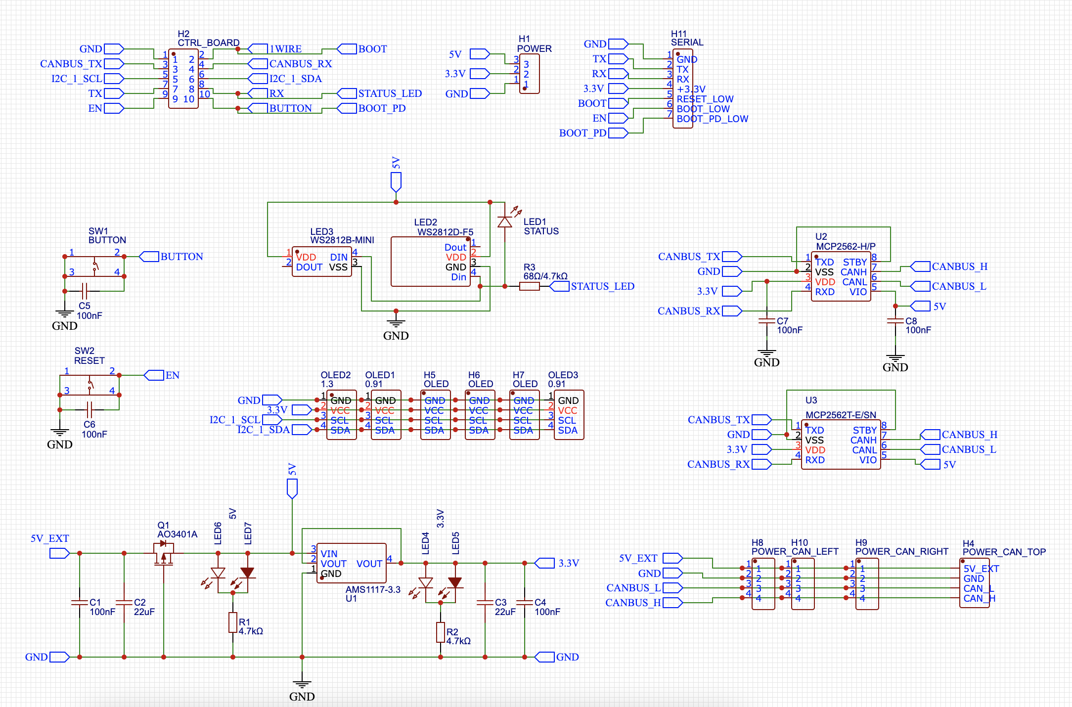

    Kikimo FRNT1 board
    The board is mounted on the front of a DIN case and has the following functions:
    - supply circuit 3.3V based on LDO linear stabilizer AMS1117-3.3, power supply transferred to CTRL board from ESP32
    - reverse power supply protection circuit on MOSFET
    - CAN transceiver - MCP2562 powered by dual 3.3V + 5V (SMD or THT)
    - LEDs showing the status of the 3.3V and 5V power supply
    - status LED controlled by the ESP32 - this can be either a regular LED or a WS2812b LED (SMD or THT)
    - two buttons - one function button for use with the ESP32, the other is reset
    - possibility of mounting OLED I2C displays, both 0.91" and 1.3" in three different locations
    - board can be mounted in 2MOD (DIN modules) and 4MOD enclosures, has the possibility to cut at the perforation point
    - two possibilities of connecting the modules - with side gold pins or from the top (the correct socket lead-out to be worked out)
    - bottom SERIAL connector for programming - eventually lead-out on the angled connector from the bottom
    Electrical schematic of Kikimo FRNT1 board with component and connector labels
    PCB made so that both SMD and through-hole components can be used, all resistors and capacitors are of size 0805, generally friendlier to assemble ;)
    Kikimo FRNT1 PCB layout with labeled connections and components.
    Kikimo FRNT1 PCB with surface-mount and through-hole components.
