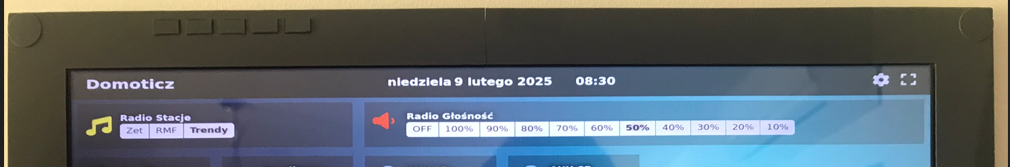

    For the past three years it has used:
    1. Satel Integra 128 replaced this year with 256
    2. a Domoticz on a Raspberry 3B+ and SSD drive
    Raspbrery because it uses GPIO and audio output there is a tutorial on the web on how to make a cool radio on Raspberry
    Internet radio in domoticz it works nicely.
    3. the Rasbbery 4 plus a 14 inch screen in the living room to control the whole thing on the Dashticz screen
    4. for lighting a Sonoff 4CG module with AFE software
    5. for roller shutters schelly 2.5 unfortunately a little unreliable
    6. other sensors on ESP8266 temp, pressure, voltage, power, energy
    As I started building automation where in 2019 Domoticz was very popular and all the info I found on it everyone said it was easier to use and it is. Due to the fact that I have a lot done on it I will not switch to HA which is also supposedly more difficult. The creators of domoticz claim that no system is intuitive and does not have such a possibility of automation as Domoticz via blockly and dzVents or LUA scripts.
    In addition, there is integration with the Satel alarm system, which, it must be said, is extremely stable in operation.
    I read a post on the elektroda forum that one of the users also keeps Domoticz precisely because of its good integration with Satel.
    As far as power supply is concerned, I am currently switching, as time permits, to 12V buffer power supplies plus converters for 5V to support some devices at the snapshot power supply from the power supply, which likes to mess things up.
    Unfortunately the sonoff 4ch module requires 230V so it must be changed to another which will be connected to the buffer power supply.
    What modules @Mavannkas are you planning to use for basic circuits such as lighting or roller shutters?

    tesla97 wrote:
    Domoticz in 2025? Seriously?
    Well, seriously: https://forum.domoticz.com/viewtopic.php?t=43095
    E.g. such a radio on a 14 inch touchscreen:
    Touchscreen displaying the Domoticz app with radio station and volume control. .
    can it be easily integrated into Domoticz and raspberry ?
    Do you need a full-time programmer to slap together the code ?
