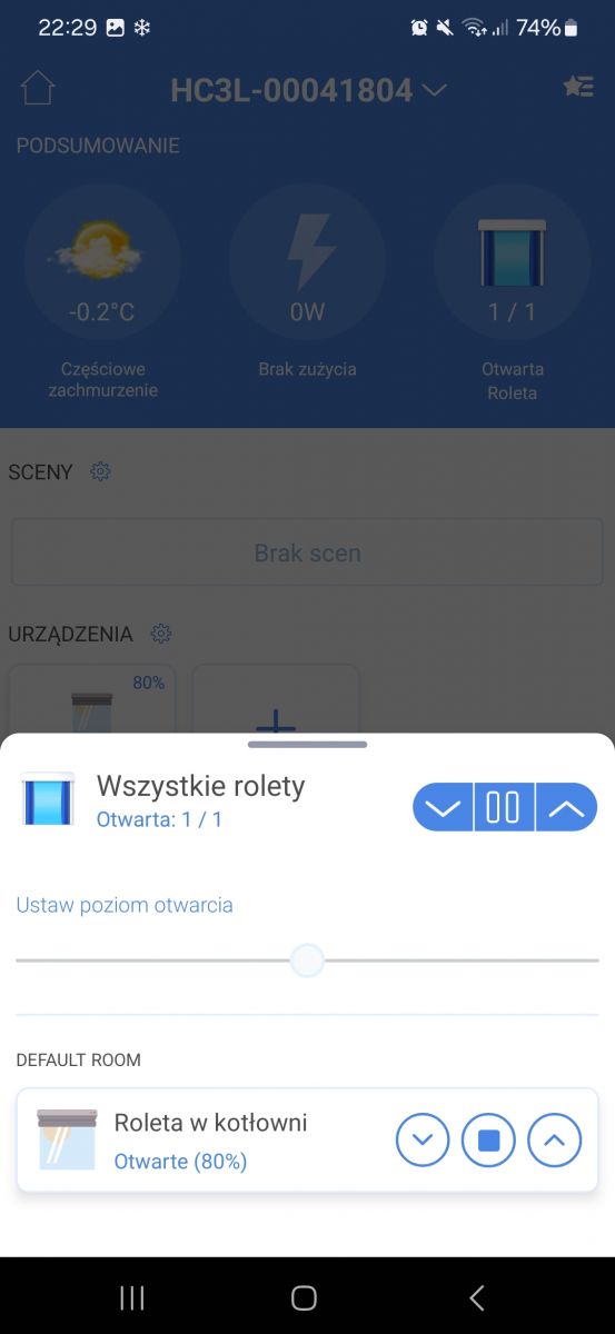

    Hi all, I need help setting up a vmz solar roller shutter control system from Fakro, running on z-wave and as I have managed to set everything up that it operates all by zrh12 remote control plus 3 additional sub remote controls for 3 separate roller shutters, I cannot find anywhere specific information on how to hook up HomeCenter 3 lite to the whole thing. There are 13 roller shutters in the house, HC3 is already connected to the net, configured, there is an app, unfortunately after adding one roller shutter, it stopped operating it with the zrh12 remote. If there is anyone who is more familiar with all of this, or has instructions to master these components then please contact me.

    HC3 lite will handle these roller shutters as I have even added 1 already, however, the remote zrh12
    Screenshot of an application controlling blinds showing the status of the blinds. stopped controlling it.

    Have you tried adding these separate blinds controlled by sub remote controls?

    Well, no, I don't want to try because it will then take me a week, I'm hoping someone can tell me how to set it up step by step, whether the hc3l should be the master and the remote controls the slaves, or somehow else. One thing is for sure that the control of the hc3l itself is easy to set up, but now that the zrh12 remote control is the master and the 3 zrh1 units the slaves, how do I configure the hc3l?
    On the Fakro website there is a manual that applies to the hc2
    https://www.fakro.pl/att/LOCAL/service/user_m.../BRAMKA_SUPLA-Instrukcja_programowania-PL.pdf

    After a technical contact from Fakro, the problem was rectified.
