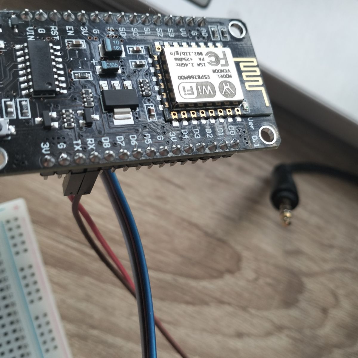

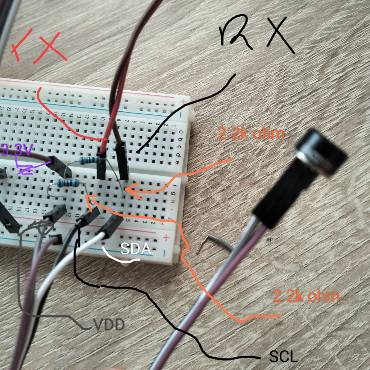

    Does anyone have an idea why the program can't see the camera, or how to check otherwise if the camera is working?

    First of all, you have mixed up the connectors .
    RX/TX is not SDA/SCL !

    After the change it still can't see and the question is whether it is the fault that the program is adjusted under the rx and tx pins or the camera is not broken, how to check this project is in the following link
    https://github.com/dev-lab/esp-thermal-camera-streamer
