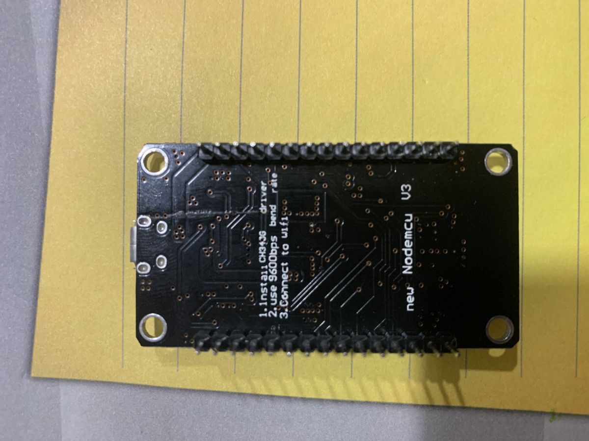

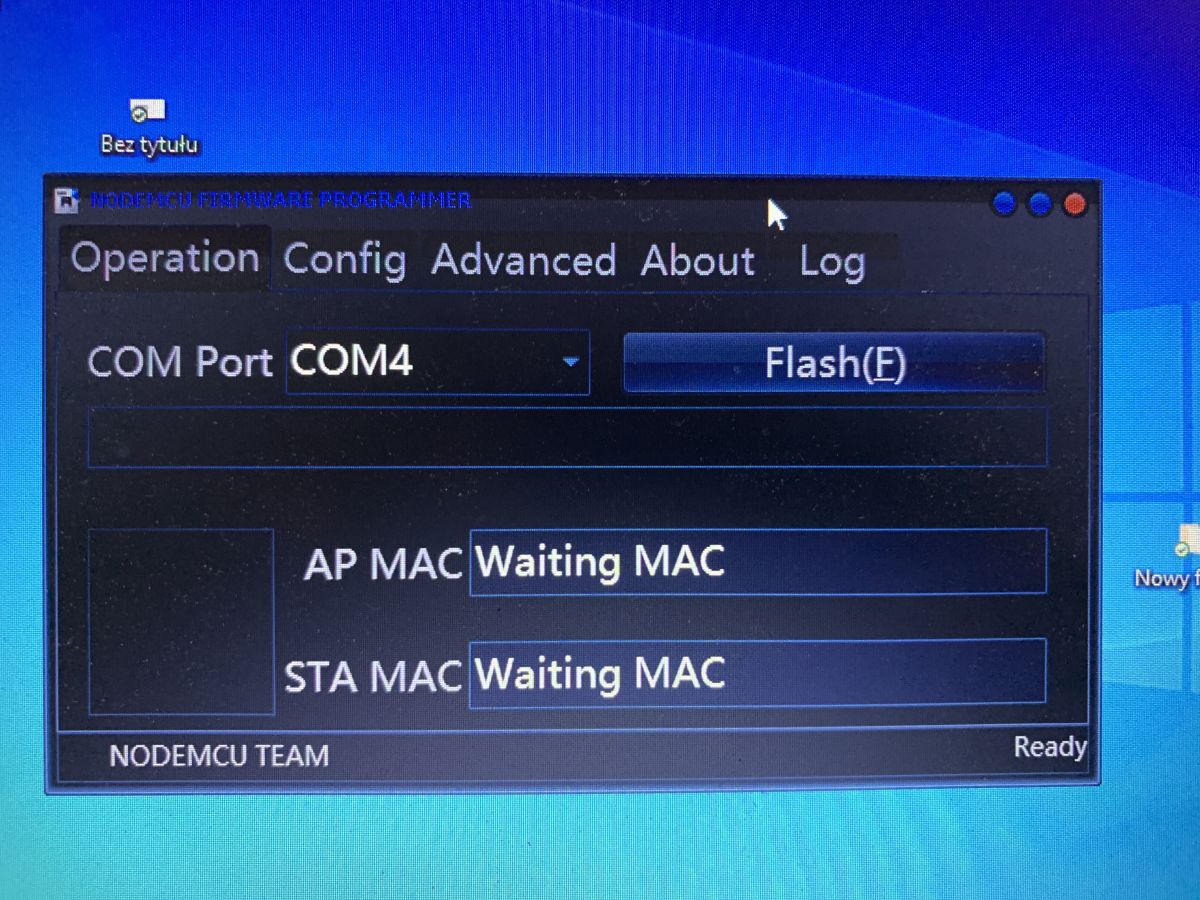

    Hello, I do not know how to program esp 8266 v3, I tried to upload firmware via NodeMcu flasher, I pressed flash and nothing happened. I have a CH340 installed.
    Does anyone know how to help me?

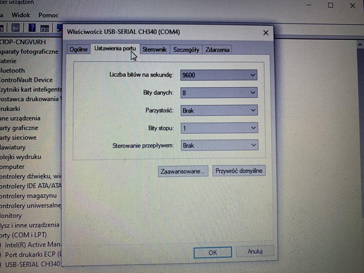

  • #2 19680627
    bubu1769
    Posts: 8063
    Help: 1177
    Rate: 2374
    Show port settings.

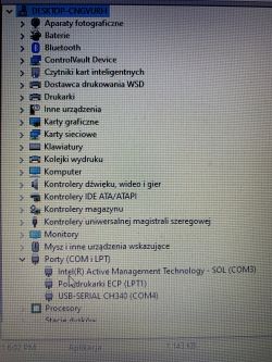

  • #3 19680645
    rafnocul12
    Posts: 16
    Difficulties programming ESP8266 V3 module with NodeMcu Flasher and CH340 controller .
    Added after 3 [minutes]:
    I use such a program :Difficulties programming ESP8266 V3 module with NodeMcu Flasher and CH340 controller .

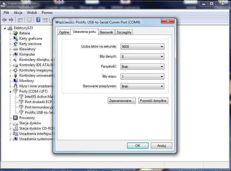

  • #4 19680654
    bubu1769
    Posts: 8063
    Help: 1177
    Rate: 2374

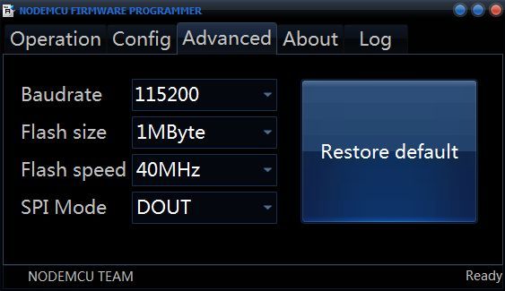

    I was referring to these settings:
    and this

  • #8 19680698
    bubu1769
    Posts: 8063
    Help: 1177
    Rate: 2374

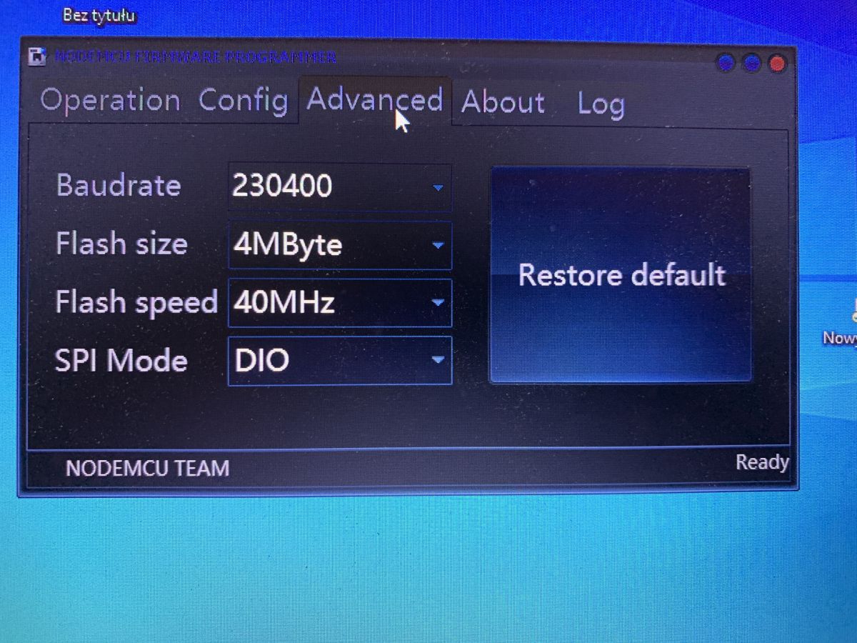

    In my opinion, the baudrate needs to be set to 115200 can even be 9600.
  • #9 19680701
    rafnocul12
    Posts: 16
    I set it up like this and it doesn't work

    And still try SPI Mode on the DOUT.
  • #11 19680712
  • #12 19680717
    bubu1769
    Posts: 8063
    Help: 1177
    Rate: 2374
    The V3 has an integrated converter.
    Plugging in DPIO0 should not be necessary.

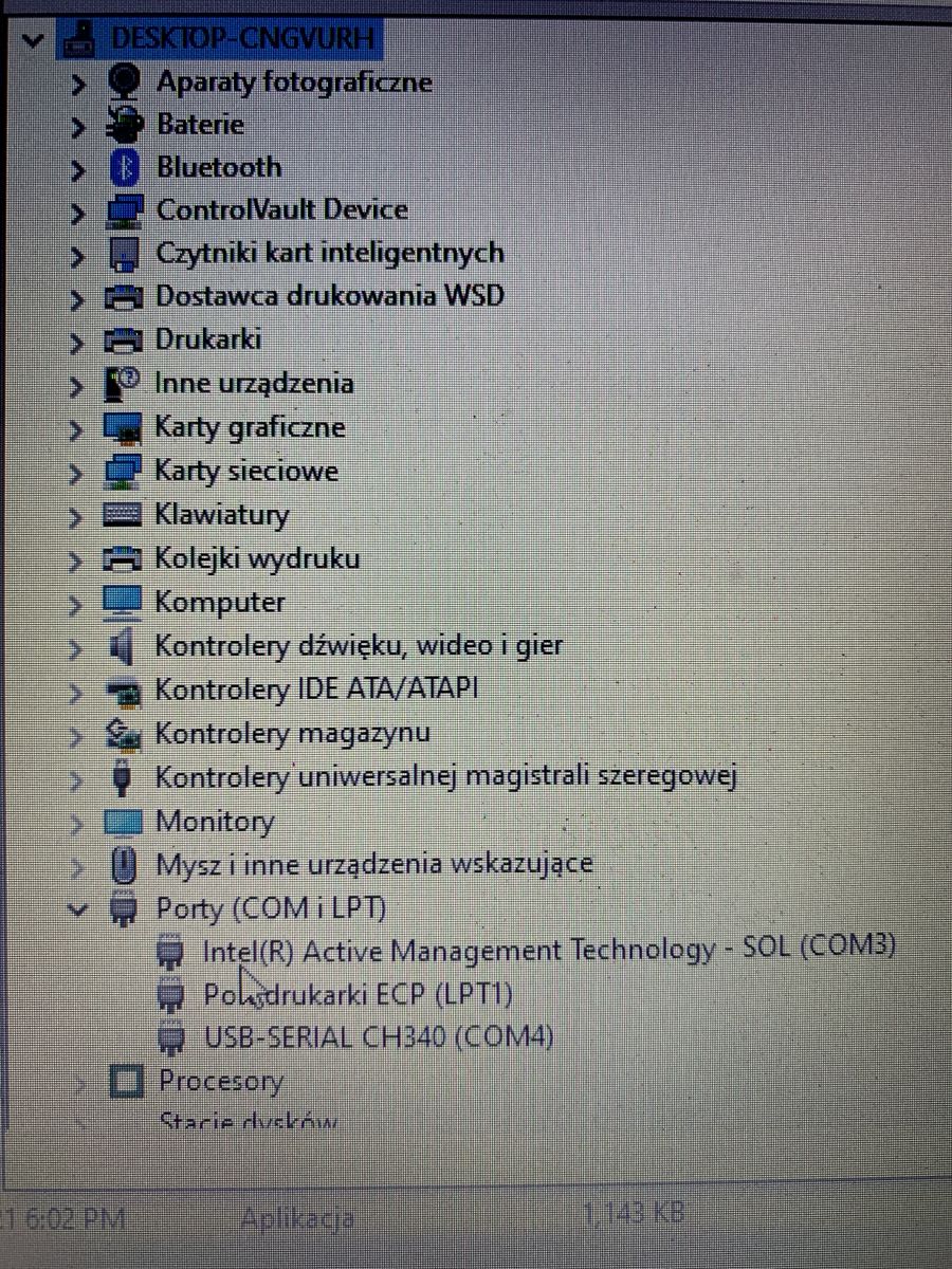

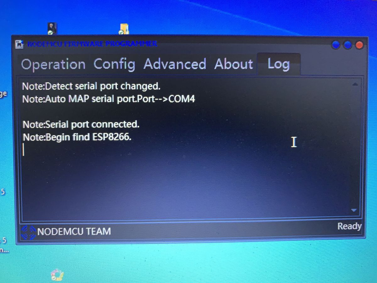

  • #22 19680760
  • #23 19680770
    rafnocul12
    Posts: 16
    When I press flash, the esp light only flashes, but nothing happens in the programme.
    Added after 1 [minute]:
    On the back of the esp it says CH340G is this the same as CH340?
    Added after 9 [minutes]:
    khoam wrote:
    Which USB port are you powering the board from?
    COM4 is this about ?

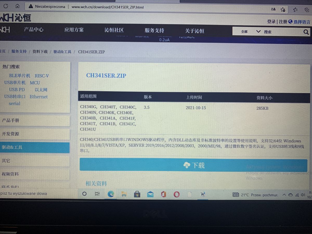

  • #24 19680800
  • #25 19680806
    rafnocul12
    Posts: 16
    I have CH340 downloaded on my computer then I need to download CH340G?
  • #26 19680810

    rafnocul12
    Posts: 16

    Or maybe it will be the same as with the Sonoff that you have to hold down the FLASH button and only connect the USB to the computer.
  • Check boot mode and USB cable integrity
    #29 19879318
    kaczakat
    Posts: 1748
    Help: 317
    Rate: 231
    As above, it is not enough to press flash before programming, the ESP is supposed to be running with that button pressed, that is, either holding the flash button connects to the USB, or holding the flash button does a reset.
    However, in a working NODE MCU board this is not needed, properly connected transistors to CH340 switch RST and PIN0 so that it boots either in programming mode or normal operation.
    Maybe the cable is bad and doesn't connect, sometimes you get a bad new one, they also die over time. I have more and more of these in my junk.
    After connecting the USB port, you can open some COM port monitor, set the speed to 74k, press reset and see what it spits out, then the same with the flash button option, the initialisation message should be different. In such a manual setting with the flash buttons you can connect to the RX/TX/GND pins from another USB-UART 3.3V converter and try to upload "sideways".
