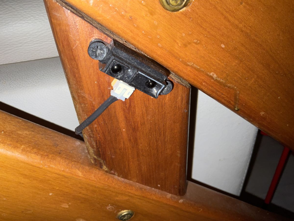

    I have this hooked up to an Arduino at home under the analogue input. Generally the closer the detector is to the obstacle, the higher the voltage/readings on the port.
    You have to set the threshold of operation by testing.
    One detector started to go crazy for me, giving false readings, I tried to mask this with software but eventually replaced it with a PIR. The other one is SHARP all the time.
    You are interested, I will send a sketch. It works, but it's not beautifully written.
    Sensor mounted on a wooden surface.
    Generally, I'd recommend the PIRs more, they're about 10mm in diameter, you can shield them with a tube to catch movement from a small area. And they are digital.

    In the archives I found what I bought at the time: Sharp GP2Y0A02YK0F
