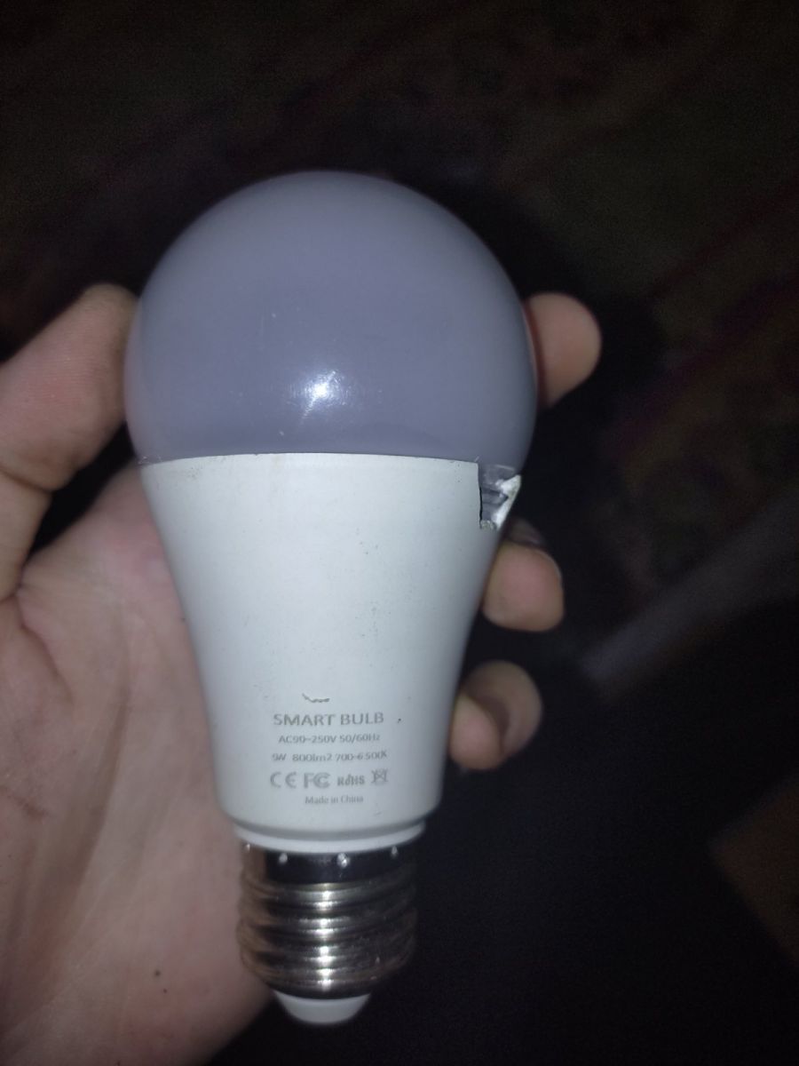

    Unrelated: Hi, I am new here and would like to share progress I've made with a lightbulb in found in a flea market. Please message me if I haven't done something right or missed any information/rules. Thank you.
    I initially ported this device onto the firmware 1.17.308 but it lacked PWM functionality (Hence why I did not publish it). Now I've managed to get it working fully on version 1.17.439 thanks to some commits which fixed W600 PWM functionality (thanks to whoever did that fix, this wouldn't be possible without that).

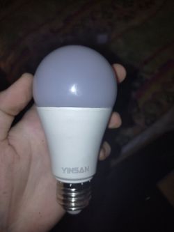

    Smart LED bulb with colorful light.
    Two colorful YINSAN LED bulbs, one standing upright, the other lying on its side.
    Amazon link

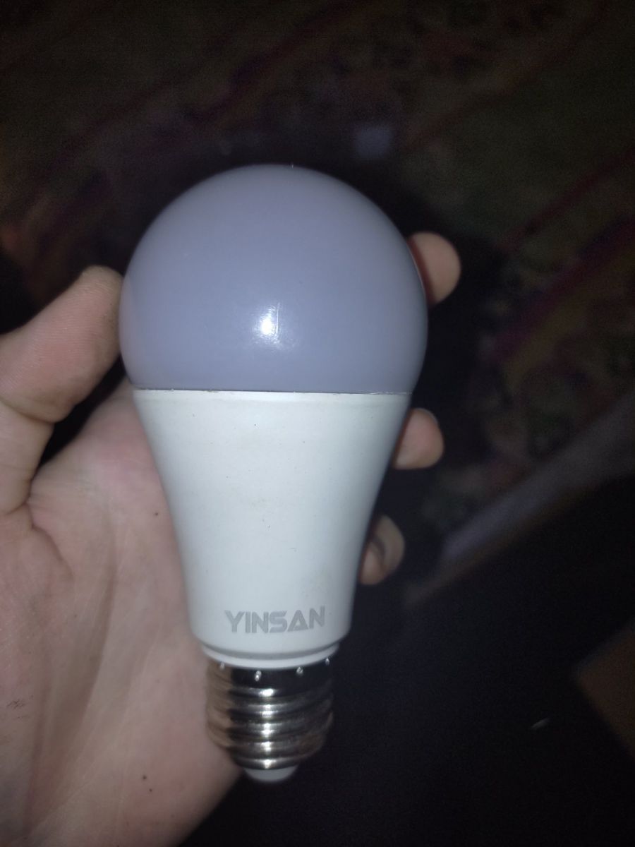

    Person holding a YINSAN light bulb in hand.
    Person holding a smart bulb with visible text on its casing.
    This device was quite tricky to reverse engineer, but I've been able to get it running after a bit of elbow grease, so to speak.
    The first and trickiest part about this bulb is the disassembly because the bulb is glued together with silicon, which is quite tricky to remove.
    You can see some of the resulting scars from that in the second attached image. (Battle wounds :P)

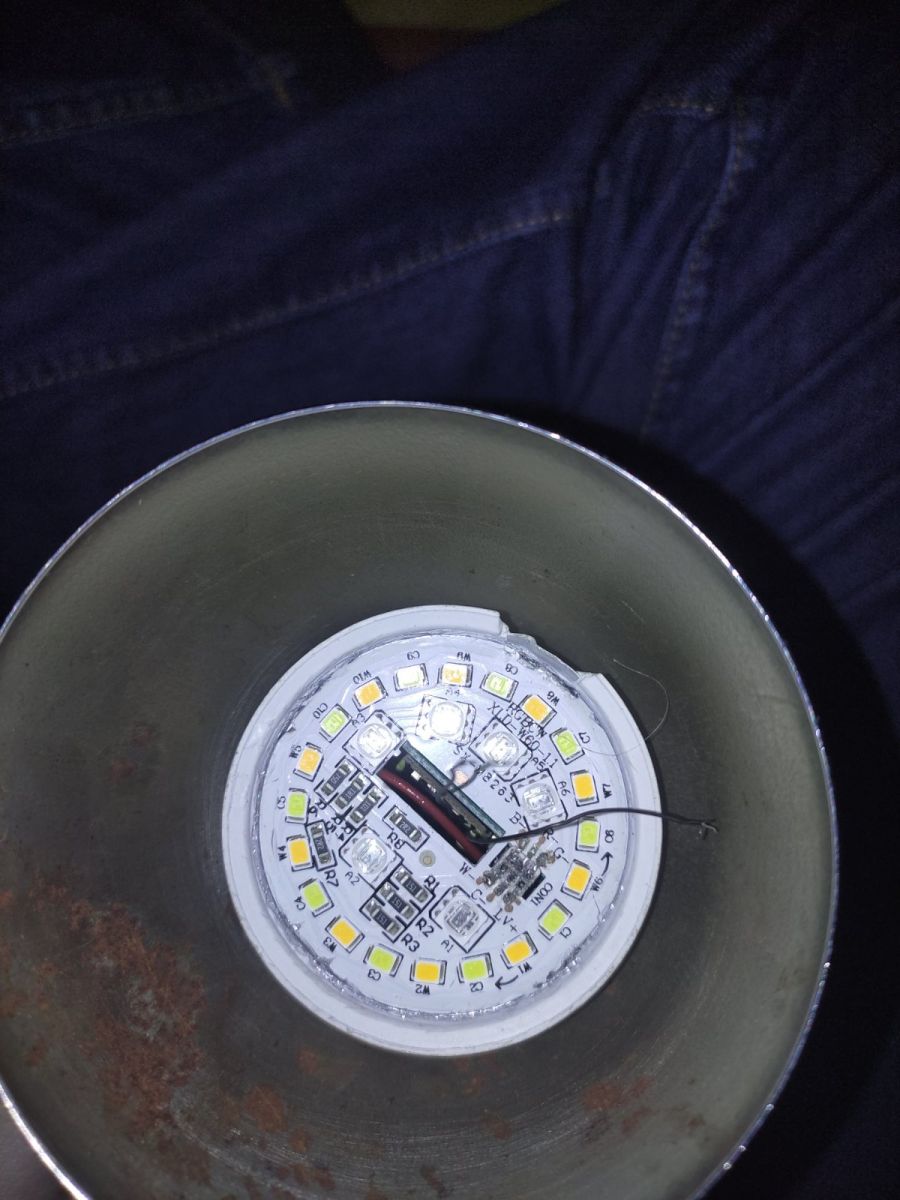

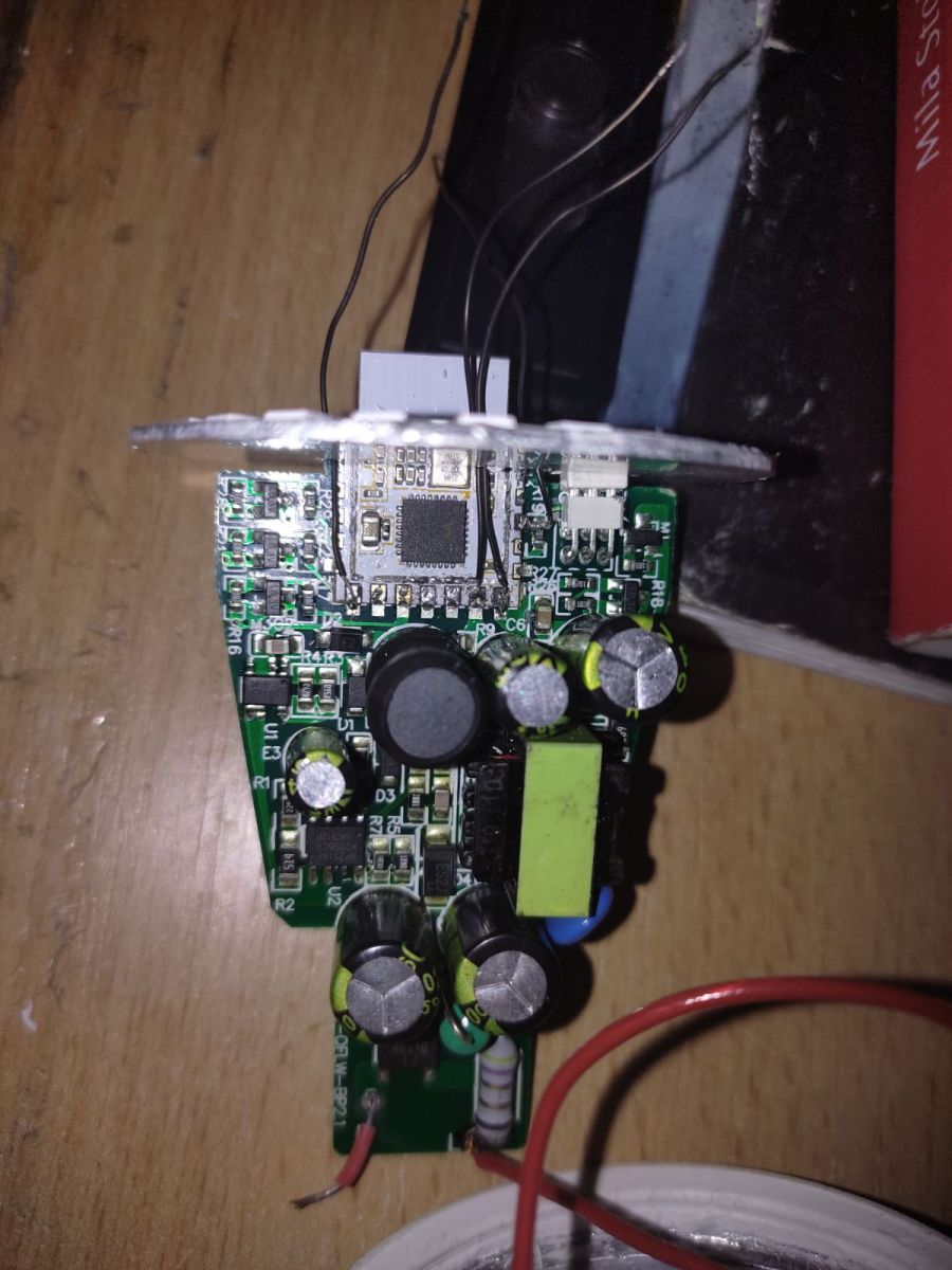

    But, once opened, you could inspect further by removing the glue attached on the ring PCB and pulling it out of the light bulbs body.
    Interior of an LED bulb showing a circuit board and connections.

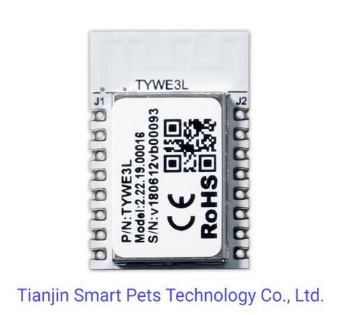

    An ESP-looking module would appear, that has the writing TW-05 on it. Now since I've partially destroyed mine while said disassembly, I'll attach an reference photo of what it USED to look like :)
    TYWE3L electronic module with CE markings and QR code.
    Except it has pins on the bottom and instead of the sticker it has TW-05 laser etched onto its metal case. A bit of imagination is required ;)
    Once pulled out, you'll be greeted with this. (Minus the debug wires I soldered onto it)
    LED bulb electronic circuit with exposed circuit board and visible components.
    In order to make use of this destructive process you'll need a soldering iron, bit of solder, a UART adapter (any that supports 3.3V would work), some small wires and a bit of patience.

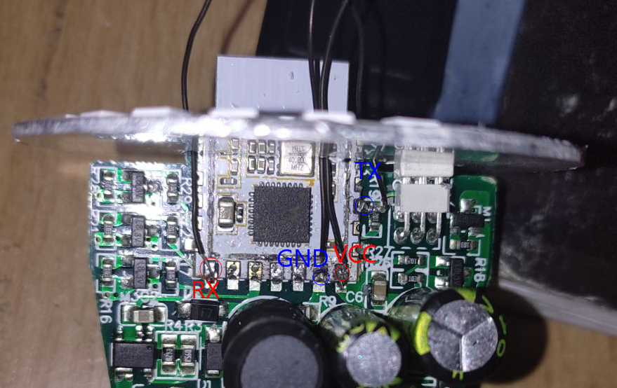

    You'll need to solder 4 connections:
    Circuit board with RX, TX, GND, VCC labels.
    You can take off the white PCB above the main power board, but BE WARNED that you may damage the 6 pin header that's connecting the two. You HAVE BEEN WARNED.

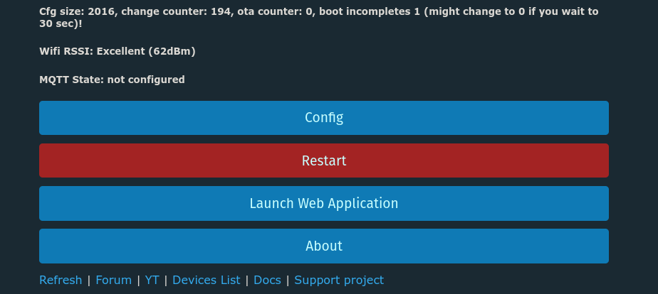

    Once completed, your lamp would create a Wi-Fi access point. Connect to it and configure it to work with your wifi network. It should be named OpenW600_some_hex_value.
    In case you cant obtain the IP address on the new access point, try setting it to an static 192.168.4.10. Once done, you should be able to access the configuration interface on port 80 on IP 192.168.4.1.
    From there you can configure it to connect to your Wi-Fi network. Once done the device will reboot, get its own IP address (you'll have to find it with a port scanner tool) and host the configuration interface from port 80 again.
    Connect back to your main Wi-Fi, and find the new IP address of the bulb using a port scanner. Look for port 80.
    Once the new IP has been obtained, you'll have to click on the Launch Web Application button.
    Configuration of smart bulb software with high Wi-Fi signal.

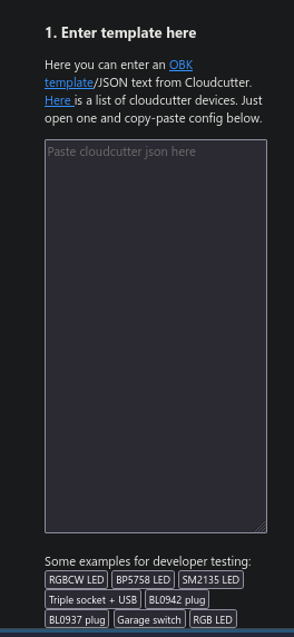

    Once in there, go to the Import tab.
    Screenshot of a user interface with the Import tab.

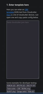

    From there download the attached w600.zip, in there you will have a w600.json file. Open that file and paste the contents of it into this text box.
    Interface for entering OBK/JSON templates from Cloudcutter
    Once done, you will be able to control your Smart Light as you please.
