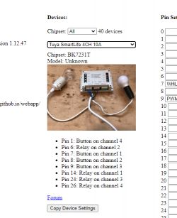

    - you do not need to manually set the pins anymore, on the javascript web panel (Launch Web Application button - the second web panel) there is an online database of devices that is always downloaded from the network, so if you already know the device, you just select the name from the list and you can automatically set its configuration:
