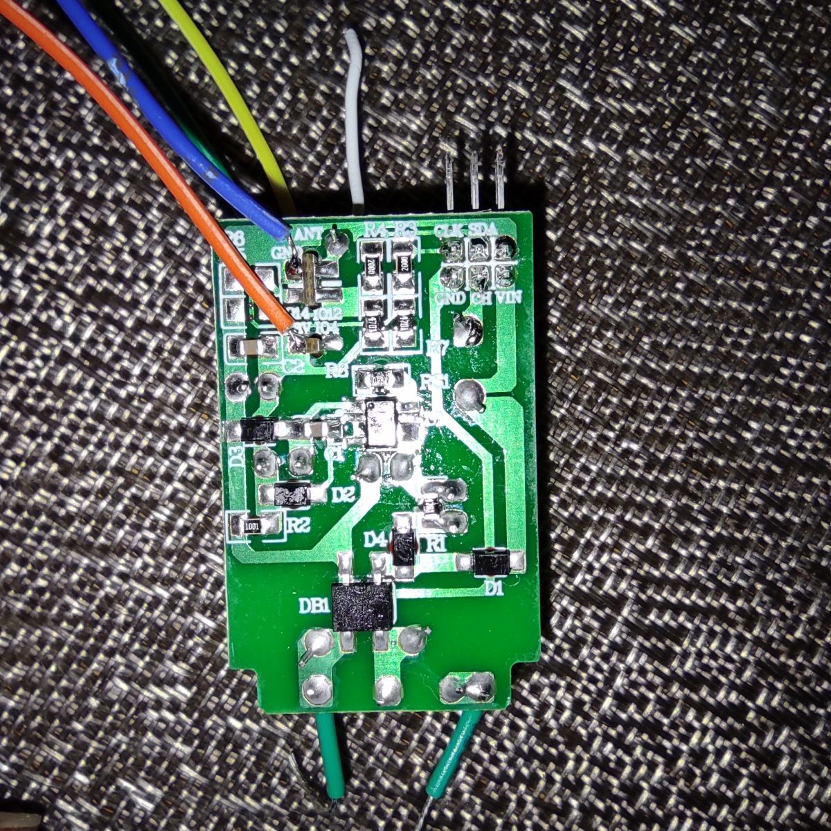

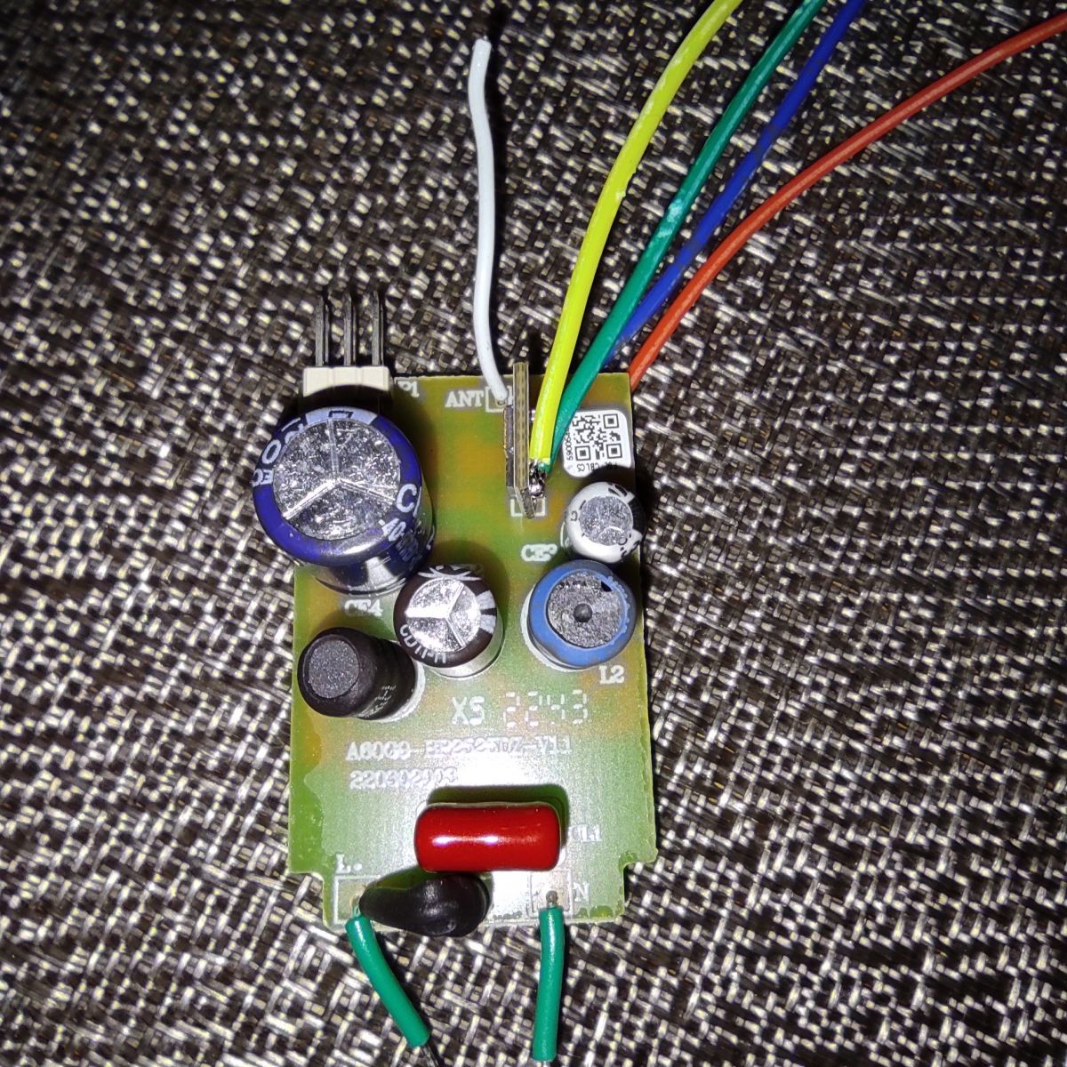

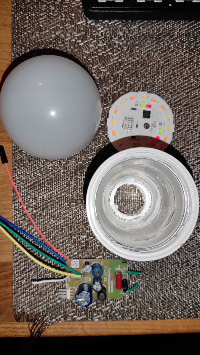

    Fortunately, the teardown and the subsequent UART flashing were successful.
    Disassembled smart LED bulb with visible internal components.

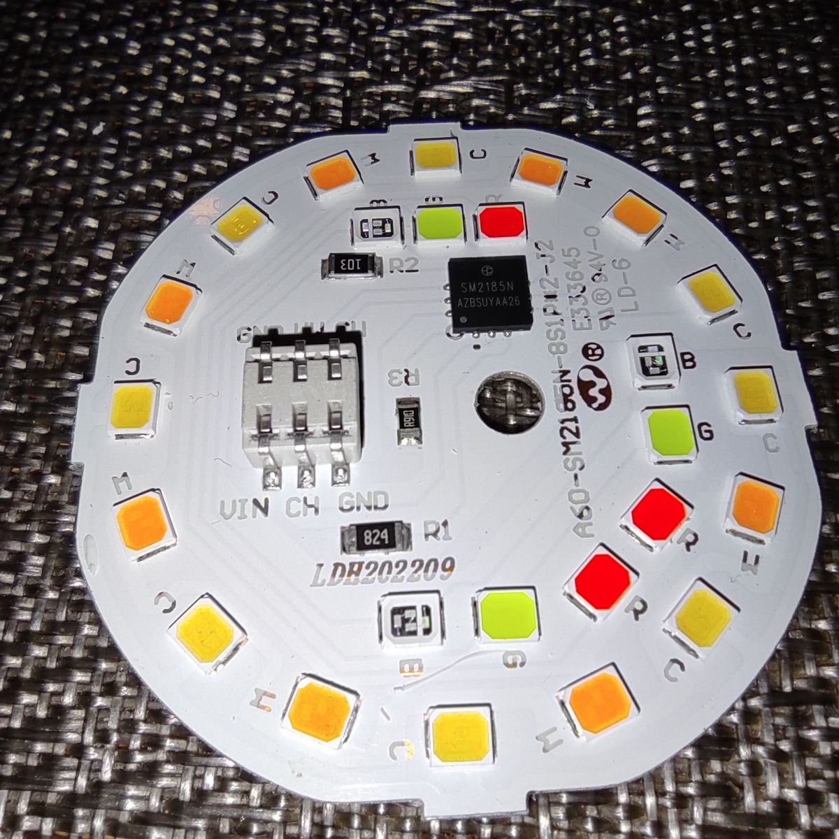

    This bulb uses an I2C driver, SM2185N.
    LED circuit board with electronic components and LEDs in various colors.
    Unfortunately, it doesn't work with the available I2C drivers (tried SM2135 and SM2235). Edit: The SM2235 actually works, see below.
    The board looks like this:
    Close-up of a circuit board with soldered wires and visible tracks and electronic components.
    Connections seem to be standard: P26 is CLK, P24 is DATA.

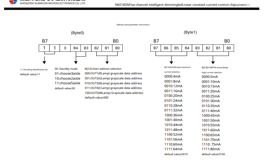

    See the attached documentation that I found here. It seems to contain the full specification of the protocol used by this chip.

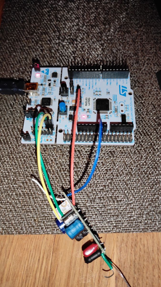

    Flashed it using the Nucleo board as the USB to UART converter. It should provide enough power for flashing and WiFi, which cannot be said about the FTDI module which I usually use in such cases.
    Nucleo board with connected cables to a module.
    I couldn't get neither BK7231GUIFlashTool nor hid_download_py to work with my Linux/Debian PC. Fortunately the ltchiptool in command line mode works:
    Backup:
    $ ltchiptool flash read -d /dev/ttyACM0 -b 115200 BK7231N woj14412-backup.img
    Flashing:
    $ ltchiptool flash write -d /dev/ttyACM0 -b 115200 ../bk7231flasher/firmwares/OpenBK7231N_QIO_1.17.306.bin

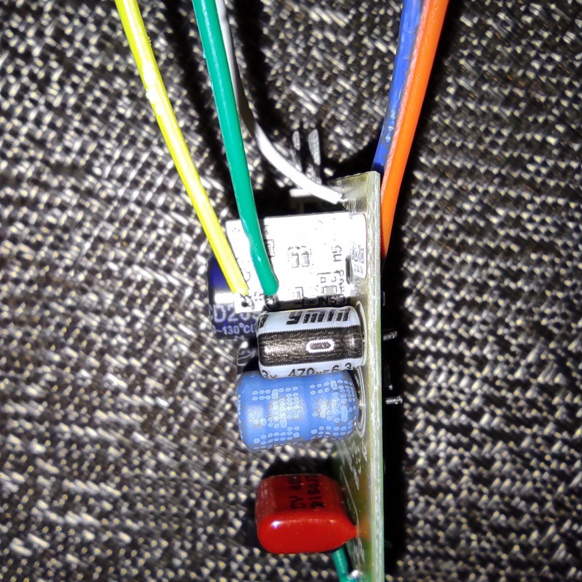

    Two more photos:
    A circuit board with electronic components and four soldered wires.
    Close-up of a circuit board with soldered capacitors and colored wires.
    I hope it will be possible to write a driver for SM2185N. For now I have the very first smart bulb and the very first OpenBeken device but no light ;)

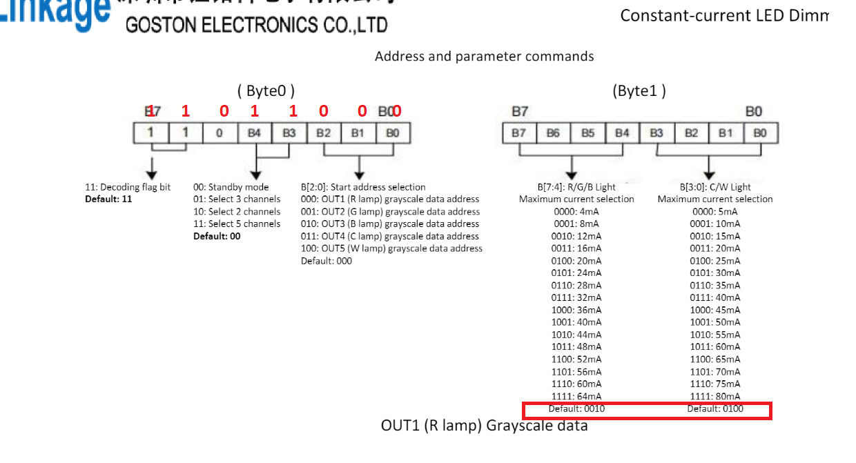

    @leśny_ziutek from a brief look, it seems that SM2235 driver may work here, the first control byte matches exactly the what I would expect from that driver, the total number of bytes also matches, and it's also 1024 values per each channel

    SM2235 I2C byte format and 10-bit value mapping
    #6 20812827
    Posts: 14743
    Rate: 12839
    No, but the communication is very simple.
    Code: C / C++
    Bit shift for sending 10 bit value:
    Code: C / C++
    The constants:
    Code: C / C++
    Byte meaning in SM2235:
    Bit diagram for SM2235 LED
    The same from SM2185:
    Addressing scheme and instructions for SM2185
    Compare the images, it seems it matches.

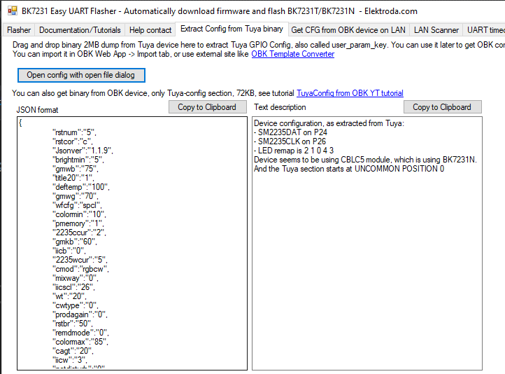

    SM2235_Map 2 1 0 3 4 command fixed the issue with the reversed warm/cool. The original mapping was 2 1 0 4 3. Thanks!
    I've downloaded the BK7231N_TuyaConfig_obk1F03214D.bin but now have a problem with "drag and drop" it to the bk7231flasher (running in Linux using mono). Is there any other way to load it?
  • #12 20814110
    Posts: 14743
    Rate: 12839
    Please attach it here and I will check this out.
    Tomorrow morning I will update flasher to also have file open dialog, i was not aware that drag and drop is broken on linux
  • #13 20814428
    leśny_ziutek
    Posts: 52
    Rate: 9
    Here you are.
    • BK7231N_TuyaConfig_obk1F03214D.bin (72 KB) You must be logged in to download this attachment.
  • SM2235 driver config identified for bulb flashing
    #14 20814470
    Posts: 14743
    Rate: 12839
    Your config indicates that this LED driver is used internally as SM2235.
    Screenshot of firmware programming tool showing JSON section and description.
    Now I will update the flasher for you.
    Added after 7 [minutes]:
    EDIT: Relased https://github.com/openshwprojects/BK7231GUIFlashTool/releases/tag/v1.1.3 can you check?

    Now I can load the bin file and obtain the JSON and the text description.
    As I've written before, I didn't use BKFlasher to flash this device because of some transmission errors. Instead, I used ltchiptool in cmd mode (GUI mode doesn't work). This is normal if you live without Windows. I'm used to it ;)
    To sum up, all you need to do to get this bulb to work is:
    1. Configure Module:
    - set P24 (PWM4) to SM2235DAT,
    - set P26 (PWM5) to SM2235CLK.
    2. Configure General/Flags:
    - select Flag 4 - [LED] Force show RGBCW controller (for example, for SM2135 LEDs, or for DGR sender),
    - optionally select Flag 12 - [LED] Remember LED driver state (RGBCW, enable, brightness, temperature) after reboot.
    3. Restart the device.
    4. In the Web App execute SM2235_Map 2 1 0 3 4 command to swap the Cool and Warm channels.
