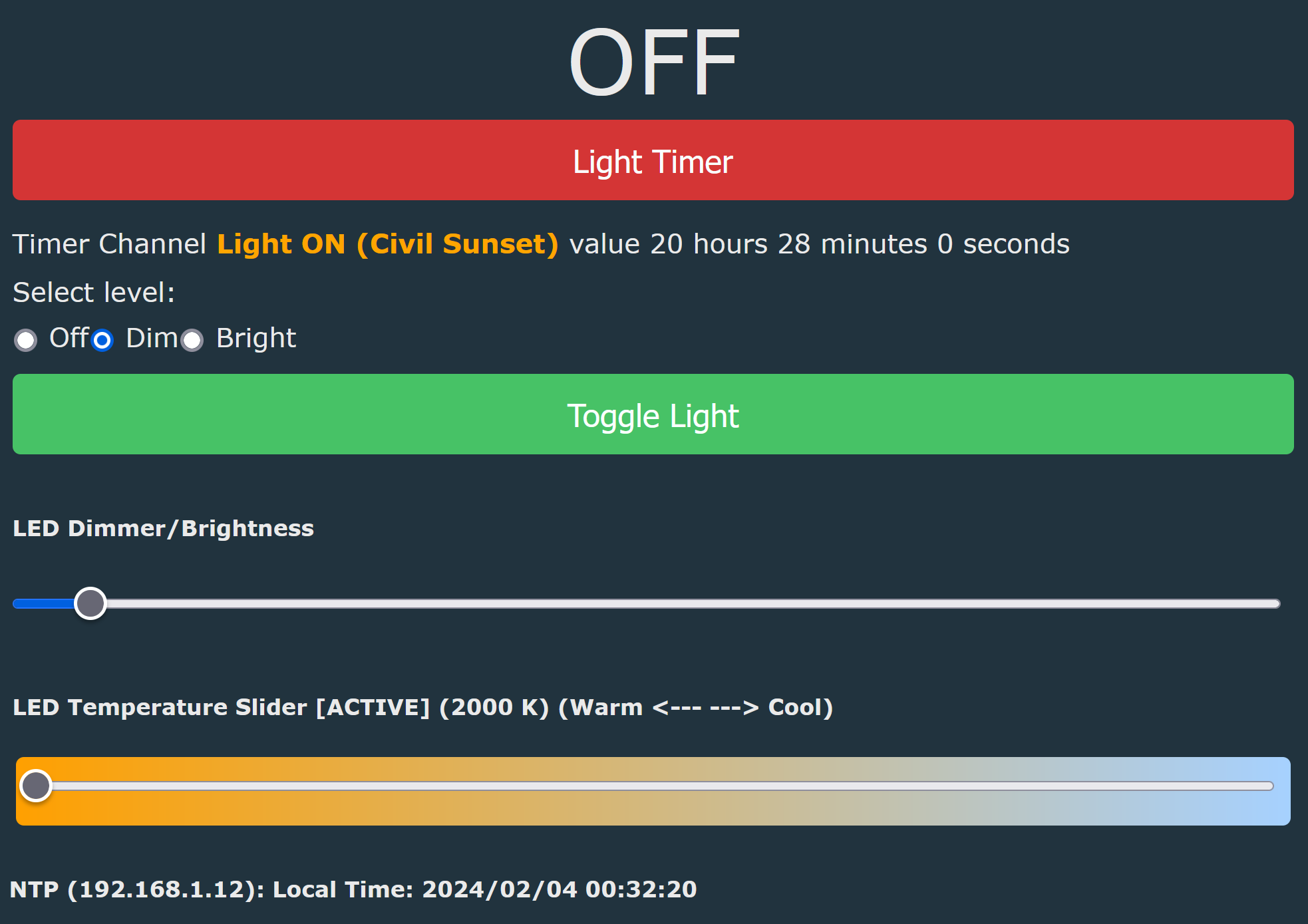

  • User interface for managing lighting with timer and LED controls

    // Channel 10: maintain sunset time (The time when the light should turn on)
    setChannelLabel 10  "<b><span style='color:orange'\>Light ON (Civil Sunset)</span></b>"
    setChannelType 10 TimerSeconds
    // when using $sunset as an expression in addClockEvent, it needs to be re-calculated every day to take into account different sunset values
    alias calc_sunset backlog setChannel 10 $sunset+1800; removeClockEvent 4; addClockEvent $CH10 0xff 4 high_lights; echo Lights will turn on at $CH10
    // Channel 11: hidden register to store current time as TimerSeconds
    setChannelType 11 TimerSeconds
    setChannelPrivate 11 1
    setChannelVisible 11 0
    // Channel 12: trigger for timer_on_lights
    setChannelLabel 12 "Light Timer"
    setChannelType 12 Toggle
    setChannel 12 0
    alias timer_on_lights setChannel 12 1
    // Channel 13: 3 way toggle for light settings
    setChannelLabel 13 "Switch"
    setChannelType 13 OffDimBright
    alias off_lights setChannel 13 0
    alias low_lights setChannel 13 1
    alias high_lights setChannel 13 2
    // timer trigger: lights will be on high for 5mins, then on low for a further 25mins, then turned off
    addChangeHandler Channel12 == 1 backlog high_lights; addRepeatingEvent 300 1 low_lights; addRepeatingEvent 1500 1 off_lights
    addChangeHandler Channel13 == 0 backlog led_enableAll 0; setChannel 12 0; echo lights_set_off
    addChangeHandler Channel13 == 1 backlog led_temperature 500; led_dimmer 5; led_enableAll 1; echo lights_set_low
    addChangeHandler Channel13 == 2 backlog led_temperature 300; led_dimmer 30; led_enableAll 1; echo lights_set_high
    addClockEvent 3:30 0xff 1 calc_sunset
    addClockEvent 21:00 0xff 2 low_lights
    addClockEvent 23:00 0xff 3 off_lights
    waitFor NTPState 1
    waitFor MQTTState 1
    calc_sunset
    // set the current time as TimerSeconds in register for checks below
    setChannel 11 $hour*3600+$minute*60
    // Set initial light state to match the above clock events
    // sunset - 21:00   lights set to high (evening activities)
    // 21:00 - 23:00    lights set to low (sleepy mode: warmest temperature and very dim)
    // 23:00 - sunrise  lights on for a short period (bedtime the lights should be off, but can be forced on for a period by switching off and on)
    // sunrise - sunset lights turned off (day time the lights should be off)
    if $CH11>=$CH10&&$hour<21 then high_lights
    if $hour>=21&&$hour<23 then low_lights
    if $hour>=23||$CH11<$sunrise then timer_on_lights
    if $CH11>=$sunrise&&$CH11<$CH10 then off_lights
