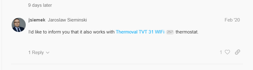

    https://community.home-assistant.io/t/how-to-integrate-thermoval-tvt31-wifi-thermostat/166679
    Although.... here is a comment:
    Screenshot from a forum showing a user's comment about the compatibility of Thermoval TVT 31 WiFi with Home Assistant.
    https://community.home-assistant.io/t/wifi-th...ureon-beca-energy-component/48519/434?page=22
    No less, this is a thread from 4 years ago, so it would probably be a bit of a combination to get it working at all.
    In the above post there is some code snippet:
    Code: Python
    Maybe with these integrations it would be possible to have both Thermoval and Tuya displayed in the HA panel....

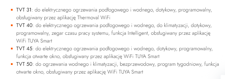

  • Manufacturer lists other Thermoval models as Tuya-compatible
    #6 21105542
    Posts: 14771
    Rate: 12914
    There must have been a selection error, because according to the manufacturer's website, other Thermoval are compatible with Tuya:
    List of Thermoval models with function descriptions and compatibility.
    Source:
    https://thermoval.pl/baza-wiedzy/cieplo-w-zasiegu-reki/
    Here you have the whole paragraph:
    The software of systems that support wireless heating control can be divided into two groups: internal and universal. The former are unique firmware and operate in their own environment, such as Thermoval Wi-Fi. The second are open, meaning that they can work with multiple devices simultaneously as part of an entire smart home management system. TUYA Smart Wi-Fi is an example of such software.
    There are four WiFi controllers available from Thermoval:
    - TVT 31: for electric underfloor and water heating, touchscreen, programmable, operated via the Thermoval WiFi app
    - TVT 40: for electric underfloor and water heating, for air conditioning, touchscreen, programmable, system time clock, Intelligent function, operated via the WiFi TUYA Smart app
    - TVT 45: for electric underfloor heating and water heating, touchscreen, programmable, open window function, operated by the WiFi TUYA Smart app
    - TVT 50: for water heating and air conditioning, wireless, weekly program, open window function, operated by the WiFi TUYA Smart app
    And maybe it's worth trying to ask the manufacturer anyway, if they couldn't help somehow? It's strange that just the TVT 31 doesn't have this support, while others do.
    Maybe it's worth trying to pair this TVT 31 with a Tuya anyway?

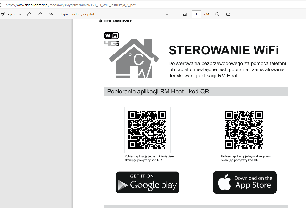

  • Check TVT31 pairing with Tuya app
    #8 21105910
    Posts: 14771
    Rate: 12914
    For this moment I would really suggest to check these pairing of the TVT 31 with the Tuya app. Just pair according to the manual, but with Tuya.
    I previously based this on a Youtube video from the manufacturer:
    There it mentions the Thermoval app. I dug deeper, and the manual in turn mentions the rm heat application:
    Instructions for downloading the RM Heat app with QR codes in Polish.
    I'm beginning to wonder if it's not all the same after repainting.
  • FAC parameter 10 enables pairing mode
    #9 21105985
    puchalak
    Level 20  
    Posts: 1351
    Help: 12
    Rate: 229
    For the moment I would really suggest checking these pairings of the TVT 31 with the Tuya app. Just pair as instructed, but with Tuya.....
    I tried it a long time ago, although I'll admit to not believing in success, I didn't try very hard. Smart Life did not detect it. But pairing is done in a strange way. The instructions told me to set the FAC parameter in the menu to 10 and turn it off. When switched on, the thermostat entered pairing mode. But this FAC can be set from 0 to 32. I have no idea what this is for, and the instructions say nothing.
    pp. 9-10
    https://www.sklep.robmex.pl/media/wysiwyg/thermoval/TVT_31_WiFi_Instrukcja_3_.pdf

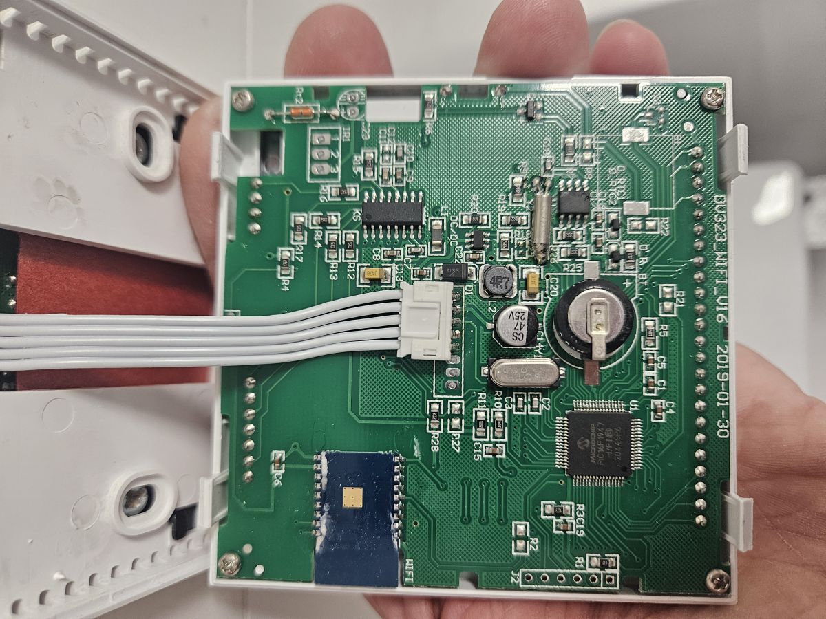

  • New TVT31 revision uses Tuya hardware
    #15 21759278

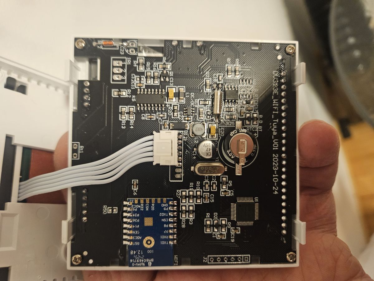

    puchalak
    Level 20  
    Posts: 1351
    Help: 12
    Rate: 229
    Eg. I bought another, the eighth of the same thermostat - a TVT31. It had been lying around in the box for a while, waiting to be installed. I installed it yesterday, finished late, so I had already let go of the configuration in the app. In the morning, still in bed, I fired up smart life to raise the blinds, and here's a new device - the installed thermostat reported. The manufacturer, without changing the model name, changed the platform to TUYA - i.e. did what I asked when starting this thread. Maybe the subscription on the previous platform was too expensive? To be honest it's a bit annoying now - I now have seven controllers in one application and one in another. I thought that maybe having a design it would be possible to change the firmware to tuya in all of them. Unfortunately the electronics have also changed. The new one looks like this:
    TVT31 thermostat circuit board with TUYA Wi-Fi module and ribbon cable visible.
    While the old one is slightly different. The wifi module has fewer leads.
    Thermostat interior showing PCB with cable connector, Wi-Fi module, and electronic components
    The whole menu is identical. I don't know if this is possible. Perhaps colleague @p.kaczmarek2 could advise something?
  • #16 21759288

    And just out of curiosity, what kind of Wi-Fi module is in this new one? And just to be sure, also what kind in the old one....
  • #17 21759377
    puchalak
    Level 20  
    Posts: 1351
    Help: 12
    Rate: 229
    And how do you check this? Nothing can be determined from the photos?
  • #18 21759391
    Posts: 14771
    Rate: 12914
    Remove the four screws in the corners, the Wi-Fi modules are marked on the top, and you can see the bottoms of the modules in the photos. The new one looks like a Beken.

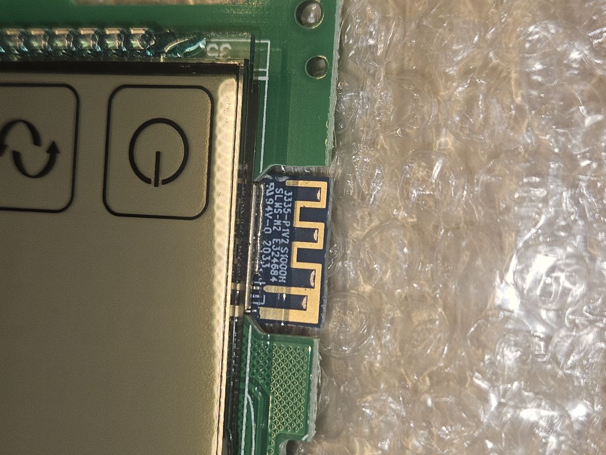

  • CB3S module identified in new thermostat
    #19 21759590
    puchalak
    Level 20  
    Posts: 1351
    Help: 12
    Rate: 229
    Wireless module on PCB next to LCD screen with power button symbol
    I've taken the old one apart - unfortunately the soldered display covers 3/4 of the module, but from what is written next to the antenna it appears to be the same module as in this topic.
    https://www.elektroda.pl/rtvforum/topic4148573.html
    The new one has the CB3S module you wrote about here:
    https://www.elektroda.pl/rtvforum/topic4059644.html

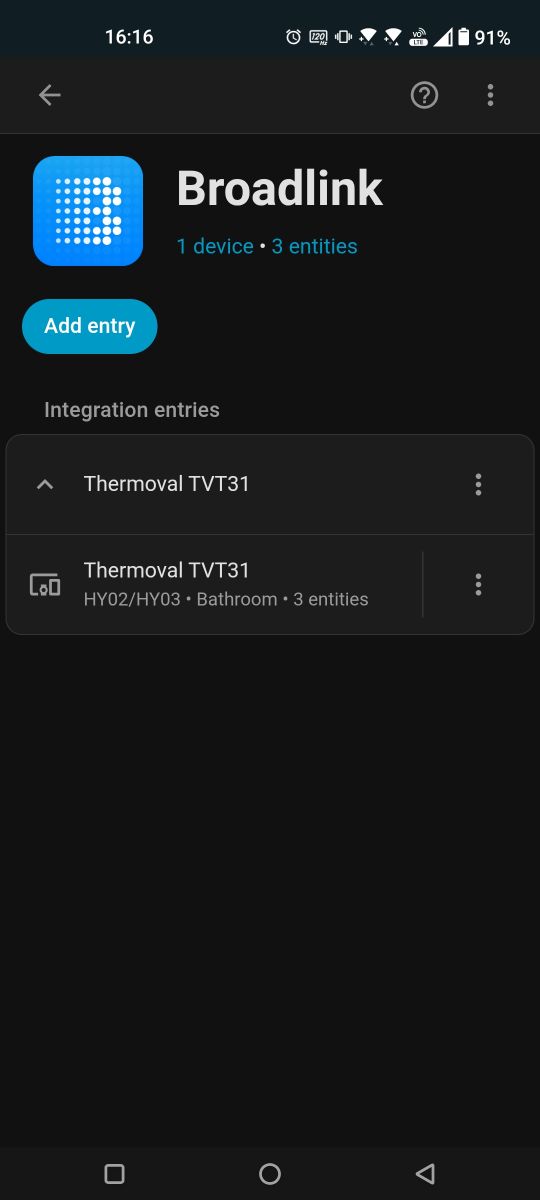

  • Broadlink integration works without internet access
    #20 21759978
    piotrszulc1
    Posts: 37
    Rate: 8
    Broadlink app screen showing Thermoval TVT31 with three associated entities
    I too have a TVT31, bought a few years ago. It works with HA via the official Broadlink integration. All I had to do was configure in the app and the HA detected everything by itself.
    Then I blocked the thermostat from accessing the internet and peace of mind - it's been working for years without a problem.
    Pairing with Tuya I haven't tried; I suspect it won't work.
