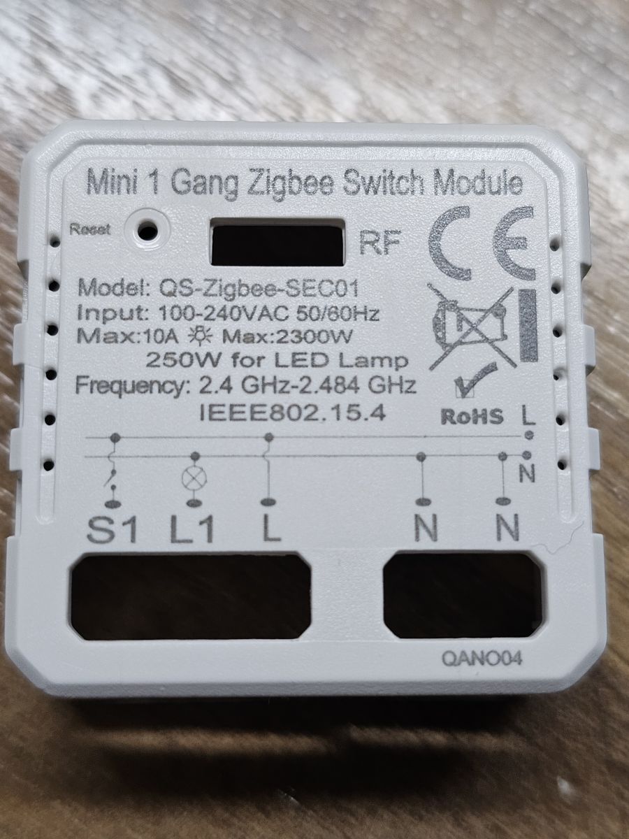

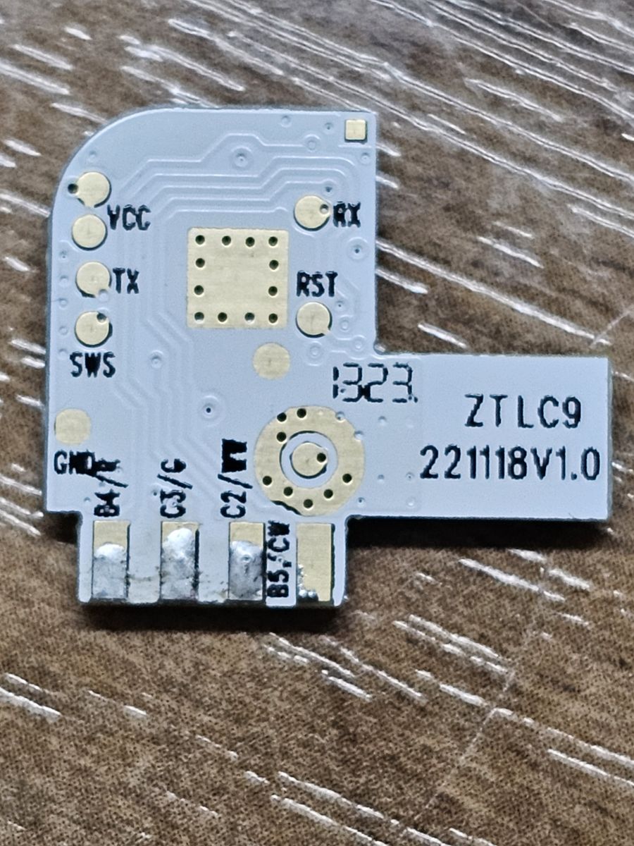

    Found a ZTLC9 module in a switch. Anyone reprogrammed this module?
    / Zigbee module with technical specifications. ZTLC9 module with technical markings on a white PCB. Close-up of the ZTLC9 electronic module from a switch, showing its components and connections. Frank

    Hey, this is a Zigbee module. Why would you want to reprogram that? It can already work without a cloud when you use, for example, zigbee2mqtt with Home Assistant.

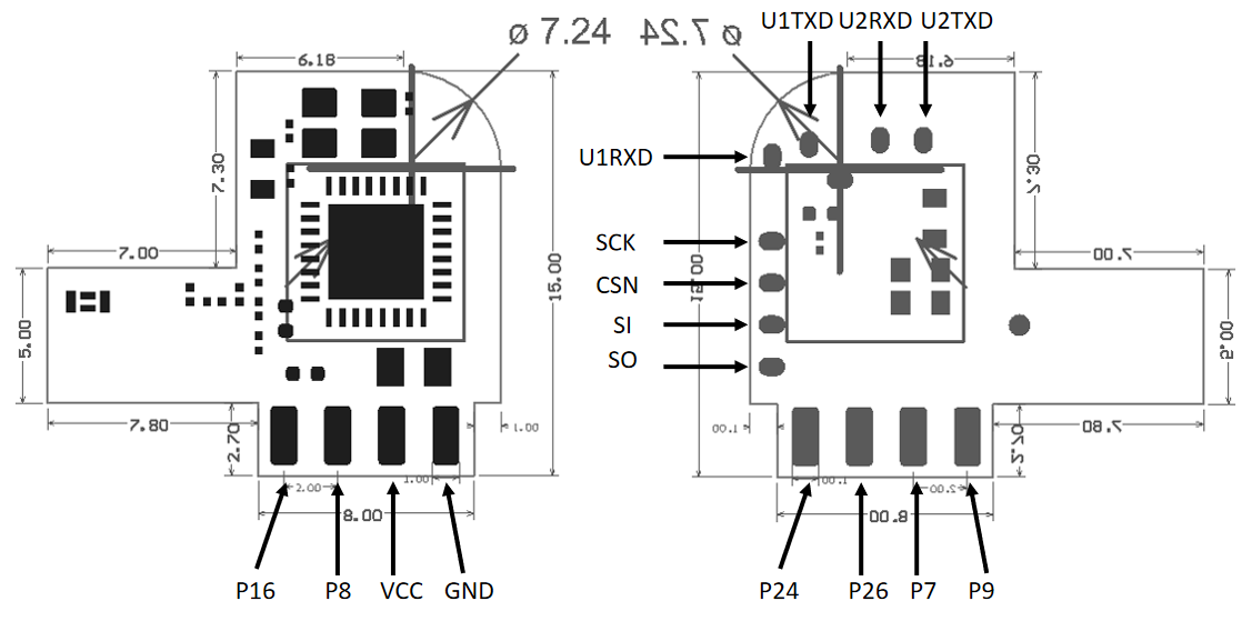

    By the way, it looks like a Zigbee version of WBLC9:

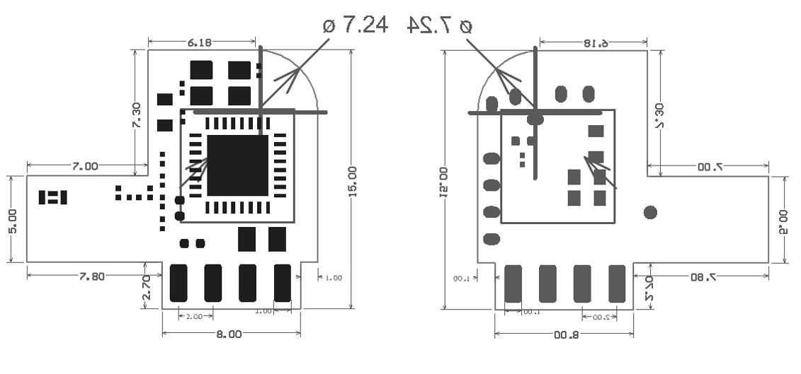

    Diagram of Zigbee WBLC9 module with dimensions.
    Technical sketch of the Zigbee WBLC9 module with pin labels.
    The following images are from the WBLC9 docs and the similiarity is very high. Still, it's a Zigbee module, not WiFi, so it should work with zigbee2mqtt out of the box.

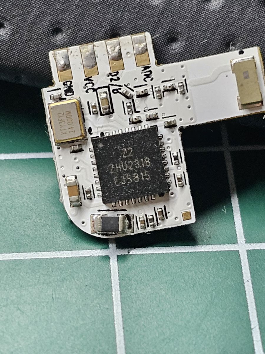

    And I have another question about the ZTLC9 module. Is it possible to somehow change the antenna to one with higher gain? WBLC9 has information in the description about the presence of a ceramic antenna on the board. But which one is it? Can it be replaced, for example, with a WiFi antenna from a laptop?

    Custom firmware for this device (and many more) is available here: https://github.com/romasku/tuya-zigbee-switch
    The thread for this device: https://github.com/romasku/tuya-zigbee-switch/pull/223
    Tuya firmware is not the best and never receives updates. It can be unreliable, missing features, spamming the network.
    Basic functions work, but there are plenty of reasons to replace it.
