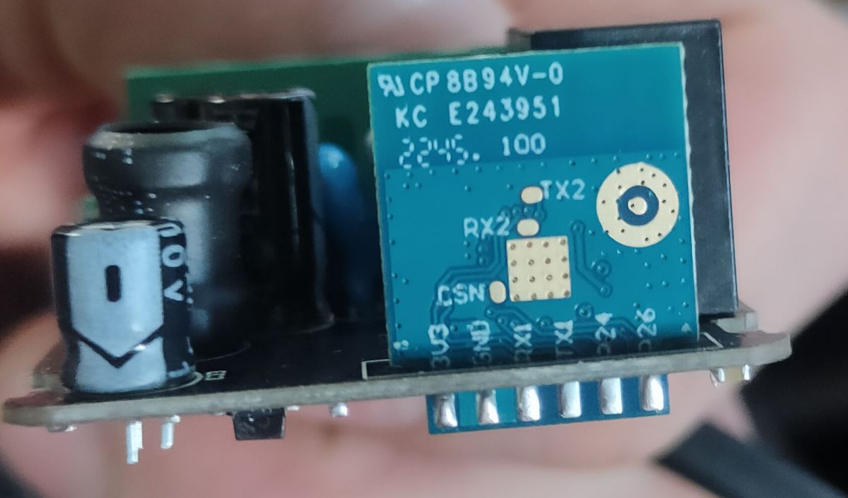

    To read data and firmware, it is enough to connect an external power supply 3.3v and uart
    All pins are accessible without desoldering the module.
    mini smart switch - Belon BL2028N
    Thanks to the developers - you can not look for anything, everything is signed on the board:
    we need 3.3v, GND, RX1, TX1
    TP CS is obviously not a select chip, but CEN (reset), see photo from the front, but we don’t need it.

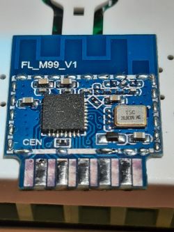

  • Belon writer appears to predate Beken writer
    #2 20262533
    Posts: 14755
    Rate: 12881
    This is great discovery. I haven't ever seen a FL_M99_V1 module yet. Great job.
    Hmm, Belon BL2028N... I remember seeing Belon name somewhere. I think it was here:
    Belon Writer 1.55? Does it ring a bell? It seems like a previous version of Beken Writer 1.60. Was Belon renamed to Beken at some point?
    I am attaching the document where I've found the mention of Belon Writer.
    EDIT: attaching some extra documentation related to BL.
    • BL2028N module data sheet V10.pdf (1.34 MB) You must be logged in to download this attachment.
    • hlk-b30.pdf (1.72 MB) You must be logged in to download this attachment.

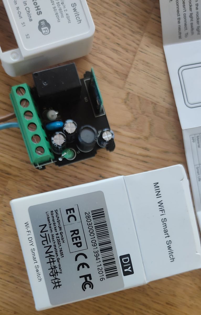

  • Special BL2028N version with different pinout
    #8 20581634
    grericht
    Posts: 13
    >>20262292
    seeml like i found a special version of this smart switch.
    flashing worked like descripted
    but pins are different.
    mini smart switch - Belon BL2028N mini smart switch - Belon BL2028N mini smart switch - Belon BL2028N mini smart switch - Belon BL2028N mini smart switch - Belon BL2028N mini smart switch - Belon BL2028N mini smart switch - Belon BL2028N mini smart switch - Belon BL2028N mini smart switch - Belon BL2028N mini smart switch - Belon BL2028N mini smart switch - Belon BL2028N

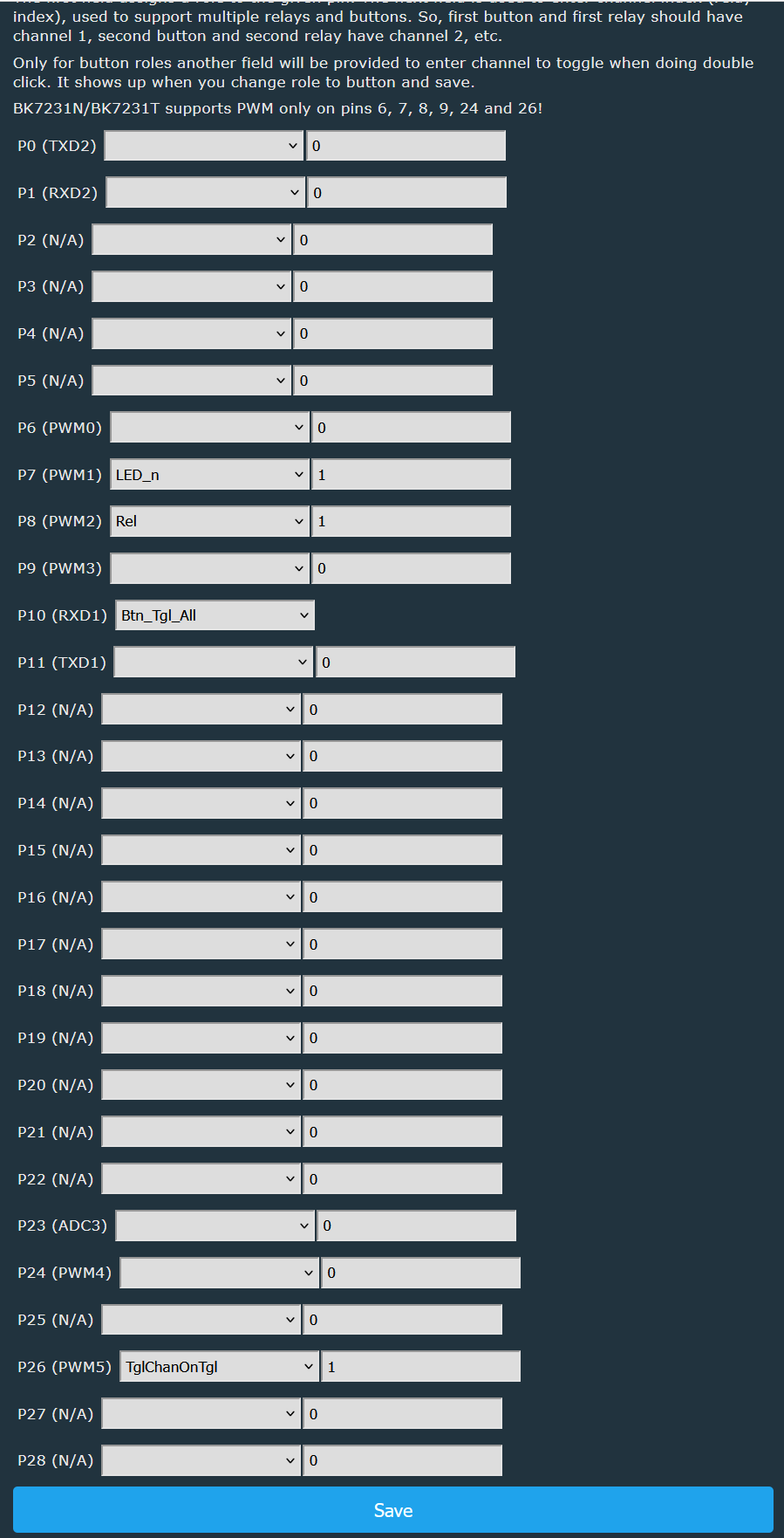

  • #9 20581694
    Posts: 14755
    Rate: 12881
    Please post JSON template from Web App as well, thanks!
  • JSON pinout mapping for Belon BL2028N switch
    #10 20581738
    grericht
    Posts: 13
    here it is:
    is it possible to upload the json file?

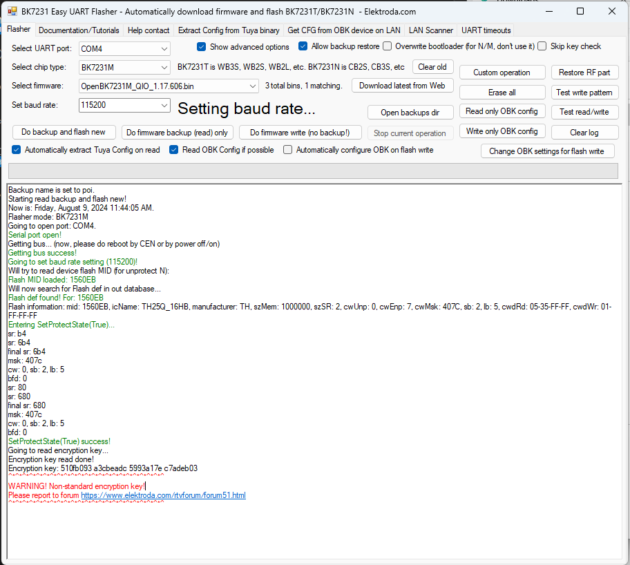

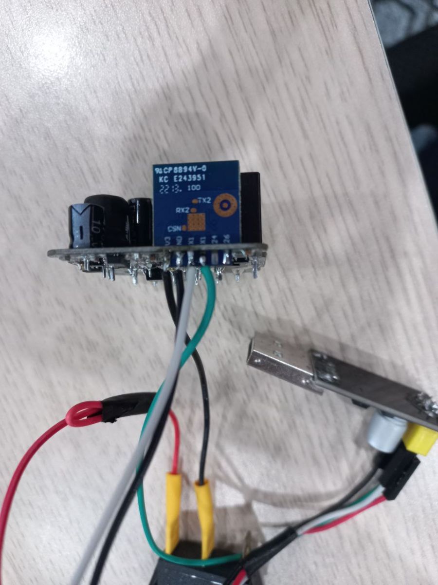

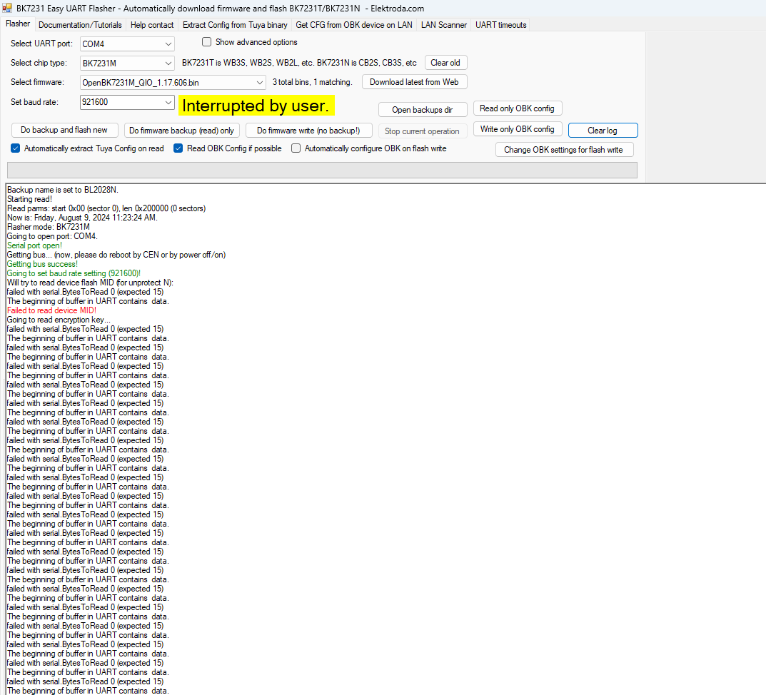

    #16 21185100
    khangtm1work
    >>20581634I am trying to flash a mini smart switch - Belon BL2028N and I saw you can flash it and I tried but it doesn't work. I don't know if I soldered it wrong or not that I can't flash it
    Close-up of a mini smart switch Belon BL2028N with connected wires.
    I am wiring as shown in the picture, and this is the error i get
    Screenshot of BK7231 Easy UART Flasher program showing error messages.
    I don't know what I did wrong, and when i change the baud rate i get this error
    Screenshot of BK7231 Easy UART Flasher software displaying an error message about an encryption key.
  • #17 21185430
    Posts: 14755
    Rate: 12881
    Try BK7231N mode. This is a standard Beken key.
  • #18 21187657
    khangtm1work
    Thanks a lot!!! I tried it and it worked
