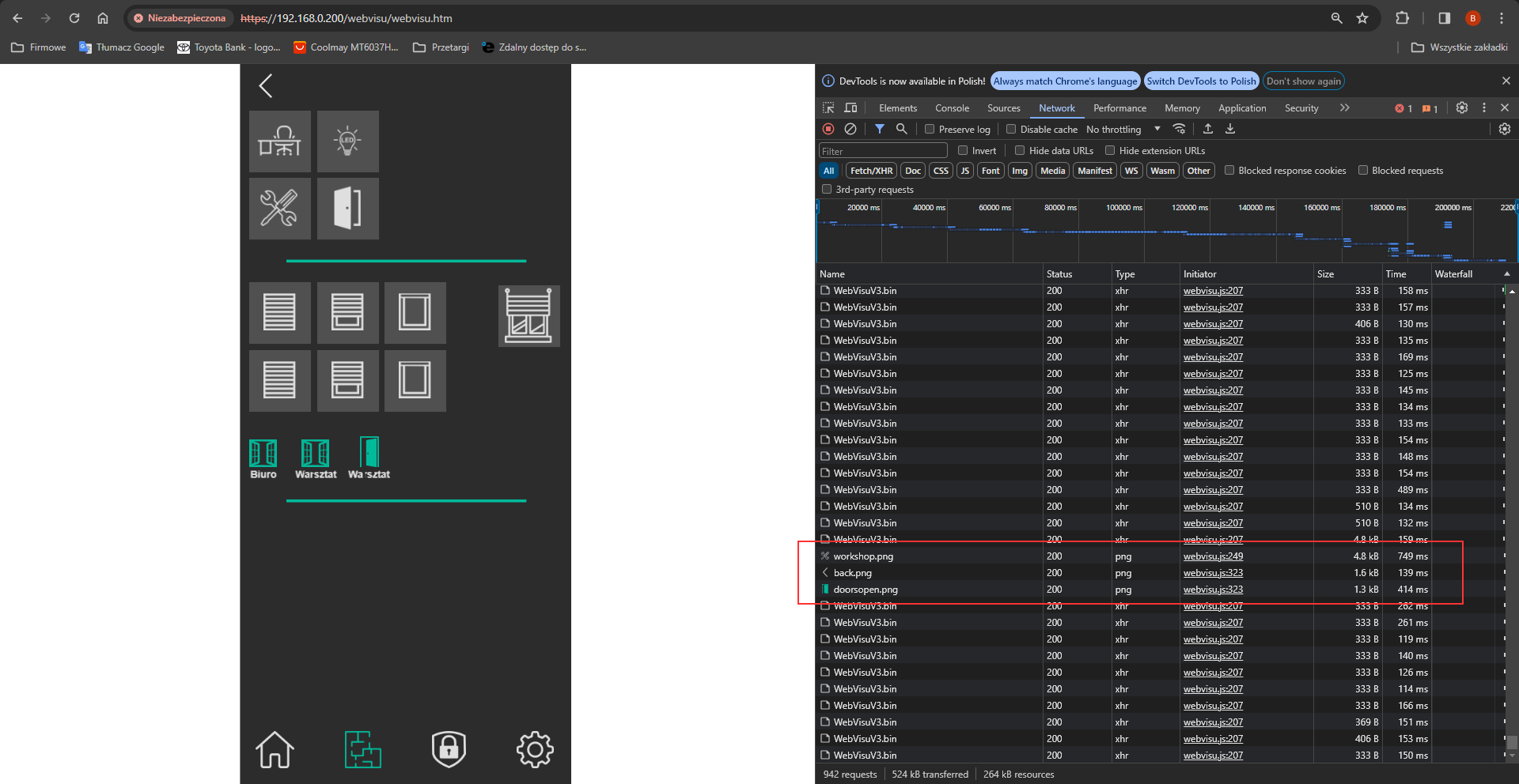

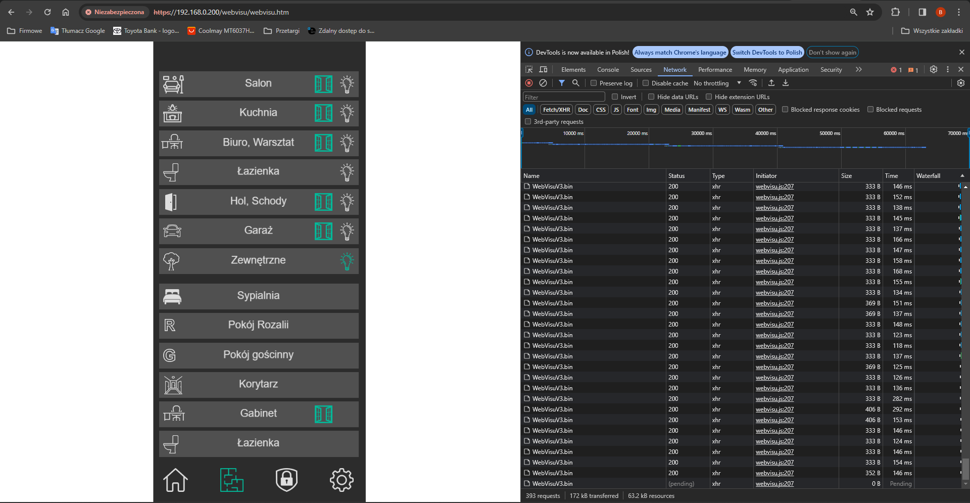

  • #3 20981081
    brzoza900
    Posts: 192
    The WebVisuV3.bin process is executed cyclically (every 200ms), in addition to which the images displayed in the visualisation are loaded when a window is opened.

  • #4 20981088
    hindoos
    Level 36  
    Posts: 3781
    Help: 292
    Rate: 667
    Is access to this file password protected or available to anyone on the local network?
  • #5 20981130
    brzoza900
    Posts: 192
    It is accessible to everyone. I would prefer to leave it that way so that no password has to be entered, so that use is immediate and more convenient.
