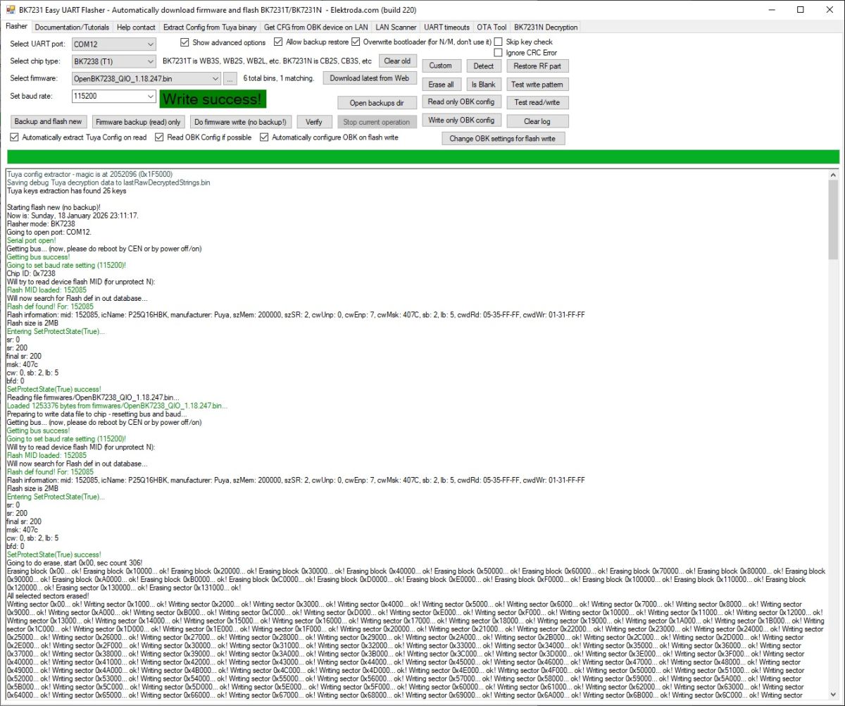

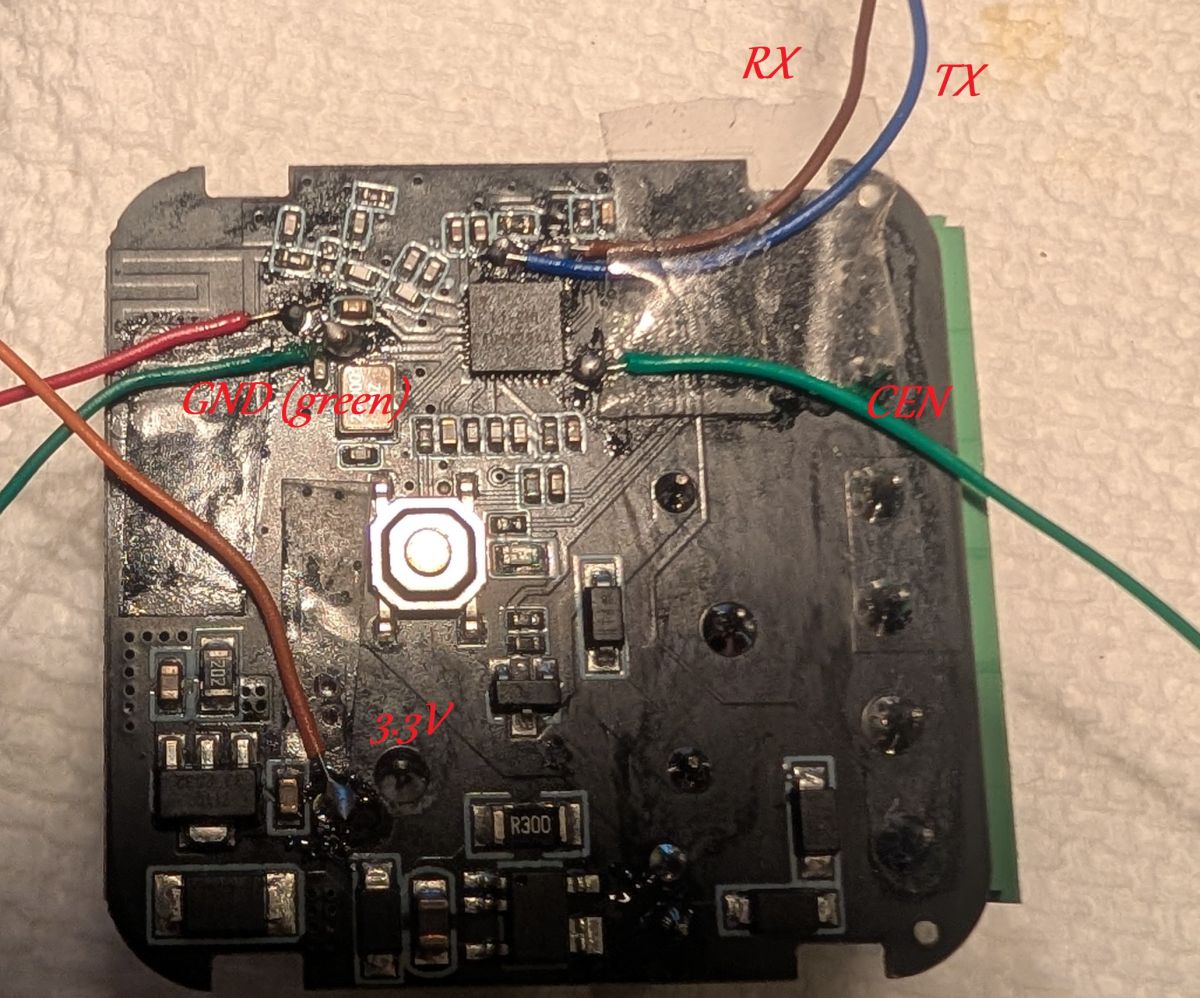

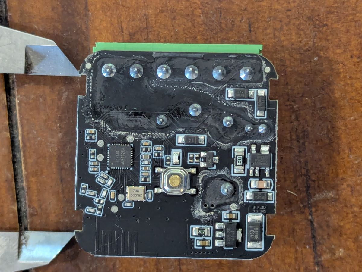

    I have 6 new generic Tuya DIY smart Switches with a

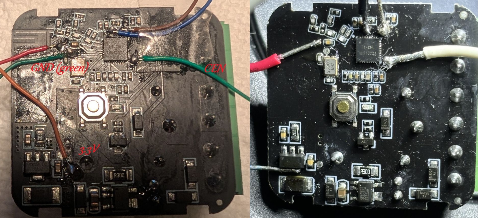

    Close-up of PCB with soldered wires labeled GND, RX, TX, 3.3V, and CEN
    T1-CHL AU5101XA chip and some unmarked pads on the bottom that I traced out and identified 3.3 V, GND, Tx, Rx, CEN.
    I am presuming that this is compatible with OpenBK7238_QIO_1.18.247 firmware (I tried several other ones in the repository).
    I've made some progress Screenshot from Tasmota app showing GPIO configuration in JSON format
    Bk7231 GUI Flasher window with JSON configuration displayed
    Bk7231N Easy UFlash Flasher app interface showing partitions and decoding log
    Of course, there are no signs of life after this flash. No access point. No LED.
    I eventually was able to get some signs of life for two of the units by overwriting the bootloader, writing OBK settings for the WiFi network and then finding it on DHCP. The relay responds in the web GUI. The RF section, according to the web app, is all FF FF. The MAC addresses of those two switches were identical. Using the web app, OTA flash seems to work using the overwritten bootloader. GUI MAC change does not; AP access point does not work. "Restore the RF part" from the UART flasher writes a few lines before the rest which, for the most part, are all FF FF FF according to the web app, but the GUI now shows a new random MAC which then appears on the network properly. Didn't get to test MQTT.
    It seems that the offsets may be an issue or I'm completely wrong as to which firmware to use. Any insight on how to set up the flasher for the new offsets would be appreciated. Attaching the read file from a stock device.

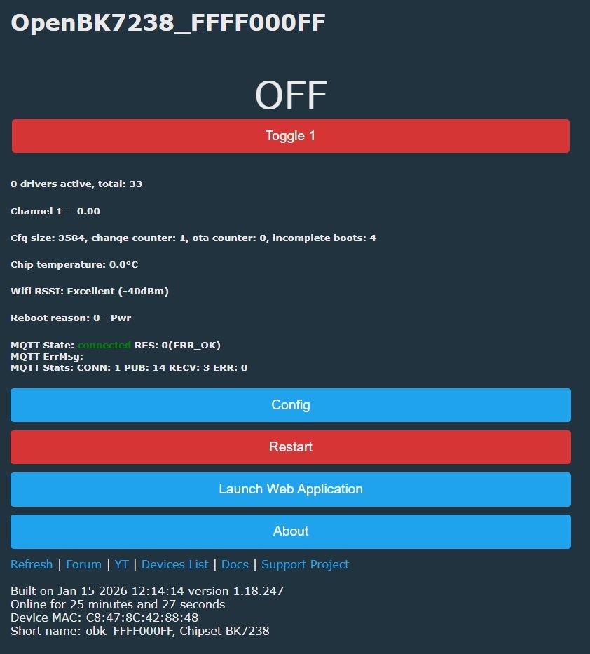

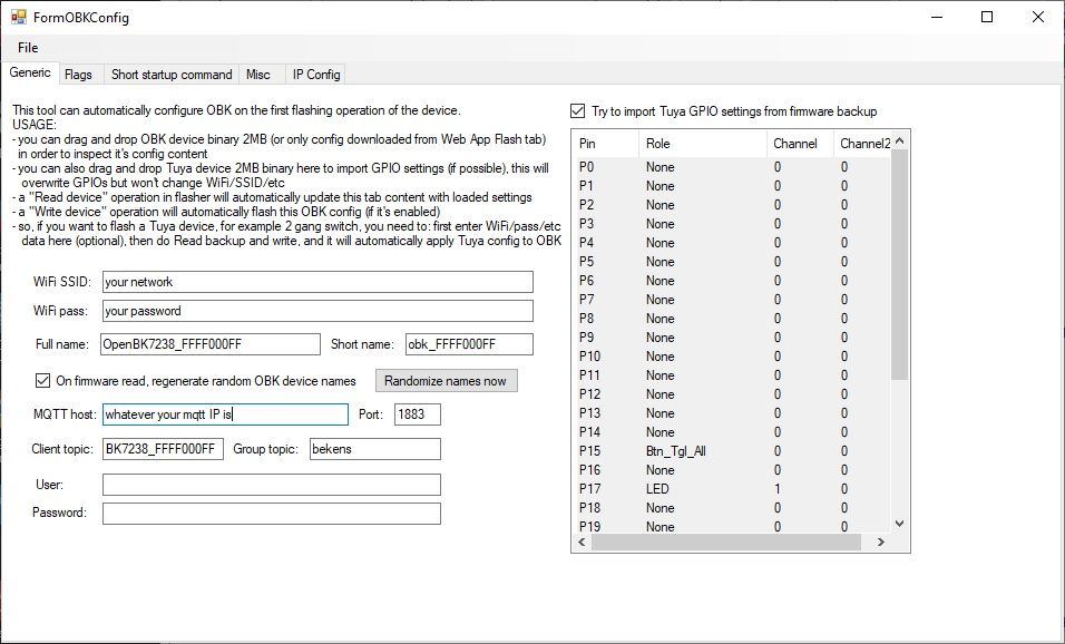

    So the sequence that at least gets me a GUI on the network was to: flash the firmware, overwrite the bootloader, then flash OBK separately with WiFi credentials, then restore RF part, apparently not completely to the right place. Once I do this, I get a GUI only on the network and am unable to restore from backup.
    Firmware flashing tool interface for BK7231 with Write success! message visible
    OpenBK7238 interface showing OFF status and MQTT connection data
    FormOBKConfig configuration window with network and GPIO settings

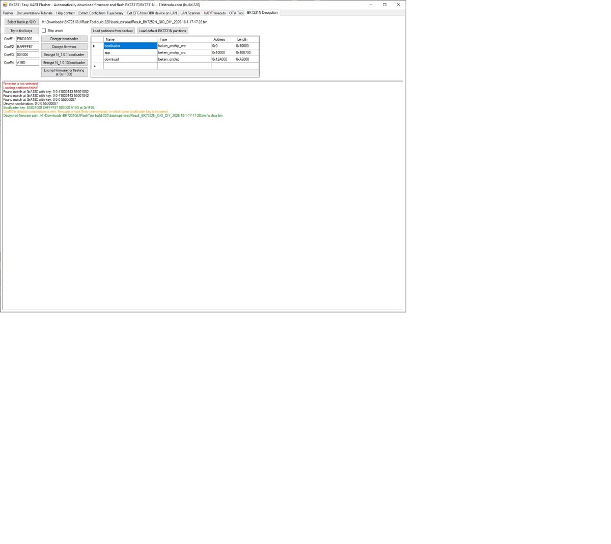

    use your backup to restore original RF to correct location for BK7238. I think ideally Easy Flasher would strongly encourage a backup and restore of RF to correct location or OBK move expected location to match Tuya's, because this will keep coming up
    https://www.elektroda.com/rtvforum/topic4106397.html#21764525

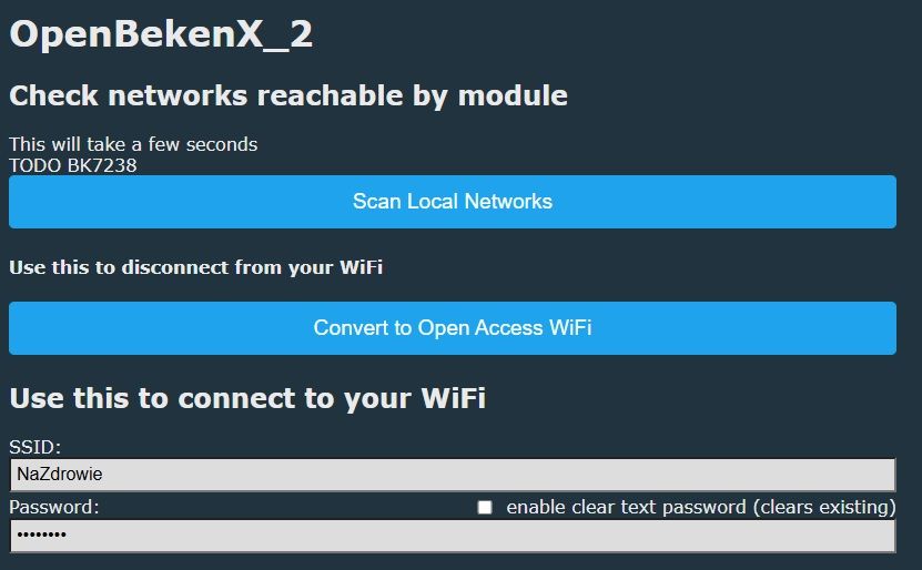

    I opened a second batch of switches with the same chip name, but these perform differently when flashing.
    Now the sequence: 1) "Backup and flash new" with OpenBK7238 v247 - "Automatically configure OBK on flash write", "Allow Backup restore", and don't overwrite bootloader. 2) Before doing that, "Change OBK settings for flash write" with the correct GPIO data - as automatic GPIO seems not to work. 3) Restore RF part. Works.
    All the stuff that didn't work on my last two units of hardware works well with this new batch.
    Tested: OTA update with .rbl file, access point, change MAC with GUI, MQTT. Wi‑Fi SSID changes.
    OpenBekenX setup interface with WiFi options and SSID field NaZdrowie

    Looking at the forum, it is difficult to keep a database on these generic TUYA switches with the same packaging, same case, no labels on the circuit board, and no model numbers.
    This one works with different pin settings compared to many of the templates.
    "pins": {
    "6": "TglChanOnTgl;1",
    "15": "Btn_Tgl_All;1",
    "17": "LED;1",
    "26": "Rel;1"
    It appears to respond to a PowerSave 1 command properly, based on the log.

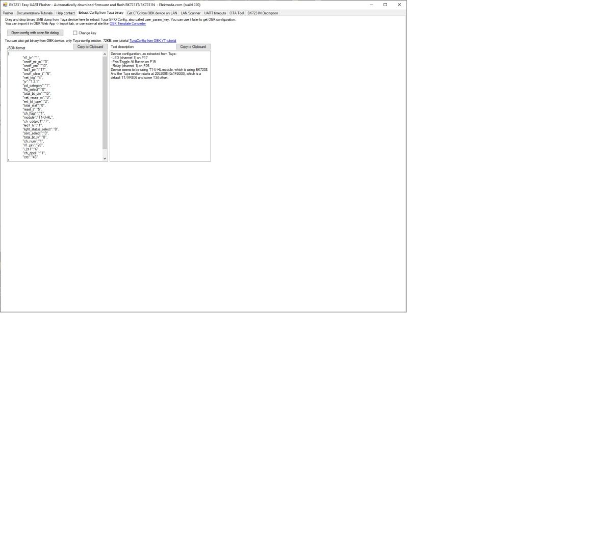

  • Decrypted JSON reveals pin mapping and template gap

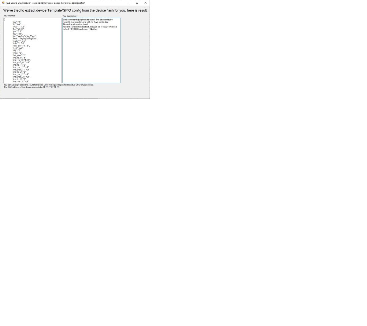

    The JSON below can be seen decrypted from your dump. Easy Flasher doesn't extract enough currently to map pins from it and even then it doesn't know about your pin6, which I guess is either
    or
    do you have any more pictures of your device so one can be added to the device list in a new template?

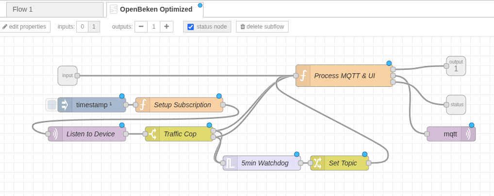

    While I am waiting for the new device package to test out, I made a Node-RED subflow that seems useful specifically for Open Beken flashed devices.
    The usage is a custom node that only requires a topic and a pop-up selection of an MQTT server known to flow. It takes an input from a Dashboard 2.0 switch node and feeds back to the input of the switch node to update its state. There is a status display below the custom node that displays online, offline, on, and off states.
    Example flow usage picture and design of the subflow node. JSON of the subflow node.
    Testing and comments would be appreciated.

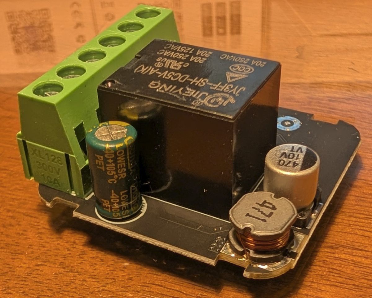

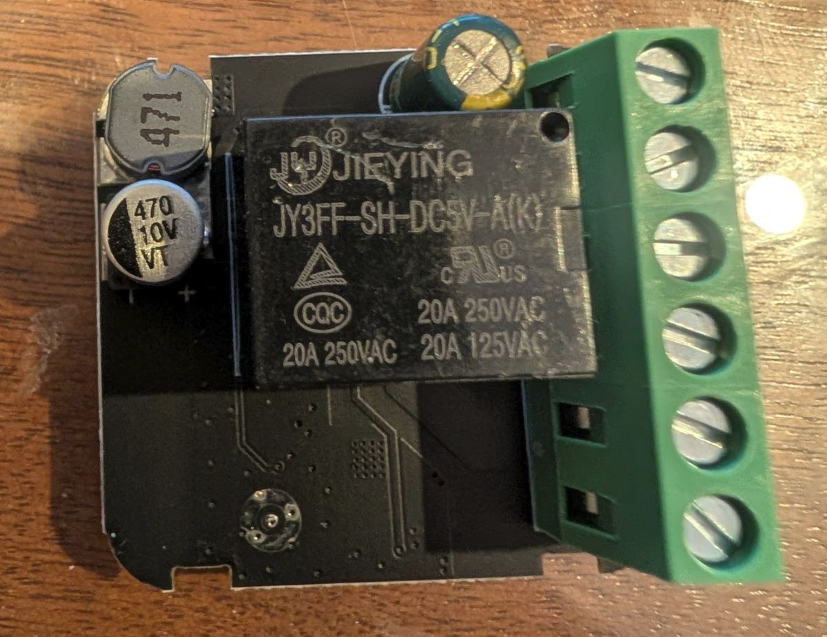

    The new batch just came in and appears to be the same from this vendor.
    Pics:
    Box labeled “DIY Smart Switch” on a wooden table
    Mini Smart Switch with technical specifications label and screw terminals visible
    JY3FF-SH-DC5V-AK relay module with screw terminals and capacitors
    Relay module with capacitors and terminal block on a wooden surface
    Close-up of a PCB with AU5101XA chip and various surface-mount components.

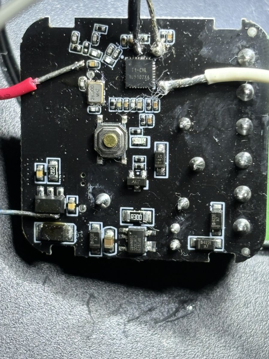

    Mushinronsha
    I got a similar device that uses T1-CHL AU5102XA and I cannot flash it, it always fails to recognize the chip even when I power it from my benchtop PSU or shorting CEN to ground. What is baffling me is the fact that all pins seem to be the same, I verified this by continuity testing the testing pads on the PCB against the chip pad descriptions in the T1 datasheet. I also tried different chip types in EasyUartFlasher to no avail. Any thoughts/ideas?
  • #12 21911220
    Posts: 5220
    Help: 449
    Rate: 918
    got any pics of your device and wiring?

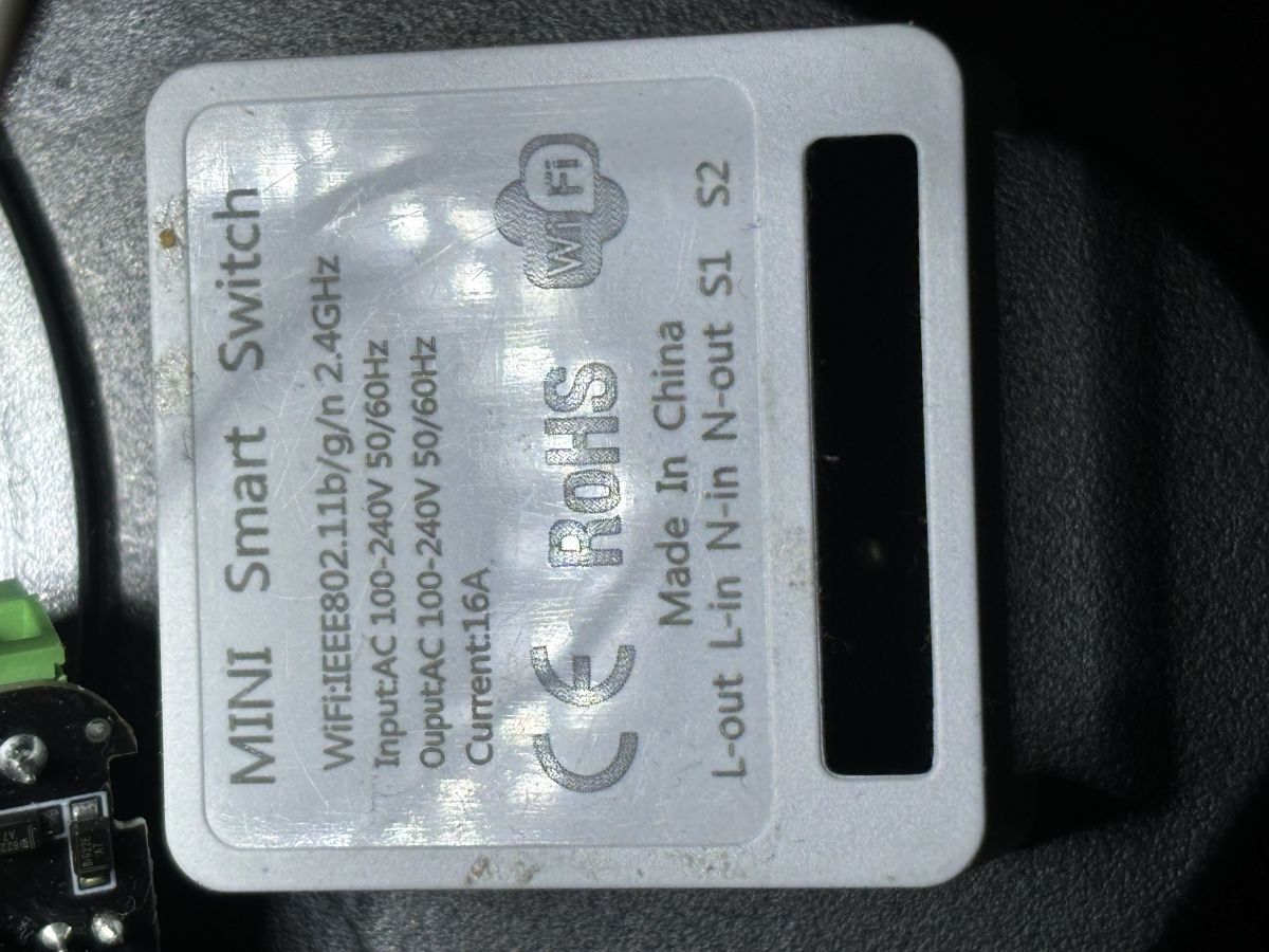

  • #13 21911854

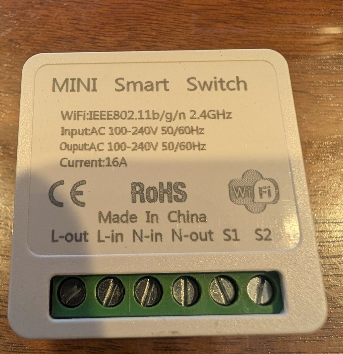

    Mushinronsha
    First of all, I'm really sorry for such a late reply. Now, as you can see from the pictures, it is literally the same thing except that 2 in the chip marking T1-CHL AU5102XA.
    Everything else, I think, is the same.
    Close-up of a PCB with SMD components, soldered wires, and a small push button Label on a “MINI Smart Switch” module with Wi‑Fi, power specs, and terminal markings..

    Two close-ups of a PCB with soldered wires and labels GND, 3.3V, and CEN

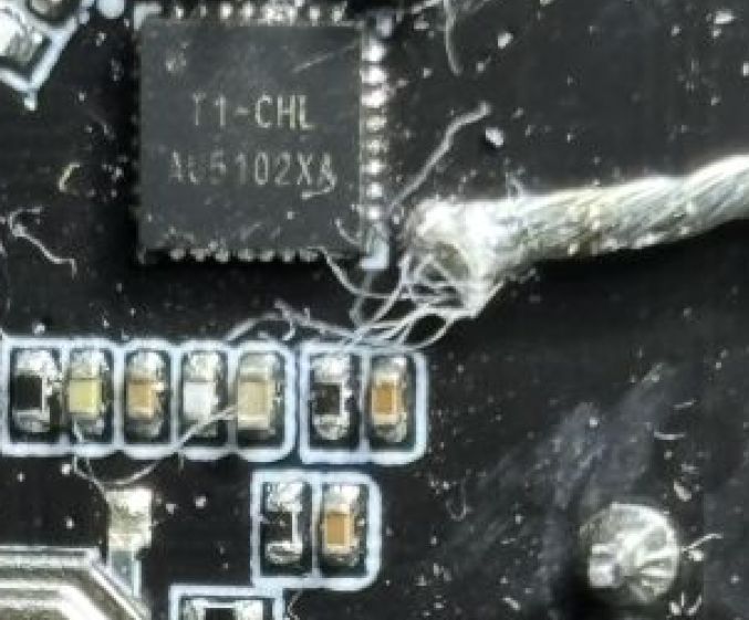

    these strands here, are they fluff or actual solder/wire? are they causing a short?
    Close-up of a PCB showing an IC and a cluster of fine fibers near a soldered area
  • #15 21911974
    Mushinronsha
    They are fluff from the cotton bud I used to clear flux off the chip, in order for the markings to be readable.

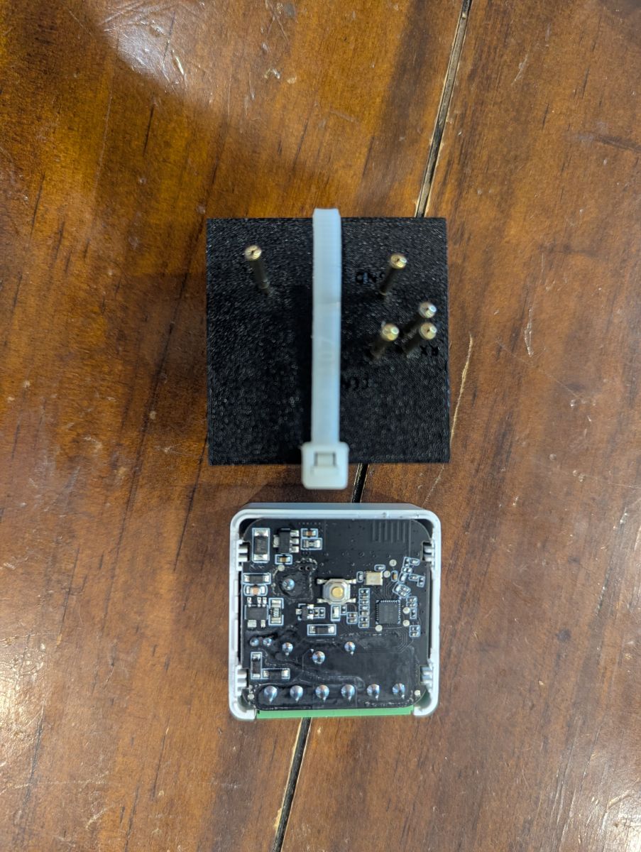

    Printed a pogo pin adapter for it as well: https://www.printables.com/model/1741438-tuya-diy-smart-switch-pogo-pin-adapter
    Close-up of a black PCB with a tactile switch and SMD components on a wooden surface Wires connected to a USB hub and a small electronics module on a wooden tabletop Circuit board in a white housing and black foam block with metal pins on a wooden table

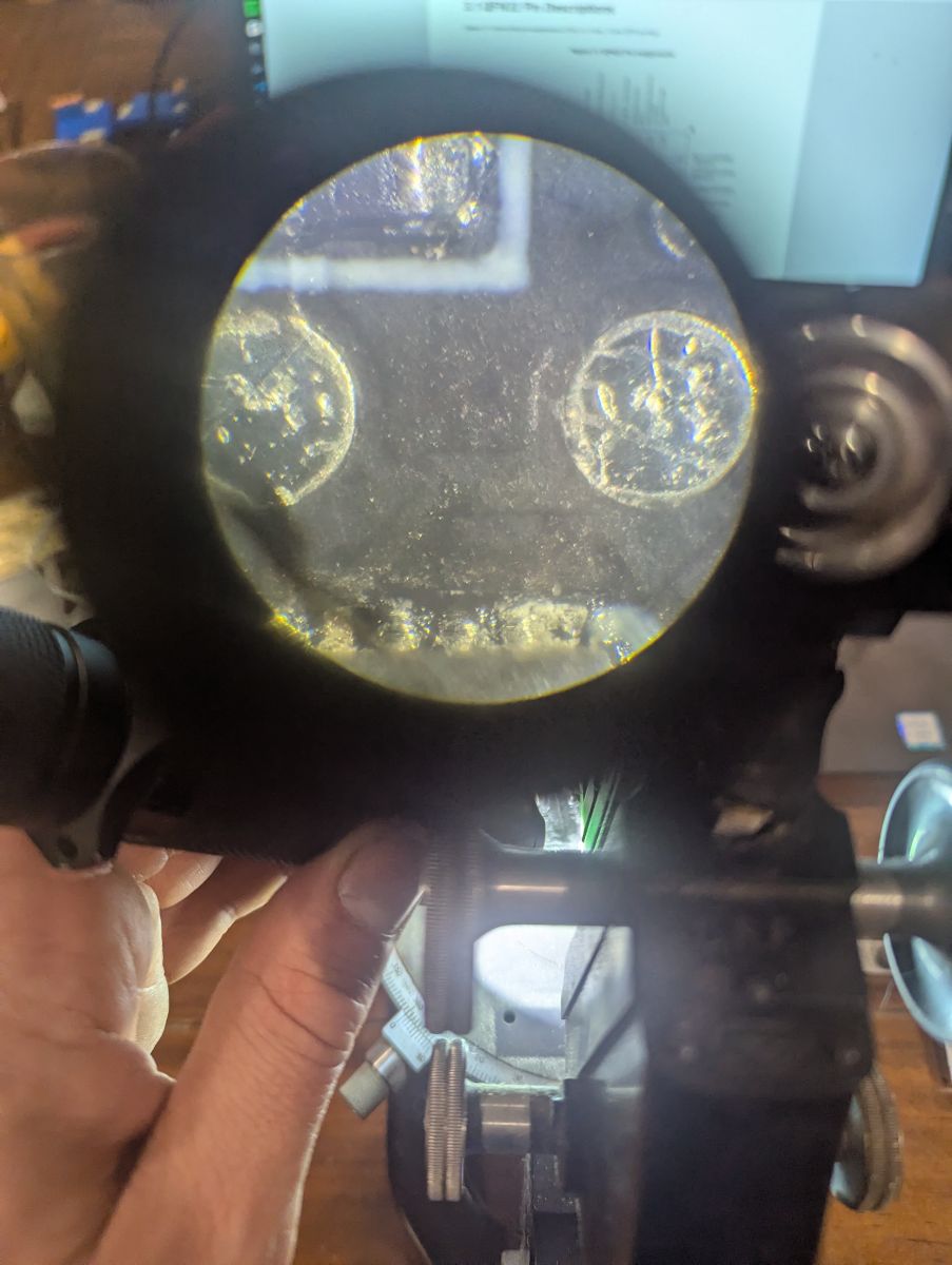

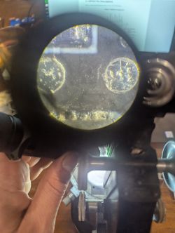

    I assume the labelling in the pic in post #1 is correct, but have you verified each pad traces to the expected pin on the T1-CHL?
  • Test pads actually route to TX1 and RX1 pins
    #24 21914045
    iff7378
    Posts: 11

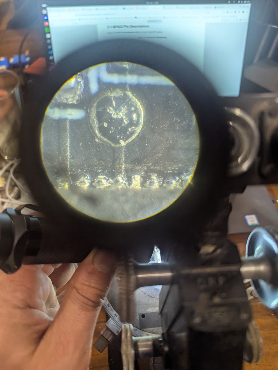

    Hmm, I rung out the test pads with my multimeter and neither of the Tx ad Rx pads according to the image in the first post seem conected to the T1 chip at all. Cen, Gnd and Vcc all seem correct but no UART pins. Looked at the board through my microscope and those two pads are connected to TX1 (pin 29) and RX1 (pin 28). I have no idea why I'm not seeing a connection. Getting contact to the chip package itself is going to be hard.
    View through an optical eyepiece showing a magnified circuit board area with traces and solder points View through a round lens: close-up of a metal part with two screws

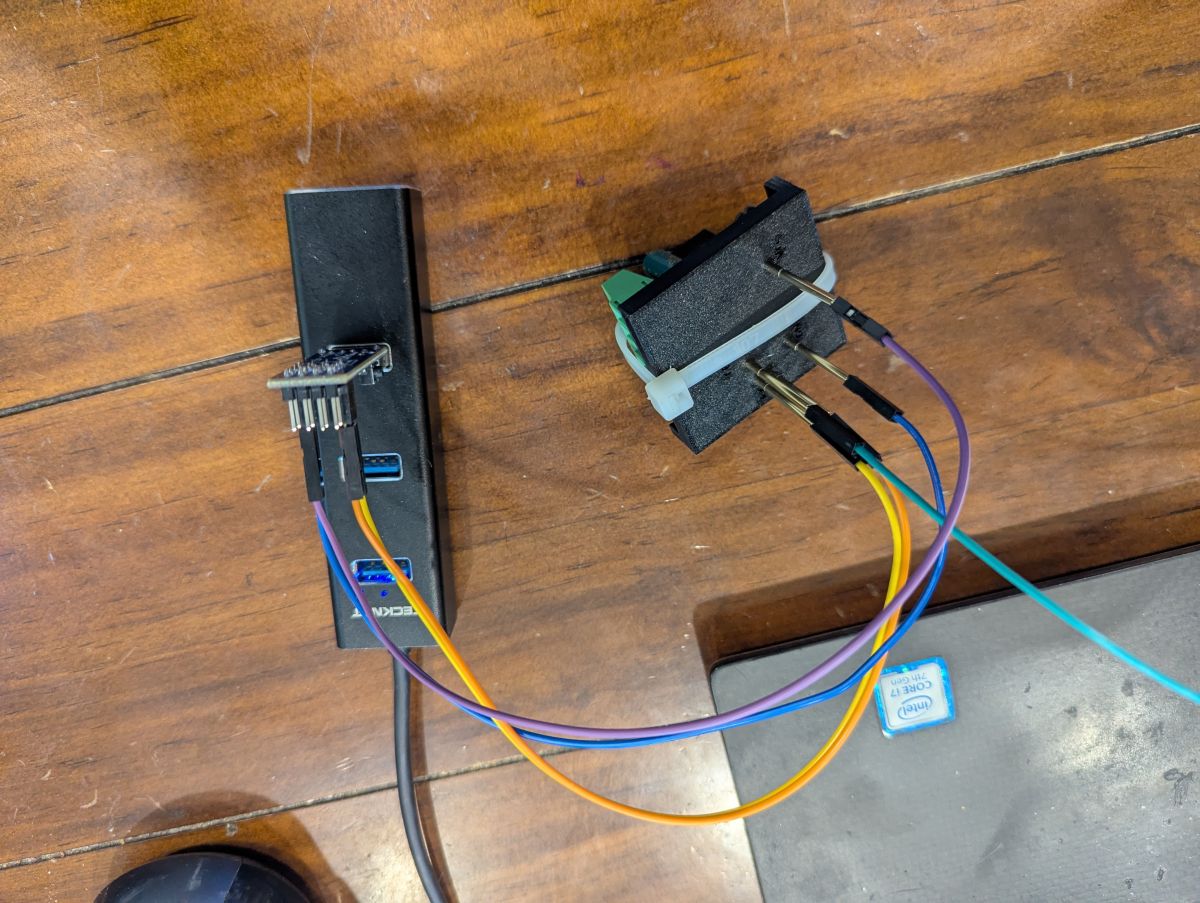

    OK Progress! I got connected to the bus. Looks like my pogo pins weren't making good contact with the pads. I soldered wires on and things got better. However, now easy flasher is failing to set the baud rate? I tried 115200 and 921600. Both failed.
    Looks like the fastest it wants to go is 19200. Oh well, it's reading the chip at least!
    Edit: Got OBK on and working. Connected to a real power supply got faster data speeds.
