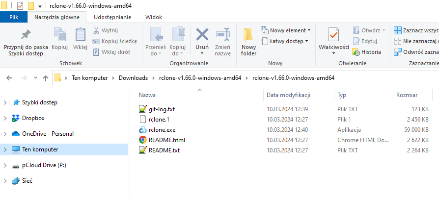

    The tool in question is cross-platform and available for download completely free of charge, including: here:
    https://rclone.org/downloads/
    We simply download and unpack the package for our platform.
    This way we get the expected exe:
    Screenshot of a folder with rclone files in Windows.
    However, it is not a window program, only a command line tool, so you will need to write a script...
