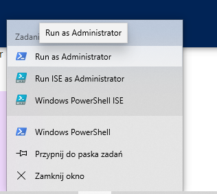

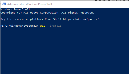

    Then we open PowerShell - as administrator:
    PowerShell context menu with Run as Administrator option highlighted in Windows. .

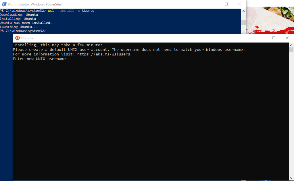

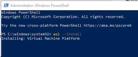

    We type wsl --install :
    PowerShell window running as administrator with the command wsl --install typed. .
    The laborious installation process will then begin:
    Windows PowerShell window with the WSL installation command active and a message about installing Virtual Machine Platform. .

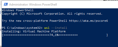

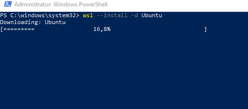

    Waiting:
    Screenshot of Windows PowerShell window running wsl --install command, installation progress at 74.1%. .
    In my case it continued to install Ubuntu by default, but the installation was stuck at 0.6%:
    Screenshot of WSL and Ubuntu installation in a Windows PowerShell window. .
    I aborted the process and performed the necessary reboot of the machine. Reboot can be done with the command wsl --install -d Ubuntu :
    Windows PowerShell window running the command to install Ubuntu via WSL, showing download progress at 16.8%..

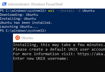

    After a while, our Linux system will install and our Ubuntu prompt will start.
    Step 2 - we are finalizing Ubuntu on Windows .

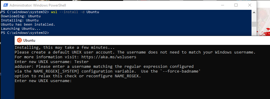

    It's time to configure our Windows Ubuntu. We provide a username and password:
    Computer screen with PowerShell running Ubuntu installation via WSL and Ubuntu window asking to create a UNIX user. .

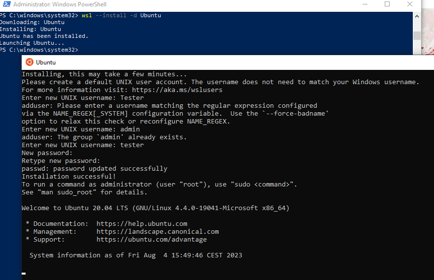

    Ubuntu is picky, I had to enter the name in lower case:
    PowerShell window installing WSL and Ubuntu, with Ubuntu terminal prompting for a UNIX username during initial setup. .
    We also set a password, I myself chose a fairly short four-letter one:
    Ubuntu installation screen in PowerShell on Windows with user setup in WSL. .

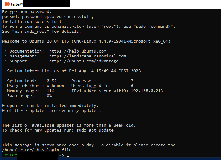

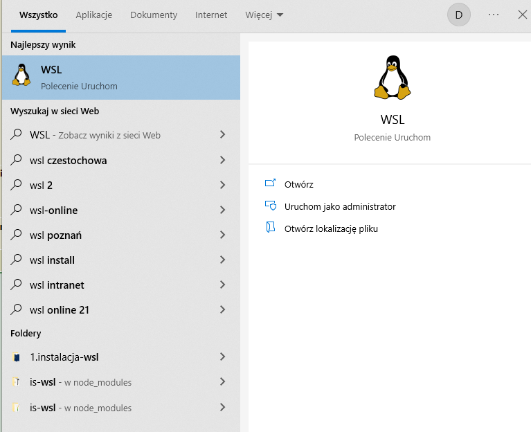

    From now on, we can type "WSL" on the Windows bar and run the Linux command line this way:
    Screenshot of the Windows search showing the WSL app with a penguin icon in the results. .

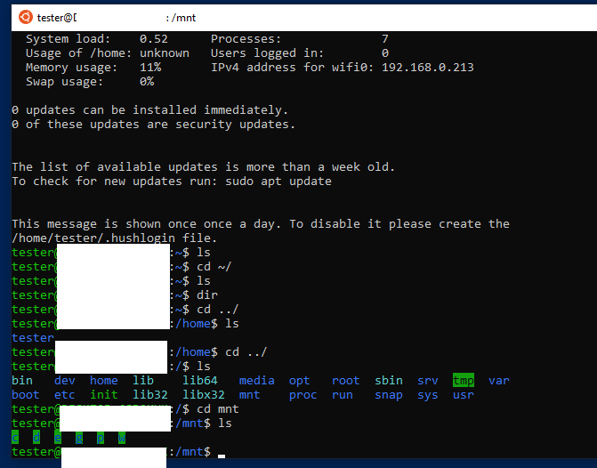

    In my case it looks like this:
    Ubuntu 20.04 terminal launched in WSL showing the welcome message and system summary. .
    The obvious implication of this is that you need to know the Linux commands. That is, we operate via cd (change folder), mkdir (create), chmod (set permissions), etc, etc. Our disks can be found in the mnt folder:

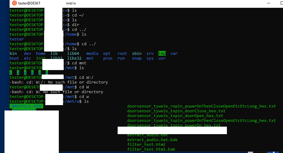

    Screenshot of Ubuntu terminal running in WSL on Windows, showing filesystem navigation commands and directory listing. .
    For example, below I have looked at my W drive - lower case there. All files are visible:
    WSL terminal window on Windows displaying directory structure and filenames on mounted W drive with visible commands and text files. .

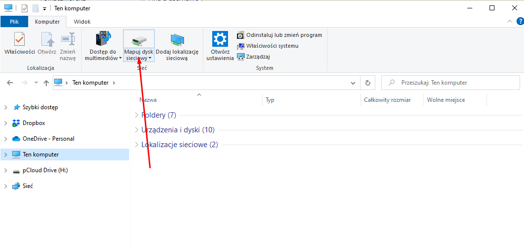

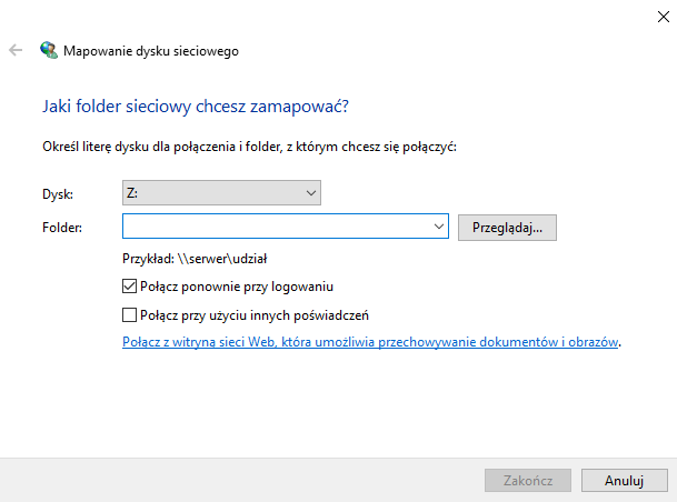

    Eventually I decided that I would map my server on Windows as a network drive .
    This is performed in This Computer, here:
    A screenshot from Windows Explorer highlighting the Map network drive option in the top toolbar. .

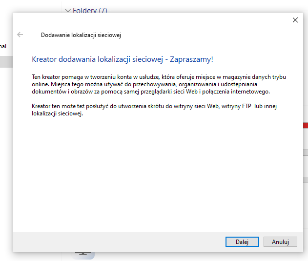

    We click through the wizard:
    Network location wizard window in Windows, with Next and Cancel buttons visible. .

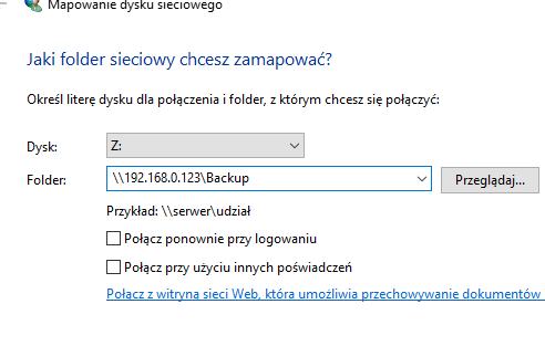

    We enter the address of the share in the format <span>share:
    Network drive mapping window in Windows with options for selecting drive letter and network folder. .
    Below you have an example of what this looked like for me:
    Windows network drive mapping window with selected drive letter and network folder address. .
    It's worth ticking the box from automatically connecting after a reboot.

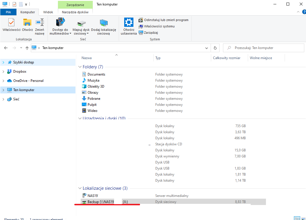

    Then in my case the disk did not appear at first, but after the reboot everything was ok:
    Windows “This PC” window with a mapped network drive “Backup (\NAS19)” as drive X: highlighted. .

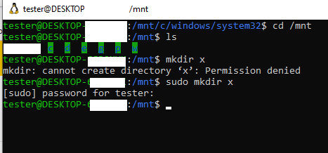

    I didn't even have to install rsync itself. I only had to mount the newly added network share to WSL by first creating a folder for it in mnt (as root) with the mkdir command:
    WSL terminal window showing permission denied error for mkdir, then successful directory creation with sudo. .

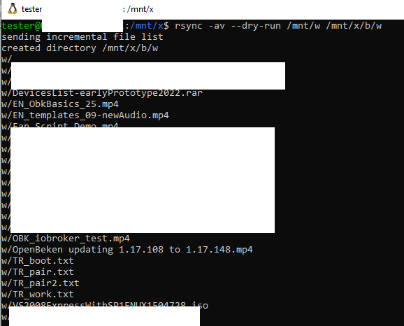

    Then all I had to do was use the rsync command.
    I recommend this for a trial:
    rsync -av --delete --dry-run /mnt/w /mnt/x/b/w
    The basic syntax is:
    rsync [przełączniki] [źródło] [cel]
    This will make a copy of the files from the source on the specified target.
    Let's decipher the arguments one by one:
    - a is the archive mode (recursive synchronisation with the option to preserve attributes)
    - v - verbose mode (displaying progress and processing information)
    - delete - deletes files on the target location that do not exist on the source location
    - dry-run - enables simulation mode, where rsync displays what would happen, but does not perform the actual synchronisation, so you can experiment to your heart's content
    This is what it looked like for me:
    WSL terminal showing example use of the rsync command to simulate copying files between directories. .
    rsync will also give information about deleted files. And of course - the process can be interrupted and resumed, the whole thing works "smart" and does not copy blindly, it is an efficient solution.

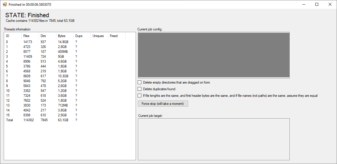

    I have set up a backup and data management system for my own use. I use rsync, but this tool alone is not enough.
    There are problems such as duplicate files and strategies for managing them, synchronising backups (especially when it comes to photos and getting rid of unnecessary files), undoing changes, logging exactly what is being done, busy reports, etc.
    I base my solution on file hashes. All operations of adding, moving and deleting files are first performed on the hashes, then execution scripts are generated and scripts for undoing changes should something go wrong.
    Technically it is a set of tools written in Python, Bash, Java and C.
  • #6 20681970
    Posts: 14783
    Rate: 12924
    @simw good point.
    @acctr yes, I play like that too, I have at least a multithreaded, just based on hash tables (but the first level of hashes is... file length in bytes), deduplication program:
    Screenshot of a file deduplication program showing a summary of files, directories, and data usage. .

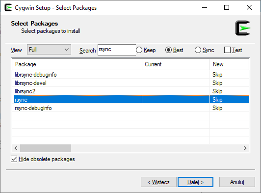

  • #12 20683143
    simw
    Posts: 759
    Help: 94
    Rate: 288
    It looks like @jvoytech is right. With me on msys2 this command works. Thanks, I learned something new.
    It seems to be similar with Cygwin64.
    It too is in packages and can be installed.
    All in all no surprise, after all it's a linux toolkit for windows.
    Cygwin Setup window displaying a package selection list, rsync searched. .

Where are Windows drives mounted inside WSL, and how do I access a drive like W: from Ubuntu?
Windows drives appear under /mnt inside WSL. In the thread, the W: drive is accessed as /mnt/w, using a lowercase drive letter. You then use normal Linux commands such as cd and ls to browse files from Ubuntu. That mapping lets rsync treat Windows folders like local Linux paths. [#20681049]
